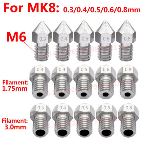

G-son Posted May 24, 2019 Posted May 24, 2019 I just thought of using 3D printer nozzles as gas jets for small burners. I've just made a little research, but they seem to be available down to 0.2mm diameter. Not sure about the internal shape or length of the narrow passage, probably varies between different manufacturers. Do they seem suitable? Availability seems good, price okay (but not great, like the mig tips). Quote

Mikey98118 Posted May 24, 2019 Author Posted May 24, 2019 The printer jets remind me of a similar idea I had to use replacement gas jets a few years back. The printer jets appear to have the same drawback; very short orifices. If you have to mount capillary tubes in the jets to get the desired result, than nothing is gained over using a MIG contact tip. Quote
G-son Posted May 25, 2019 Posted May 25, 2019 Which brings us to the topic "how short is too short?" (Keep your girlfriends out of this one.) Looking at the jets in store bought small burners the orifice seems to be quite short, a couple of millimeters at the most, and often there's a filter of sorts mashed down into the mouth of the jet too so there's no laminar flow into the orifice for sure. Not a perfect design by what we have learned around here, but it seems to work. With smaller diameters shorter orifices would seem to be acceptable, but how much is enough? Quote
