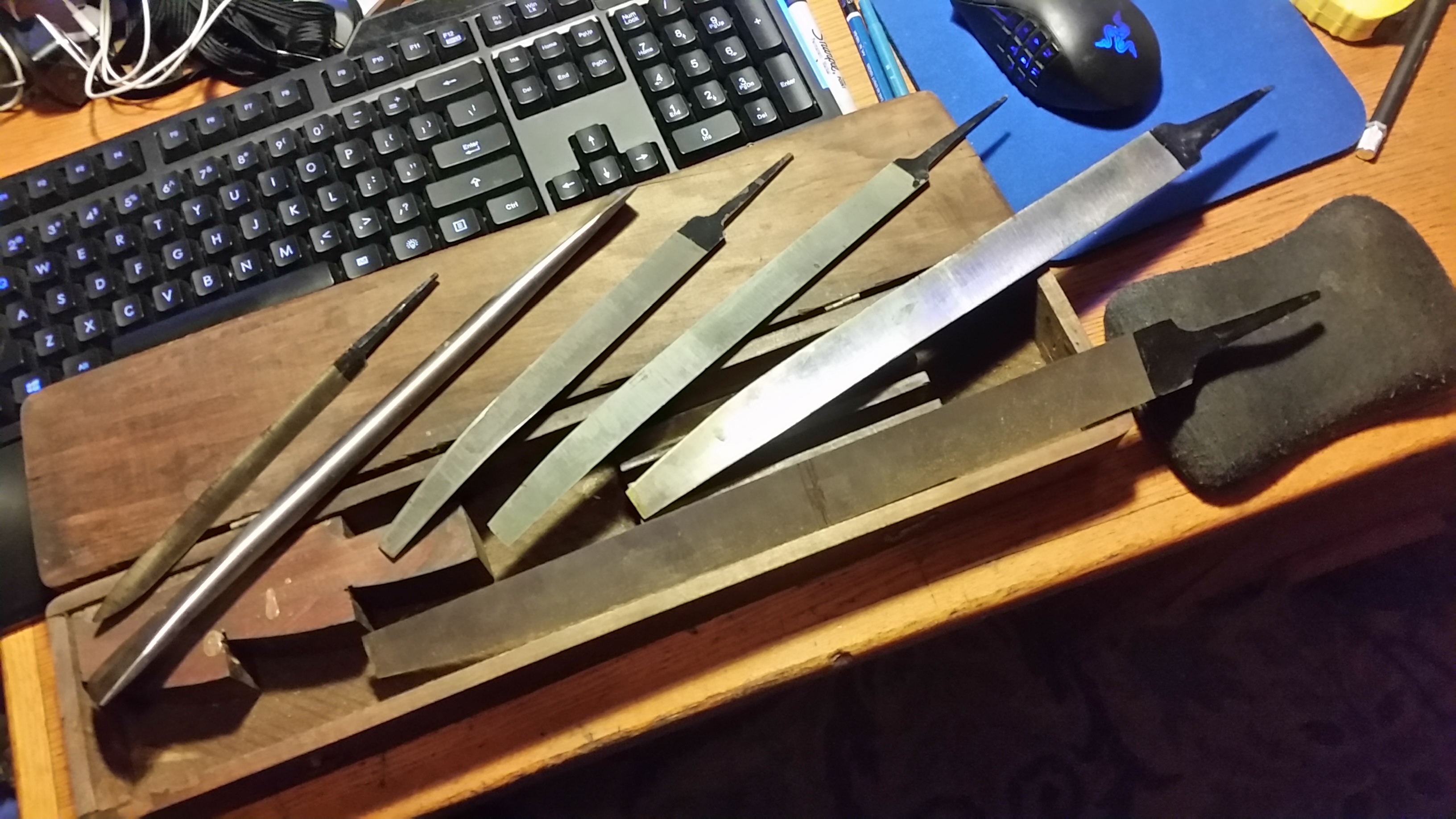

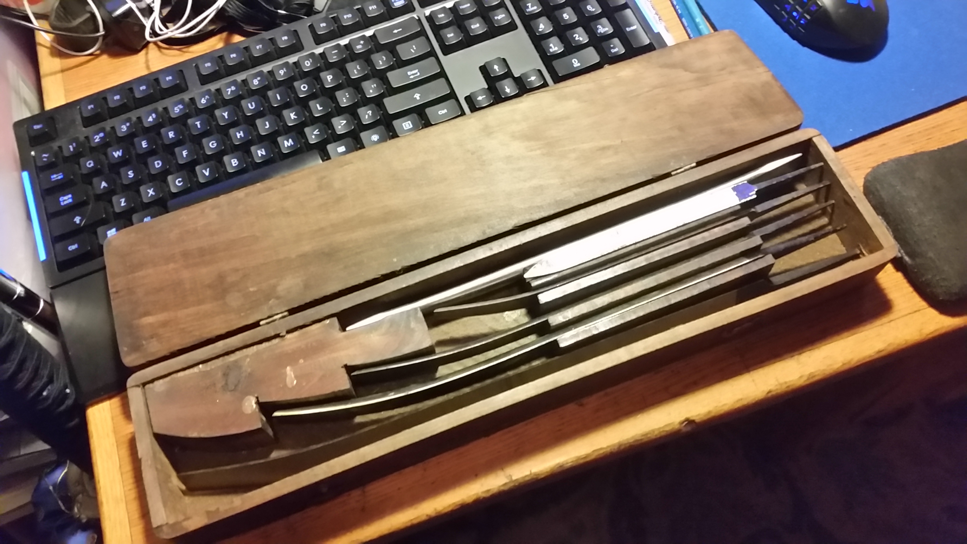

What are these? Can I turn them into knives?
They look like unfinished files, but the inside is actually concave and the edges are sharp. They appear completely unused, with some oil still protecting them.

Scrapers?
Good Morning,
They are a set of Babbit Bearing Scrapers. A necessary Tool set for working on old Machinery/Equipment.
Can, Is a question of Ability. I have no knowledge of your Ability.
Neil
Yep, scrapers. Since you have a nice set there I would not make knives out of them. Anyone doing work with babbit bearings for power hammers and such could use them for final fit up. The Cincinnati centerless grinder which is still the standard of the industry uses babbit bearings. They can also be used for scraping in ways on milling machines. Those are the tools that make the little feathery marks on machine ways, and tables.

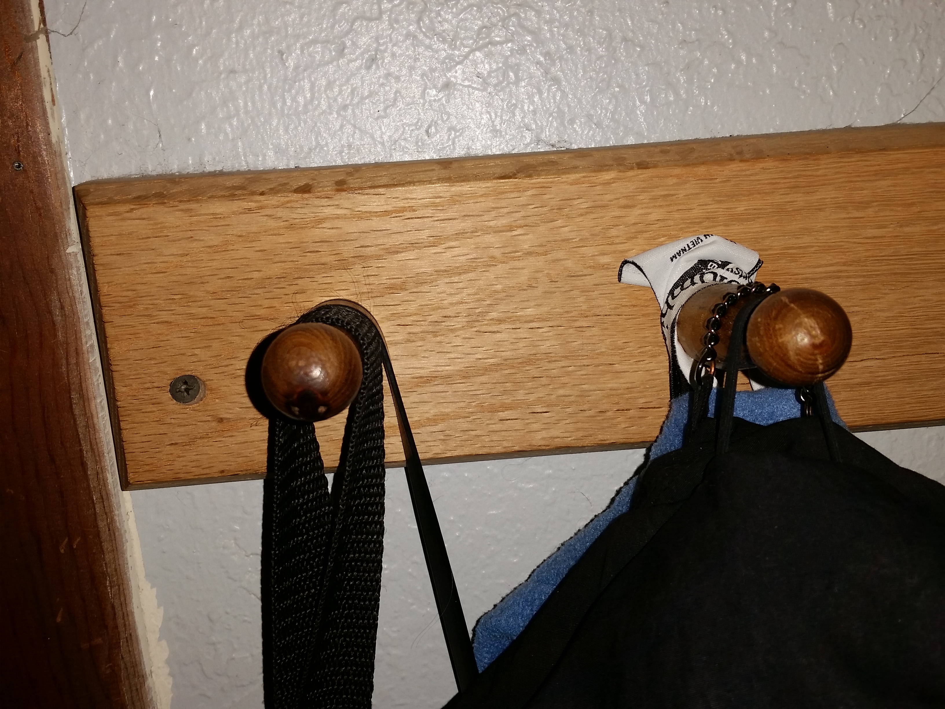

Oh Frosty, alright already! These have darkened up quite a bit, since I put this coat rack up 15 years ago. These locust pegs were turned on the '34 Southbend, aforementioned (duh wuns wit duh wabbits). I was making the pegs from dowel rod, but ran out, three pegs short. So, I went to the wood stove, grabbed a 1-1/2" dia piece of locust, and turned the last three pegs. The back plate is re-milled pallet oak.
