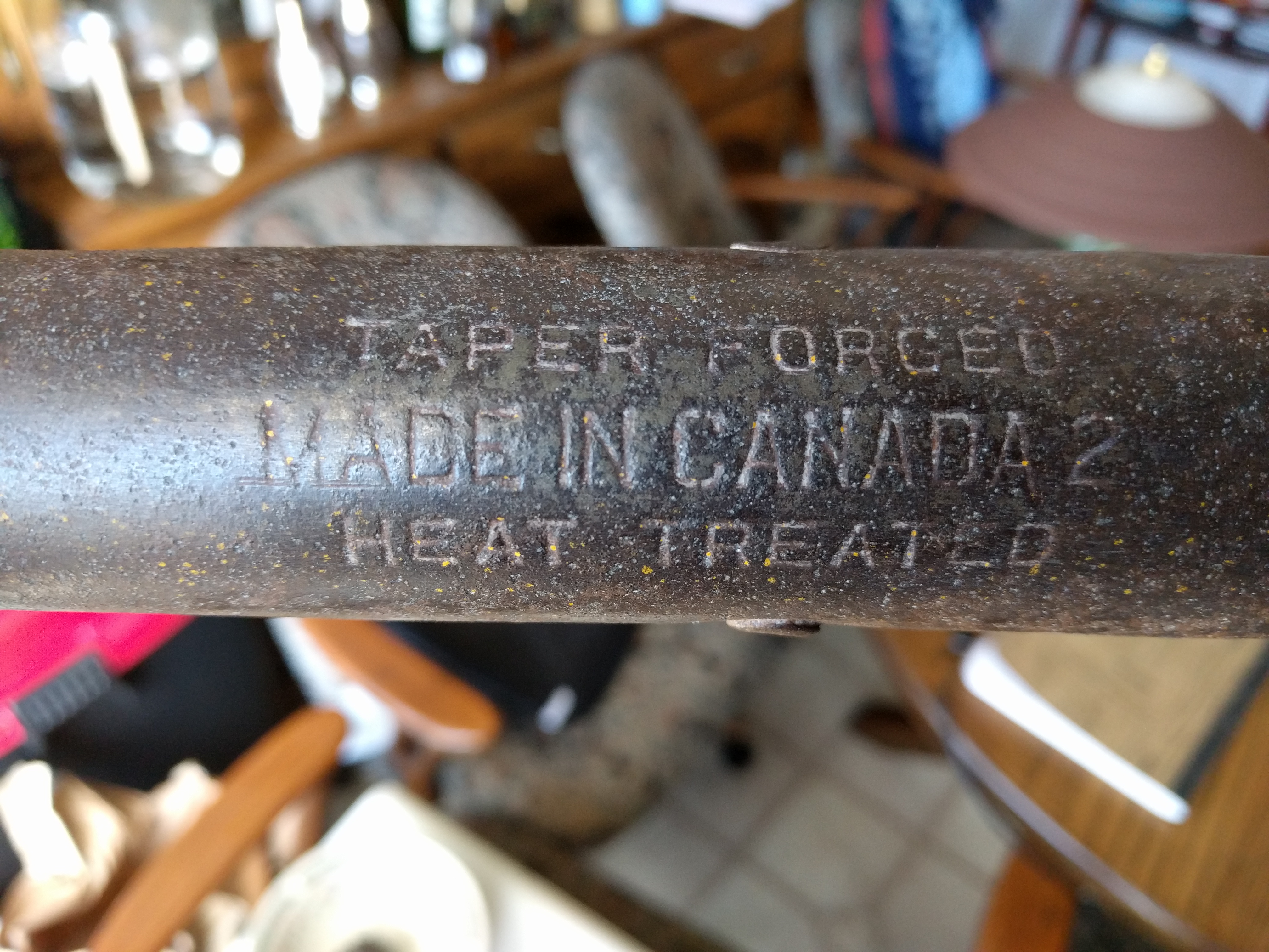

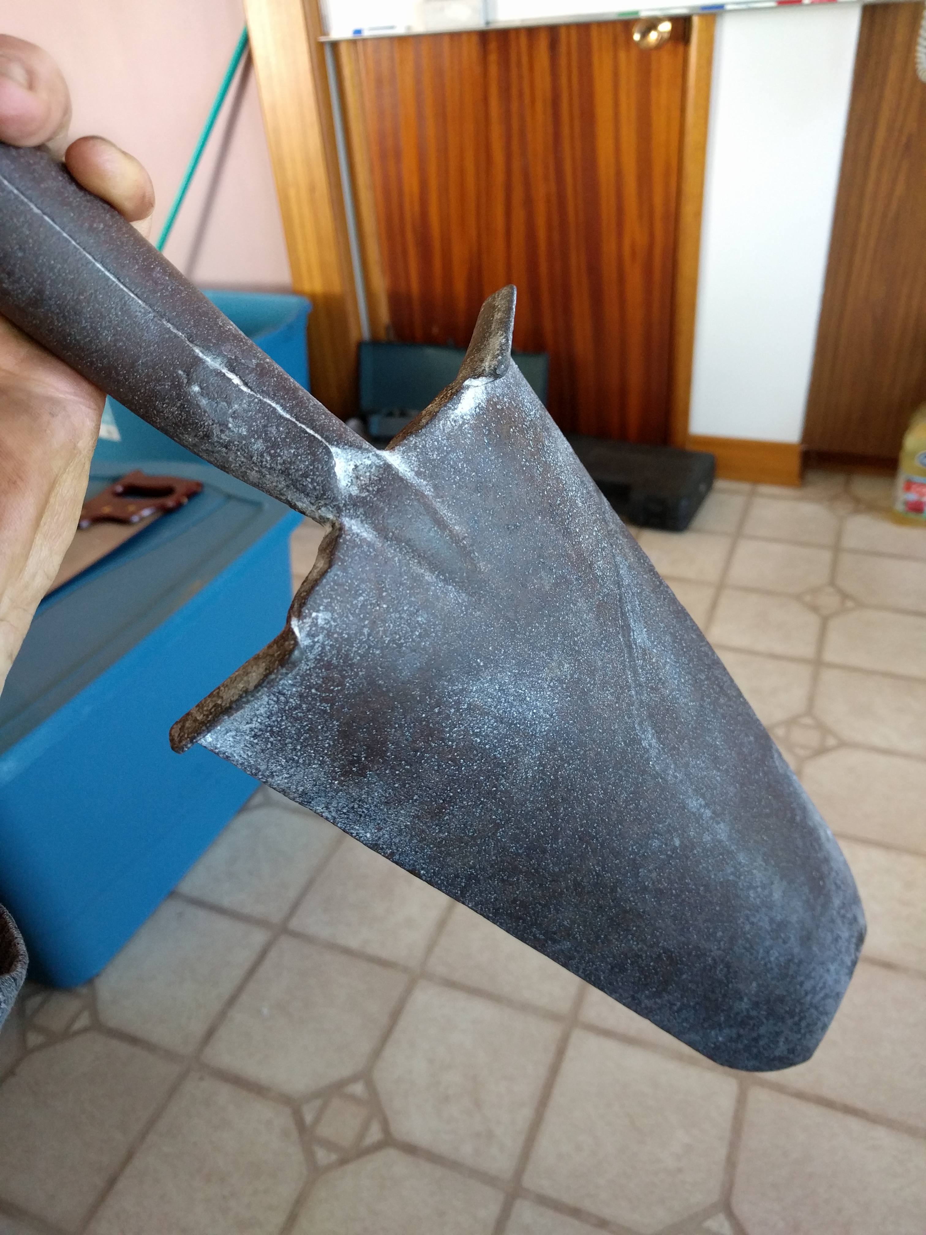

Ok so here is my situation.  I am a tree-planter who works in northern Canada and I have been doing this a number of years.  I have a very demanding sense of what my shovel should be shaped like.  I plant 3000 trees every day so I need that tool to be exactly how I like it.  It's piece-work, so if my shovel isn't perfect it is costing me money.  A good shovel can make me a lot of money in a 4 month period.
So I making myself a new shovel this year and I have found an antique shovel that I wish to convert into my customs shovel.  I'll be doing some grinding to bring the shape down to where I want it but I find the angle of the blade to the handle is a little too extreme for my taste.  I want to bend the shaft of the shovel just before it reaches the blade.  On the shaft of the shovel is printed  "Taper Forged   Made In Canada   Heat Treated".   What I want to know is can I simply clamp the shovel in a vice, heat the shaft up with an oxy-acetylene torch and bend the shaft to the angle I want?
There will be times when I'll be putting a lot of torque on the shovel, and I don't want to weaken the steel.  I have seen other shovels fail in this part of the shaft but those were likely of poor quality.  I'm probably being overly cautious posting here looking for advice, however this tool is very critical to me and also I expect I could learn something interesting.

The short answer is NO.  It will be soft and weak in  the area you heated. In this state you would have a SSO (shovel shaped object)
It would need to be properly heat treated to function as a shovel. It was heat treated by professionals at the factory when it was manufactured. An experienced blacksmith might (repeat might} be able to do it,

I suspect that the steel used for shovels is generally a type of air hardening steel . If it is you can heat it and and air cool without softening the steel. If you have some scraps from your modifications you could do some tests. Heat up, cool, and it will be quite apparent if the steel has softened.

Klorinth, from your description I wonder if this antique isn't what you were describing with "bare root shovel".  I bought this thing for $5 off an old guy who collects antique stuff.  I really feel like the quality of the steel is almost certainly going to be much higher than anything I can buy new today, that's why I went out of my way to hunt this down.  I'm still trying to decide how I want to shave it down, whether I keep the kickers etc.

You pretty well got my meaning . Tap the piece in the vise with your hammer to get the feel of it,heat and allow to cool, and tap again you will feel if it is still about the same or has gone soft. If it goes soft then I would guess its better not to try heating and bending .

Going to  take another shot at it. Spades and shovels are at least medium carbon steel and doing what you wish isn't a just heat it and bend it operation. The sockets are hardened tapered, curved, thin wall tubing with a slit full length. The original bend is done in a closed die forging press, about 1:44 in the video below. Also note the professiona blacksmith using tools specifically designed to make shovels spends about 2x the time forging the socket than the blade. Heat treat is a little more extensive than it looks I believe the blanks are allowed to air cool in a bin between the finish forming and hardening. The hardening furnace is specific to the purpose. The shovel blades look to be as quenched without tempering, this leads me to think it's a medium carbon steel.

I assume that you'd like more back bend, to align the blade more parallel with the handle shaft?  Personally I would make that bend cold.  I'd fit it with a temporary handle and trap the blade under a heavy log... I'd put a branch for fulcrum under the neck of the handle socket and then step on the handle, or bounce, till I got acceptable alignment.  You are only trying for a few degrees of bend and I think you'd get it that way.  This shovel was made for trenching, which wants a different blade alignment.  Do it before you grind it as you'll not be out much if it fails, which I think unlikely.
To add more curve to your flat shovel... I would use a well rounded forging hammer and forge it against a stump end.  The end grain of the stump will be soft enough to form nice curves as you hammer the concave side of the shovel blade.  Lots of firm raps and slowly curling the shape that you want is the way to work it... Be patient.  BTW do this cold.

Yes... but to curve the blade you are not using forging forces.  Really by hammering against a soft anvil (stump) you are just curving the blade, not reshaping it.  Very little danger of embrittlement involved! Lots of taps though... to get an evenly curved shape whilst only dealing with a small portion of the whole blade at a time.  This is probably a ten minute project... for an experienced smith.

BigFootNampa:  Thanks for that tip on curving the blade, that will work nicely.   That is correct I want it to be more parallel with the shaft for a number of reasons.  I am not sure I would have the ability to bend that metal as you described, it's quite beefy.  Perhaps a machine shop could help me.

I heated the shaft and bent it.  I did a quick in and out dunk it water to semi-halfway quench it without making it completely brittle.  I obviously don't know what effect that had.  At any rate it's done now so I am on to the grinding and adding a handle.
