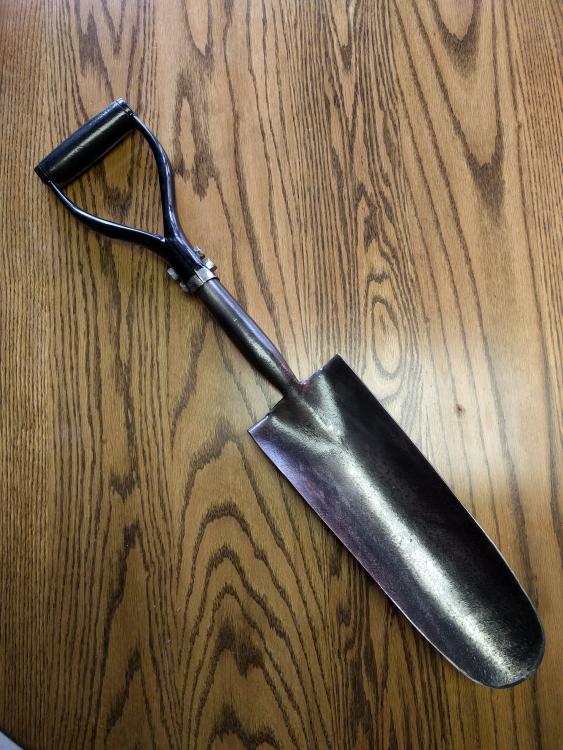

It's all done.   I've made some tree-planting shovels in the past but this one is my masterpiece.  It is a beast
27 inches long and 1.5 Kg.
If I work my hardest I could be putting 250 000 trees in with this shovel this summer.  I'll post some update photos at the end of this summer to show how it weathered the storm.

I've heard of and used short handle spades but . . . :o Deb has a larger key chain!
Do you have any videos of these things in use? I'm having trouble wrapping my head around what kind of advantage a spade that short has. Even if it was just weight packing it around that's negative leverage if you with it pry at all.

You wouldn't have much leverage with that thing, but if it was soft enough ground or you pushed it two handed....there's times I definitely would have prefered that shovel to the standard issue E-tool.

If your shovel is too long you have to bend your elbow or twist your torso in an unnatural way.  You already have to reach into the dirt anyways so it helps if you are already bent over far enough to reach the ground(which you likely won't be if you are working with a longer shovel).

Got it! Head wrapped around itty bitty short spade handle now. Makes sense.
That is an absolutely amazing shovel that your friend made. Beautiful!
Yours is very nice as well. I preferred a little longer handle and a smaller blade. Light and fast.
