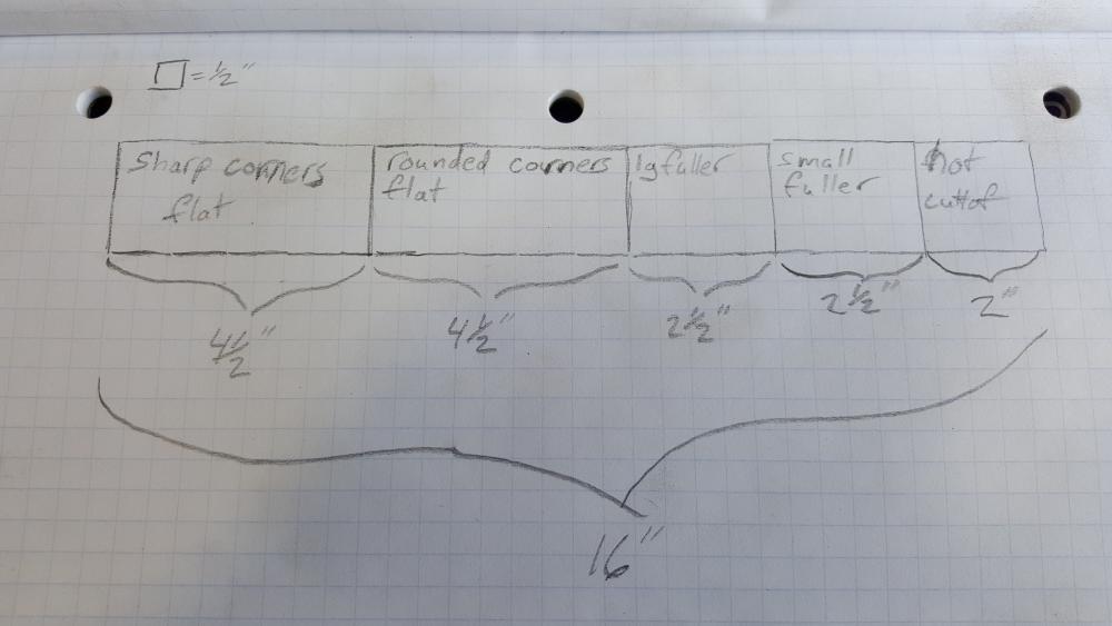

I realize it will eventually up to my personal preference but is an integrated hot cut a bad idea? 1457042309689-719973251.thumb.jpg.13a205
This is my initial thought, I will probably play around with it alittle more.
Where would do you think would be a better place for it? Or just leave it off completely?

Anyone have thoughts on the integrated hot cut?
I believe Charles already said to make a cover for it if you include it.  You don't want to sever digits on that feature. My experience with this type of thing is limited, but my recommendation is to not include it as part of the anvil.  It might be a bit inconvenient to set up a different way to do hot cuts, but it's a whole lot more inconvenient to take your fingers to the emergency room and hope they can reattach them.

Ok, Charles, that's what I had been thinking to have them all flush so nothing would be sticking up over anything else. I would generally be working on the other end.
Buzzkill, I completely understand your point on severing fingers being less convenient than having a separate tool. That's why I was asking for advise on how it should be done differently so if it sounded like I was disregarding what had already been said I didn't meanotice to, just want to get it right the first time. Throwing a loop of leather or similar and bolting on will be easy but if there is a different or better way or placement I would like to know it
I don't think a hot cut built in is the best idea. You might cut you hand badly or damage a tool. You are better off making a portable hardy hole if you want to use a lot of hardys. Otherwise, your vise can probobly hold most. For a hot cut, you can put an old axe head in a vise.
Pancho, I tried to envision how you would stand when using the anvil.  In my mind to use the large or small fuller area you would probably stand with your tongs perpendicular to the anvil and swing in line with the hot cut.  If you were standing at the hot cut end of the anvil, which would be the closest to your fuller areas, then you'd be swinging directly over the hot cut section.  Unless you can get a cover for that hot cut that you know will not come loose while you are hammering I see that as a recipe for disaster.  I suggest mounting that rotary bar you have.  You can mount that flat like you show in the pictures.  You've got a nice large central hole with a bunch of little holes around it.  If you can get a decent thickness plate with a square hole in it, you can easily bolt it in place and then have a mount for any hardy tool you want to use.   My 2 cents, but someone with more experience might have a better idea.
The more I think about it it is a bad idea, even without all everyone saying it is.
I think the only legitimate use for an always-up integrated hot-cut would be something like a nailmaker's setup, production smithing where you are going to be doing lots of cuts a lot of the time.

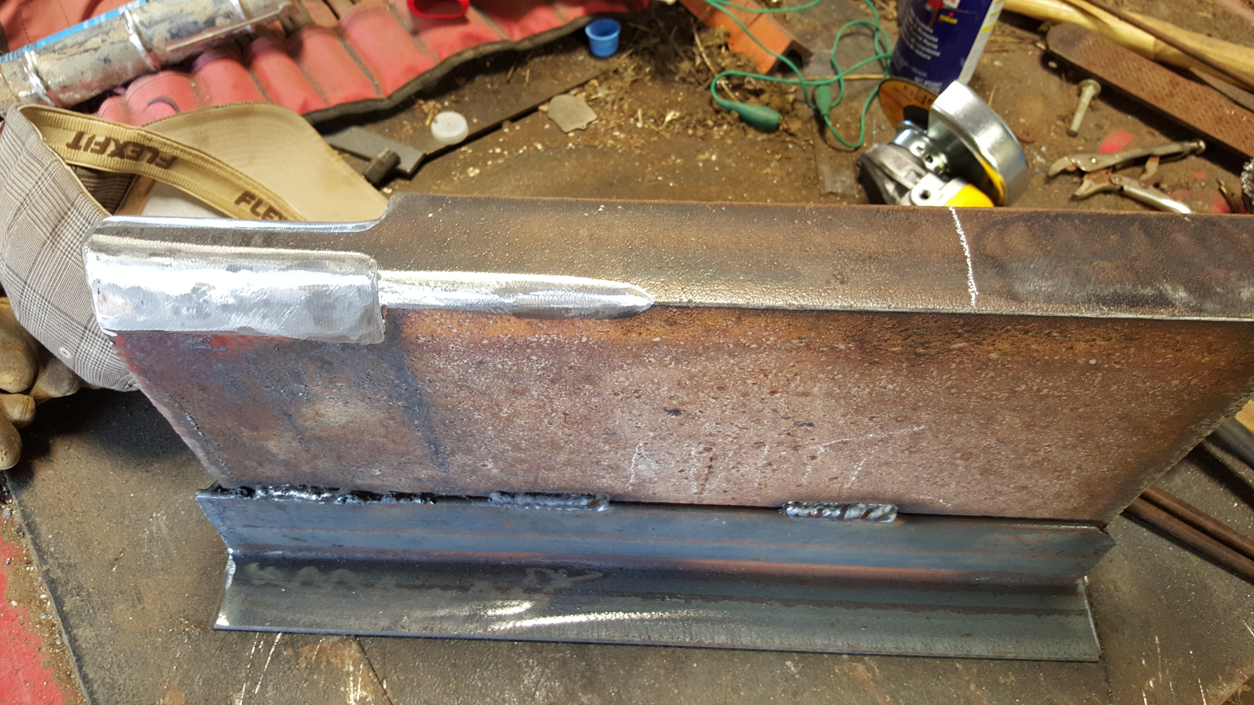

Well this is what I ended up with, just need some kind of stand, what little I've played with it so far though it works pretty well
good start all you need is a 3 legged angle iron stand at the height you need or want.

That'll work. I'd weld the angle iron to the stand and let the anvil "float" in the angle iron. That lets you rotate the anvil so you have all those other edges to modify as you like or need. A tripod has a number of benefits but most of all it's stable on any reasonably solid surface, it can NOT rock. A 4 legged or box stand can get rocky on a pebble and you WILL want to move it eventually or maybe like Me, all the time. I swing my anvil around for the best angle on what I'm doing.

Over all I'm happy with it for the moment. I obviously didn't put the hot cut in, haven't decided whether I'll weld a piece of tubing onto it for a hardie hole or go with Frosty's idea of a completely separate one.
 I've been toying with the idea of hard facing it but if I end up needing to i can always do that later I suppose.
There is NO rush, you have the basics already. Make whatever stand you think will work for you, right now you can stand that on a pile of lumber and get to hammering. I certainly wouldn't bother with hard facing. It's probably low carbon steel plate so would want to dent under the hard facing so you'd need to lay down at least 1/2 of build up rod for stiffness then hard face, THEN grind it smooth. For the price of enough hard face and build up rod to make a difference you could just buy a new anvil.
