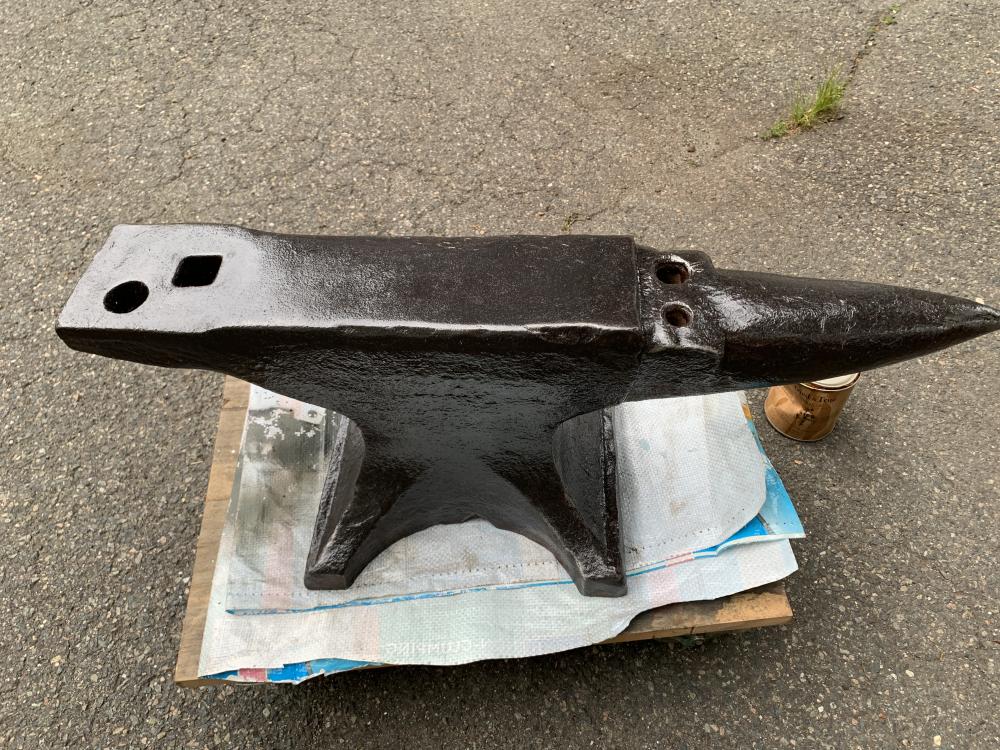

Spanky Posted May 28, 2021 Share Posted May 28, 2021 I just obtained this anvil from Craigslist. After a good brushing I see no identifying marks. There are three (3) Pritchel holes which makes me think “ferrier” but I would love it if anyone could help me identify it? Quote Link to comment Share on other sites More sharing options...
Frosty Posted May 28, 2021 Share Posted May 28, 2021 Welcome aboard Spanky, glad to have you. Are you the long quiet Spanky Smith or another one? If you'll put your general location in the header you might discover how many members live within visiting distance. I don't know the maker unfortunately but I believe the two holes on the step are finger holes making it a bowling anvil. It's like curling, you pitch the anvil on a frozen sheet of ice and score throws according to distance from the target point. Usually a coyote. I'm being silly, I certainly HOPE I didn't need to tell you the above is silliness! I don't even have a copy of Anvils In America so I'm afraid I'm no help unless a little comic (I hope) relief made you smile. Someone will be along who knows anvils I'm sure, give them a little while. Frosty The Lucky. Quote Link to comment Share on other sites More sharing options...
Chelonian Posted May 28, 2021 Share Posted May 28, 2021 That anvil looks sort of similar to one I saw for sale recently. Do you live in or near MA? My guess for brand would be Peter Wright from the steps on the feet. Quote Link to comment Share on other sites More sharing options...
ThomasPowers Posted May 28, 2021 Share Posted May 28, 2021 Need to see the underside of the base, I'd bet that there has been some serious modifications to it, I think all the Pritchel holes have been added or modified. What are the ring and ball bearing test results? Always helpful to give the location of the anvil, if someone was asking about a used car identification would knowing it was located in Russia change your pool of guesses compared to being in the USA? Quote Link to comment Share on other sites More sharing options...
Spanky Posted May 29, 2021 Share Posted May 29, 2021 Thanks for the warm welcome! Yes, I’m in Massachusetts; the man who sold me the anvil told me it had belonged to his grandfather in Tewksbury. To my (decidedly inexpert) testing it has a lovely ring and excellent rebound. The two extra Pritchel holes are very cleanly drilled through several inches of steel and it’s hard for me to imagine they were added later (did they have hardened steel bits that would do that 75-100 years ago?) but I suppose they could be. I didn’t see any markings on the underside of the base when I brushed it up but I can try check again & post a picture tomorrow. What am I looking for? (PS - still having rotator cuff trouble from the last time I took my anvil bowling. Be warned!) Quote Link to comment Share on other sites More sharing options...
Frosty Posted May 29, 2021 Share Posted May 29, 2021 Sure, I have two drill presses more than 100yro. Drill bits have been around a long LONG time and any drilling necessary in an anvil would be done before the face was hardened. Where the two pritchels holes on the step are isn't hardened steel. Bummer about the shoulder, that's usually the result of improper follow through you know. Thomas is asking to see the bottom because some makers leave characteristic "signature" artefacts. A "caplet" being the most common I THINK. It's an indentation more or less the same shape as the foot. Frosty The Lucky. Quote Link to comment Share on other sites More sharing options...

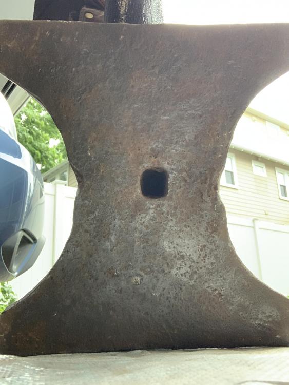

Spanky Posted May 29, 2021 Share Posted May 29, 2021 Here’s the bottom of the anvil. Does it help to identify? Quote Link to comment Share on other sites More sharing options...
Frosty Posted May 29, 2021 Share Posted May 29, 2021 Ayup, that'll help. Frosty The Lucky. Quote Link to comment Share on other sites More sharing options...
Irondragon Forge ClayWorks Posted May 29, 2021 Share Posted May 29, 2021 15 hours ago, Spanky said: I’m in Massachusetts; We won't remember this once leaving this post, hence the suggestion to add it in your profile. As Frosty said the picture will help by eliminating some of the manufactures that had caplets & hour glass shapes in the base. I'm another one who is thinking Peter Wright, but I've been proven wrong before. Quote Link to comment Share on other sites More sharing options...
