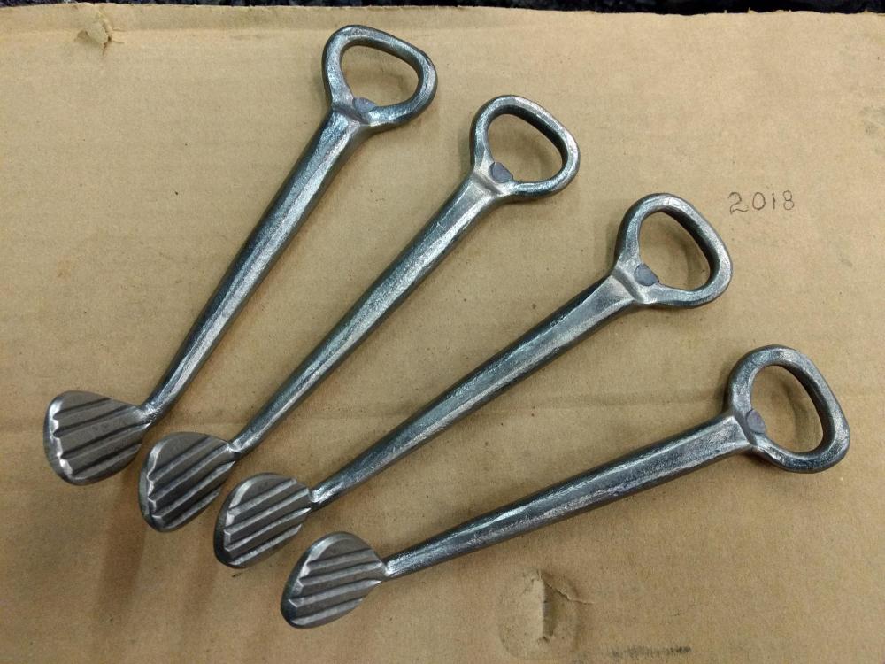

Here are the steps I used to forge the golf club bottle opener heads, which could be used for large heads for a regular club with large stock size :
(click on the picture below)
