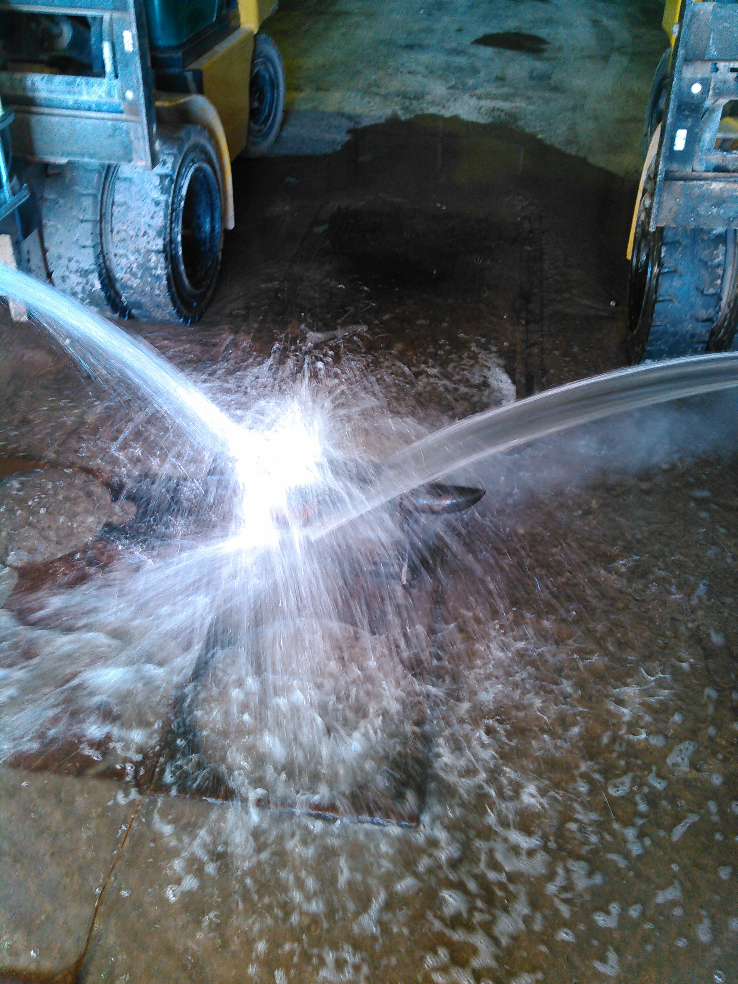

I am finally going to get my anvil done, I convinced the manager at work to let me do it there when we are slow. I am wondering if anyone has ever used a pressure washer for the quench on an anvil. I have seen it mentioned before but only as theory. Do you guys think it will work or should I go another route.
If you do some searching there is video of Brooks - I think it was brooks - hardening process. It was basically a large torch heating the surface followed by a high pressure water spray. If you can the video it may give you a place to start from.
Are there any near by lakes or ponds? If you know someone with a lake you could always quench there. The quench bucket should be big enough then and you have plenty of water of a relatively consistent temp as long as you don't drop it too far down.

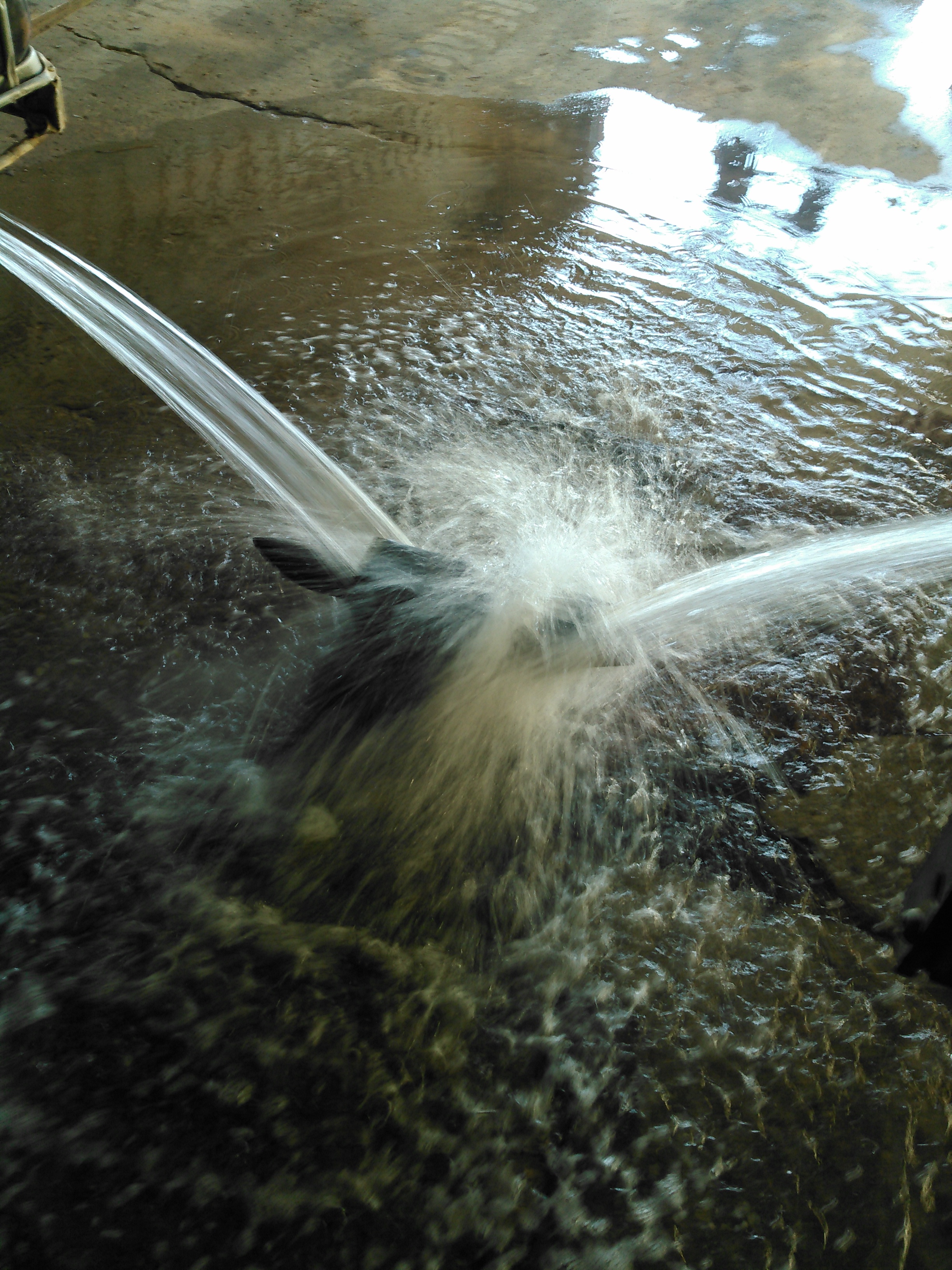

I'll check out that video, the anvil is 207lb so the pond probably wouldn't do it, there needs to be enough pressure to break the steam pocket.
Got any firefighter friends?  If you could convince them to hit the anvil with the firehose for a few minutes that would probably give you a better combination of pressure and volume than a high pressure washer.
Yes the anvil makers tended to use a good sized flume and drop the water a good distance to break the steam jacket; a pond or lake won't do it.  Most pressure washers I have seen don't have the volume needed.  The Fire department high pressure hose is a good choice and is what Charles McRaven mentions using in "Country Blacksmithing" when he re-heat treated an anvil.

I've already talked to the fire chief and he agreed to come spray it for me. I was just wondering if the pressure washer would work because I'm doing the heat treat at work in the wash bay. Just thought it would make things easier. Charles, I'm going to go ahead and try to get it done next week since we have nothing going at work. I just hope all goes well and nothing catastrophic happens to all the work I have in it so far.

Or rent a 2" trash pump and set up next to a decent size lake or BIG pond. Set the outlet hose a way above the anvil so it hits with enough velocity to wash off any steam pockets.

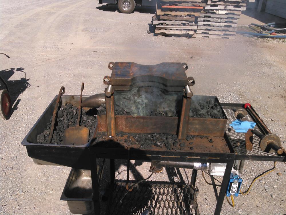

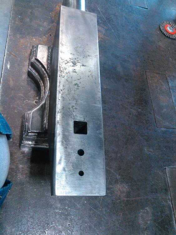

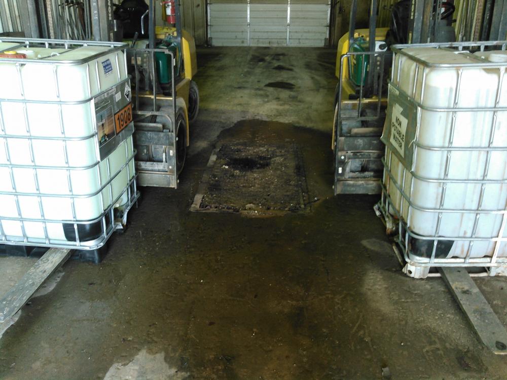

It's finally done!!!! It took 4.5 hrs to heat treat. Then after a 400 degree temper the top averages mid 60s exept a small spot at the corner of the heal at 35.
Was there a decarb issue with that corner or did it overheat during tempering due to it's thinner crossection?
I'm guessing just a cool spot cause its only about .75" and the other corner is fine and it was the same before the temper.
Looking at your heating picture I wouldn't have guessed it was a cold spot---unless there was a bit of time for cool down before the quench hit it.
Putting on the handling rings looks like a great idea, did they help?
There was a couple min of cooling time getting it off the forge and inside. The rings helped alot. I used 1" rod in the to move it around by hand and with the lift.
