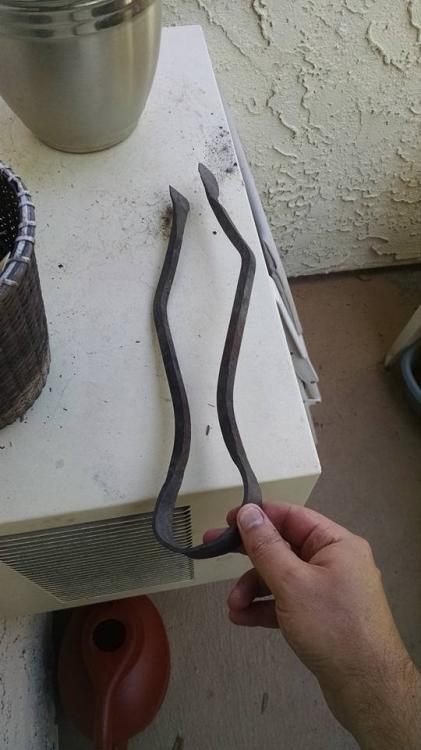

hanzosbm Posted October 9, 2015 Author Share Posted October 9, 2015 I'm sure you can mark dimensions on the anvil you are using for the day. Just make sure to "erase" all other marks so you don't get confused what marks are yours and what marks are someone elses. After all it's just chalk. That's one of the things that makes soap stone so nice. I mark and erase many distance marks on my anvil over the course of a day, depending what I'm making.My apologies, I don't think I originally understood your suggestion. Yes, I could definitely do that. In fact, I think that might be the best way to start off since I'm getting a bit lost looking at all these different hook rules. As I need to stay fairly mobile with all of this stuff, I can just toss a tape measure in my bag, mark out lengths that I'll need for that day on the anvil, and then use those marks to lay out my work. It's technically one small additional step, but it's free, easy to transport, and is a good first step while I get a better feeling for what I really want. Regarding calipers, dividers, and scribes, I'd LOVE to get a good set of all of the above. That might be round 2 of my purchases. At this point, I'm not sure that my skill is high enough to warrant checking those small figures. But, when I get better and/or start doing more finish work with either files or a grinder, they will be absolutely necessary. I might also want something that will allow me to measure given angles. For the time being with simple measurements I can go all Pythagorean on it, but later, it'd be nice to know if two pieces had the same angle bend. A lot of this came out of my very first project making a set of BBQ tongs. The necessity of getting both sides perfectly even but without any kind of measuring or marking instruments was frustrating. I have an engineering background, so my little OCD mind was going nuts knowing how I COULD make them better if I had the tools I wanted. They turned out okay in the end, but they could've been better. Link to comment Share on other sites More sharing options...

Smoggy Posted October 9, 2015 Share Posted October 9, 2015 They look like a functional set of tongs, pleasing on the eye and likely in the hand......not a bad effort by any standard for an initial forging! Link to comment Share on other sites More sharing options...
Frosty Posted October 10, 2015 Share Posted October 10, 2015 (edited) Those look like a fine pair of tongs. You're blacksmithing, forget the dial indicators. Eyeball against a couple story marks. A LOT of my work starts out marked on the edge of my anvil using one side or the other of the hardy hole or far edge of the anvil as the mark. The hardy hole gives me 4 different distances, two off the sides and two off the tail. The prichel is another but I don't use it as often.A pair of tongs like those are simpler than they look. Forge the feet first. (grippy part you snag the hot dogs with) The next step is the flattened spring section. While cool balance it on your finger and mark that spot with a chisel, center punch or if you want to be properly OCD about it, a tap on a cold hardy. Mark the spot, heat it and draw it into the flat spring keeping it even.Bend the spring around and finish shape the arms. Viola!Easier than it looks, honest. I got into smithing for two main reasons: playing with fire and hitting things of COURSE and secondly. I grew up with micrometers, calipers, height, depth, etc. gauges galore. I was probably the only 3rd. grader who could read a vernier caliper. Anyway, I like smithing because it's mark one eyeball and tactile, a quick swipe with a piece of soap stone is good enough. It was a HUGE relief.Frosty The Lucky. Edited October 10, 2015 by Frosty Link to comment Share on other sites More sharing options...
hanzosbm Posted October 10, 2015 Author Share Posted October 10, 2015 Smoggy, thank you for the kind words. I view these early projects as methods of learning certain techniques. Overall, I was pretty happy with the tongs, though now, I certainly see room for improvement, but that's the idea. Frosty, you're right, it isn't a terribly difficult project to get done, but the devil is in the details. For instance, keep in mind that I had no soap stone, so while drawing out the center, the point of balance constantly changed. And trying to balance it while hot isn't easy and constantly quenching to check was a time suck. The bigger problem, however, were the arms. Knowing how far down to make the first and second bends as well as to what angle to make them to ensure that they were symmetrical purely by eye wasn't easy. I would've liked to have been able to at least mark the metal at arbitrary, equal point for bends. Even drawing an outline on the anvil to try to match would've been nice. I understand that the concepts being taught don't require the finished result to be perfect, but like my grandfather used to say, 'if it's worth doing, it's worth doing right'. Link to comment Share on other sites More sharing options...
Frosty Posted October 10, 2015 Share Posted October 10, 2015 You can notch with a file to mark or even scratch with a rock though that's pretty hard to see. Once you start drawing the spring section you don't balance it on your FINGER. <sigh> Use a piece of 1/2" sq. it's flat so you're not working to microscopic precision but narrow enough to be pretty accurate.Once the spring is turned make sure the tips meet evenly. Open the vise jaws to the arms just slip between them. Heat the arms where you want the outward bend slip them into the vise and spread the arms. Select an inner form the width of the wide place. Heat that part of the arms slip it over the new die and bend them till they're what you want.If you're making a run then bend specialty bending forks for the hardy hole, one to open, one to close. the trickiest thing then is remembering to lay them in the right order for the next tong.Frosty The Lucky. Link to comment Share on other sites More sharing options...

hanzosbm Posted October 10, 2015 Author Share Posted October 10, 2015 Agreed Frosty, but at the time, the only tools available to me were that one piece of steel, the Forge, the anvil, and my hammer. Thomas, you make a good point, a center punch might be a good thing to pick up as well. Link to comment Share on other sites More sharing options...
