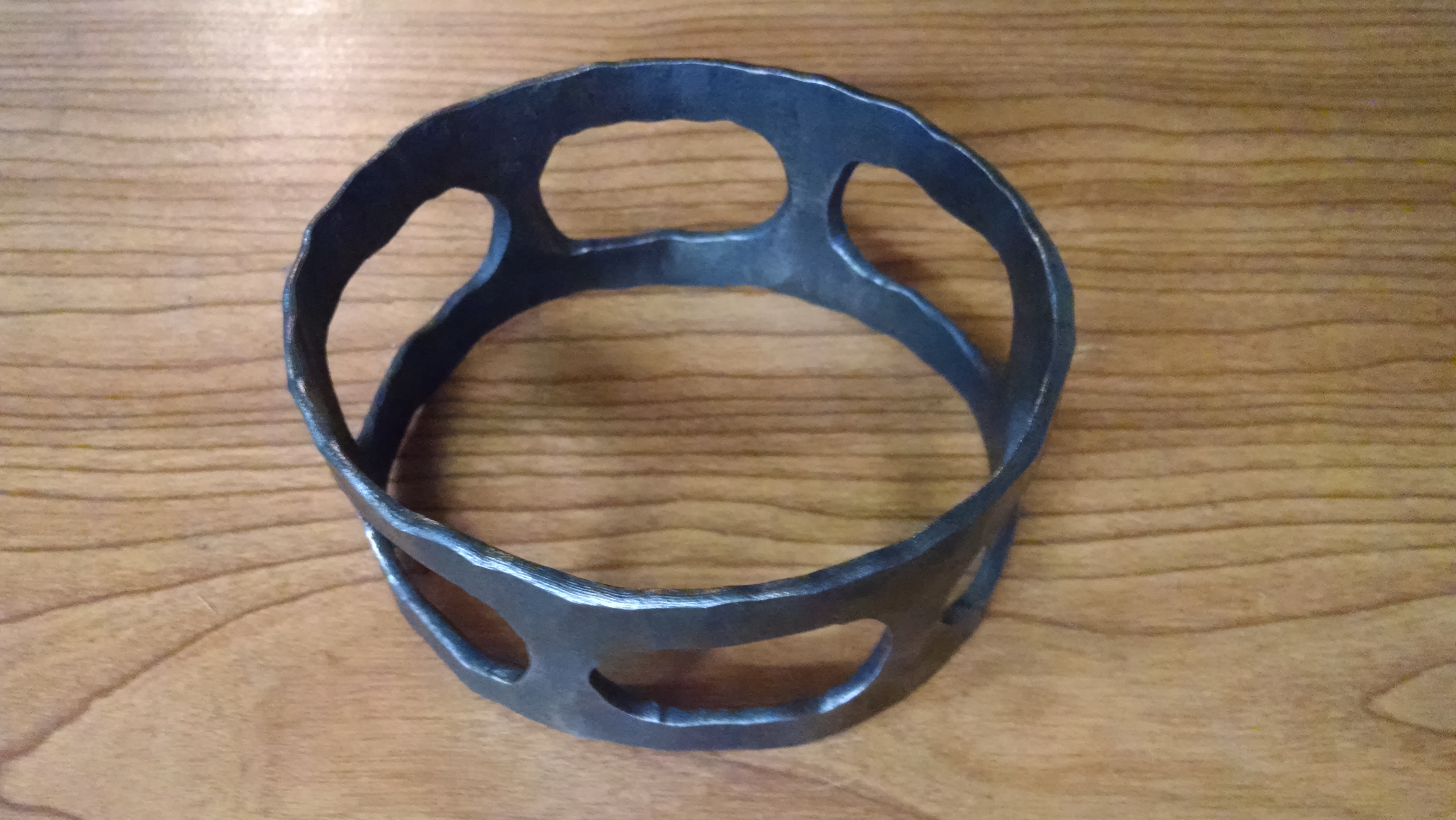

JHCC Posted September 16, 2015 Share Posted September 16, 2015 I have a retaining ring from the inside of a ball joint that I'm hoping to turn into a bracelet for my daughter. Quote Link to comment Share on other sites More sharing options...

JHCC Posted September 19, 2015 Share Posted September 19, 2015 I have a retaining ring from the inside of a ball joint [edit: actually a CV joint] that I'm hoping to turn into a bracelet for my daughter.And here it is! Quote Link to comment Share on other sites More sharing options...

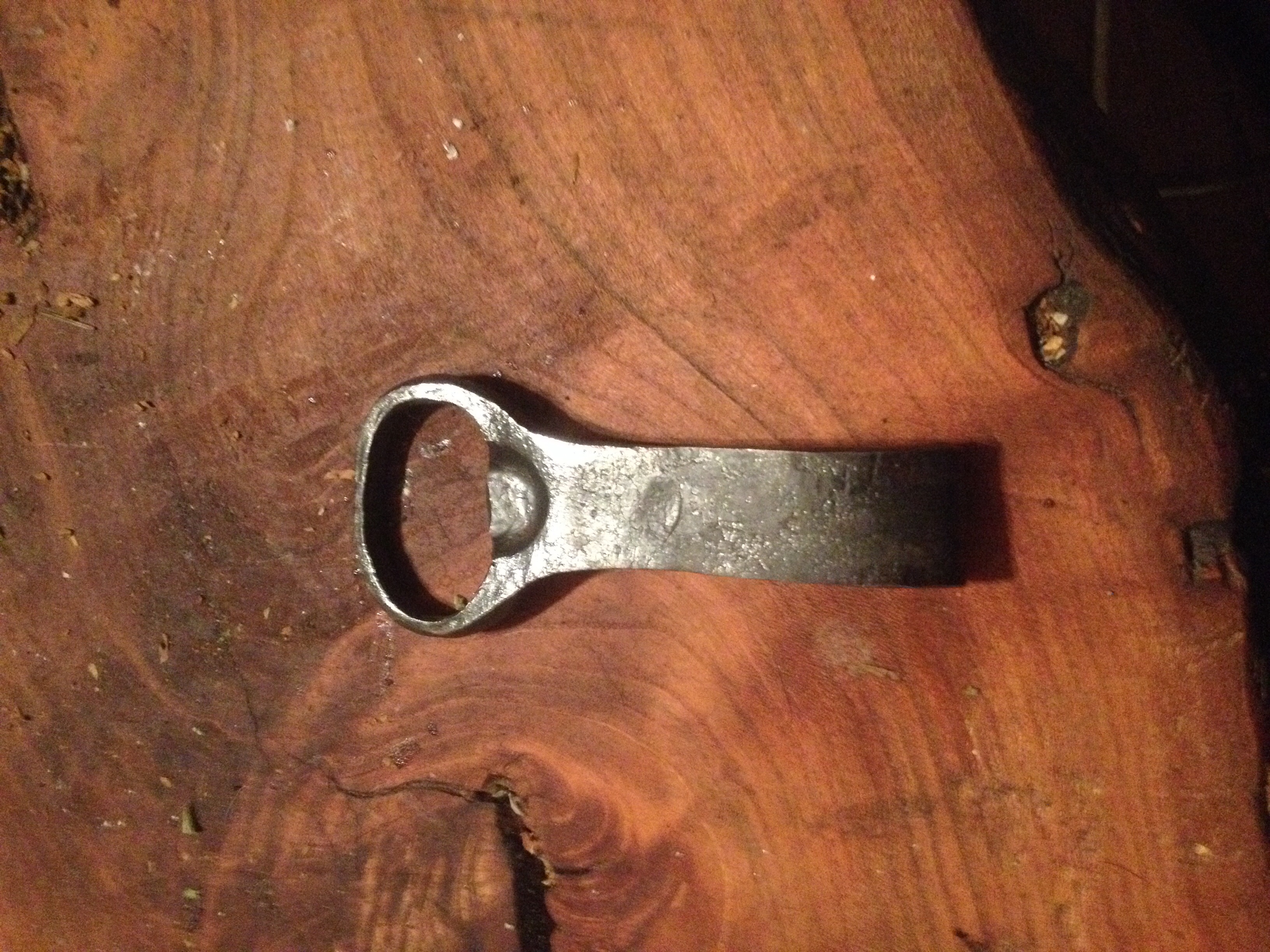

MrDarkNebulah Posted November 28, 2015 Share Posted November 28, 2015 Im planning on trying to make some bottle openers out of railroad spikes. The only problem is I haven't made anybottle openers before. I have watched a few videos on it, yet I dont have an actual anvil (I use a big lump of cylindrical steel) so I cant widen the hole like that. Any tips on it? Im hoping to make something like this: Quote Link to comment Share on other sites More sharing options...
DSW Posted November 28, 2015 Share Posted November 28, 2015 I drift my openers vs opening up the ring on the horn ( still working on getting that down). You can make a simple pritchel plate by drilling various size holes in it and using them to drift open the hole. I use the small pritchel on my anvil to punch the hole ( though you can drill it with a drill or even slit it with a chisel instead). I drift to about 1" on my swage block simply because I have it. If I didn't, I'd make a pritchel plate to go over my "portable hole". Arkie here suggested slitting vs punching the original hole and I've found that useful when I don't have as much material to make the ring. I can't remember if the RR spike opener I made I slit or punched. I know I upset the point to drive more mass up into the ring area before I did anything else. I've also found knocking in the corners 1st helps, I was fighting getting the ring round before I did that. Quote Link to comment Share on other sites More sharing options...
NickOHH Posted November 28, 2015 Share Posted November 28, 2015 Hmm.... I drift mine about half way then use the horn to finish it , if the hole isn't centered exactly I can work the high spots to keep it even then work it back round at the end. Quote Link to comment Share on other sites More sharing options...
