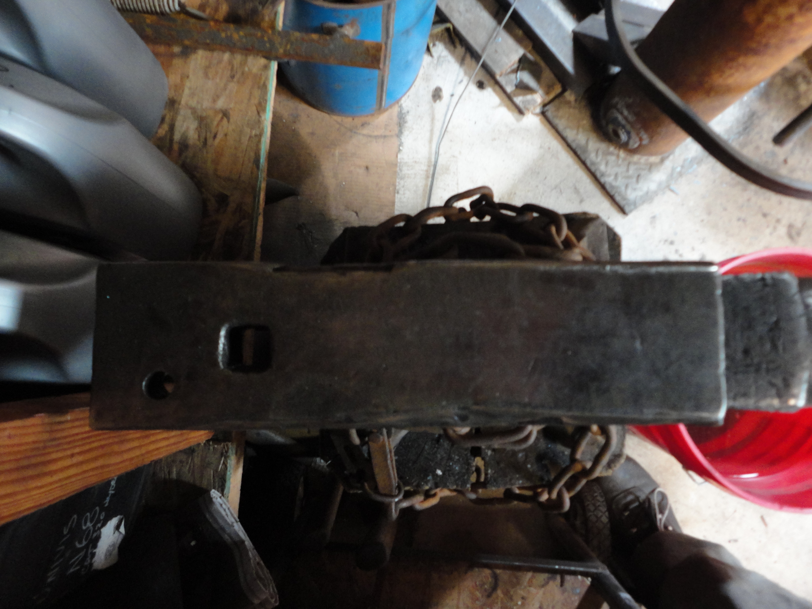

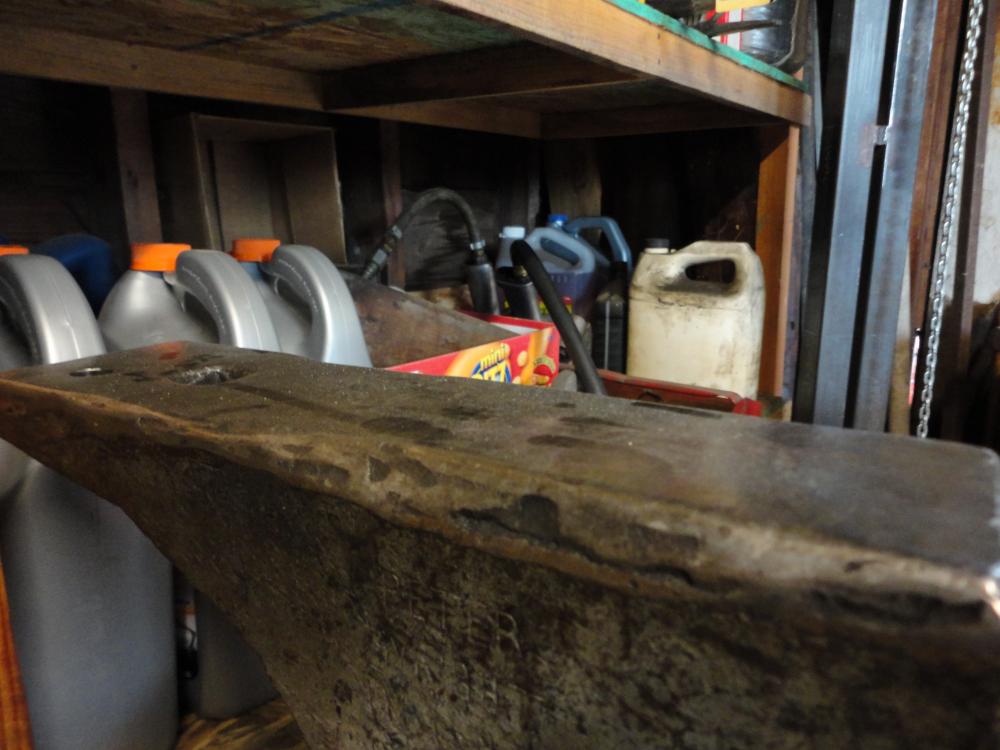

Zyphiza Posted September 4, 2015 Share Posted September 4, 2015 Hey this is the first anvil I have ever bought I found it in a scrap yard I've been using a small section of railroad track and have been waiting for the right anvil to come around I think I got an okay price it's a bit beat up though I got it for $275.00 I think it's around 300 pounds I estimate, is there any way to tell roughly what it weighs by dimensions? I don't have a scale capable of weighing it. I don't know too much about them but it has good rebound though. the face is about 18.5 inches long, the horn is about 10 inches long and the cutting table about 3 inches and the anvil is 13 inches in height. I believe whoever owned it before I rescued it may have welded a new top onto it you can see what looks to be a weld line (I believe) in the photo showing the height, would that effect it at all? Thank you to anyone that helps (: Also it's about 5inches wide forget to add that. Quote Link to comment Share on other sites More sharing options...

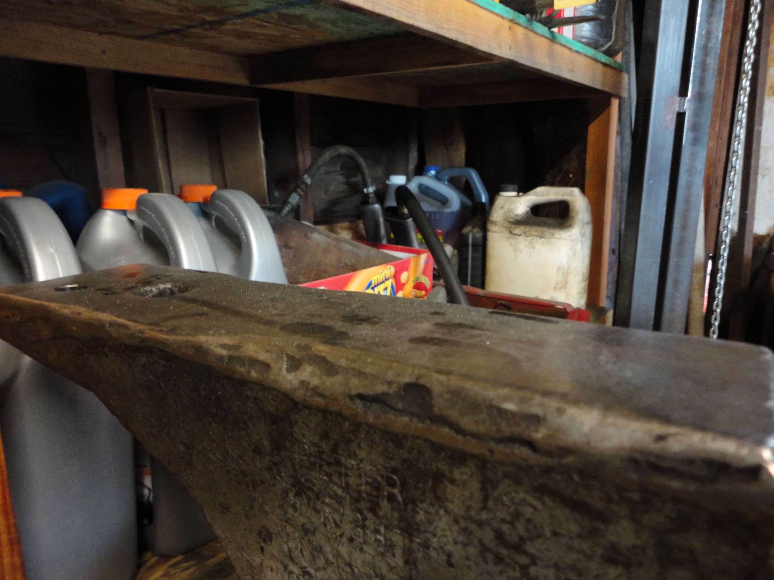

Zyphiza Posted September 4, 2015 Author Share Posted September 4, 2015 few more photos maybe you can help me identify who's made this Noticed paint was covering up a lot of it.. better picture Quote Link to comment Share on other sites More sharing options...
Zyphiza Posted September 4, 2015 Author Share Posted September 4, 2015 On the left side of the anvil there is also the number 38 not sure what it means but maybe it will help out, looked for markings around the feet but didn't have any luck Quote Link to comment Share on other sites More sharing options...
Kevin Olson Posted September 4, 2015 Share Posted September 4, 2015 That should say Hay Budden above whats there. Good anvil. And whats up with the bottom. Looks like a mold thay has not been filled completely. The bottom of mine is kinda like that but only on one end. Hope some here has an answer. Quote Link to comment Share on other sites More sharing options...
yahoo2 Posted September 4, 2015 Share Posted September 4, 2015 At a guess I would say it was owned by a farmer who had no forge. there are dents from cold steel, oxy torch cuts and a chisel mark. It looks like it has not been used much. Quote Link to comment Share on other sites More sharing options...
Zyphiza Posted September 4, 2015 Author Share Posted September 4, 2015 picture of the 38 and took a second look around the feet found more numbers Quote Link to comment Share on other sites More sharing options...
Judson Yaggy Posted September 4, 2015 Share Posted September 4, 2015 Yup, Hay Budden. Face around 5"wide should be 300+ pounds. For that price you stole it! Ignore the chips and gouges, it's more than big enough and nice enough to have plenty of workable area. Quote Link to comment Share on other sites More sharing options...

clinton Posted September 5, 2015 Share Posted September 5, 2015 You did goodHere is a little info on your anvil from Anvils in America- The serial numbers 170001-180000 were manufactured in 1910. The # 38 stamped toward the heel is a steel heat number used for quality control.The base is forged wrought iron what you see are lumps of wrought that were forged together not cast. The weight should be stamped under the logo often hard to make out. I have a Haybudden that has no visable logo left lots of chisel marks. Quote Link to comment Share on other sites More sharing options...
Zyphiza Posted September 5, 2015 Author Share Posted September 5, 2015 I see a 2 and what looks to be an 8 or a 9 after that the last number is completely gone so that means I have a 280 or a 290 pound anvil? that's awesome Quote Link to comment Share on other sites More sharing options...
Zyphiza Posted September 5, 2015 Author Share Posted September 5, 2015 Not sure if this means anything but I believe it's an upside down 5? Just noticed that lol. Quote Link to comment Share on other sites More sharing options...
notownkid Posted September 5, 2015 Share Posted September 5, 2015 after a win like this I'd be buying some lottery tickets tonight you are LUCKY this week. Quote Link to comment Share on other sites More sharing options...
Zyphiza Posted September 5, 2015 Author Share Posted September 5, 2015 Also curious, I'm thinking about maybe fixing all the torch marks and fixing the edges, I know this has to be done with tool steel welding rod and pre-heating the metal before welding, would this destroy the hardening of the steel? would I have to re quench it because if so that's a job a bit larger then what I can handle. Thank you. Quote Link to comment Share on other sites More sharing options...
Dogsoldat Posted September 5, 2015 Share Posted September 5, 2015 (edited) Honestly, the edges are a long way from any need to be fixed. More harm than good. My Peter Wright has far worse edges but it still works great for most things. Use it for a year or two and then see if those torch cuts are still a problem. Edited September 5, 2015 by Dogsoldat missed my pics Quote Link to comment Share on other sites More sharing options...
arkie Posted September 5, 2015 Share Posted September 5, 2015 DO NOT DO ANYTHING TO YOUR H-B BUT USE IT!!! It's in great shape and any grinding, heating, welding will only be negatives for your anvil. Hay Buddens are a very high quality anvil and you got a great deal on yours. Welding is probably the worst possible thing you could do to it. The edges are in great shape; they don't need anything done to them. The most I would recommend is a light wire brushing and some linseed oil to stave off future rusting, but that's all. Have fun with it! Quote Link to comment Share on other sites More sharing options...
BIGGUNDOCTOR Posted September 5, 2015 Share Posted September 5, 2015 Don't worry about the torch marks, just work around them. That anvil is perfectly fine to work on in the condition it is now. Quote Link to comment Share on other sites More sharing options...
