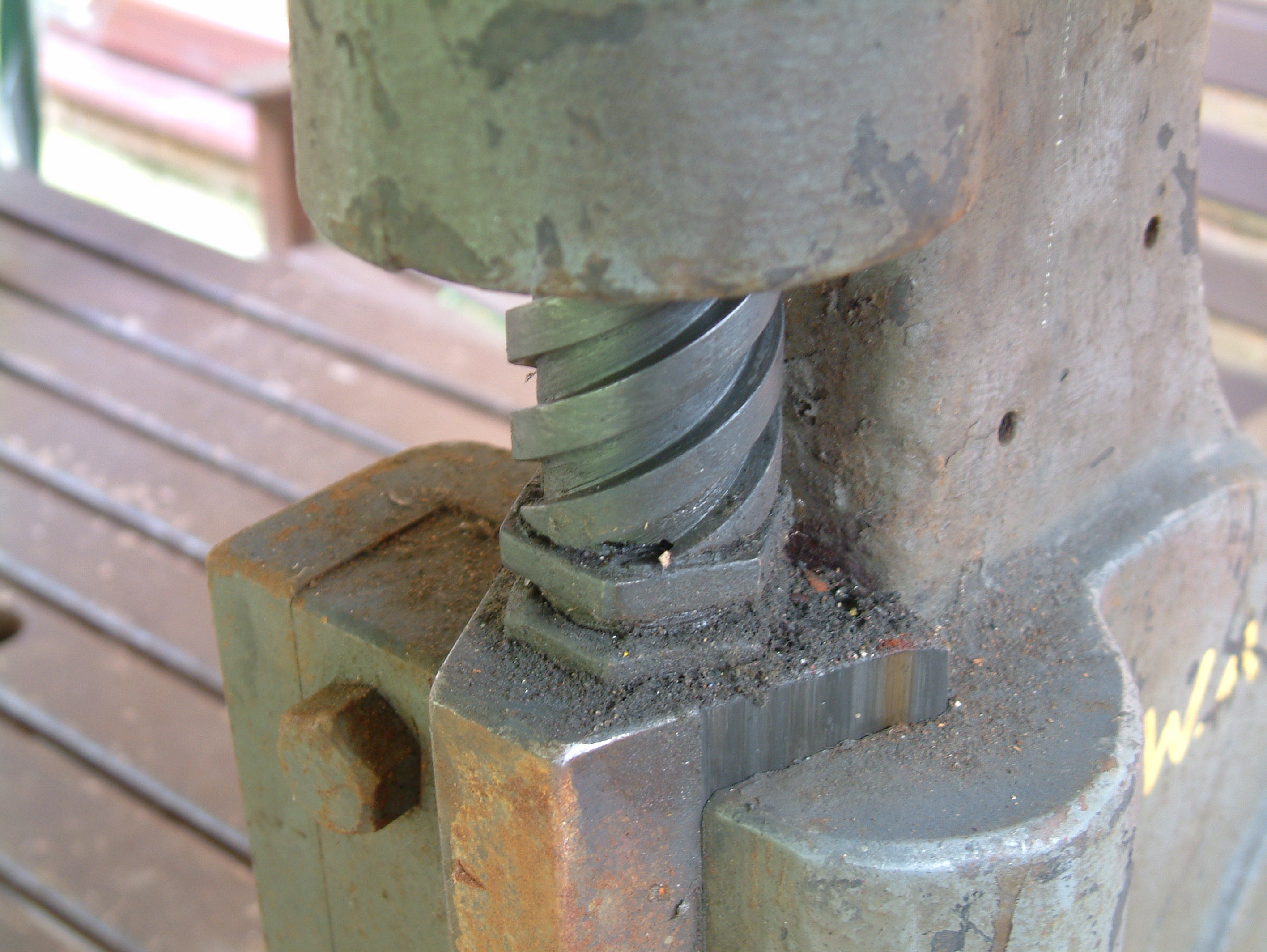

Purchased this fly press yesterday,
on getting it home found that the ram as a threaded tool location approx 11/16"  and not a 1" hole and locking bolt.
What your thoughts on drilling out to 1" and adding a tool locking bolt ?
Regards Paul

that may be a piece inserted into the normal hole, check first
also in your last pic it looks like a small grub screw at the back, remove the block and inspect it further
Thank you all for your sound advice after which I will certainly take it slowly and not rush into a hasty decision.
I will clean it up and see if there  is indeed a grub screw as iron dwarf close observation suggests .

I have strip it down and found :-
                                                  The screw shaft and locking collars are very good condition
                                                   The slide adjustment and locking bolts will need replacing.
                                                    There is some slight scoring on the slides and ram due to grease being used as a lubricant and not being cleaned regulary
 The ram lower thread is well beaten up internally through I suspect being used with loose fitting tools .
So I will clean it up replace faulty parts fettle scoring and lastly drill out the ram and drill and tap for top snap locking bolt.
Oil the slides and fabricate a new  handle . when purchased it came with two balls and no handle,   poor boy.

Well I have managed to sort out my No 3 fly press the no is stamped on the ram see photo with chalk circle " photo's a bit poor sorry" made a handle out off 1 inch bar .
Drilled the ram hole out to 1 inch . to take tooling .  it doe's the job.
