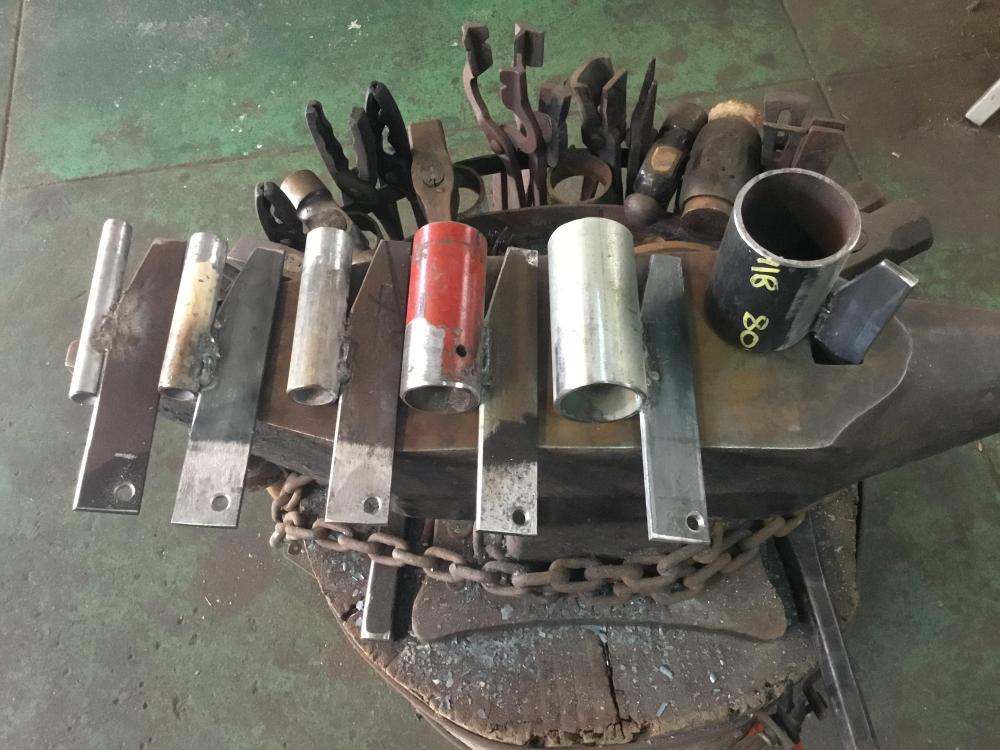

  1. Made out of scrap, various jigs for hooks or similar. The v slot makes them available for various gauges of rod, the support is able to be mounted in a vice or hardy hole. The hole in the bottom allows them to be hanged for storage

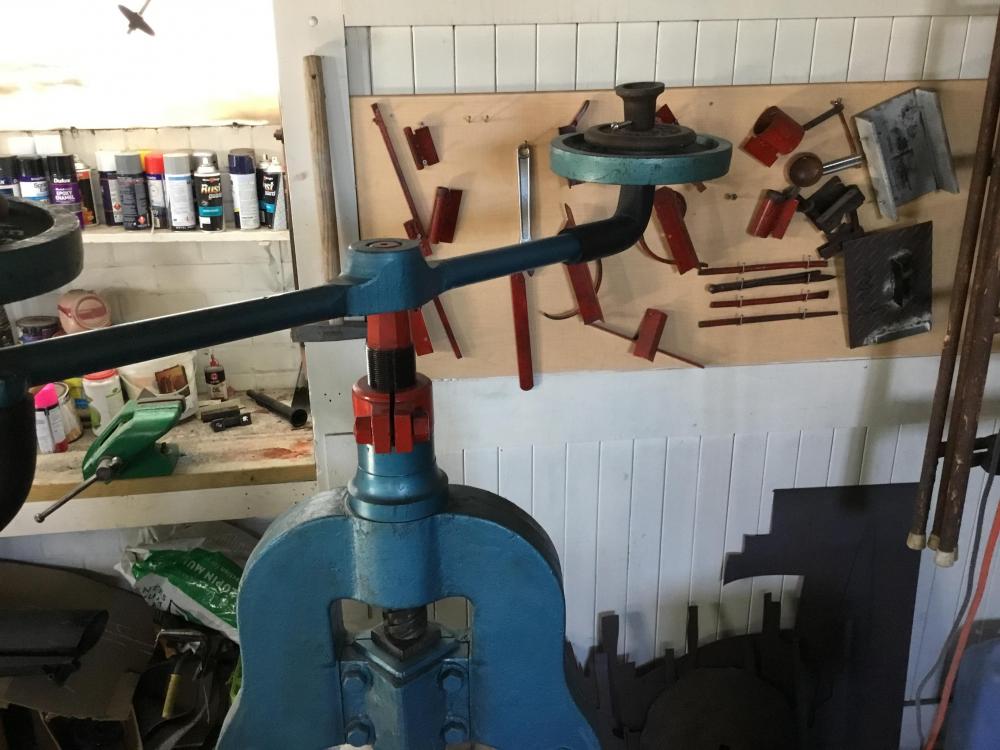

  9. Caotropheus My flypress came without ball weights also (where do they go?) I added barbell plates all I needed to do was file some corners into the holes and Bobs your uncle I have since added some more for grunt and it would be easy to swap for bigger plates. I put the securing bits on but it probably doesn’t need them, also added some rubber pipe insulation to save my head.

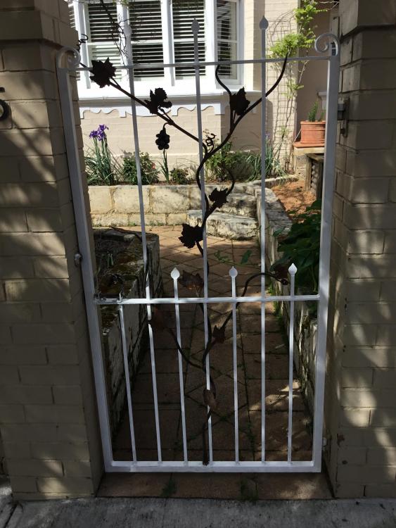

  10. Thanks, the leaves are starting to rust and aren’t very dark just poor photography.

  12. I had a pretty ordinary gate, works well but I wanted to make it more interesting. I have four fence panels that need some character, any suggestions?

  16. I filed some corners into some exercise weights. I already had them so no cost but they are easy to get. The barbell clamps secure them nicely. I am building a stand to get it off the floor.
