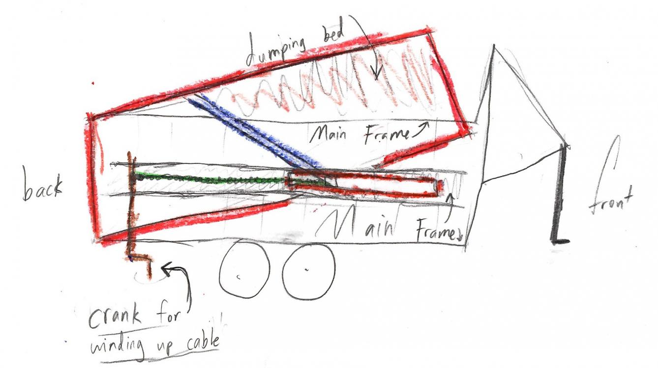

Perhaps in an hour or two I can get some pics. (supper first!) the trailer bed is close to 10 ft long--I forget exactly. Since my previous lifting mechanism, which failed, was complicated perhaps I can get a diagram together here soon. I had no plans or anything when I made it--it just sort of came together in my head, I guess. Thanks again for your help and interest.

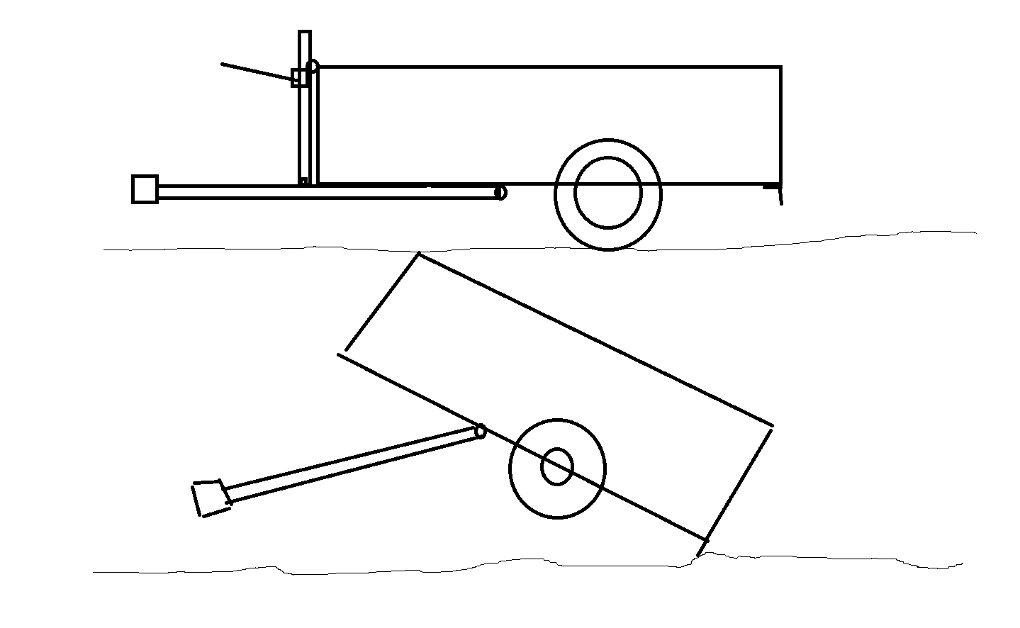

So, here is probably the most interesting and horrible and confusing technical drawing you have ever seen! At the worst, this will provide you with your day's laugh! This is a diagram of my previous lifting mechanism that failed.
First of all, there is the actual dumping bed, outlined in red. Then, underneath it and attached on a hinge in the middle (not shown correctly) is a thick-walled pipe, outlined in blue. Attached to the other end of the pipe, on another hinge, is a base which runs back and forth in a track, outlined in orange (looks like red). Then, attached to the base in the track, is a cable, outlined in green, which is wound up around a crank, outlined in brown. So, if you can visualize everything, when the crank is turned, it winds up the cable, which pulls the end of the pipe in the track forward. Then, the pipe pushes the bed upward, making the whole process work like a hydraulic cylinder. wagon_diagram.thumb.JPG.466510e20482c906

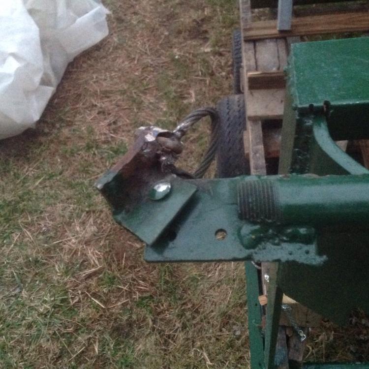

The reason this didn't work is because the cable wasn't attached well enough to the base that ran in the track. And so under heavy loads, the cable is always under strain, and it was pulling loose from the base. I had welded wire rope clips to the base and then the cable went in the clips, but the strain from a heavy test load was pulling the clips off, despite my welds. Also, the crank was terribly hard to turn with a real load. I'm sure this is probably pretty confusing, but some pictures of the real wagon might help. They're coming soon.

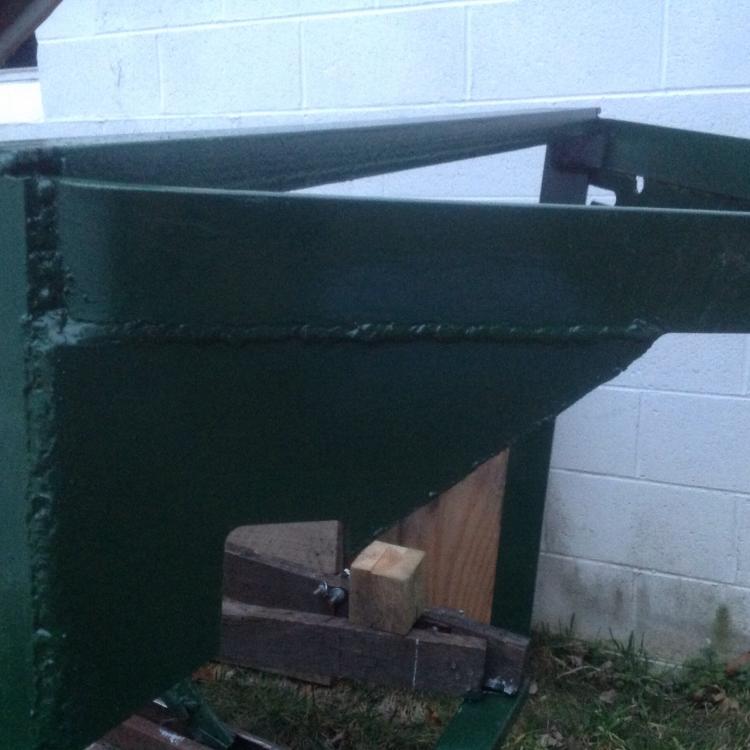

here are some pictures of this wagon. this is a close-up of some welds on the goose-neck hitchimage.thumb.jpg.05f59caee1278feafc5e4ec6

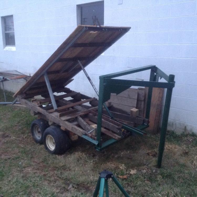

this is the wagon with the bed raised. the tubing on the left is just holding it up--it's not part of the lifting systemimage.thumb.jpg.2ce8dc0ed0826317b953f2cc

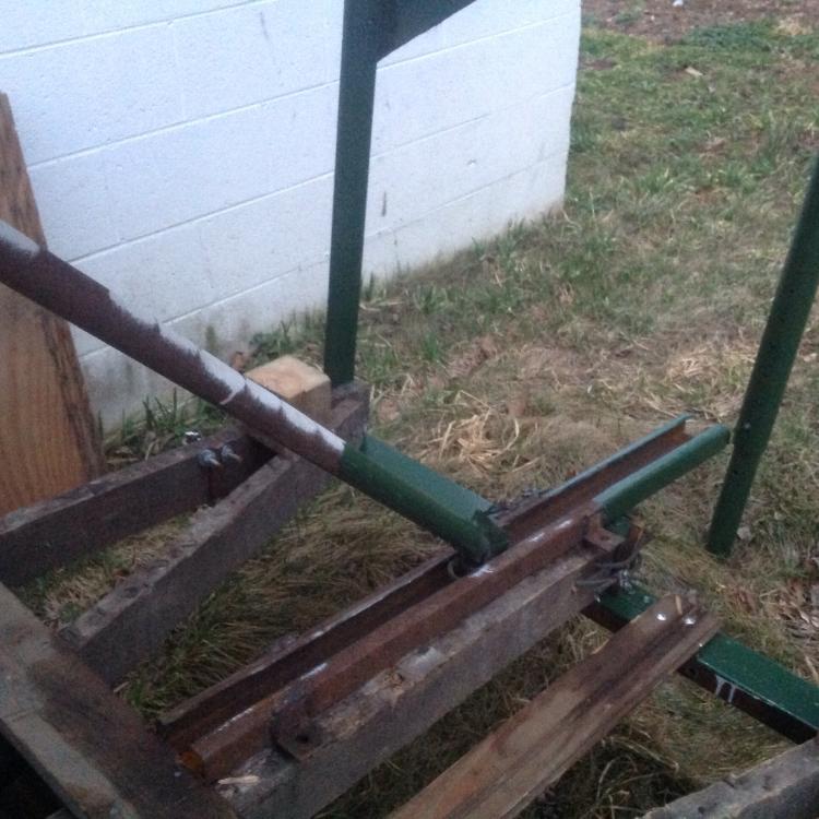

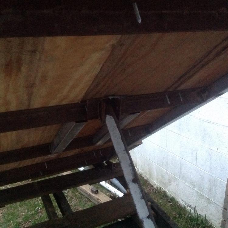

this is the pipe on the hinge on the bottom of the bedimage.thumb.jpg.2a632775e246ba8065039936
this is the track the base of the pipe runs in. So, the main pulling cable is attached to the little loop of cable you can barely see inside the track, and then that main pulling cable is wound up around a crank, pulling the pipe forward and making the bed go up.image.thumb.jpg.a7c4d83ee92d74f593a91397
Then, here is the base itself, also hinged on the pipe. You can kind of see that the cable clip is breaking.image.thumb.jpg.5c1103bdb2ef1d416c51fb98

I applaud your efforts so far on your trailer build.. Indeed a learning project., I will offer my 2c.  Your fit up to the wood frame from your 5 th wheel design createds a sheer point and the bolts holding the unit to the frame is a weak point.  I suggest forgetting about the dump feature and consintrate on firming up the structure..  It is a big mouse trap please proceed with caution..  Keep arms and body away at all times..  Just an ol boys 2c

Good Morning Tony,
You have created a "Widow Maker" or in your case, a "Death Trap".
At the very minimum add 2 stiffners from the front of the frame to the point of where your hitch connects to the hitch. The way you have it, is a major accident waiting to happen. In the world of tractors, you "MUST PULL THE LOAD FROM BELOW AND IN FRONT OF THE CENTER LINE OF THE DIFFERENTIAL"!!! If you are connected to the standard hitch at the rear of the tractor and you have a heavy load or a load shifts, you have the potential of flipping the tractor back onto the trailer, with you in between. Many smart people are no longer with us, because they overlooked this function. You may have a love/desire to have a fifth wheel, but you have NO STRENGTH in your hitch.
You want to make it dump, what I see is the potential of you getting squashed, between the dump and the frame. You will be cut in two, like scissors.
I have seen and I have survived flipping a tractor, It is scarey!!!
Your life is not worth the experiment of designing a scissor lift. Leave the trailer flat until you have saved up enough money to purchase a proper engineered scissor lift.:(:(

​You have gotten some good advice here....you really need to listen. You need to step back from your project for a few minutes and try not to see the whole trailer but rather it's parts;
1. The frame. Lets start here. Shorten the frame to just behind the back axle. Mount your hinge there. Move the bed mounted part of the hinge forward. This will greatly reduce the force required to dump. *Important* If you make this modification you must now have a way to pin the bed down.
2. The hitch. Eliminate the gooseneck. It literally is a deadly accident waiting to happen. It is unsafe in too many ways to be fixed and it is useless and counterproductive. Pretty much inviting natural selection to occur. You are a thinker, you just don't have enough experience yet to be able to design structural elements. I highly suggest you turn your investigations toward the study of applied mechanics, physics and mechanical engineering. We don't want to lose you. Especially if you want to carry firewood. If I thought it would just gently fold down upon itself, I wouldn't be saying anything. That thing is going to fail under shock load, and there will be energy released when it fails. The amount of energy in just 1/2 a cord of green firewood moving at 3 mph will astound you. Did you know that steel is highly elastic? Just before the welds snap, the component parts will bend like springs, storing energy like giant capacitors and releasing it as the welds snap. You will be sitting directly in the path of all that, and helpless. Please don't let this happen.
3. the dumping system. This was covered by Glen, as well as the notion of balancing the load over the pivot point. His description is pretty much the way to go here, with the possible exception of swapping out the block and tackle for a small hand winch such as a boat trailer winch. Even these can be dangerous by the way. My own brother smashed his hand to broken bits when a hand winch failed under too big of a load and the out of control handle failed his hand. He massively overloaded the winch though. Think the winch will be slightly safer than a block and tackle but either way, that is how this situation is usually tackled.

I have to second Arftist, scrap that design and start over. This one has too many design flaws to fix and they're catastrophic failures on short fuses. I THINK that's a dead horse but let me know if it needs more beating.
The easiest tilt bed ATV trailer I know if uses the axel as the bed pivot. The tongue is basically a straight bar from the hitch to the axle. The trailer frame and bed use the wheels as the hinge so there is NO hinge weak point. As the frame drops to horizontal or haul position it slots over the tow bar and pins providing the hips that prevent it torquing sideways. Well, okay there IS a hinge pin but it's at the end of the tow bar and consists of a single heavy pin at the center of the axle and is only under stress when towing. The bed's weight and any side motions are all riding on the wheels as it dumps so the hinge pin can wobble and not be stressed.
This will cut the weight of the trailer better than in half. Remove the bed hinge as a weak point. Make it EASY to dump and seat to haul. Safer still, the pinch point is under the center of the trailer, a person would have to TRY to get pinched and seeing as the easiest way to dump it is to stand on the rear corner you ain't going to be under a loaded trailer. If you get yourself pinched laying the empty down you need to find safer things to do.
Oh yeah, the unladen balance point is less than 1' forward of the axle to provide adequate tongue weight without squatting the ATV down.
