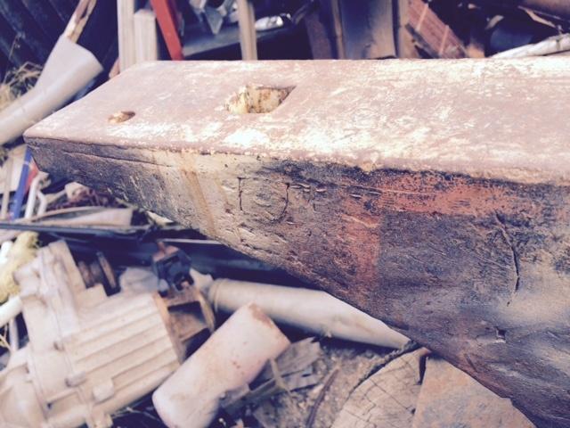

I'm new here and this is my first post.  I ran across a 199# Arm & Hammer.   The present owner got it 50 years ago.  It was once in a shop fire and was glowing red.  There's what appears to be some sort of defect on the side just below the Hardy hole.  You can see it in the second picture, it's a square area with a crack around it.  Does anyone know what this is?  Possibly it could be some sort of square bar attached to the top plate to help it bond to the anvil body?  I don't know if it will have any affect at all on the usefulness of the anvil.
I ran across it unexpectedly so wasn't prepared to do any sort of ball bearing or hammer bounce tests.
I'd sure appreciate any comments anyone may have concerning the square cracked area, or any comments on the anvil in general.

Welcome aboard Bob, glad to have you. If you put your general location in the header you might be surprised how many of the IFI gang live within visiting distance.
It was glowing red in the fire? If so the temper's run, basically annealed and about as soft as it can be. Not knowing where you are I don't know who to recommend you contact about heat treating. That's one of the rare instances an anvil really could use "fixing."
I don't know about the squarish mark in the side, it might be slag inclusion or an affect from the fire. They're cast bodies with a foundry welded high carbon steel face. I can't think of a reason for something like that in the casting.
She's a beauty I hope we can find someone with experience heat treating an anvil and get her in fighting trim again.
Frosty, A&Hs had forged wrought bodies, not cast.  You might have been thinking Fisher.
 Every time I think about tempering an anvil I get this grand vision I my head of a boom pole mounted to the back of a speed boat, a bon fire on the beach, a 12 volt air mattress blower and several brown bottles.....maybe on my bucket list..I don't know..
 Anyway, back on topic, maybe. I have an A&H 100 lb. that I use in the shop I really like. Take this for what it's worth....when I go to a meeting or another shop to work, I find my self fumbling around some on a different anvil. I guess that thin heel kind of  spoils me at home. No big deal just my lack of experience. Am I alone on this ? There is just some things I do, that feel normal on that nice thin heel.          Dave

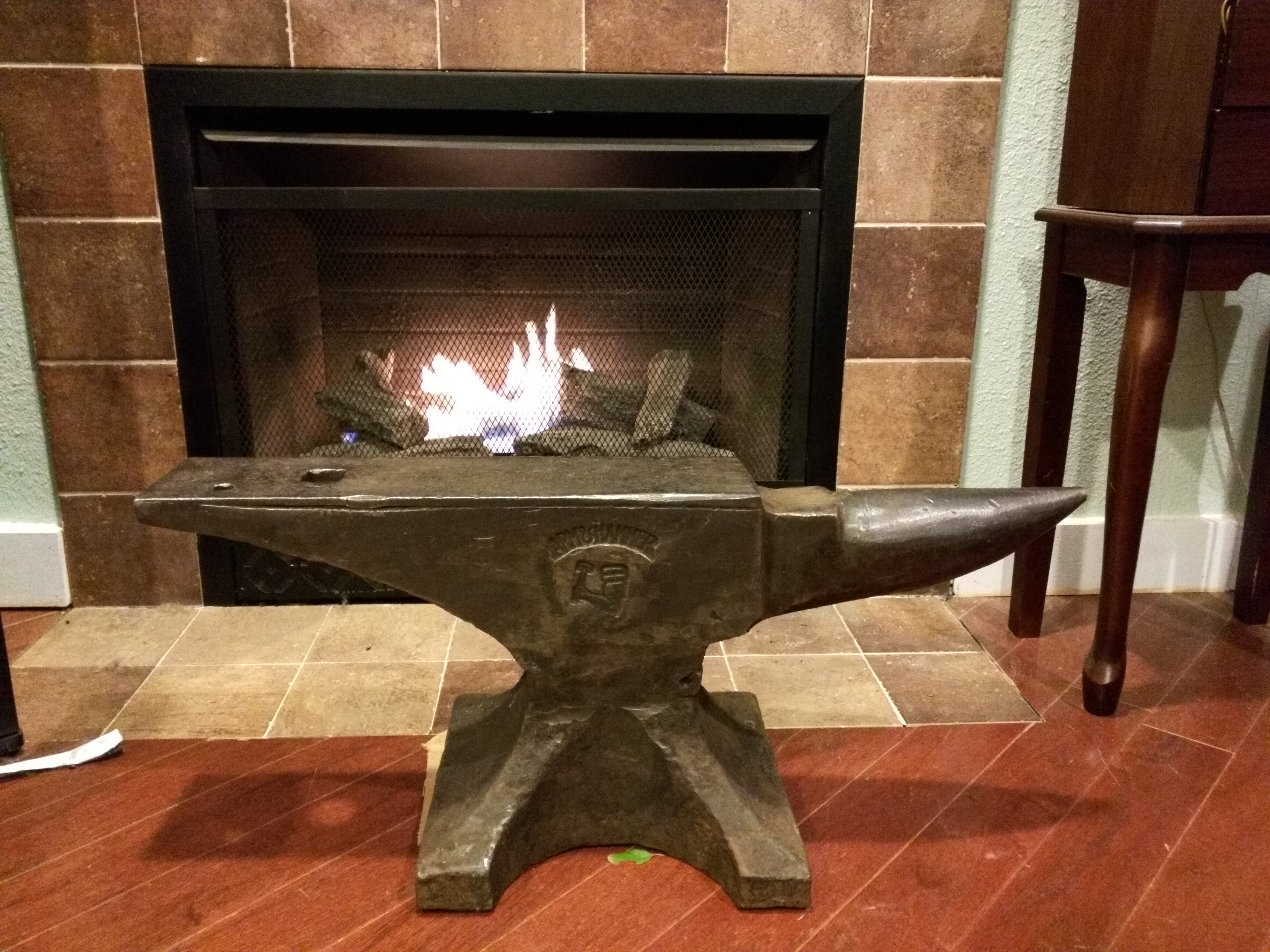

After reading AIA and the reviews here I wanted a arm & hammer and came across this in a trade it's a 150lbs number 49,XXX something, chilling in my living room for now, till I get my own shop.
