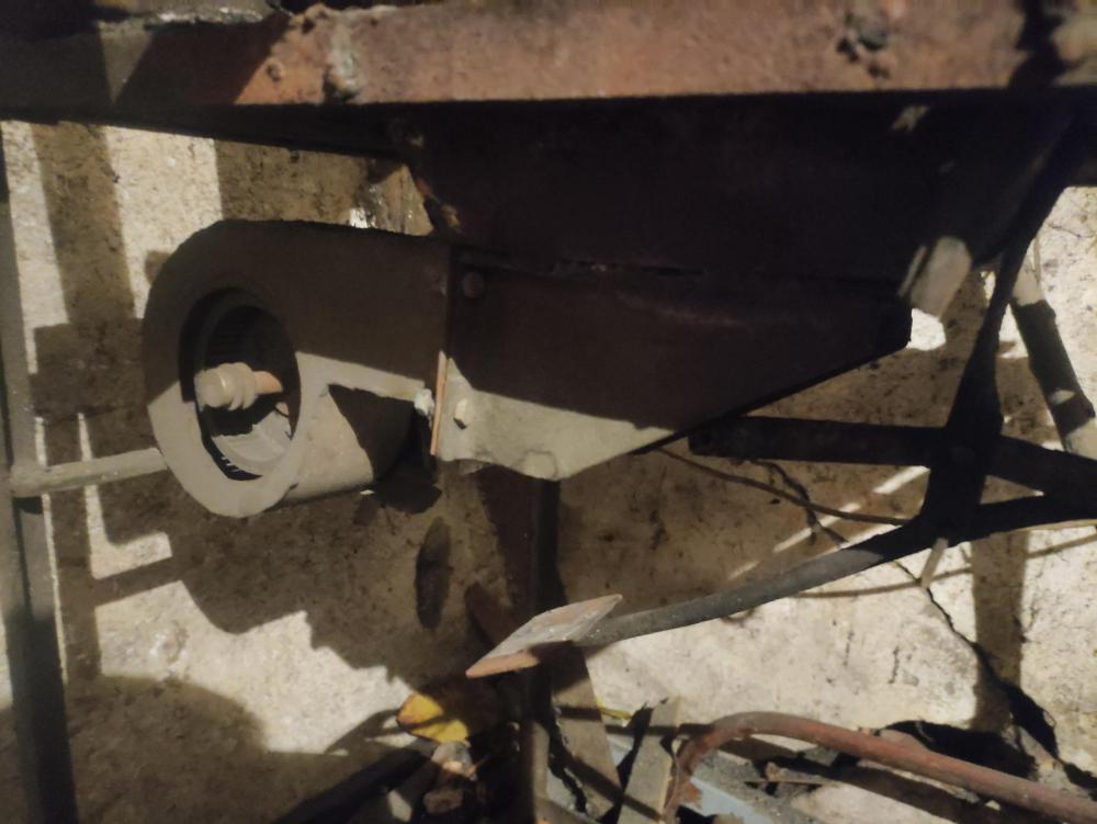

I have a very large bellows and five mall holes (just under 3/8")  in the tuyere plate and they plug off frequently from clinker. So that statement concerning small tuyere holes and high air pressure won't apply to my forge. The fact that I opened up the tuyere plate and it functions much better, is a great relief  to my operation.
I love bellows, I burn up stuff with a blower if I'm not carful if you have a deep enugh fire a bullet grate is nice for a smaller fire.
The fan allows me to have both hands free and I can do other things when the stock is heating (Yes I also burn things if I am not careful). The design of my tuyere is such that I regulate the flow just there. Thus I have the highest airspeed in the tuyere and nothing falls down in spite of it being a bottom blast. Advantage: no tuyere block, disadvantage: clinker must be fished out.
