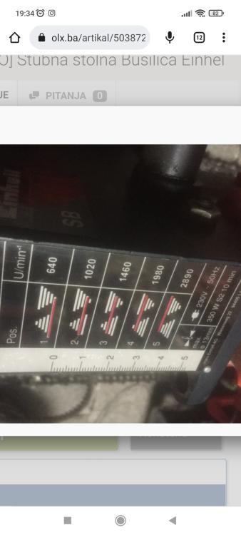

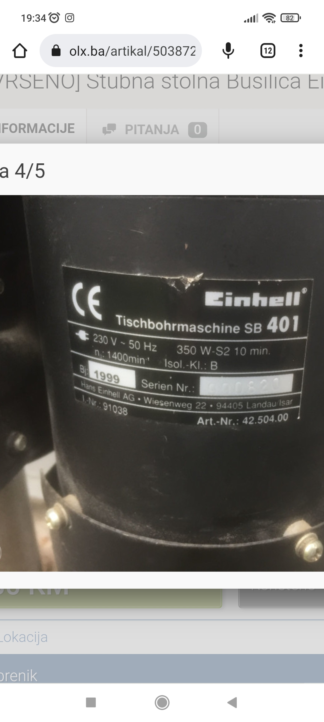

I bought used drill press but Ian not familiar is it to weak for metal to drill with it.
It sometimes get stuck when drilling holes in hardened steal, is this drill press for woodworking or it is a little bit weak.
I saw videos that you can change conductor on it so you can make motor stronger.
It does not have too much torque I can If I use force stop it
Maybe there is some issue with motor if it's weak or maybe conductor ,maybe it's designed for that purpose
I tried to drill steel with 9 mm drill bit less then half inch hole
Those just aren't very strong drill presses, stalling them is pretty easy. I have one with a more powerful motor so the belts slip if the bit wants to jam. When that happens turn it off and carefully turn the drill bit backwards to release it. It won't chip the bit that way. Just lifting the handle to free the bit chips the edges of the bits, sometimes too badly to re-sharpen.
  If you have a weak drill press, the only way is to start very small and step drill your way to the size you need.  I have boughten used angle grinders like that at junk shops or in lots at auctions.  You just have to accept it and adapt.  I suppose an inventive person with time to spare could adapt a bigger motor to it.
So it can work for knife holes and something small, I will see to use it for that and use it for wood.
I would be looking for one with three pulleys/shivs two belts. The two pulley set up spins to fast for steel. I sometimes burn up drill bits with the later mentioned, I think they are more suitable for a wood shop.

Well I don't have space for bigger drill press I will see can I peck way for bigger holes
Even tho it isn't very powerful, it will drill any size hole you want. I don't know what your experience with drilling in metal is, so here are some basics.
I always centerpunch where my hole is instead of marking with chalk or a scribe.
Drill a pilot hole first. It should be a bit bigger than the flat at the bottom of your bit. I usually do a pilot, if I have a lot of holes, on anything 3/8" and bigger. Its just my habit.
For larger holes, say 3/4" and bigger, you might want to drill a pilot hole first, then a smaller bit, then your final bit.
Use a cutting fluid. Water works fine for holes 1/2" and smaller, or any size if thats all you have. The fluid keeps your steel cool without hardening it and carry"s away the swarf {fines}
Find the sweetspot for downward pressure. You can feel the point where you are forcing it and letting it cuts easy, not fast. This will enable you to not over heat your steel, not have the bit grab, and not dull your bit.
Hardened tool steel is often best annealed before drilling.
No matter the power of your drill press, it has more power and accuracy than a brace and bit or a hand held electric drill.
