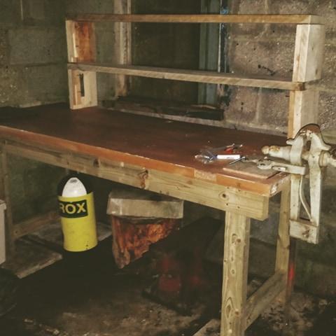

Managed to get this for £10 p/inch last month, need to give the bolt and the handle a bit of love but other than some squeaking and rust friction its in great working order. Only 3" but it was a lot harder to track one down locally than it was the anvil. not sure if i want to just give it some lube where it needs it and let it be or take it all apart and clean it up. The foot is sitting in a 5kg weight that's solid in place
79766445_580499546069467_2716428001376993280_n.jpg.c03fc7c306896dff2bebb6014b7ad543.jpg75419010_10162768313410341_208213992965931008_n.jpg.9e2dcbdded9b1c07a02cceb36d7361fc.jpg
I would take the screw & screw box apart and clean them of old lube & gunk, oil them and pivot points then put it to work. A 3 inch vise will do a lot of work and 30 pounds sounds like a good deal.
Cleaning the bearing surfaces, (cheeks & pivot, screw&screwbox) and lubing them well will make the vise/vice a lot nicer to use.  The rest is personal preference.
I will get to it over the weekend, it couldnt definitely be smoother to use. I'm a bit torn on the rest really, i don't like the faded sky thing it has going on but i a shiny clean steel anything would stand out like a sore thumb given the rest of the shop(inc the roof, door and windows) is built from scrap and salvage. Ill have a think and come post  clean up picture when i decide
I didn't know what was an option, ill have a look at tea'd steel on google and decide then, thanks for the idea
You may want to look up coffee as well.  Tea is the tannic acid so a peat bog soak should also work. (Don't include the screw/screwbox of course!)
I had one friend who cleaned, polished and then heat coloured his vise/vice and then clear coated it.
There is always paint as well.
Many people wipe down a cleaned tool with boiled linseed oil; but that won't colour it.
