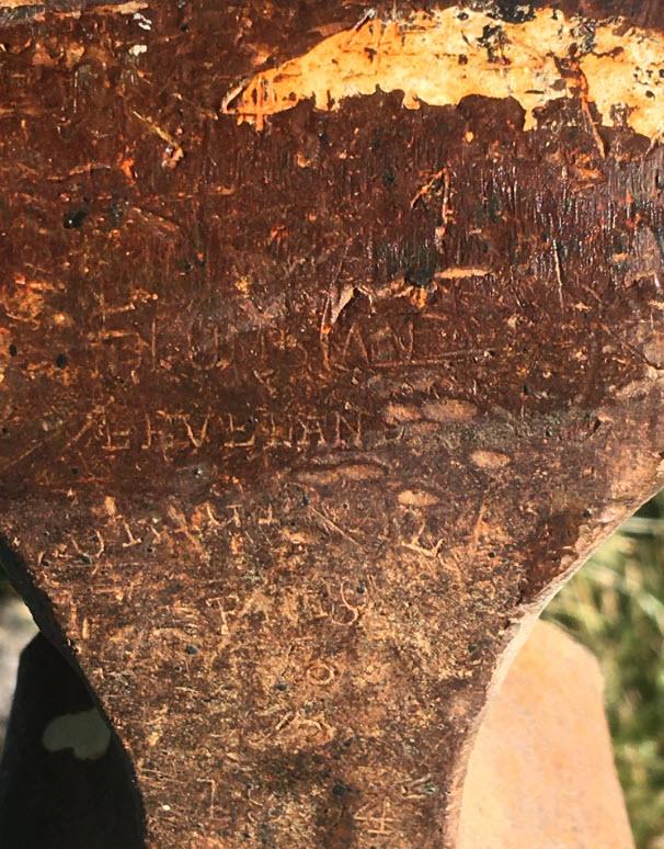

Chris C Posted July 28, 2019 Share Posted July 28, 2019 Okay, I have an identity question: My vise has no name on it anywhere. On the outside of the moveable jaw is stamped the number 50. I'm assuming that means 50 pounds because that's what the vise weighs. On the inside of the fixed jaw is stamped the number 4. I guess that's because it's a 4" jaw. On the underside of the mounting plate is a large number 2 cast into it. Can anyone venture an educated guess as to the age or maker of this vise? Not a big deal to me, but would be fun to know. Link to comment Share on other sites More sharing options...
Rmartin2 Posted July 29, 2019 Share Posted July 29, 2019 That sounds exactly like one of mine except mine has 4.5” jaws. Mine also had a date of 12/27/1906 stamped under the mounting plate next to the 2. I don’t recall the jaw width being stamped in my jaw but I do remember another year stamped on it. I think it was 1907. I do have the 50 stamped on the moving jaw. Edit: I think I determined it to be a Columbian even though it didn’t have the “C” stamped on it. Link to comment Share on other sites More sharing options...
Chris C Posted July 29, 2019 Share Posted July 29, 2019 Interesting comments. Thanks. Link to comment Share on other sites More sharing options...
ThomasPowers Posted July 29, 2019 Share Posted July 29, 2019 Postvises were made by hundreds of places few marked them save for some of the larger manufacturers (Columbian, PW, Iron City, ...) Also note that many folks assume that the if the screwbox is marked then the vise was made by that company. Well it may and it may not have been; movable parts can be transferred from one vise to anther---I've done it myself to get a better working vise from two basket case vises. Link to comment Share on other sites More sharing options...
Chris C Posted July 29, 2019 Share Posted July 29, 2019 Oh well, my nameless vise will serve me nicely, I think. It's only a lowly 4"er, but I'm happy with it. Link to comment Share on other sites More sharing options...
jlpservicesinc Posted July 29, 2019 Share Posted July 29, 2019 Many times if the vise was made in a place of mass productioned hand work.. the vise may just have a dot or 3 or 4 to denote which parts go where or via whom the maker was. People forget that it's easy to have 4 people.. each with a center punch and to leave their mark meant 4 whacks with the center punch. Link to comment Share on other sites More sharing options...
ThomasPowers Posted July 29, 2019 Share Posted July 29, 2019 People also often ask "Was it hand forged or factory made?" when in the 19th century the answer very will could be: "YES". Link to comment Share on other sites More sharing options...

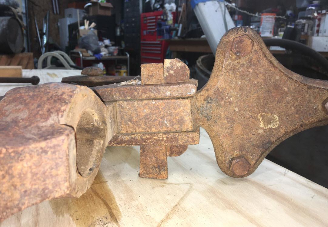

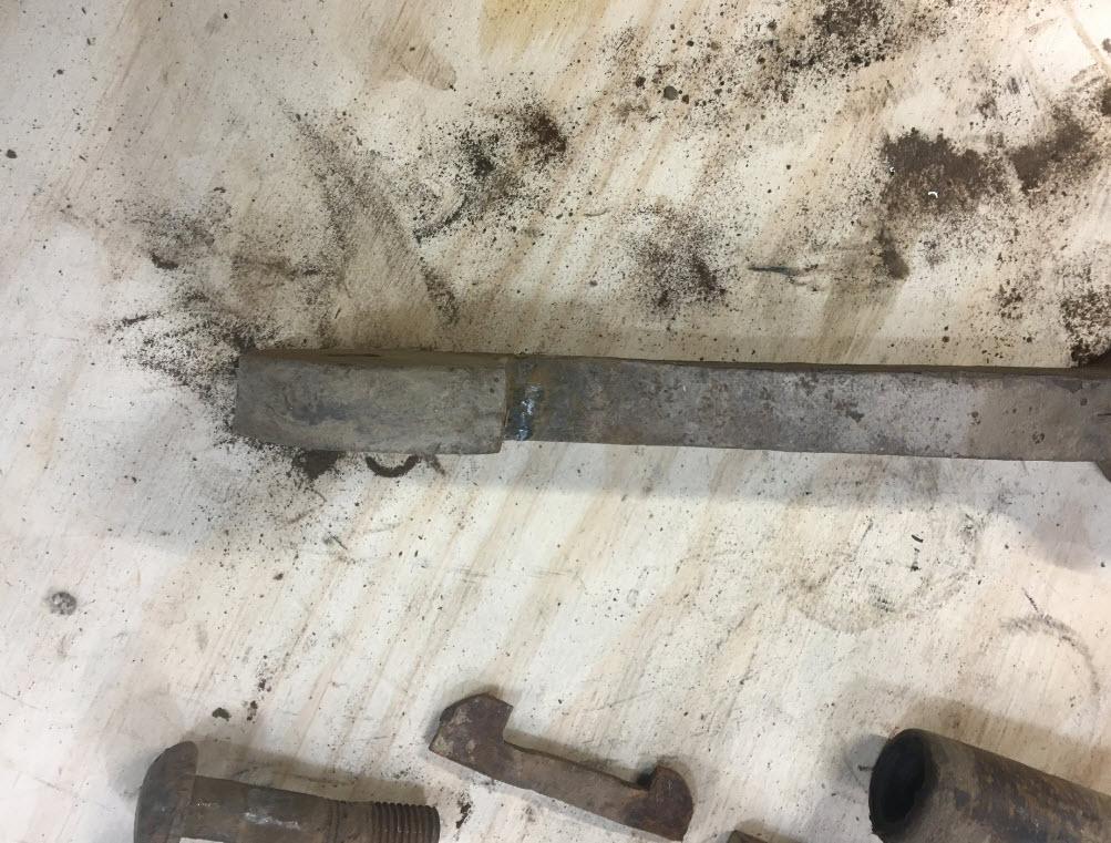

Old Crew Posted November 10, 2019 Share Posted November 10, 2019 loneronin It looks much better now that you have spent some time bringing it back to life. I just got a big 2 leg post vise. 165# with 8 " jaws ! It was very rusty but the screw box was excellent, it was still full of grease. The pivot bolt was rusted half way through and needed to be replaced and it didn't have the spring or the mounting plate . I forgot to take pre-cleaning pictures , but here is a picture of what i am trying for the spring. Link to comment Share on other sites More sharing options...
Old Crew Posted November 10, 2019 Share Posted November 10, 2019 The spring is a 2" wide by 1/2" trailer leaf spring with a piece of 7/8 bolt welded to the end at the pivot point. I am sure that it is not period correct, but it opens the jaws easily up to 7 " . before it looses push. The pivot point is interesting in that the movable jaw is beveled at the radius of the pivot to match the lower portion of the base. Link to comment Share on other sites More sharing options...
jlpservicesinc Posted November 10, 2019 Share Posted November 10, 2019 this type of vice joint is seen in German and some European vises. Link to comment Share on other sites More sharing options...
ThomasPowers Posted November 11, 2019 Share Posted November 11, 2019 The curved bearing surface I have seen in French vises. Large cheeks around the pivot point is typically German. Lovely vise; would go well in a much classier shop than mine... Link to comment Share on other sites More sharing options...
