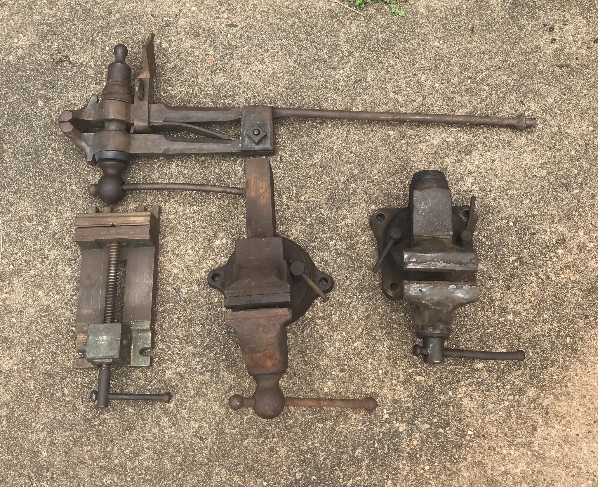

Rmartin2 Posted June 30, 2019 Share Posted June 30, 2019 All scrapyard finds. All need (needed) something but were had for $70 total. Unknown 4” post vise. Wilton 1460 Rock Island 574 Wilton 1750 Quote Link to comment Share on other sites More sharing options...
Frosty Posted June 30, 2019 Share Posted June 30, 2019 Oooooh! I hope you bought a lottery ticket! The Wiltons are expensive vises, even used, I don't recognize the maker of the drill vise but unless there's hidden damage it's worth more than $70. The leg vise looks complete but can't see the screw, it's PROBABLY worth your $70 easy. The gods of the scrap yard were sure smiling on you. Frosty The Lucky. Quote Link to comment Share on other sites More sharing options...
Rmartin2 Posted June 30, 2019 Share Posted June 30, 2019 The dill vise is a Wilton 1460. It was $5 with a bent screw. Easy fix on the press. Works great and has the quick release mechanism. I have shown the post vise before. It needed a washer and the rear Jaw/leg is bent. One day I’ll heat it up and get it back into shape on the press. The other 3 need some work to the jaw area. I don’t mind doing it for some quality vintage vises. Quote Link to comment Share on other sites More sharing options...
Frosty Posted June 30, 2019 Share Posted June 30, 2019 Ah HAH, I THOUGHT the leg vise looked familiar! You want to straighten the heel jaw or the leg? I wouldn't bother with the leg it's not bend enough to effect anything. I'd use it for a while before deciding if the heel jaw needs work. Usually they meet on top first rather than the bottom so it's a candidate, I'd check that very thing. Frosty The Lucky. Quote Link to comment Share on other sites More sharing options...
Rmartin2 Posted June 30, 2019 Share Posted June 30, 2019 There is about 3/8” difference in jaw height when fully closed. There was another post about misaligned jaws and that vise was heated and straightened to correct the problem. That’s when I noticed mine was slightly off. You’re right about the leg. I was just going to straighten it while I was correcting the other problem. Quote Link to comment Share on other sites More sharing options...

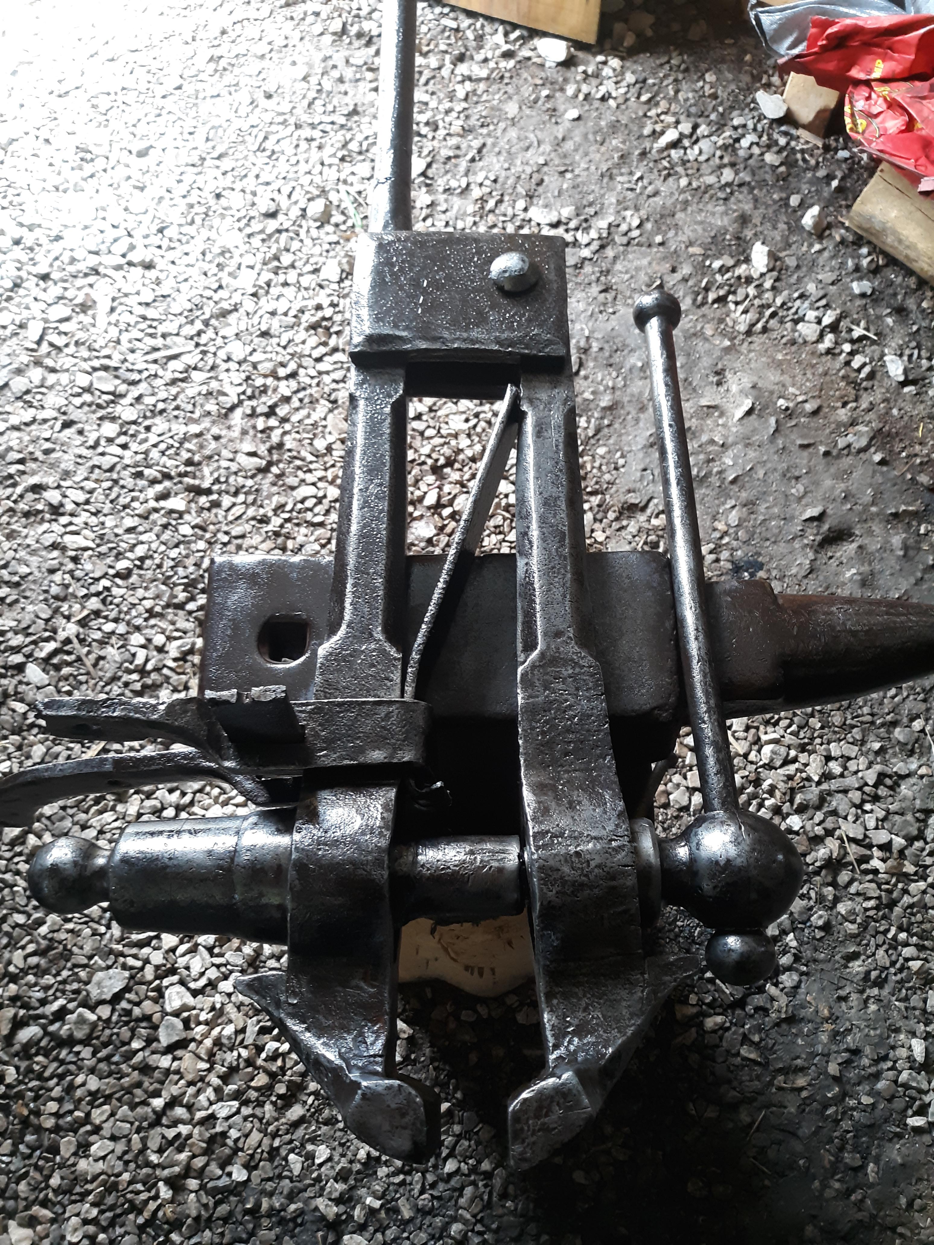

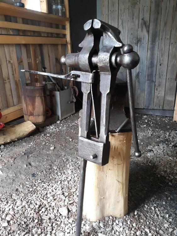

Honey Posted July 19, 2019 Share Posted July 19, 2019 Wrought iron Peter wright I thinks. 4 inch jaws, 40 inches tall 44.5 lbs If you look close between the patina it used to be painted dark red. I believe its missing the decorative ball on the screwbox. Screw in brand new sort of condition. No wear at all, each burr is sharp, not one single part of the burs dull or rounded. No signs of any repair ever having been done to this vise. Cant see light through the jaws either, Holds paper just fine without slipping at all. Got it for £39 locally I bought it thinkin i'd have a fun project to repair but theres nothing at all to do with it, so i'm kinda bored now. I'll restore the parkinsons above instead haha. Quote Link to comment Share on other sites More sharing options...
