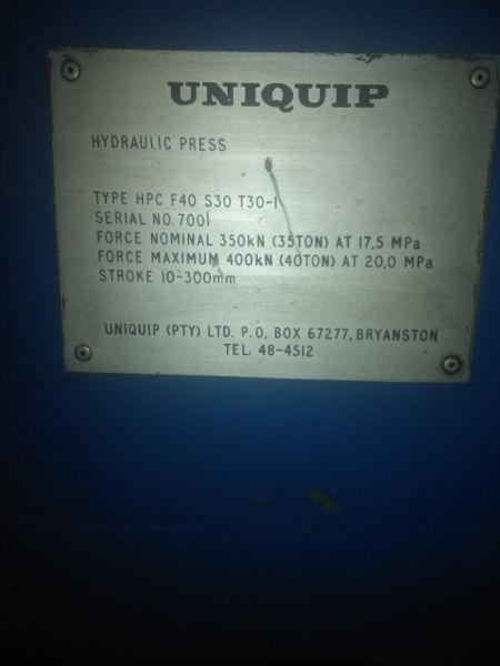

  5. ianinsa, Thank you for the offer but unfortunately, I'm moving down to the western cape (Overberg area) later this week. Although I would greatly appreciate it if you could maybe send the presses and power packs specs? Thanks and regards, Ross
  6. Received a reply from the seller, he says he thinks it was used as a molding press, so probably won't work for forging.......? Regards.
  7. Hi Y'all, Found this hydraulic press on "Gumtree" and I was curious if it could be used or adapted for forging? The description given by the seller: Good condition. Heavy duty. 300mm opening. Good value. Was going for 40000 then 30000 and now it's 20000, price in South African Rand. Thanks in advance.

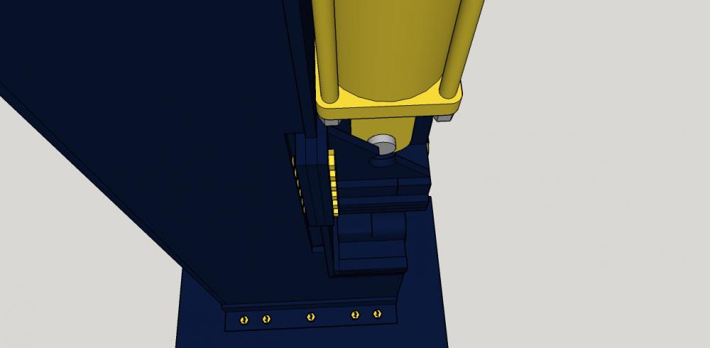

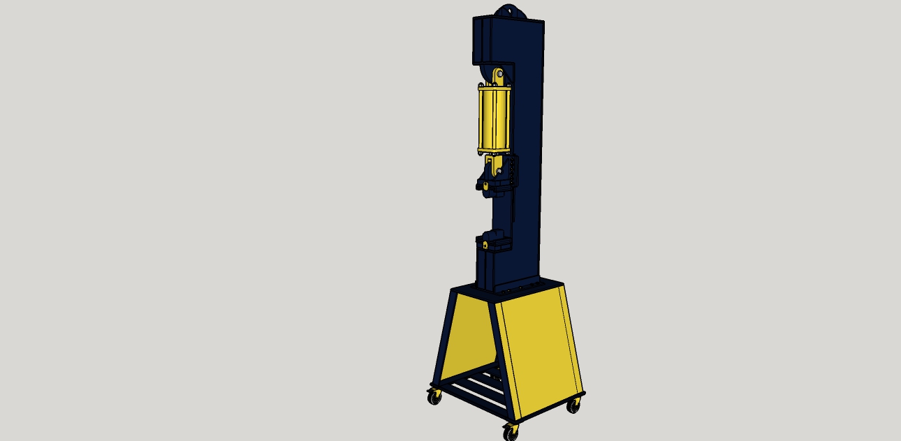

  10. Hi Y'all, So I've been doing loads of research and designing and I've finally come to the stage where I can start ordering the parts for the press. Anyways here's my reason for posting, my calculations and the page about the pump say for a 10.51 GPM, 3000 psi, 2 stage pump I need a 7 hp motor. BUT Coal Iron Works 25 ton press uses only a 5 hp motor for a 13 GPM pump and McNabb's 24-ton press uses a 3 hp (not sure what pump though)!?! Am I doing my calculations wrong or something? I'm going to be using a 5 X 8-inch tie rod cylinder. Thanks in advance! Here's a quick "animation" of the press. The press is just over 7.5 feet and working height is around 3.5 feet. "Edit" added some images in case the "animation" doesn't work. Recording #4.mp4
