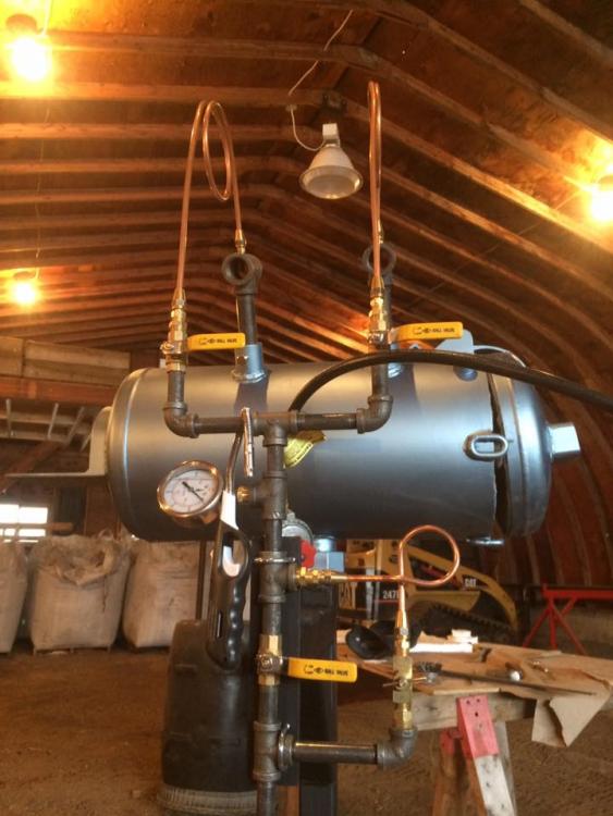

  4. The 20lb tank was just for first test burn. Everything after has been done on a full 100lb tank maintaining constant 7 PSI at the manifold.

  7. I have just completed my first Propane forge. It's made from an expired air tank (because that's what everyone does, eh Frosty?) It is a 2 burner using the "Frosty T" burners. I built it too big for my needs (because that's what everyone does) Build details are, two one inch layers of ceramic fiber covered with 1/8" refractory cement. Kiln shelf for floor. I fired the forge and trimmed the tips to tune it as it was a very yellow flame in the dragons breath. It worked great, nice blue cones and hardly any dragons breath from 5-10 PSI. Got forge up to operating temp and used it a bit, still nice flame. Ambient temp in my shop was -18F Brought the forge into the garage and gave it a few coats of ITC-100 let it cure for 3 days. Last night I went out and the temp in my shop the ambient temp is up to about 14F. I fired up the forge and got it to temp. Dragons breath showing bit of orange. As I went on forging the dragons breath had more and more yellow in it. This was the Hottest I had gotten this forge. The problem with diagnosis is that I changed three different variables when tis happened. ITC-100, ambient temp,foge internal temp. Any guess on which one is the culprit? Here are a few pics of forge, Its only running one burner @ 3 PSI in the pics because I was freezing up before switching t the 100lb bottle. Also, the side pic of the forge it isn't hooked up or running, incase anyone noticed the lighter and hose hanging by the forge.

  12. I was in the same boat, trying to find a good burner in Canada for a good price. Did a bit of reading, picked up the parts to build a Frosty 'T' burner. I still have to finish tuning it but even without a final tune it gets one inch stock to yellow in very little time. I choose the Frost 'T' because of the simple design and limited tooling need to make it. If I could do it again I would not have wasted so much time looking in to built burners for my needs. With the money I saved I was able to buy a 124lb Foster.
