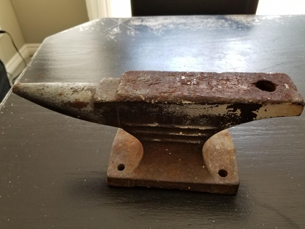

Can anyone tell me what the steps for doing a brazed face to a cast iron anvil are? It's tiny. Maybe twenty pounds. At most. Not worth it for the size, just for the experience. Face area is 2x6". I have some 1/2" AR500 plate I was thinking of using a piece of as a surface. Did a search of the forums, came up with a bit of info, but if anyone's willing to walk me through a step by step on this I'd be grateful. Here's hoping my request was not too brazin'.
