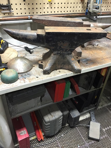

A new old anvil found me yesterday, but how old is it?

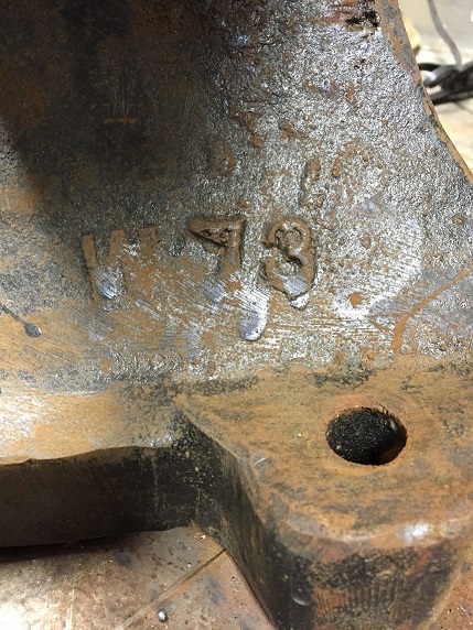

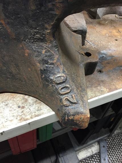

Yesterday I was given a 200lb anvil with a 200 cast in the side and a W73 cast on the end and am wondering how old it is and who made it.
Can someone here steer me in the right direction? Is it a "Fisher"? What does the "W73" mean
thanks

Fisher? Any other marks on it?
Nope those are the only markings on it, and yes it is brand new, it has never seen a hammer. It appears to have a hard face on the top about 3/4 of an inch thick

My 200lb Fisher was made in 1941.  It has a 20 cast on one leg and 1941 cast across the front, the Fisher logo in on the side.  I'm sure the Fisher guy will know, but it's my guess that it was made in 1973, or at least is more contemporary than mine.  I don't recall when Fisher went out of business, it may be one of their last.
You anvil is a FISHER/CROSSLEY.  It was made in 1973.  Crossley Manufacturing took over making Fisher anvils in 1962, when the Fisher plant closed and was demolished to make way for a highway and increased parking at the NJ state complex.  They used all of the Fisher equipment and some of the personel at the Crossley plant, about a mile away.  Crossley produced anvils until the end of 1979.  They had to shut down their iron furnace due to Federal EPA regulations.  For whatever reason, they had stopped putting the Fisher name on the anvils.
Your anvil has factory paint, and appears to have never been used.
The face plate is actually only about 3/8" thick, the pattern had an overhang to give the appearance of a thicker plate, and to provide for grinding if the edges got chipped.  Mostly it was to give the appearance of a thicker plate.
You have a special anvil.  There are not many NOS Fisher anvils left in the world.
