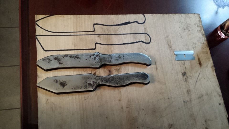

Here are 2 more I cut out of the second section of leaf spring. Basically my goal to start, is with EDC type knives for something to sell, here in Utah the laws pertaining to knives you can carry are pretty lax as we are an open carry firearm state, but unless you want people looking at you funny and avoiding you, its best to keep the object attached to your belt on the smaller side of the scale. Also the board behind them, Is what I will be using as my templates moving forward. Here is the Tanto style one from above after some grinding, I did most of the grinding freehand, then cleaned it up and fixed it best I could with a file. Essentially my plan is to make one of each style, freehand grind it and file it to clean it up, and keep the first of each design for prototype use and abuse, should they pass my tests, they will get made for sale, however my freehand grinding will need to improve before I can actually freehand them all, so I will be using a jig on any I plan to sell, I have a lot of ideas in my head for different designs, so there will be plenty of prototyping done to improve my freehand grinding skills. Unfortunately during the week my ability to work is very limited as I have a couple young kids at home who spend weekends with their mother, so forging and heat treating anything at the moment is a pure weekend project, Once my 6 year old gets over his defiant streak, I plan to have him help dad but for the moment its more risk then worth it. That is actually part of why I have moved more over to the stock removal process for knives for the moment, The girlfriend will only tolerate the noise and smell and filthy dirty boyfriend for so long before she reaches back and gives me an old school Italian smack down unless this project starts bringing money into the house. And with the number of Drag racers and mechanics my family hangs out with doing stock removal on old leaf springs is the most economical all the way around. I have one more template to rough out from a paper drawing to add to the board, technically that one is a special request, my friend who is more brother then friend wants a double edged boot knife similar to the one from Big Trouble Little China, So tonight's work is to get that drawn up and rough cut on a blank, but first I have to make a plate for my grinder, not sure why but the tool/stock rest on my cheap harbor freight jobby has these deep grooves on it which prevent smooth movements with anything remotely Jig shaped.
