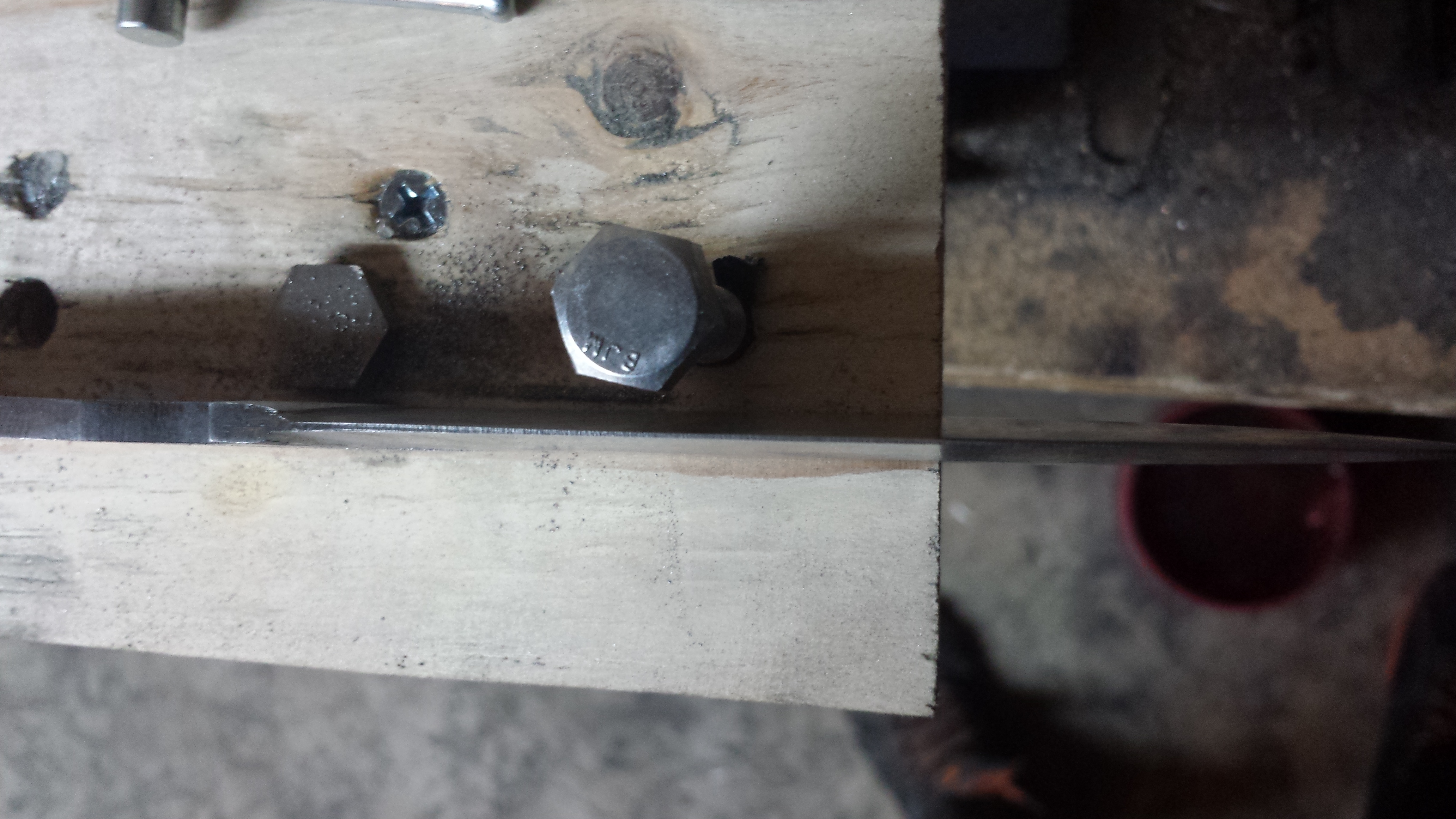

  3. Here is what I got done today, which is admittedly not that much, but I have ALL day tomorrow to work on them so its not a big deal. Top shiny one is the prototype, the one below it I did completely on the jig. Ill never file a bevel on that cheap piece of horrible fright garbage again. both sides took less then 1 hour total to bevel, granted the other side isnt as good as I did the other side first. but I have plenty of room to clean the bevels up still. Two things I noticed about the jig that are not mentioned in the video about its construction that I realize are common sense and I should have known better. 1. When placing the knife on the jig, you need to line up the file to the stop bolt before cranking it down, luckily for me, I gave myself extra room on the ricasso area and can clean the slight difference up without issue. 2. A36 is tough stuff compared to what they make eye bolts out of, In the short time it took for me to file this out, I wore a groove in the eye of the bolt. So I will be buying another eye bolt tomorrow and will be sanding my rod up to 1000 grit to hopefully negate this.

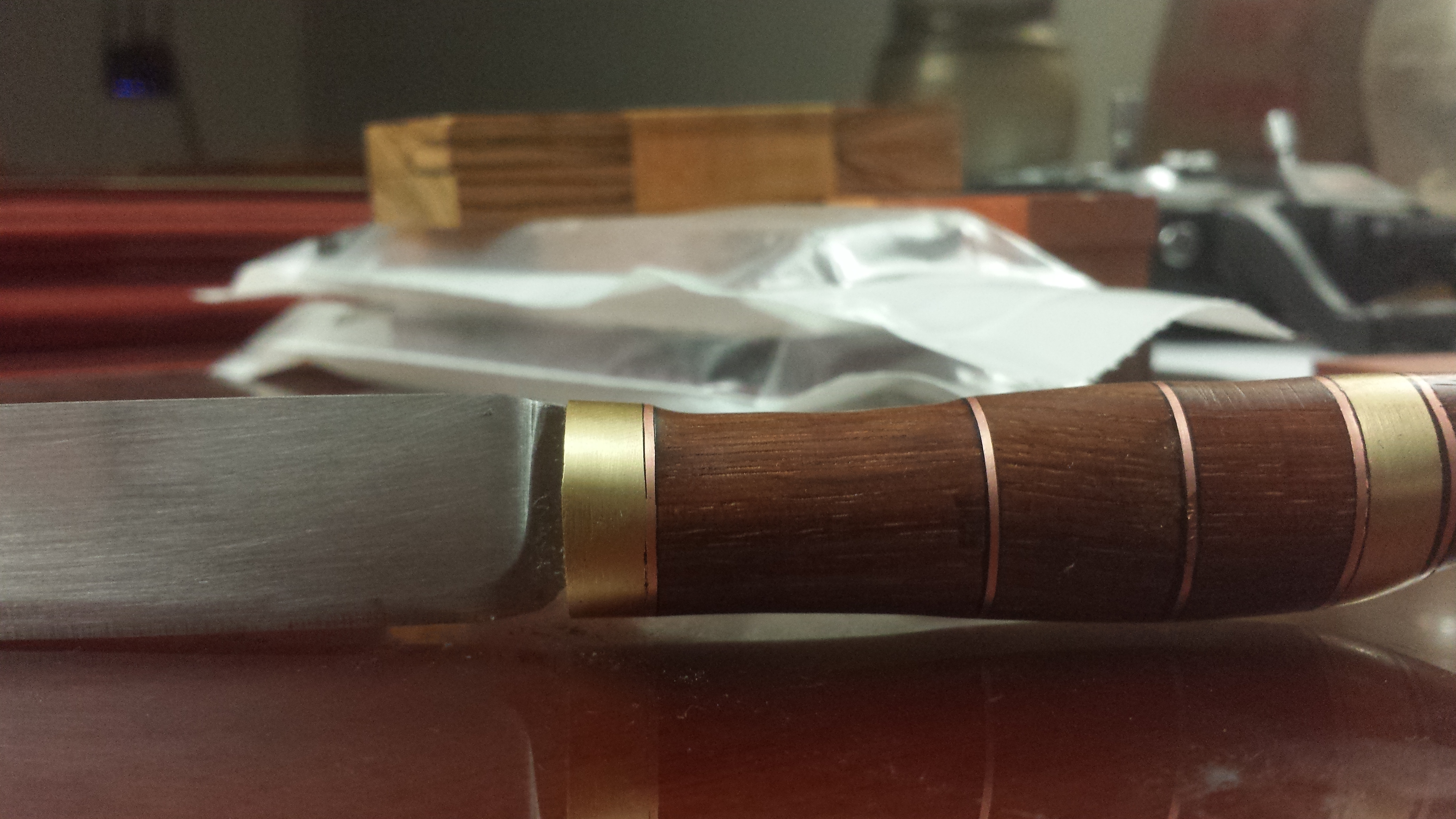

  14. So this isnt totally done, needs an edge and some final polish work done, but I figured I would post a pic of it now as I do have a couple questions. The handle is Brass, Copper, and Hickory. I have put 2 coats of boiled linseed oil on this, and am curious as to how many coats of linseed would be " enough " or is there a way to tell when you are wasting the stuff trying to put more on? I sanded this up to 1200 grit and its nice and smooth, but plan to sand the brass parts carefully up to 2000 grit and then hit them with some buffing compound and and cloth wheel. And any recommendations on treatment after the linseed oil is fully dry, or just leave it as is? Blade is O1, has a hidden tang all the way into the last piece of wood at the end of the handle, At the moment all of the O1 knives I can make have been quite narrow blades, this is due to the fact I have 1/2 inch stock, and newb hammering skills. Its also the first time I have really gotten a good clean grind line on a flat grind that I felt comfortable leaving, I plan to sand the entire knife up to 2000 grit and then compound and cloth wheel it. The fit on the copper pieces could be better, you can see some dark spots where there was a gap that was filled by the epoxy, but the copper came from a length of 1/2 inch copper pipe I cut long ways and then cold hammered " flat " and the cuts on the wood were not by any means perfect either. but considering the number of pieces I am actually surprised it fit together as well as it did, I did try my best to get the fit as close to square as possible, but im new at this and have yet to learn all the tricks to this addiction. Next one I do like this, I am going to do Brass, Copper, Wood, Copper, Brass instead of having the second brass piece at the end, I like it, but I think it would look better if the second piece of brass were at the middle instead of the end.

  18. Thomas, So you would use the masonry nails to " shim up " the guard to the tang, Am I understanding that correctly, I think on the next one I finish up in this manner I am going to give the " hit it to make it tight " idea a try, but If i end up with massive holes on each side perhaps shimming it in that manner with some masonry nails would make an interesting design once ground down to the level of the guard. Thanks for yet another great idea... Here is how that one looks now, handle is finally shaped in a way I like. still not a true Puukko style handle, but for what I envision this knife to be I really like the handle shape and it feels nice and light in the hand. When I first ground the scale off this blade after forging, i looked at it and said to myself " This is like grandpa's old fishing knife " and that use has pretty much stuck in my head ever since.

  21. Here is how that first one looks now, Other one will get glue treatment later tonight. and then cleaned up tomorrow.
