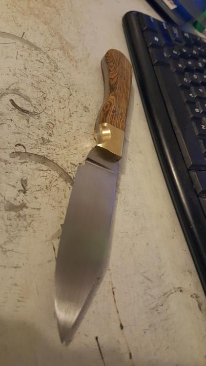

  1. I thought I posted this already, but it would seem I did not. I decided rather then grind the handle off, I would test out the CA glue treatment on it, Which I am glad I did as I really like how the handle turned out after doing so, Granted it took about 20+ coats of CA and I burned through a LOT of 1200g sandpaper, but I am quite happy how it turned out.
  2. I think if I had not been so hung up on trying to get the finish " professional " looking, I would be very happy with it, Problem is I have about 10 knives floating around my house right now that I have made, that when I look at them after looking at other peoples work I think to myself " Man you really could have done that a LOT better ". I know its a learning curve and the only way to get better is to keep doing it. I just really wanted this one to be better.
  3. Been working on this blade for months, I recently added another child to my family so time to work on knives has been very limited. With this one I wanted to go for the best possible fit and finish I could do. I probably hand sanded this blade for a solid 20 hours. When I went to start the handle, I cut the main piece ( Lacewood ) in two. flipped the pieces and glued them back together with the spacer ( Rosewood ) and then drilled the tang hole. Did a bit of surface sanding after the glue had cured and there were no lines or gaps. I was elated. I then started to file in the groove in the tang hole to hold the tang, and thats where the problems started. the small bit of lacewood that is directly after the brass decided it did not want to be a part of the handle anymore and it popped off. So I sanded the glue off both of the mating surfaces and test fit the handle probably 100 times before final glue up and I could not detect any gaps at all. Glue it up and move on to handle shaping and sanding cant see any lines or gaps the whole time I am working on it. Get the handle up to 220g and decide I want to see what the handle looks like, so I give it a quick wipe with BLO, and thats when the faint epoxy line in the spacer reared its ugly head. Should have used Clear epoxy not the White.. I am also not exactly impressed with the Lacewood, The block had a beautiful texture, but once shaped it lost a lot of the patterning that appealed to me. Honestly this is probably my best work I have ever made. I just wanted to make it better then it is. Next up, is my first ever attempt at a leather sheath, so at least the knife will have fewer flaws then the sheath will.

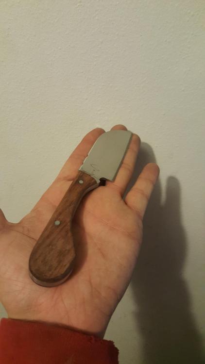

  15. Northwoodsman..... As a fellow newb to this hobby, who has asked a few " stupid questions " myself and been grilled by the likes of Mr. Sells over it. Let me offer you a couple pointers since it seems that you are very intent on this hobby. 1. DO NOT Argue, or pick a fight with anyone who has Curmudgeon under their name, If they bite your head off over a question, its because they have answered it many times in the past, and know that the answer exists elsewhere on this forum, or on other forums that are widely known. These gents know what they are talking about, and if they are going to take the time to respond to your questions, they expect you to put forth some effort into answering it yourself first, and bring to them questions that merit them taking time out of their busy day to respond ( JPH comes to mind here, that man is a MACHINE when it comes to cranking out top shelf quality stuff at a breakneck pace ) because any time they spend typing on a keyboard, is time they are not spending forgewelding or polishing up their next beautiful piece of functional art. 2. Walk, before you try to run, and right now it sounds like you are trying to skip both steps, and move right into flying. There is a reason that everyone is telling you to start with smaller blades, and the reasoning is simple, It takes a LOT less work, effort and chance for mishaps with a 4 inch drop point, then it does a 30+ inch broadsword. The skills you will learn from a 2 inch skinner, will directly apply to the work you do on a sword. And if you order say, a 36 inch long piece of 1084 from Aldo. You can either make one sword from that stock, or roughly three 4 inch blades from the same stock. if you mess up the sword, the whole stock is a loss unless you cut off your mistake and you are lucky its at the tip, where as if you make a mistake on a single knife from the same stock, you have 2 other blades to work with still. 3. Read, Crosscheck, read again, and dont take everything you see on YouTube as truth. Many highly respected bladesmiths in both the knife, and sword making world have YouTube channels, and offer EXCELLENT videos on how they accomplish their works. There are far to many to make a list of who to watch, but I will say this. Once you have a decent understanding of the processes, you can then start to spot the makers in their videos where they do something that causes you to go " Wha??? " , Once you reach that point in your understanding of things, that is when you practice and then start to progress. An excellent example of this, is the guys making videos of turning large wrenches into Tomahawks, Did you know that heating Chrome plating is highly toxic. You cant just stick any old metal in the fire and take a whack at it. Which leads me to 4. Do your research on your materials. Some metals you might stick in your fire, can kill you from the fumes. Galvanized steel for example, produces Zinc fumes when heated which have even been known to kill experienced blacksmiths ( Google Jim " Paw Paw " Wilson ), As I mentioned before, Chrome fumes are toxic, but its not just about the metals. Rosewood variants for example, are toxic, While they wont specifically kill you as fast as Zinc fume inhalation can, its dust is still bad for your health. That is not to mention the other dangers inherent with this hobby, Such as fireflies ( Sparks from Solid fuel fires such as Charcoal and Coal ) setting things near your forge on fire. Or the significant amount of Carbon Monoxide put off from a Propane forge being a danger in enclosed areas. Or the fact that the propane lines could leak if not checked regularly resulting in a fantastic yet potentially fatal fireball appearing in your shop area. Or the fact that a high speed buffing wheel can rip a blade out of your hand and bury it to the hilt in a wall after taking off your fingers, and thats if you are lucky, as using it wrong could also launch it into your chest at such a rate you could be dead before you register that it has left your hands. So proper research, proper safety precautions, and proper PPE are a MUST if you intend to keep working in this hobby long enough to reach your stated goal of making a functional sword. I am not trying to discourage you, Far from it, as a fellow newb to this ( I have been doing this for about 2.5 years now ) , I am trying to instill in you the gravity of the situation, This is a hobby that CAN kill you, or maim you, or burn your house down, Or all three. It could also create lawsuits, because if you sell a sword that shatters and kills some innocent bystander. YOU are on the hook for it. No one likes to get reamed out for what they want to do, but this isnt World of Warcraft, You dont just assemble a list of items, click create, and end up with some epic item. You have to put in the time, You have to put in the practice, and you have to do your research. None of us want to see you fail, or die from your interest in this hobby, or see you sued into the poor house because of a mistake. We want to see you survive and be a success in this hobby, The blacksmithing and bladesmithing communities online I have encountered, are some of the most welcoming helpful people I know of.

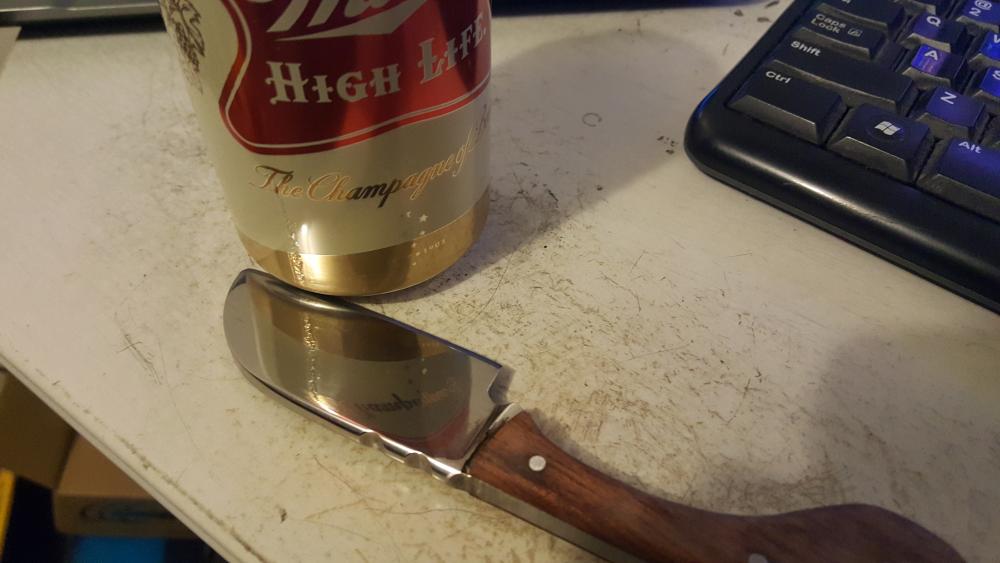

  18. Its been a bit since I posted my recent work here, Been busy with other stuff and whatnot, but still cranking away at learning this knifemaker thing. A little sheepsfoot, a Drop point, and Honestly I dont know what to call the third one, so I have taken to calling it a Hard drop point. All three are 5160 steel, The sheepsfoot has Bubinga scales and steel pins, the other two both have Brass bolsters and pins in the bolsters, and then Steel pins in the scales, drop point is Bubinga as well, the Hard drop point is Bocote. They all still have quite a bit of finishing work left to do, but in my personal opinion, they are the cleanest knives I have made to date. So it does appear that I am improving my skills to an extent. Did a mirror polish on the sheepsfoot, more for the fact that I wanted to give it a shot, you can see the glue on the ricasso I need to clean off on this one, then I need to finish sanding the spine so I can polish it as well, I would like it to match all the way around. Not sure what the little squiggly line is on the blade, It was not there when I taped it up to glue it all together, its not a scratch, and not a crack, its faint unless you hold the blade at an angle, Im going to re buff the whole knife when its ready so I suspect it will go away. The drop point, Cant really see it from this photo, but the bottom finger area of the spine is pretty rough still, will take a good bit of hand sanding to get it where it needs to be, I used a drum sander bit in my hand drill to shape the fingerish grooves in the brass because I couldnt shape it how I wanted on my cheapo belt sander. Needs a bit of clean up but I would have to try to mess this one up at this point. And another shot of the Drop point. The " Hard Drop point " basically this one needs all the same work the drop point does, this one the bottom spine and scales are a bit cleaner then the other, but still needs some work before calling it done. Overall I am pretty happy with these, I have made some really crappy stuff, and these ones look almost worth trying to sell, Spent a good amount of time figuring out a good heat treat on 5160, and have been pretty happy with the results of the steel, so now its time to make them better looking. Thanks for looking.
