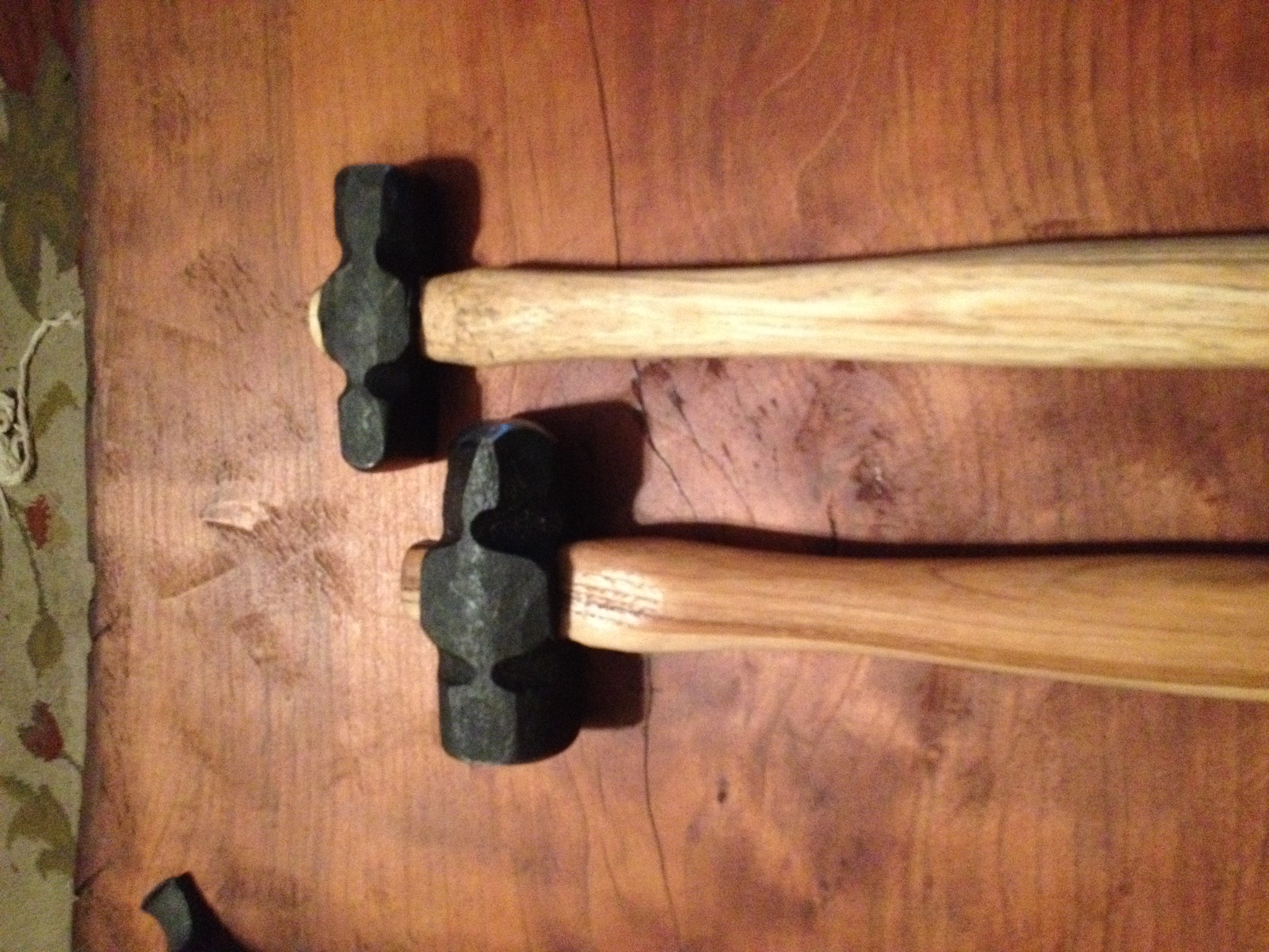

My main hammer is the a diagonal peen (left in the first picture) weighs about 2.5-2.75 haven't weighed it. And I've been using a 3# cross peen for my normal work, both forged by me. Been using a 7 or 8# strait peen for larger work but I don't have a pic of that handy.

I swear this hammer is hollow though, it feels like swinging a 3# hammer... I know what kinda hammer I want now
