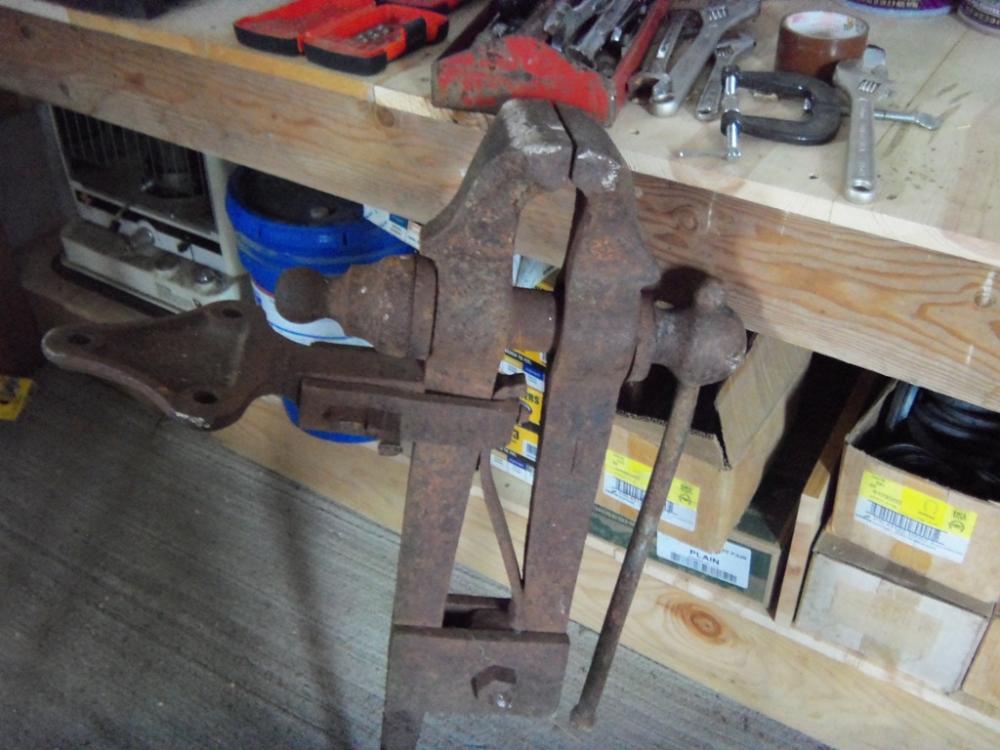

  7. Today I got the vise put back together. It's functioning well but as you can see there is a little problem with the jaws.

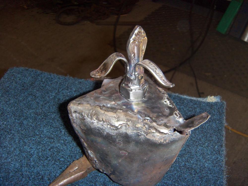

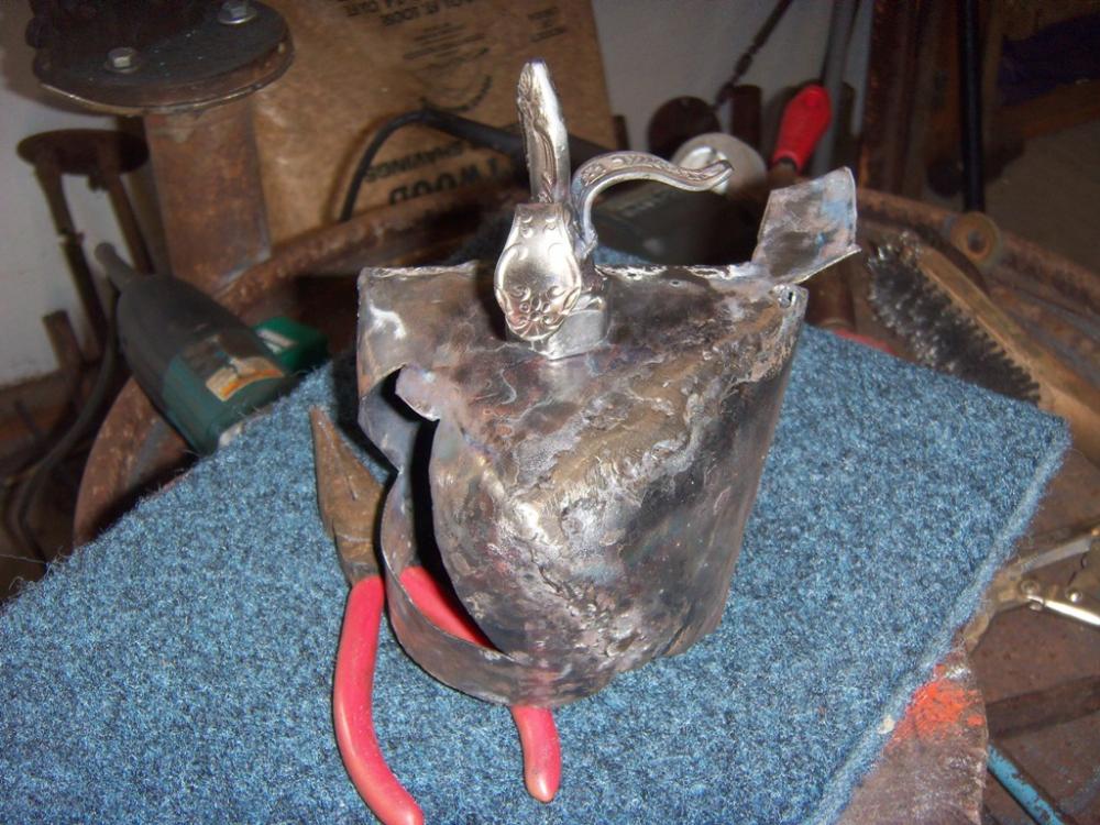

  8. Today I installed two of the three feather tufts. I didn't have enough spoon handles so I'll have to wait to do the third.

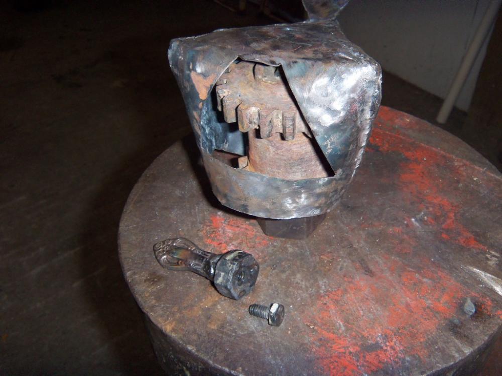

  9. Today I began building the topknot for the falcon hood. I used two nuts welded atop each other and the butt of a butter knife handle. I decided to bolt the topknot to the hood instead of welding as the sheet metal is so thin. I still have a few feather tufts to add.

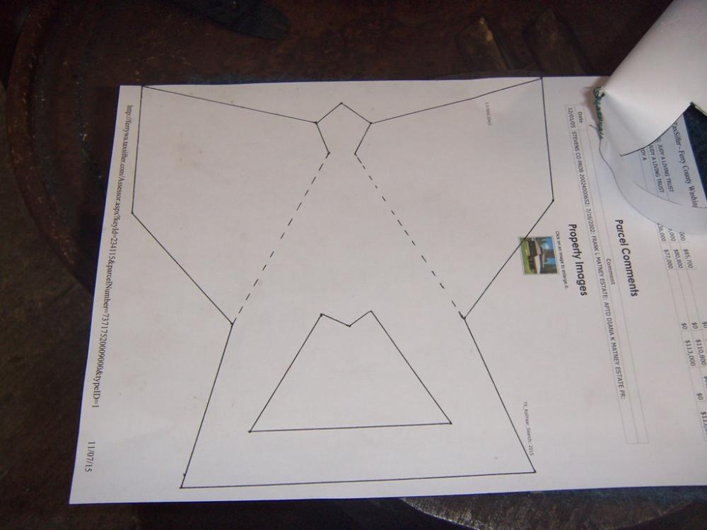

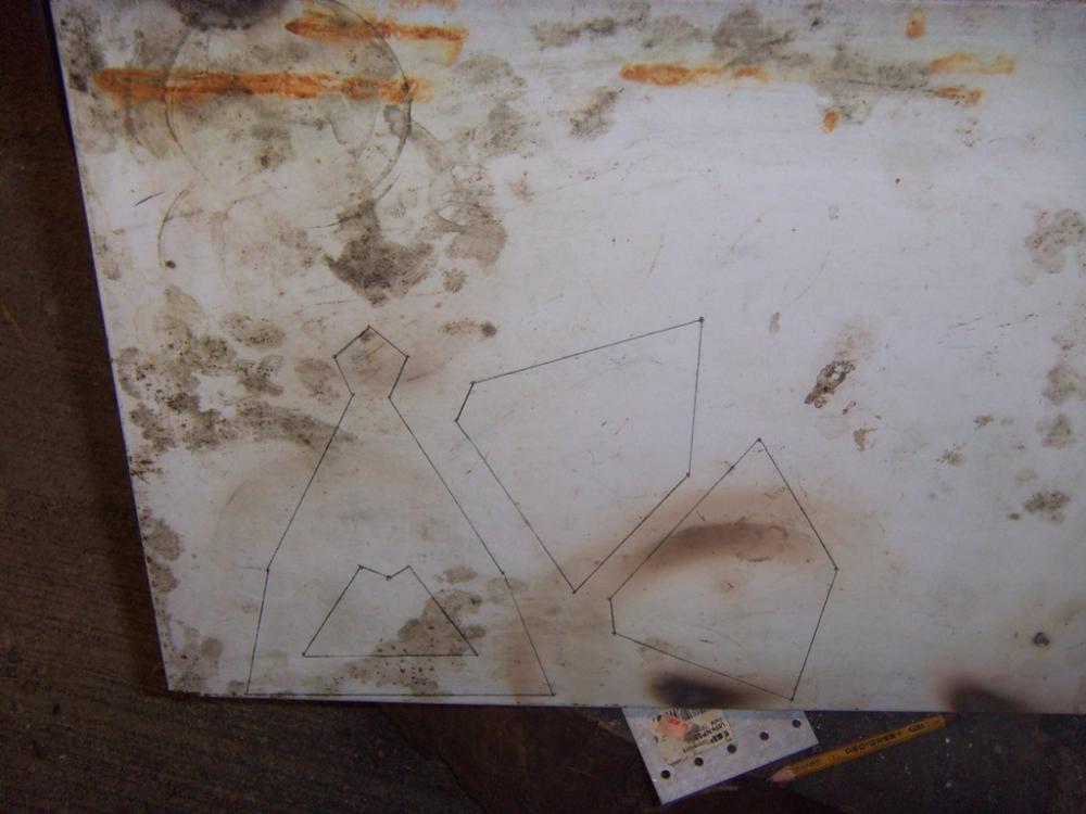

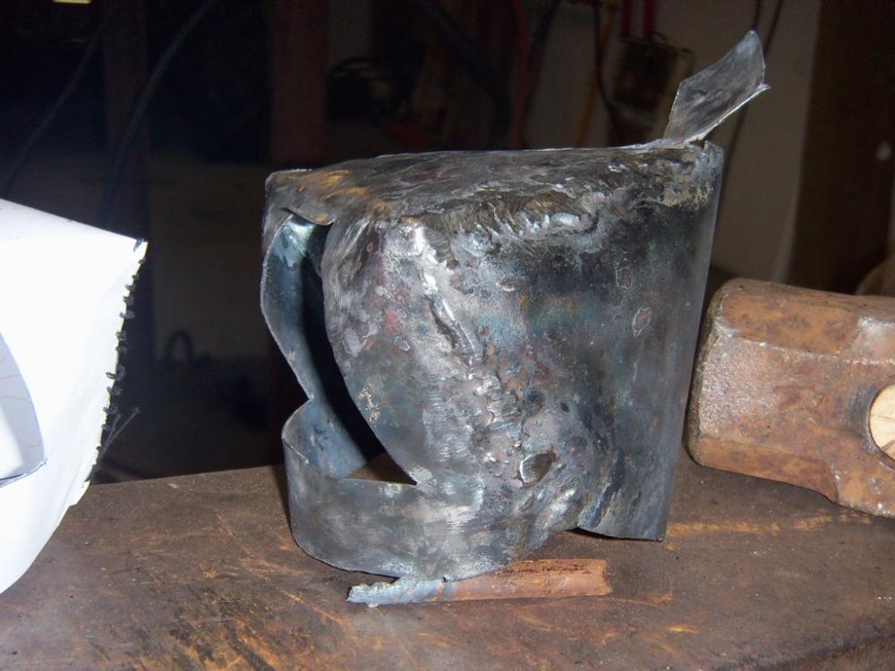

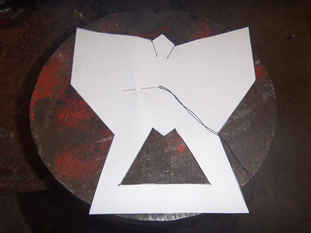

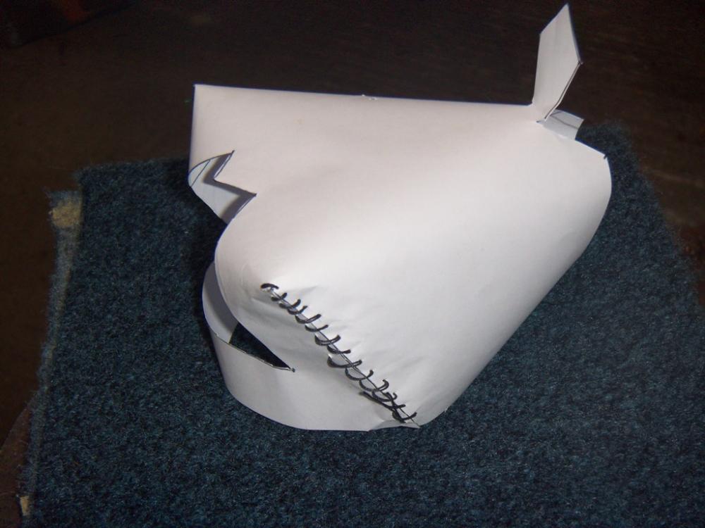

  14. I have been wanting to make a falcon hood out of steel for awhile now. I worked on it a little yesterday and a little more today. The following is how I did it. The sheet metal is salvaged from a 1940's era sheet metal kitchen cabinet. The metal is very thin and I had a heck of a time welding it without burning the thing up, Oxy/Acetylene was the best method for me.
