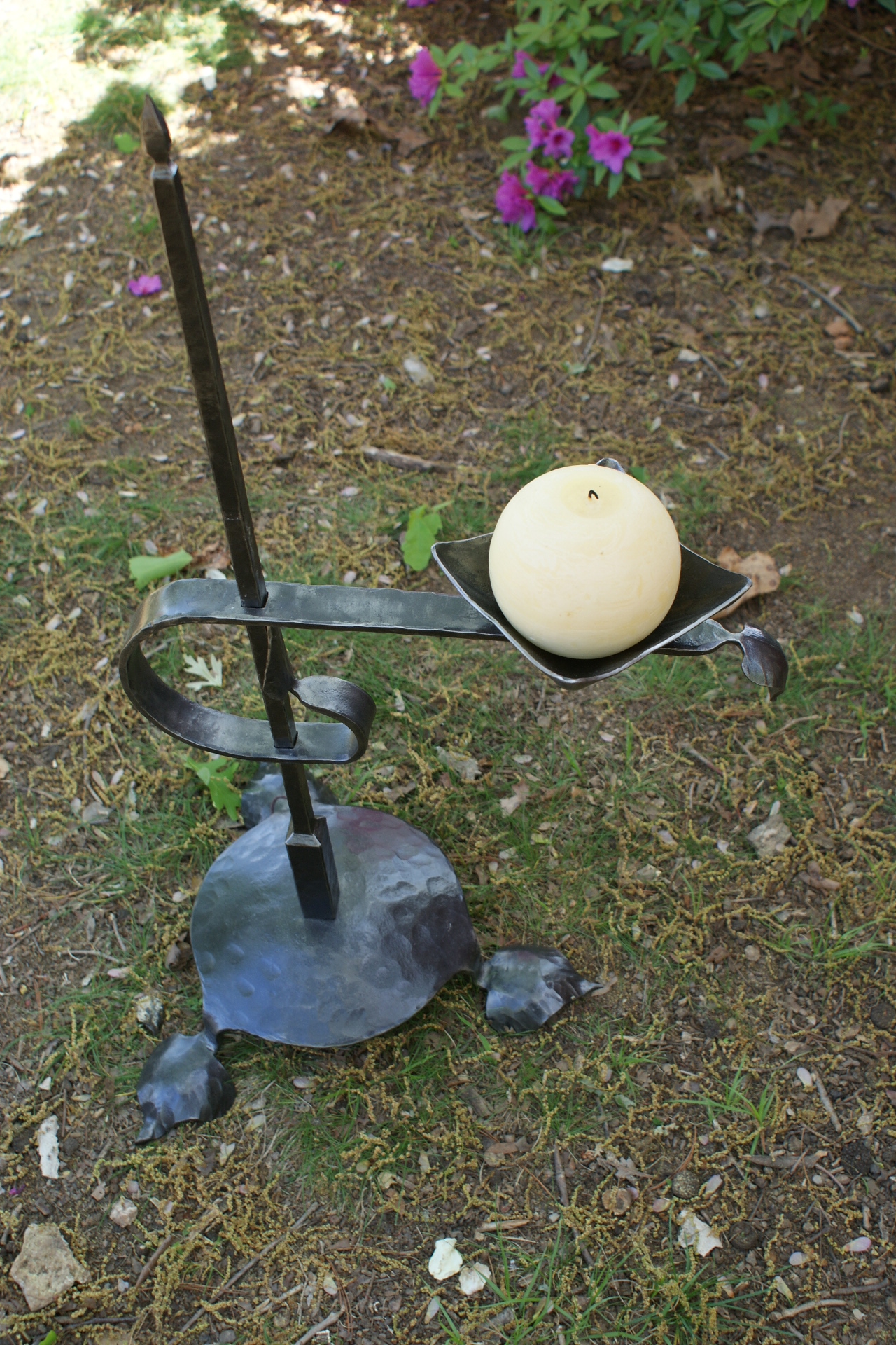

The end is forged square A square hole is punched in the candle cup slightly smaller than the square on the stem ( I used the square tang on a rat tail file as the punch ) Then the candle cup is heated up and shrunk onto the stem -

Thanks Bigfootnampa The candle cup is a separate piece I am pretty far from being good More like approaching average I'd say -
Show Me Your Candle Holders
yesteryearforge replied to Forging Carver's topic in Blacksmithing, General Discussion
A rather large candle holder About 24 inches tall with a 5 inch diameter round candle. Adjustable ( can be slid up or down to adjust the height ) -

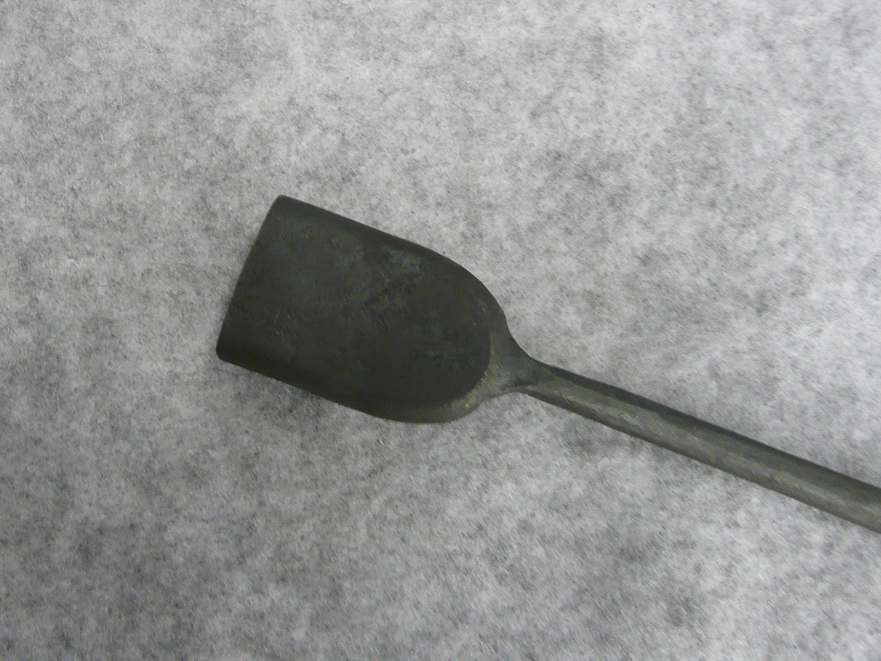

Here is a little Flux Spoon that I made to hang at the forge Approx. 10 inches long with a 3/4 X 1 inch shovel on the end with about 1/8 inch tall sides Thought it would be different than your everyday flux spoon

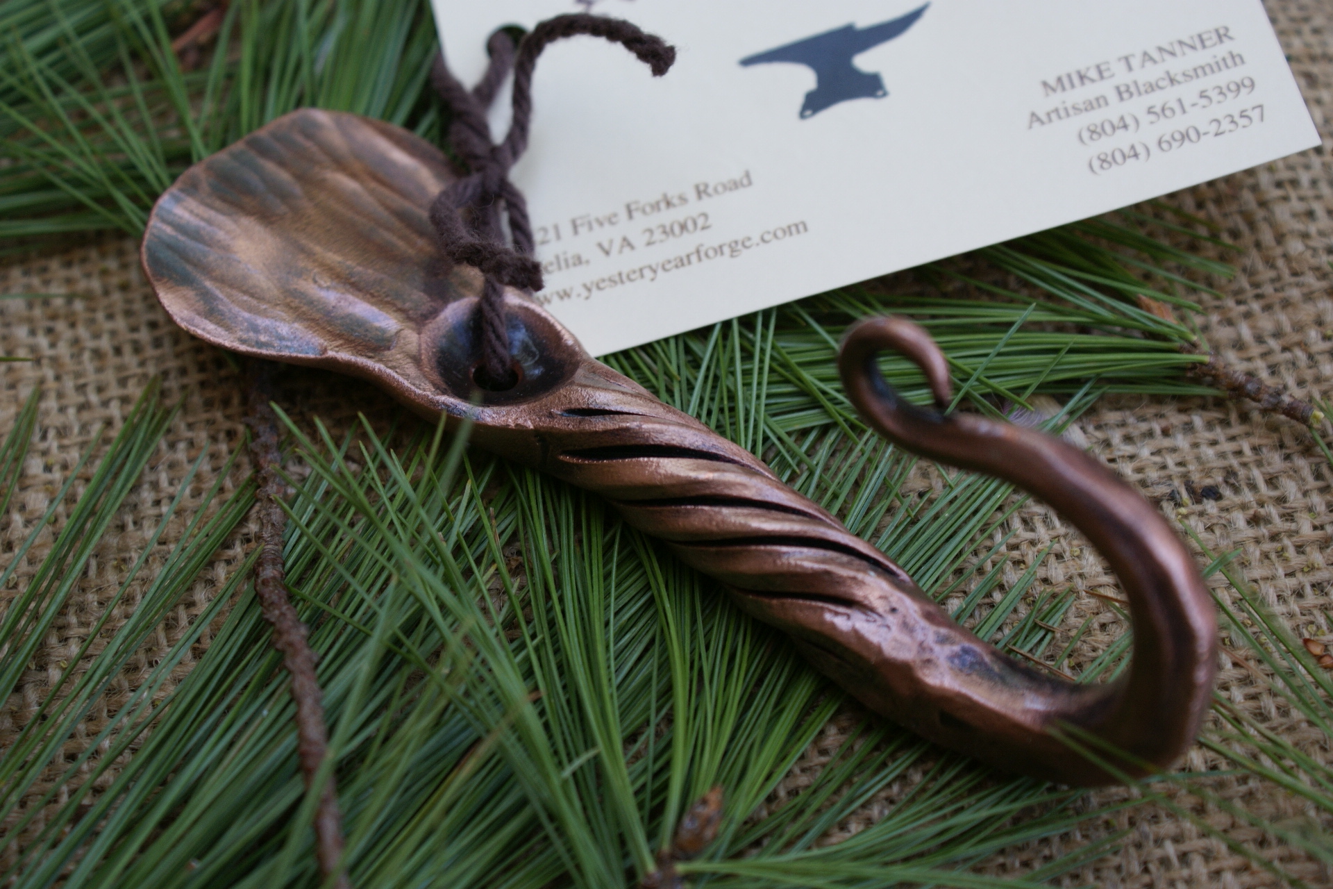

Copper Bowl on a trillium leaf base
yesteryearforge replied to yesteryearforge's topic in Copper Alloys
Thanks everyone Frosty It was forged Hot -
Thanks Jim It was rather fun to make It actually started out as 1/2 inch thick stock / final finish is clear lacquer Mike -
Bowl is approx. 3/8 thick copper and the Trillium leaf base is approx. 1/8 to 3/16 thick assembled with a large copper rivit
