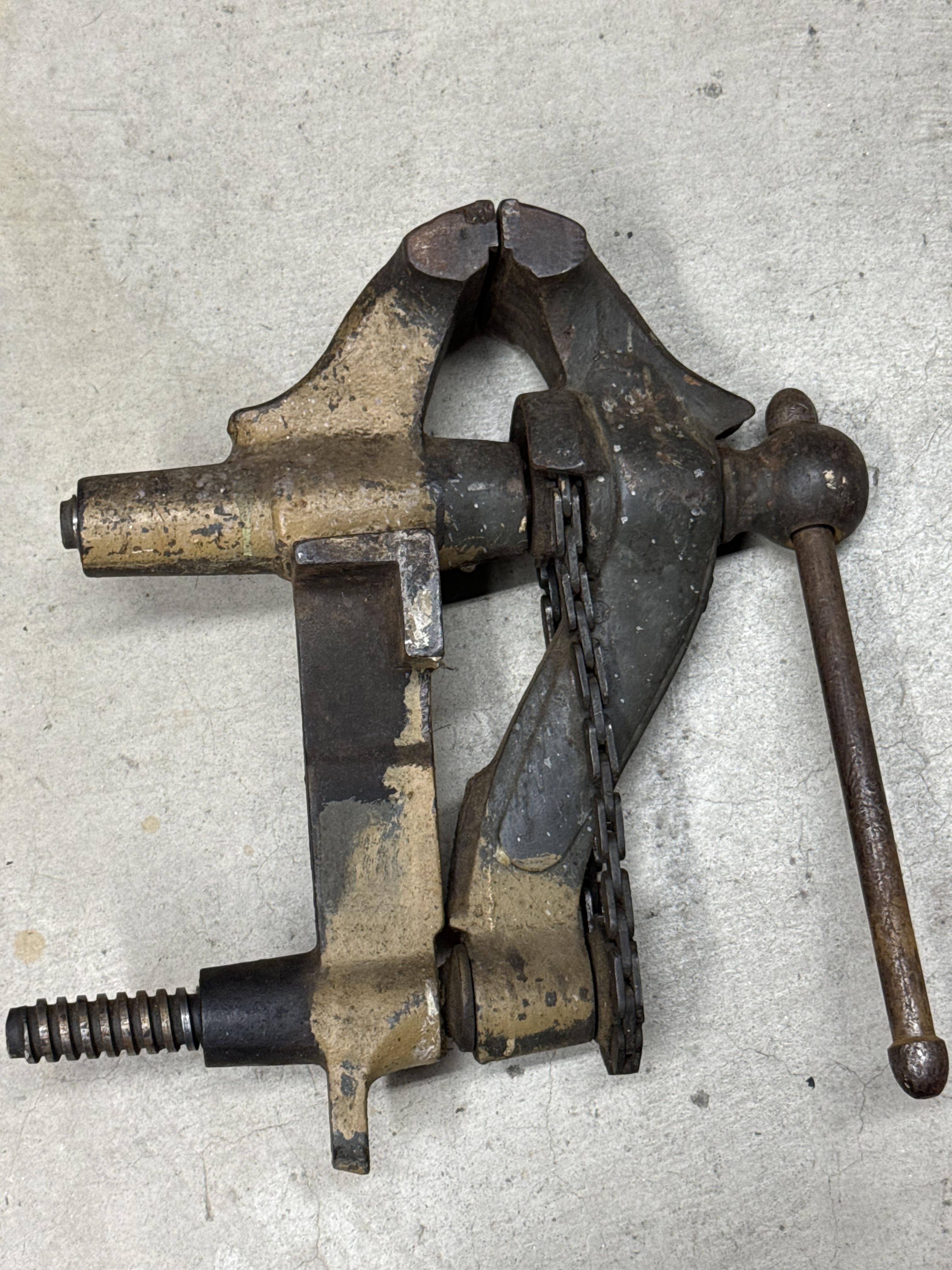

  2. Found a smaller chain-driven twin screw vise today, and was hoping someone could help me identify the maker. Its jaws are around 4 3/8 inches, it has no post, and one of the jaws has a number 3 in the casting, which would be consistent with a Fisher size-wise, but the style is a little different from other Fisher vises I have seen, and it uses a different, narrower chain. Any thoughts/wisdom?
  3. Here's the long overdue epilog to this post/inquiry. I was able to find an old-time machinist in New Hampshire (where I live) who has quite an amazing collection of older lathes, mills, etc. that he's picked up as industrial facilities have closed down over the years. His machine collection includes some surprisingly large pieces of equipment. I took the vise to him, thinking he could help me to create a large tap that I could use to clean up the interior threads on the upper screw. After some consultation, we decided instead to bore out the upper female screw hole and install a bronze replacement bushing that would be tapped to the correct thread size. He was able to create a new upper male screw with the correct buttress thread and create and install a matching threaded bronze female piece in the vise body. Today, I finished reassembling the vise, which now opens and closes properly, and will hopefully last another hundred or so years. Economically, it was probably not a good idea to buy and repair this old Fisher vise, but not every decision is economic in nature. There aren't so many of these old Fisher number 6 vises left, and I'm glad this one didn't end up in the scrap pile. Here's a couple of pics of the vise installed on a stand fabricated for it. If anyone wants more detail, I know have a pretty good working knowledge of how these vises come apart and go back together.

  5. Another thing to keep in mind is that if you’re forging and heat treating in open air, some of the carbon in the outermost surface of your work can get sucked out of the steel and react with the oxygen in the air. This sort of surface decarburization will mean that the outer surface of the work won’t have enough carbon to harden and so the tool can seem soft to a file test until you file through the decarburized layer. 1045 doesn’t have that much carbon to begin with, and you could easily have a couple of thousands of surface decarb. You might try filing a bit to see if it’s hard (or harder) underneath. Btw, you didn’t say: did you file test the tool before you tempered it?

  8. I have a Fisher No. 6 (8.25 inch jaws) that has, alas, seen better days. In particular, the upper screw, which is maybe 1.5 or 1.75 inches in diameter, is very badly worn. Worse, the female part of the vise, where this upper threaded bar inserts, is also very badly worn. The worn out male and female threads on the upper screw make the vise quite difficult to operate, such that it takes a great deal of effort to loosen or tighten the vise. It looks like, originally, the female threads were cut directly into the cast iron vise body. There is no removable bearing or cartridge, which would facilitate repair. To make matters worse, the threads on these screws are something like 3-threads-per-inch, which is beyond the capability of my modest SB 13 lathe. (Not that I'd have any xxxxxxxx idea how to mount the vise body and recut cut the interior threads anyway.) Part of me wants to throw in the towel, as getting this thing working right doesn't seem like an easy project. On the other hand, these big old Fisher vises are really cool, and I would love for there to be one more of them still working in the world. It occurred to me that one option would be to bore the female threads out of the inside of the vise body, and then have the correct female threads cut into an appropriately sized length of schedule 40 steel pipe, which could then be brazed, or possibly pinned, into the bored-out vise. Of course, I'd need to find a shop that could replicate the vise screw (the male piece) and cut matching interior threads on a piece of steel tubing/pipe. I would guess this wouldn't be too difficult a task for a shop with a big lathe that is able to cut acme threads (or whatever xxx xxxx kind of threads Fisher used on these vises) at 3 tpi. (Uninformed guesses being one of my specialties.) Before diving in on something like this, I figured I should subject myself to public ridicule here. Has anyone undertake a repair of this type before? Any thoughts, wisdom, or suggestions? Is there an easier or better way to go about this? Can anyone recommend a competent, honest machine shop that might be willing to do the necessary machine work? (Alternatively, does anyone have a NOS Fisher No. 6 vise laying around that they want to see in a good new home?) Thanks much.
