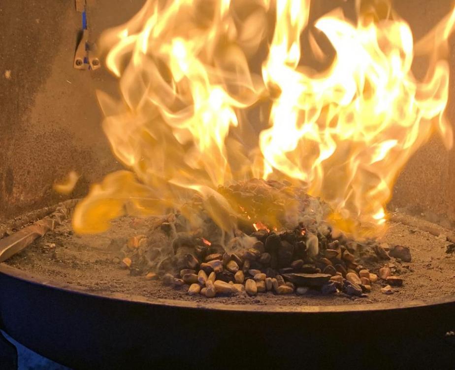

nashdude Posted January 10, 2009 Share Posted January 10, 2009 Someone mentioned this yesterday, and it sounded like a really interesting alternative to coal or charcoal. I know a few of you have tried this, so if you wouldn't mind, I'd like some comparison (especially since I can get yellow feed corn for $6.75 per 50lb hehe) 1) How hot will a corn fire get compared to a charcoal or coal fire? 2) Will a corn fire get welding hot, or just forging hot? 3) How FAST will a corn fire get forging hot? 4) How fast will a corn forge go through fuel compared to a coal forge? How fast will a corn forge destroy its fuel compared to other forges? What I'm looking for is as indepth an analysis---effectiveness of fuel, durability, cost comparison---as I can possibly find. It won't matter much to the overall design of my forge. I just want to be fully informed on what my options are, pros and cons. Quote Link to comment Share on other sites More sharing options...

Frosty Posted January 10, 2009 Share Posted January 10, 2009 A number of guys have used corn in their forges and most say it behaves more like coal than charcoal as it sticks together like coking coal. It'll weld. I don't recall any comparison for consumption vs. work done. That'll be up to you so please let us know what you find out. Take careful notes, we like good data. Frosty Quote Link to comment Share on other sites More sharing options...
Archie Zietman Posted January 10, 2009 Share Posted January 10, 2009 Wullo! In my experience corn works just like coal. It burns at the rate of charcoal, and the flame from the burning gasses is very very large. It definitely gets up to welding heat, and you can burn steel in the heat. be merry, Archie Quote Link to comment Share on other sites More sharing options...

nashdude Posted January 10, 2009 Author Share Posted January 10, 2009 A number of guys have used corn in their forges and most say it behaves more like coal than charcoal as it sticks together like coking coal. It'll weld. I don't recall any comparison for consumption vs. work done. That'll be up to you so please let us know what you find out. Take careful notes, we like good data. Frosty I'll do my best. Just remember, I'm still a smithing newb, so don't expect super-expert documentation Wullo! In my experience corn works just like coal. It burns at the rate of charcoal, and the flame from the burning gasses is very very large. It definitely gets up to welding heat, and you can burn steel in the heat. be merry, Archie That, my friend, is EXACTLY what I was looking for. If I remember my notes, charcoal is consumed faster than coal, right? Which would mean that although corn behaves like coal, and is similar to coal in regards to heat, you go through more of it faster. Also, if it produces such a high flame, it seems as if it's more volatile than either coal or charcoal. Excellent details. Any others? Quote Link to comment Share on other sites More sharing options...

ChrisB Posted March 23, 2009 Share Posted March 23, 2009 I had a dedicated corn stove for two winters. It kicked out some serious heat. Clinker was an issue and the exhaust had a delightful smell very similar to burned microwave popcorn. I got rid of it once the local grain elevators started to only sell corn in $5.00 50lb bags vs. the 66lb bushel at market price that at the time was around $3.50 One would need a electric blower from what I've seen corn is like coke and needs that constant air. Quote Link to comment Share on other sites More sharing options...

NateDJ Posted March 24, 2009 Share Posted March 24, 2009 In my experience Corn will burn very fast compared to coal, It will burn very hot though. It sparks just like or a bit more than charcoal so watch out for that the best part is that it sticks together even better than coal. I can make a 5 Gal bucket of coal last ~8 hours easily but it will take the entire bucket of corn in about 1 - 1.5 hours. If you had a way to use the corn gasses you could do more with less t would think. I have had no time to look into building a biogasser yet though. Quote Link to comment Share on other sites More sharing options...
