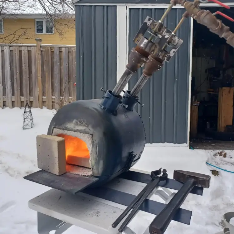

ZBarrett Posted March 28, 2023 Share Posted March 28, 2023 Sorry its been awhile since I was on. Life has been not very friendly to my honby. I made a propane forge for forge welding but I can't get it hot enough. I've been tweaking and adjusting my burners and still nothing. The forge chamber size is 5x5.5x11, I have a double burner set up. 9" long pipe with 0.04 might tips. Burner flame looks good, I have the orange dragons breath out the front. Even blocked off I can't get a piece of 1/4" to welding temp. Any help would be appreciated. oh forge is well insulated with 2" of kaowool. Sealed castolight , and coated with its 100ht Sorry forgot to say the burner is 9" 3/4 pipe down to 3/4:1 reducer with threads removed on the 1" side. Quote Link to comment Share on other sites More sharing options...
Mikey98118 Posted March 28, 2023 Share Posted March 28, 2023 Things you can do at this point: (1) Change the burner intakes out for pipe reducers that are larger. I estimate that your present reducers only provide a two to one reduction. You would be better off with a tree to one reduction; this will increase swirl at the air intake to the burner's mixing tubes, providing much better mixing of propane and air. (2) Build a flat washer for each burner's mixing tube, with a a nut welded or brazing it on a flat washer, so that you can use a machine screw through it to put pressure against the mixing tube it slides back and forth on. Use these sliding chokes to control the flow of secondary air into the forge to only what is needed for complete combustion. Uncontrolled secondary air can cool forges down quite a lot. Quote Link to comment Share on other sites More sharing options...
LeeJustice Posted March 28, 2023 Share Posted March 28, 2023 Look closely at his picture #2 Mikey, I think that I see just what you are mentioning for your second suggestion. Quote Link to comment Share on other sites More sharing options...
tinkertim Posted March 28, 2023 Share Posted March 28, 2023 I think you might have missed Mikey's point, Lee. He is referring to the point on the 9" x 3/4" mixing tube where it goes into the forge, just above the 4 bolts in a cross, used to retain the burner in the forge body, not the washers above the jets which affect the flow of primary air into the top of the burners. There is a gap where the burners meet the forge body and extra secondary air can get into the forge at this point and affect the fuel/air mixture and combustion. Hope that makes it clearer. Tink! Quote Link to comment Share on other sites More sharing options...
LeeJustice Posted March 28, 2023 Share Posted March 28, 2023 I see, there are big air gaps all around the mixing tube and holder. Quote Link to comment Share on other sites More sharing options...
Mikey98118 Posted March 28, 2023 Share Posted March 28, 2023 2 hours ago, tinkertim said: There is a gap where the burners meet the forge body and extra secondary air can get into the forge at this point and affect the fuel/air mixture and combustion. Exactly, and it is a pretty large diameter gap, too. What most people don't know is that the flame will induce air into the forge, through that gap, every bit as well as the gas stream induces air into the burner's mixing tube. Most burners end up needing a little secondary air, but those burner openings will allow the passage of a LOT of secondary air, cooling the forge down quite a bit. Quote Link to comment Share on other sites More sharing options...
Frosty Posted March 28, 2023 Share Posted March 28, 2023 Who's plans did you follow for the burners? What I see is a goodly dose of the "if a little is good more must be better" philosophy. The basic ratio for mixing tube dia. is 8:1 that is 8 x the DIAMETER of the tube. 8x.75 = 6, not 9. The ratio does NOT mean 8". Then comes the "more is better," think and makes it 9". A 9" mixing tube is 1.5 times the optimum length and hurts induction. The nipple screwed into the bell reducer is reducing the intake diameter of the burner reducing induction. The increased depth also reduces induction. Just losing the crud on the intake and mounting the jet and choke bridge directly to the outside edge of the bell reducer will go a LONG way to making it work effectively. If you replace that bell reducer with a 3" x 3/4" bell reducer you'll be styling. Last change Mike hasn't covered nicely above. A 0.040 mig tip is another face of "more is better" causing more harm than good. Most of the old school linear burner Gurus like Ron Reil only messed with gas jets (mig contact tips) larger than 0.025 because they had to change their designs too much to get 0.030" to work effectively. Frosty The Lucky. Quote Link to comment Share on other sites More sharing options...
ZBarrett Posted March 29, 2023 Author Share Posted March 29, 2023 I got the basic design from on line. I should of asked more questions before I built the burners. Thank you for all the advice. I'll be hitting up the plumbing store to get a couple new bell reducers and nipples to shorten my mixing tubes. I have already closed up the holders and that helped a lot already. I'll put the .03 mig tips back in as well Thanks again all. Quote Link to comment Share on other sites More sharing options...
Frosty Posted March 29, 2023 Share Posted March 29, 2023 Ask questions BEFORE spending time and money making a thing? Join the club Brother I think everybody who has ever built something has jiggered with it before we knew what we were doing. A good place to start reading is https://www.iforgeiron.com/topic/46536-burners-101/ Right here on good old Iforgeiron. No, don't try reading the whole darned thing, we recommend that for folks we don't like. Skim thread titles till you find one you like then skim the post subject lines. You can get as crazy bout reading as you like but you'll find out who knows their stuff and who's trying to be helpful without knowing much. (Yes, I've been both<sigh>) We don't like discouraging folks trying to be helpful but you have to sift the chaff for the nuggets. Frosty The Lucky. Quote Link to comment Share on other sites More sharing options...
Mikey98118 Posted March 29, 2023 Share Posted March 29, 2023 6 hours ago, Frosty said: The basic ratio for mixing tube dia. is 8:1 that is 8 x the DIAMETER of the tube. 8x.75 = 6, not 9. The ratio does NOT mean 8". Then comes the "more is better," think and makes it 9". A 9" mixing tube is 1.5 times the optimum length and hurts induction. I have used nine diameters on three different types of burners, and found it to work better than eight diameters. However, I have never built a "T" burner. I think the rules need to mach up with the various different flows in burners of different designs. And of course It is easier to cut a mixing tube one inch shorter, than to add an inch So, what happens if the mixing tube is a LITTLE shorter than optimum length? Nothing terrible; the flame just isn't as smooth. So, who is right and who is wrong here, doesn't matter to me. Quote Link to comment Share on other sites More sharing options...
Frosty Posted March 29, 2023 Share Posted March 29, 2023 Yeah, the original info I got said 8 to 9 x dia. That was throat diameter on a tapered tube but 8or9x works well. Just like short tubes tuning is what really makes them work. Ts are flexible, more so than linears in fact. I developed the T burner from a vacuum pump inducer and had to detune it considerably so making the tube longer or the burner faster is easy, almost harder not to do. Needing to be detuned to work as a burner is why I picked a jet ejector in the first place and the T itself rather than a single intake port in fact. Having lots of intake air available meant I could double the jet size, reduce pressure and put more flammable mixture in the forge per second than a comparable size linear or "sidearm" type ejector. Better than that, the flame is moving much slower so it stays IN the forge longer. All those are a real plus to my greedy little soul but the T is as simple a burner as I could think of and requires the least shop skills and equipment. Frosty The Lucky. Quote Link to comment Share on other sites More sharing options...

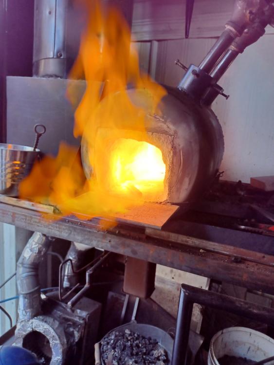

ZBarrett Posted April 2, 2023 Author Share Posted April 2, 2023 So completed my alterations to the burners on the forge. She welds!! Props to the Frosty burners. I was able to salvage the brackets to hold my manifold, and it made tuning the burners easy without having to cut the welding tips. Thanks again for all the help guys. Quote Link to comment Share on other sites More sharing options...
Mikey98118 Posted April 2, 2023 Share Posted April 2, 2023 I like your choice of latch. If, you find the need of some secondary air, just drill small holes in those sheet metal covers, one at a time, until you are satisfied with the result. So far, your forge seems to be doing just find without them. Quote Link to comment Share on other sites More sharing options...
Frosty Posted April 2, 2023 Share Posted April 2, 2023 Maybe not how I would've done it but if it works you did it right. Congratulations! Frosty The Lucky. Quote Link to comment Share on other sites More sharing options...
