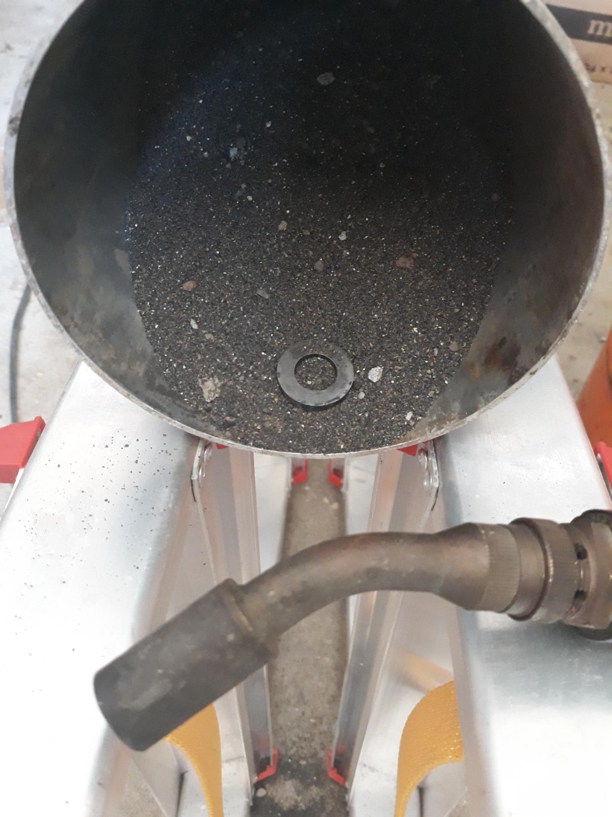

    Hi, it's a pity that someone sees me as a spammer, but it's all about hardening rings.
I did that in this way, the aluminum barrel with sand and heated the ring with a burner.
Red/orange and then in the water.
File test, and the ring seems hard!
Conclusion, the material can be hardened and actually the solution to my problem in this way. I'm going to build a box with sand anyway, it's childishly simple and a nice hobby to tackle some sturdier things.
photo!

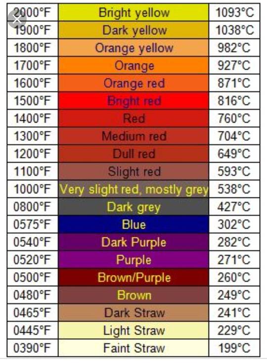

    My question is that the color of the material when heated with the burner also indicates the temperature of the material at that moment, in this case it is steel.
The color orange, what temperature does it convey?
Blue/purple, I've also seen passing by.
Best, caboverde

The blue/purple color you mention is a tempering color. Tempering comes after hardening to release some of the stresses caused by the quench. Tempering colors are easiest to see on bare (freshly ground/sanded) steel.

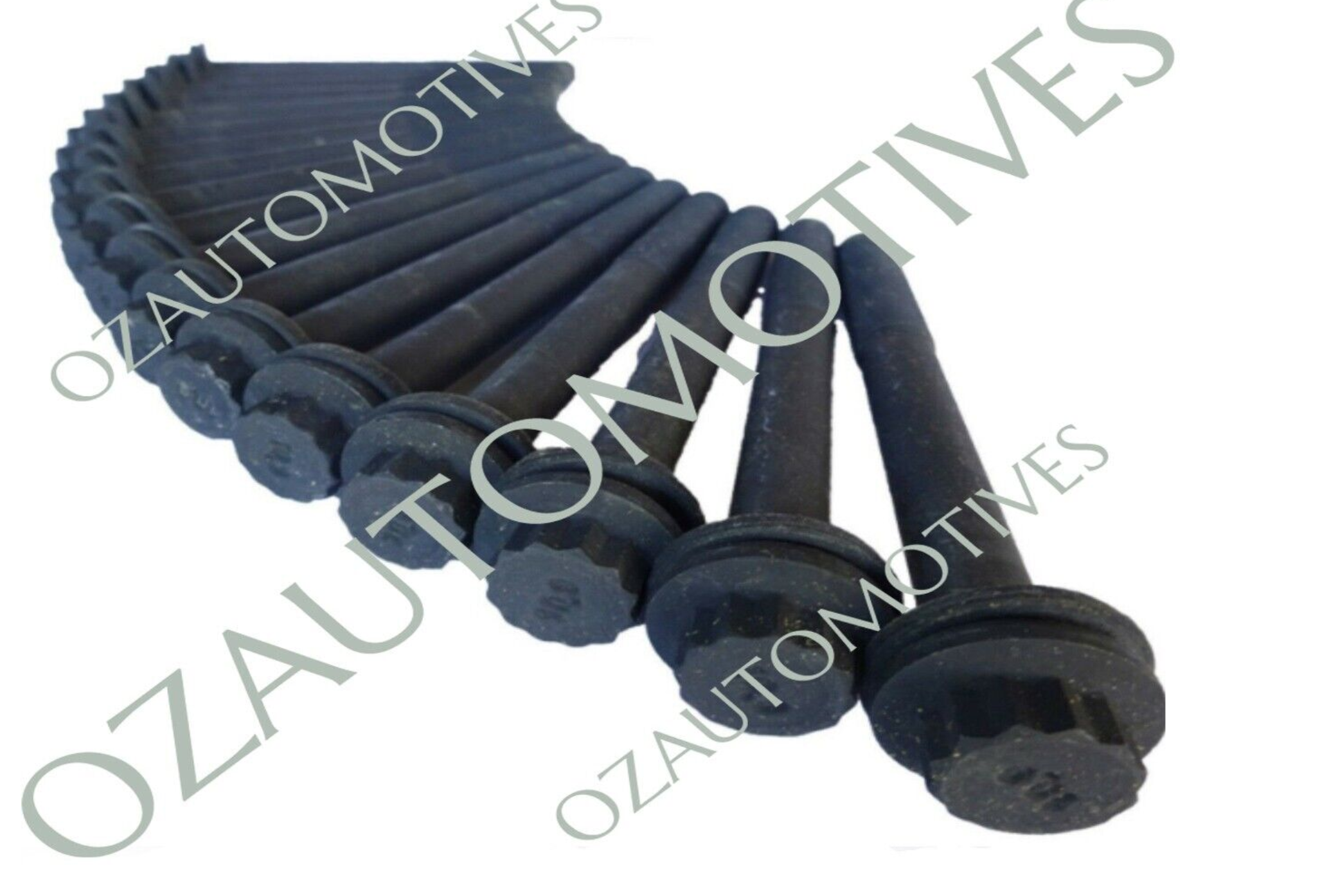

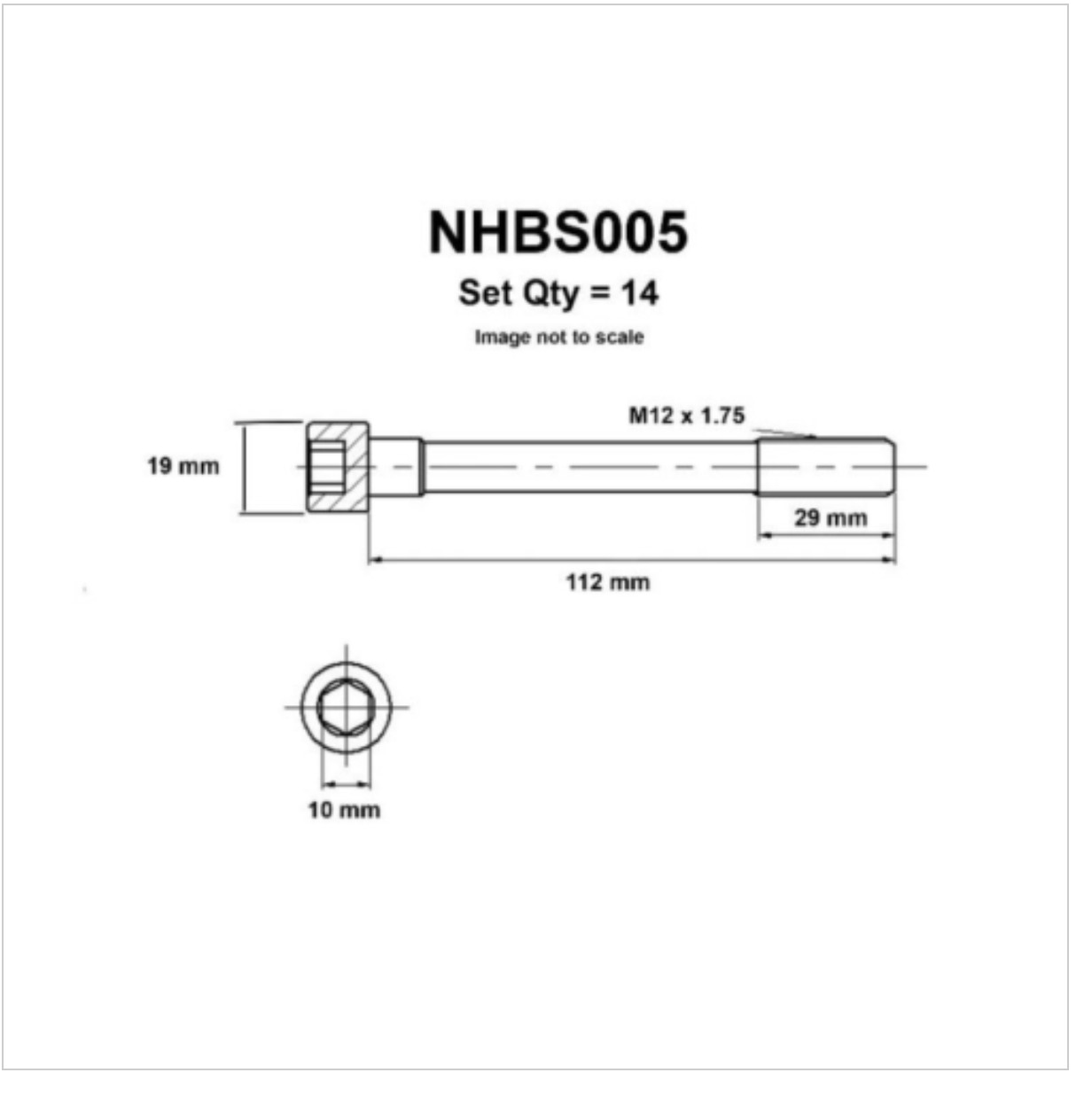

Are you sure there were washers on there originally?
Do the old bolts look like this:
or like this:
Both of these come up for that vehicle, although the ones with washers are apparently for the non-turbo version.
If they're like the first image then, assuming they aren't excessively worn/damaged, I'd reuse the old washers (not the bolts, obviously). If it's the second one then I would be surprised if there were washers there in the first place. Regardless I would still reuse the washers before trying to reinvent the wheel.
No, that like bolts of Toyota. I have an 4.2 diesel truck and the same bolts for the head and it is steel. The friction is exactly very important, the head is alluminium and need washers.
The second photo that's Nissan, and here all parts are for Toyota. That is the problem.
