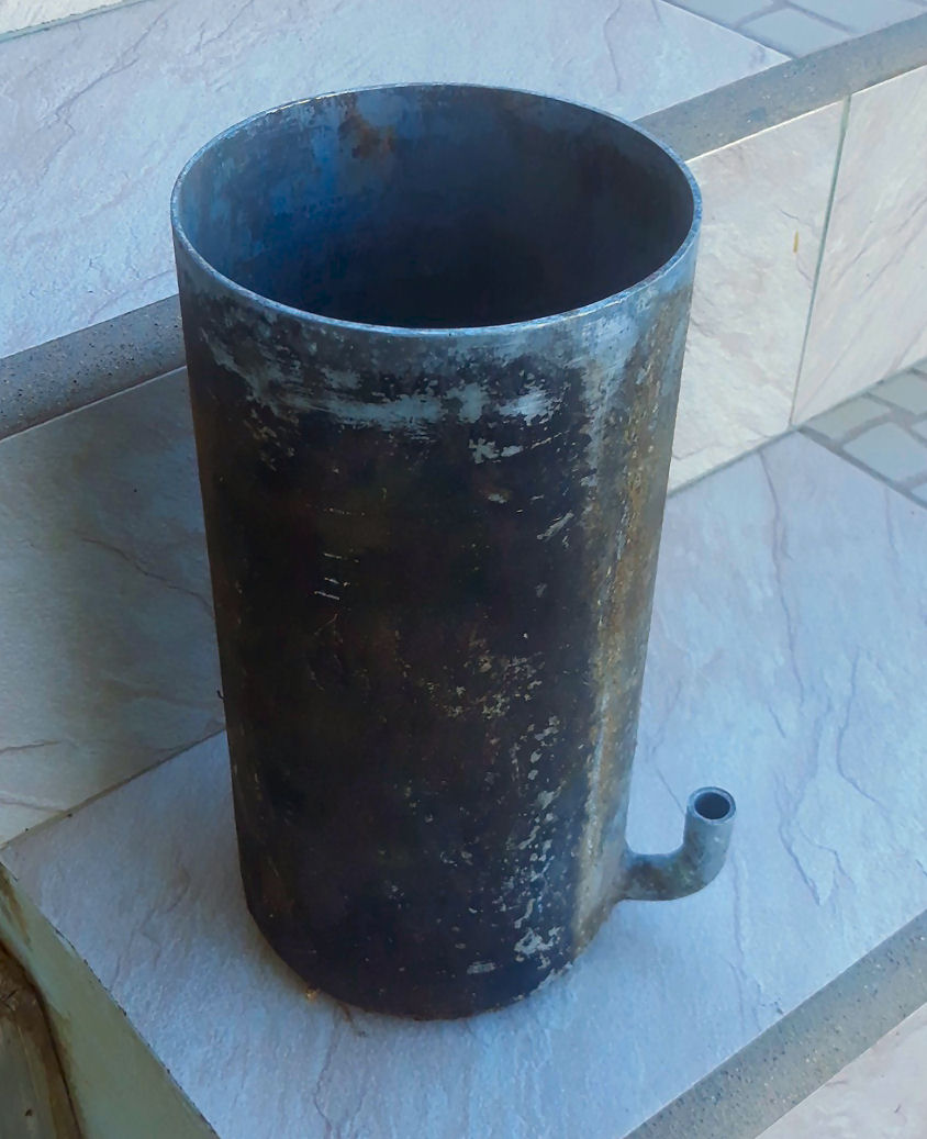

  5. Red/orange, I think it's enough for my simple washers. But important, because the cylinderhead is alluminium and de torque value for the bolts are 120 N/m.
  6. About the washers! My question is that the color of the material when heated with the burner also indicates the temperature of the material at that moment, in this case it is steel. The color orange, what temperature does it convey? Blue/purple, I've also seen passing by. Best, caboverde
  7. Hi, it's a pity that someone sees me as a spammer, but it's all about hardening rings. I did that in this way, the aluminum barrel with sand and heated the ring with a burner. Red/orange and then in the water. File test, and the ring seems hard! Conclusion, the material can be hardened and actually the solution to my problem in this way. I'm going to build a box with sand anyway, it's childishly simple and a nice hobby to tackle some sturdier things. photo!
  8. Thank you, you give me a great idea. Sand, wood, construction material ....etc. I have plenty. I'm going to make something sand based. I'll let you know, and photo of course. Best, caboverde
  9. Interesting, this brings me to go to a smithy with this knowledge, and explain what the intention is. I just can't generate enough heat at the moment, but I will! Surface treatment seems to me to be the most appropriate for this application. I let you know, caboverde.
  10. Thanks for explanation, I understand what is meant. Only I have no provision at the moment to wake up a temperature of 700-800 degrees Celsius. Then I thought about surface hardening! I also cool my drill, which gets very hot, with water, so that it retains its hardness. Then I thought, heat a ring of steel, perhaps Fe42, in a pan with oil on the stove. And then cool down! Something has to be done of course, the oil will be 250/300 degrees. So the structure on the surface will change due to the cooling of the water. I don't know if my view is correct, perhaps surface hardening is a better option for washers under head bolts! All right, caboverde
  11. Hi, the first thing I did and tried was to heat up a pan with old frying fat, it started to smoke nicely. I made the ring super smooth and after a few minutes I shocked it in water, ssstttt... The material now has a slightly different color and even a file makes little impression, at least? Would this be a good method to make the surface harder, and maybe someone can explain to me what happened in physics? Best, caboverde.
