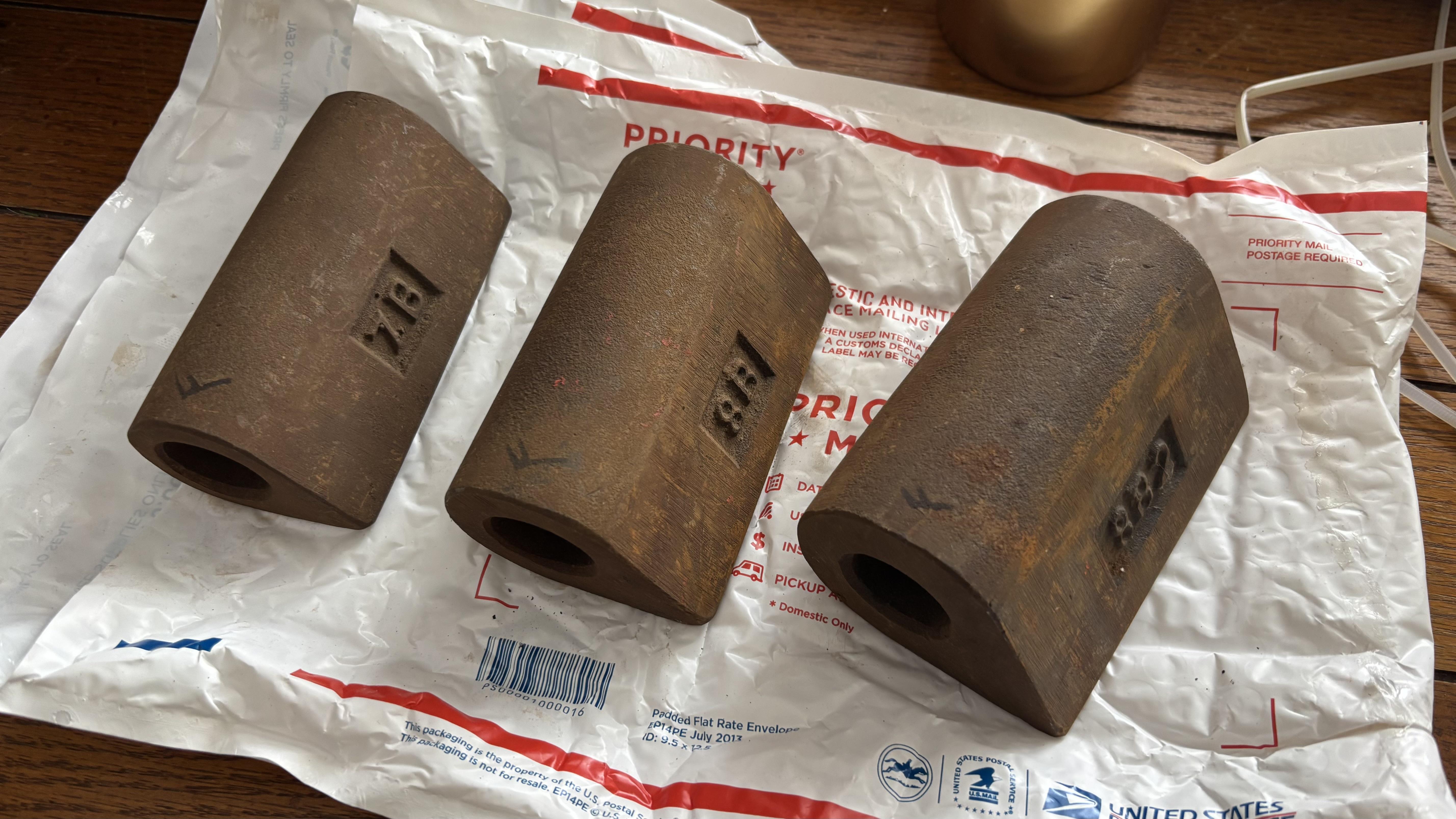

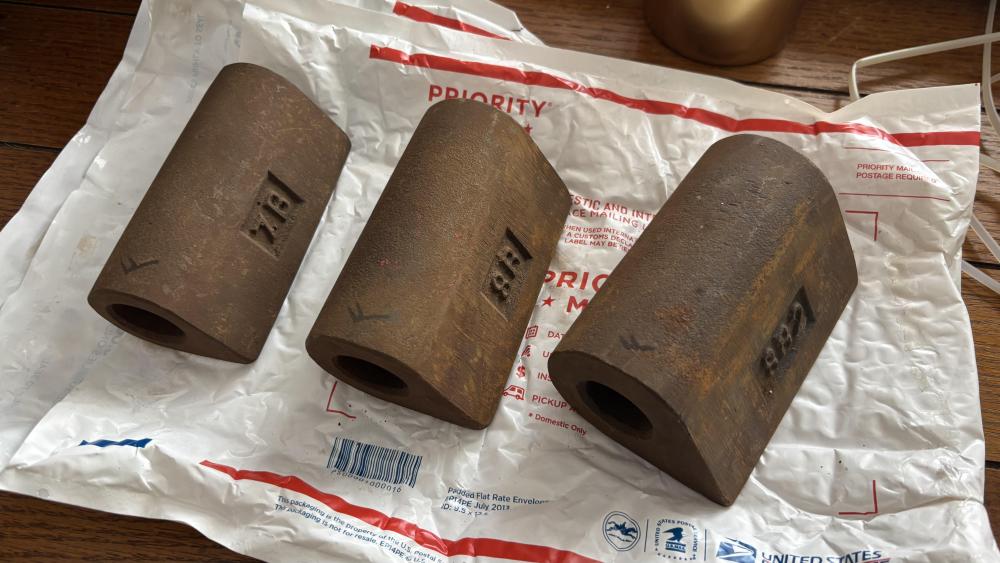

I just purchased a set of three cam dies on eBay, tools #7B, 8B, and 8B2.

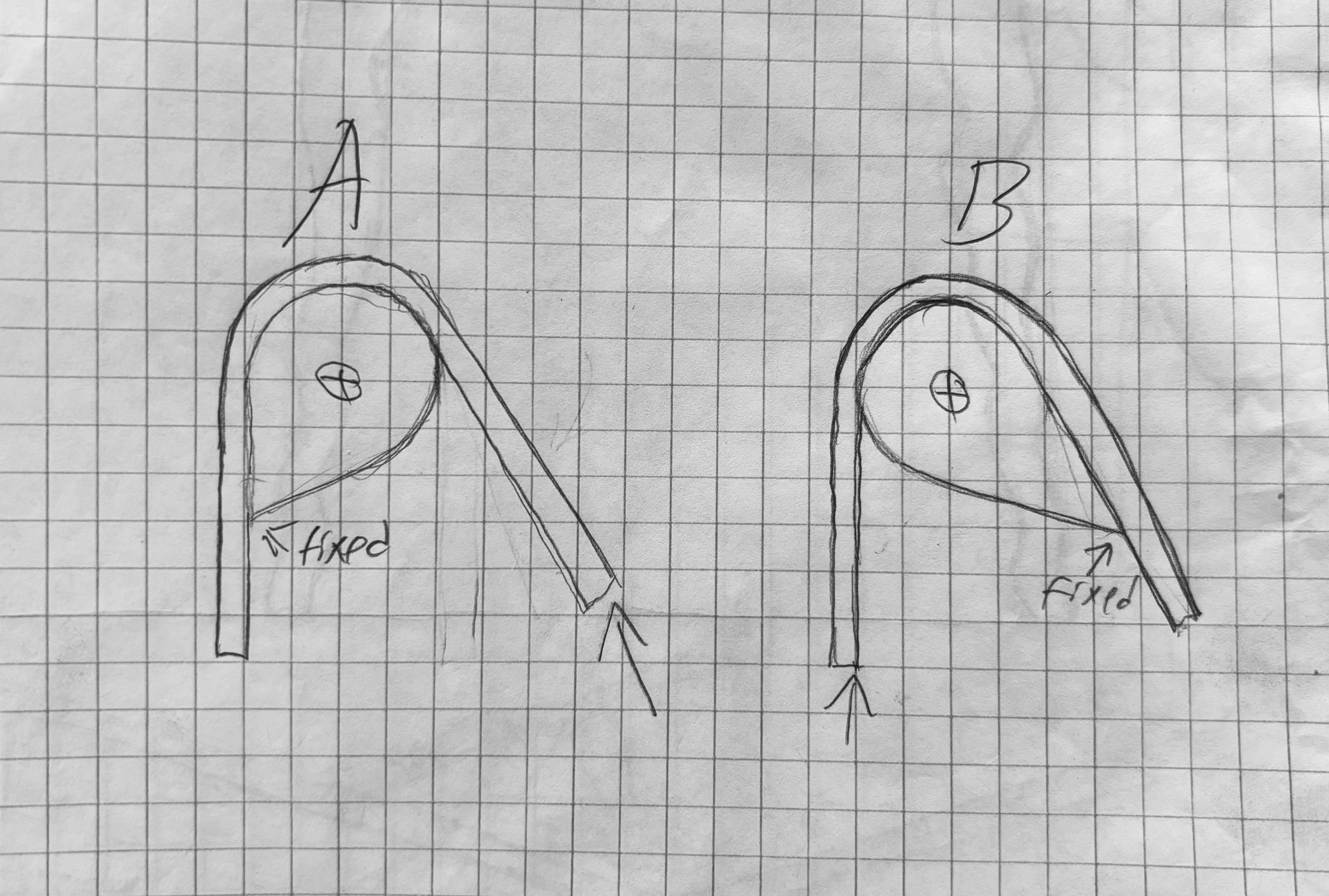

These are ostensibly for bending U-bolts (with interior diameters of 1-3/4”, 2”, and 2-14”, respectively), but will work for any bend in those sizes. The interesting thing about the cam design is that it allows you to control which “leg” of the U is feeding into the bed. That is to say, whichever leg has the flat side of the cam against it is fixed relative to the bend, and stock bends around the other side of the cam:
Thus, in (A), the length of leg on the left is fixed and the leg on the right gets shorter as it wraps around the cam. In (B), on the other hand, the length of leg on the right is fixed, and the leg on the left gets shorter as it wraps around the cam.
This is particularly important for a U-bolt, since the ends of the bolt need to be threaded before the U is bent. By switching the cam from one side to the other, you can tweak the bend to make sure the ends of the legs come out even.
NB: The Hossfeld manual notes that you can bend spacers around the cams if you need to bend larger-radius curves.

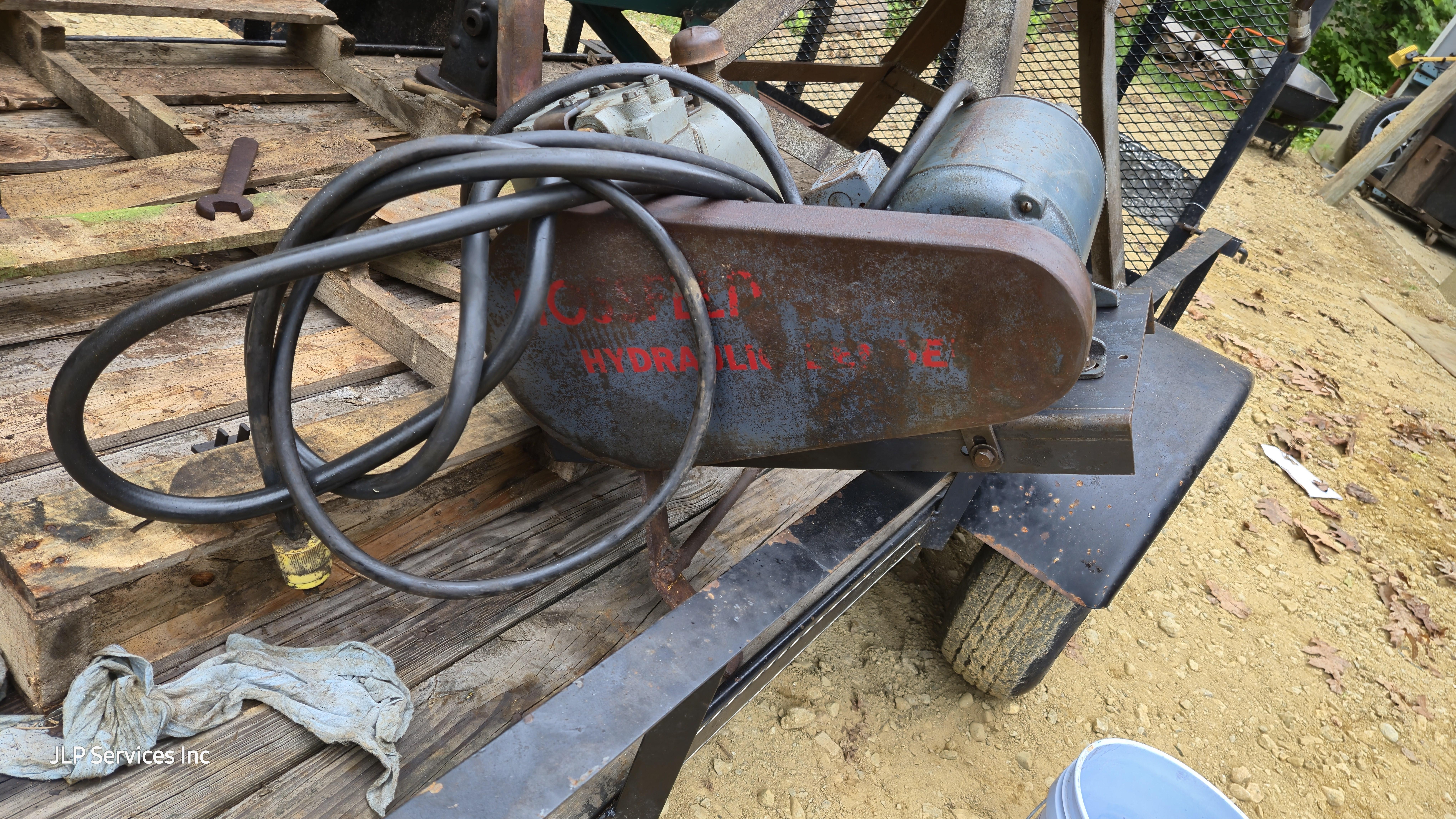

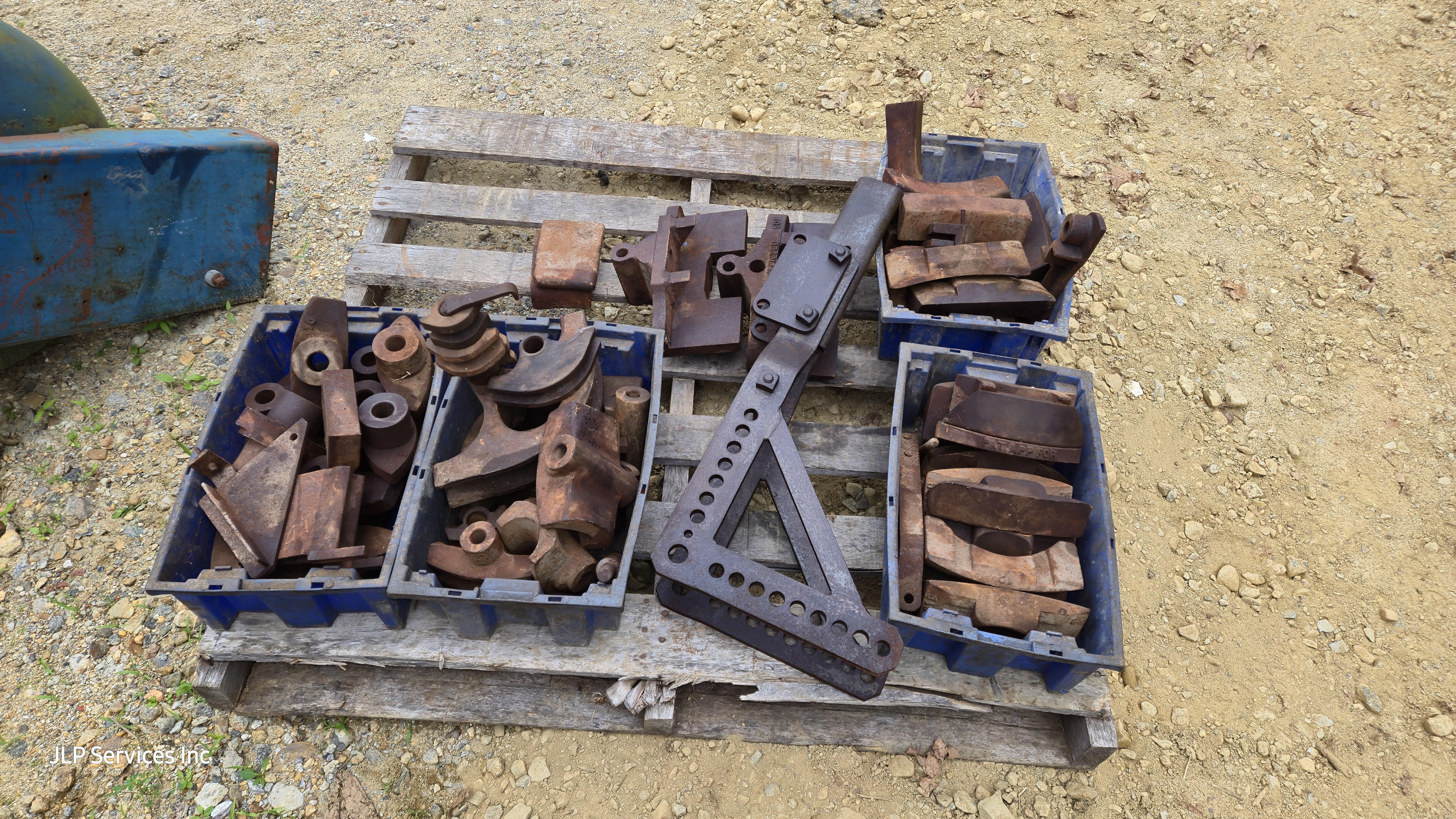

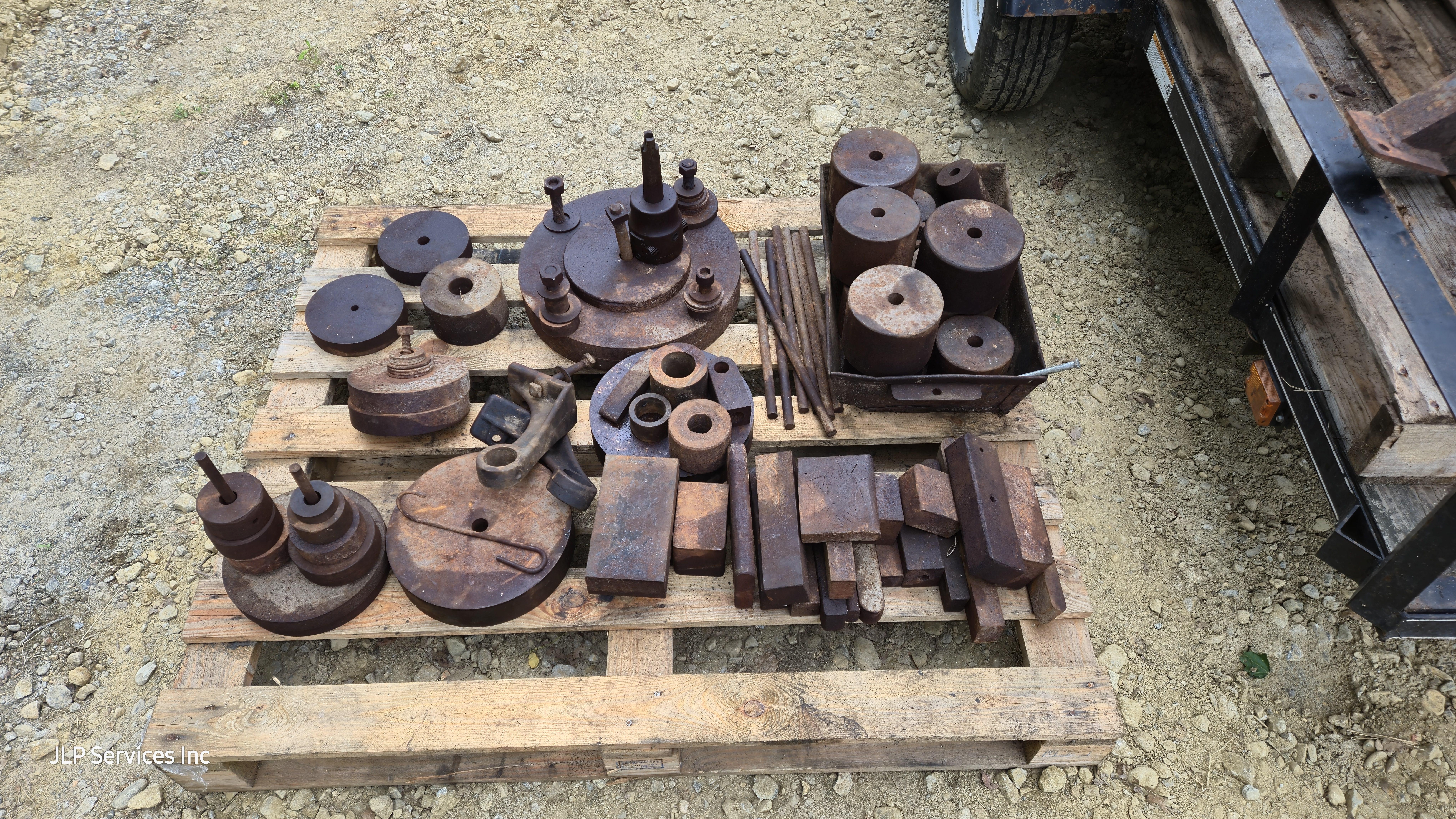

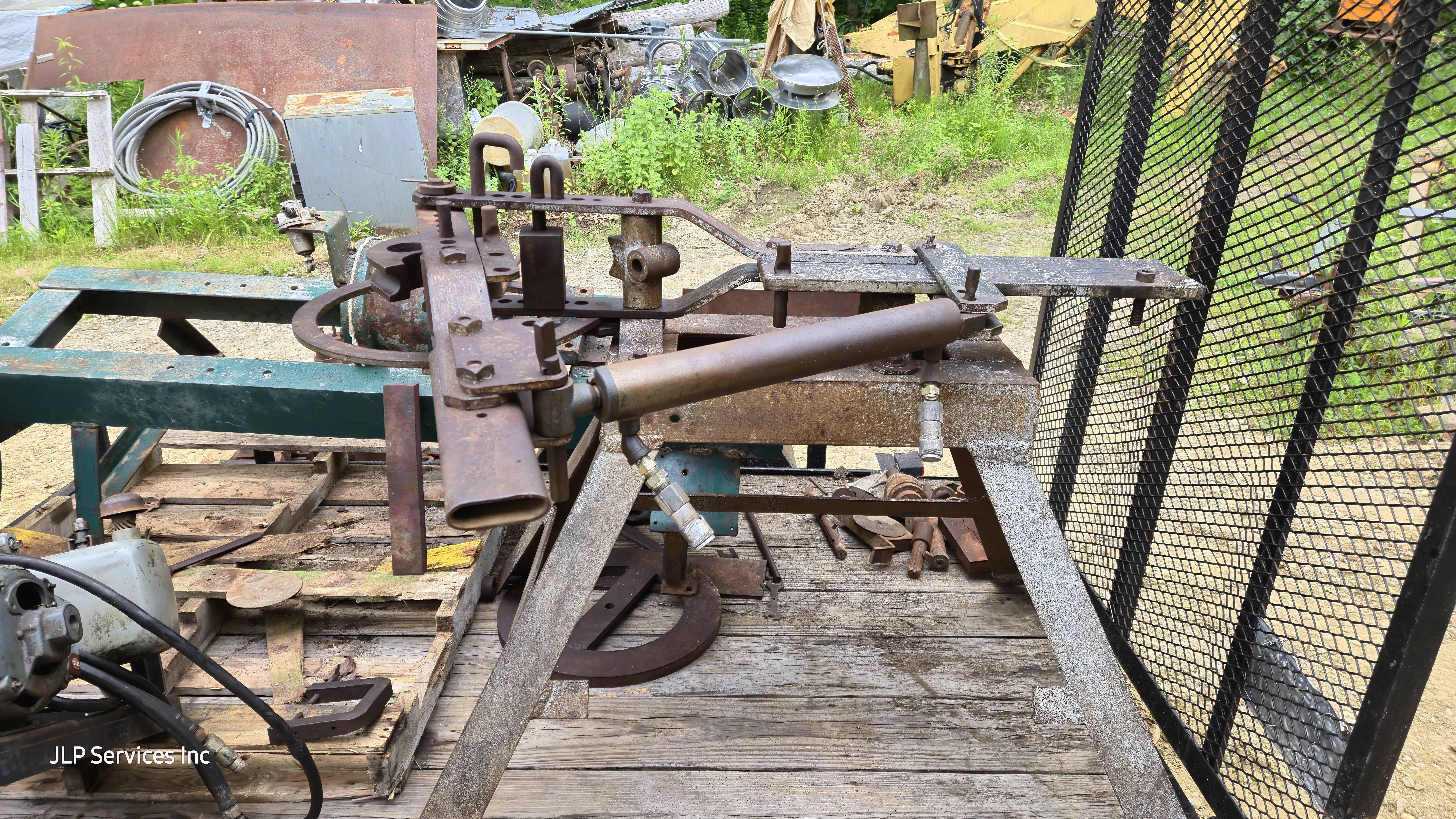

Here is my addition to this thread.
I got a text from one of my friends..  He let me know a mutual friend was cleaning out the shop.

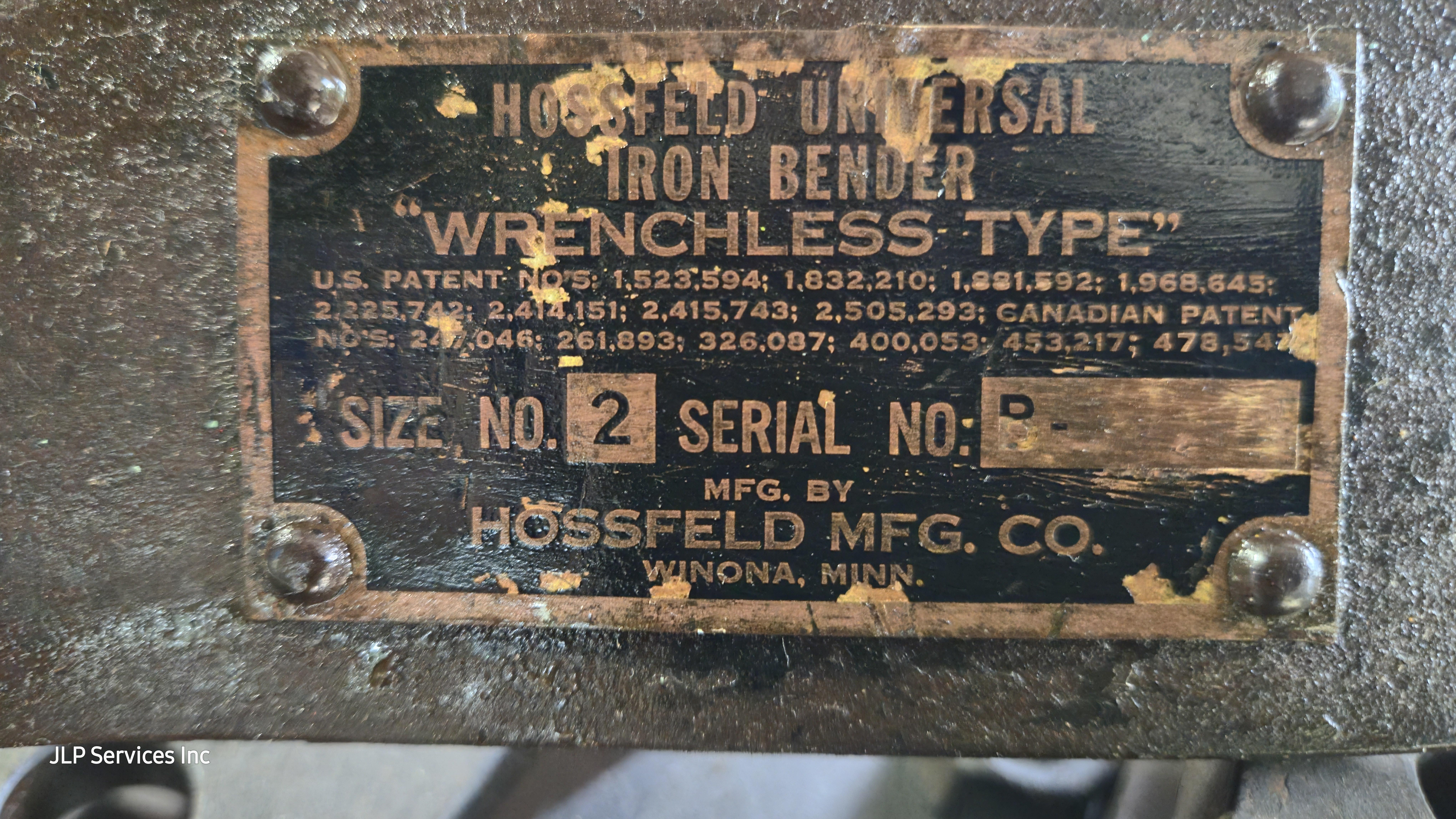

This is the most complete setup I have seen for a Hossfeld #2.
It came from Norton Abrasives in Worcester, MA back in the 90's.
The Hossfeld company changed hands about 10 years ago and all the old records were thrown away.  So there is no MFG date and no support for these older benders in terms of serial numbers nor hydraulics..
