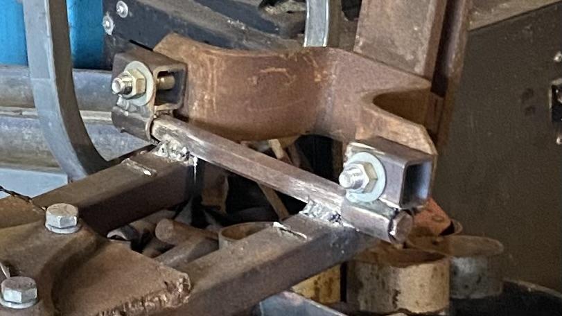

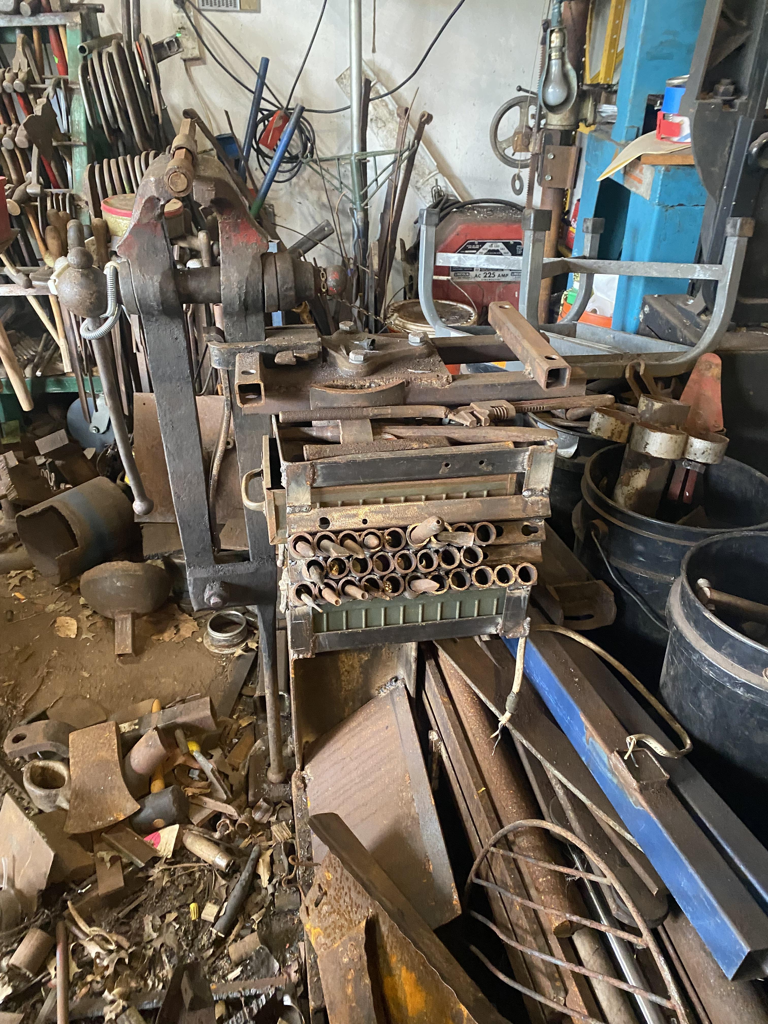

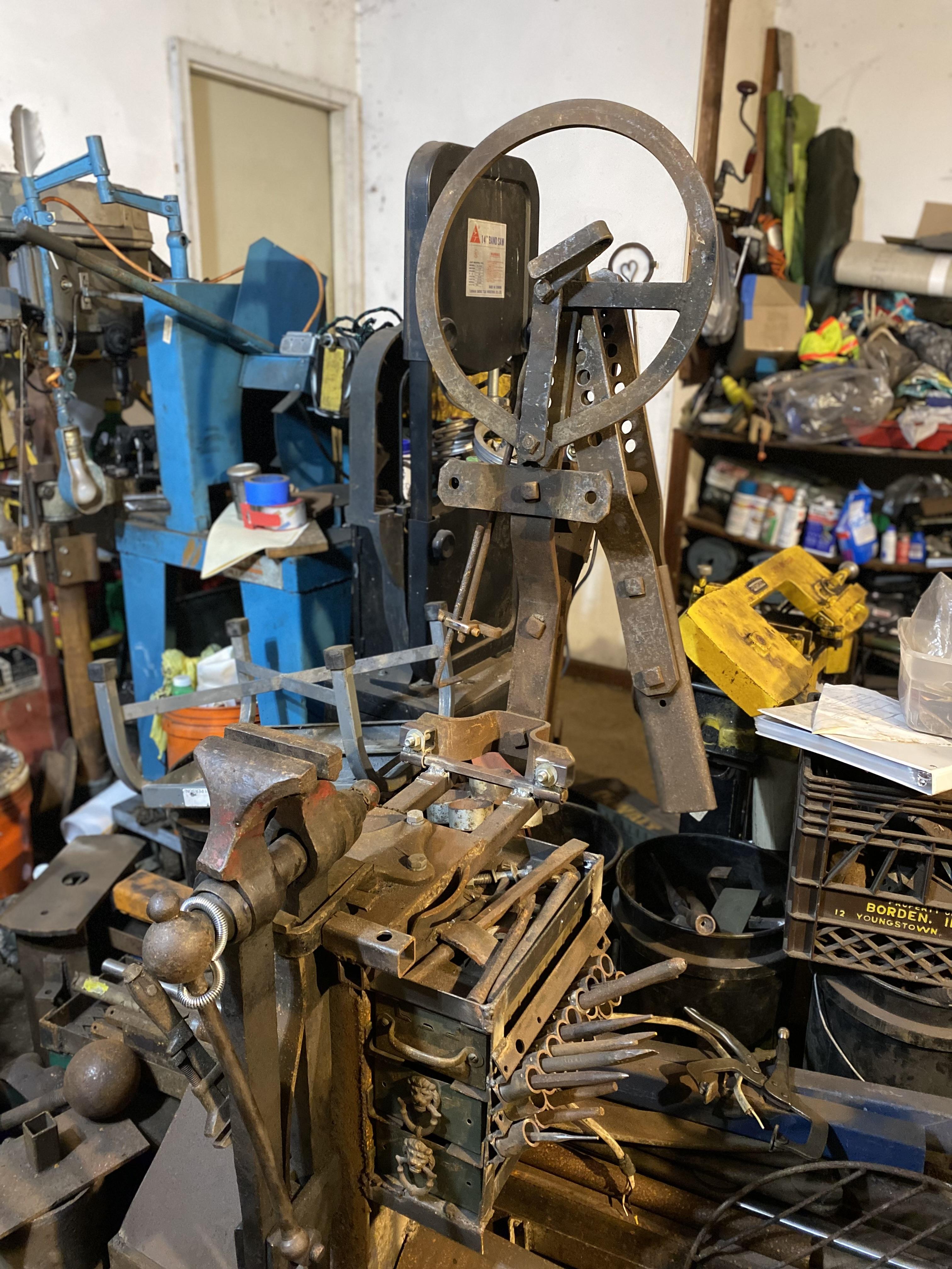

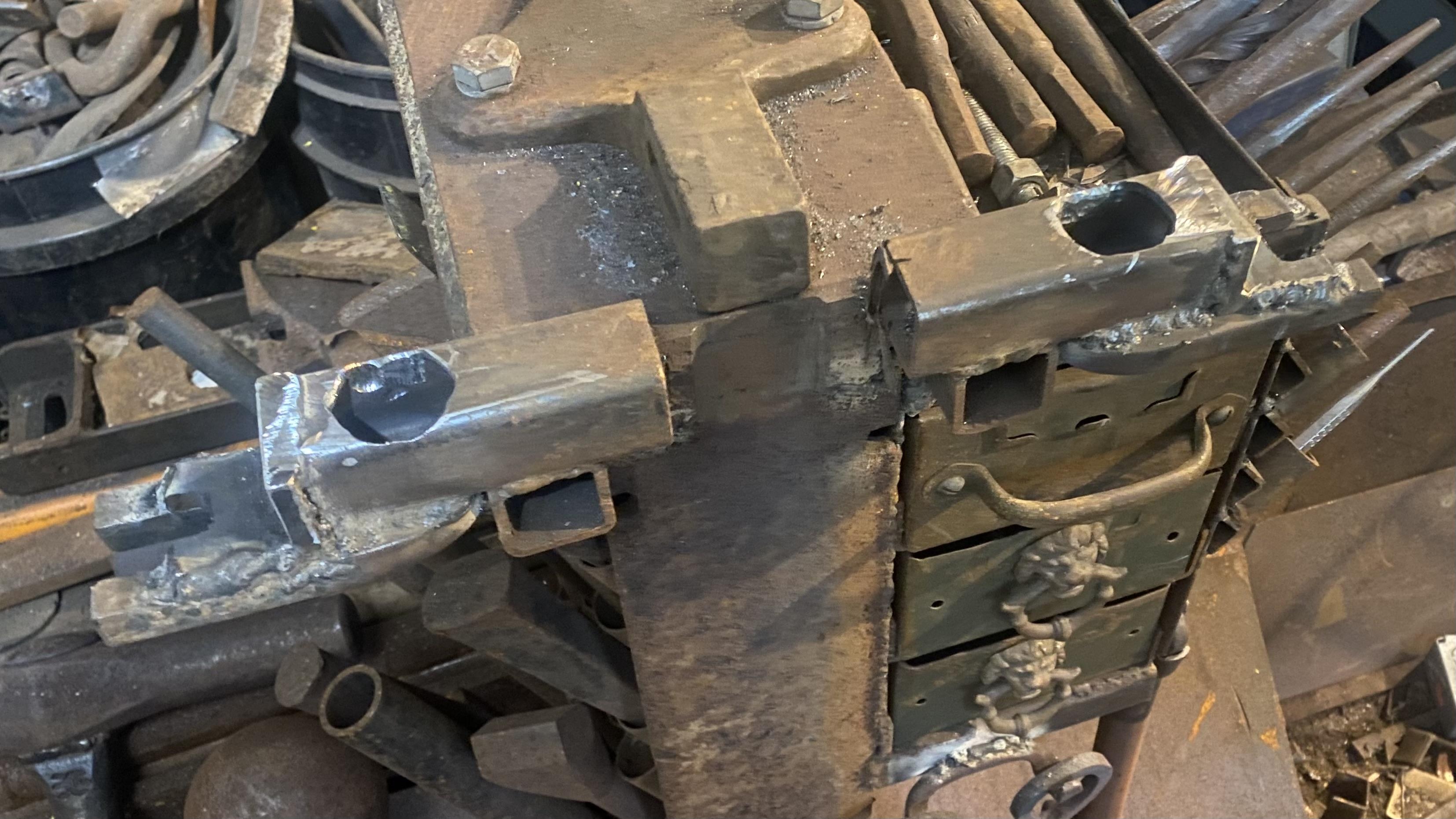

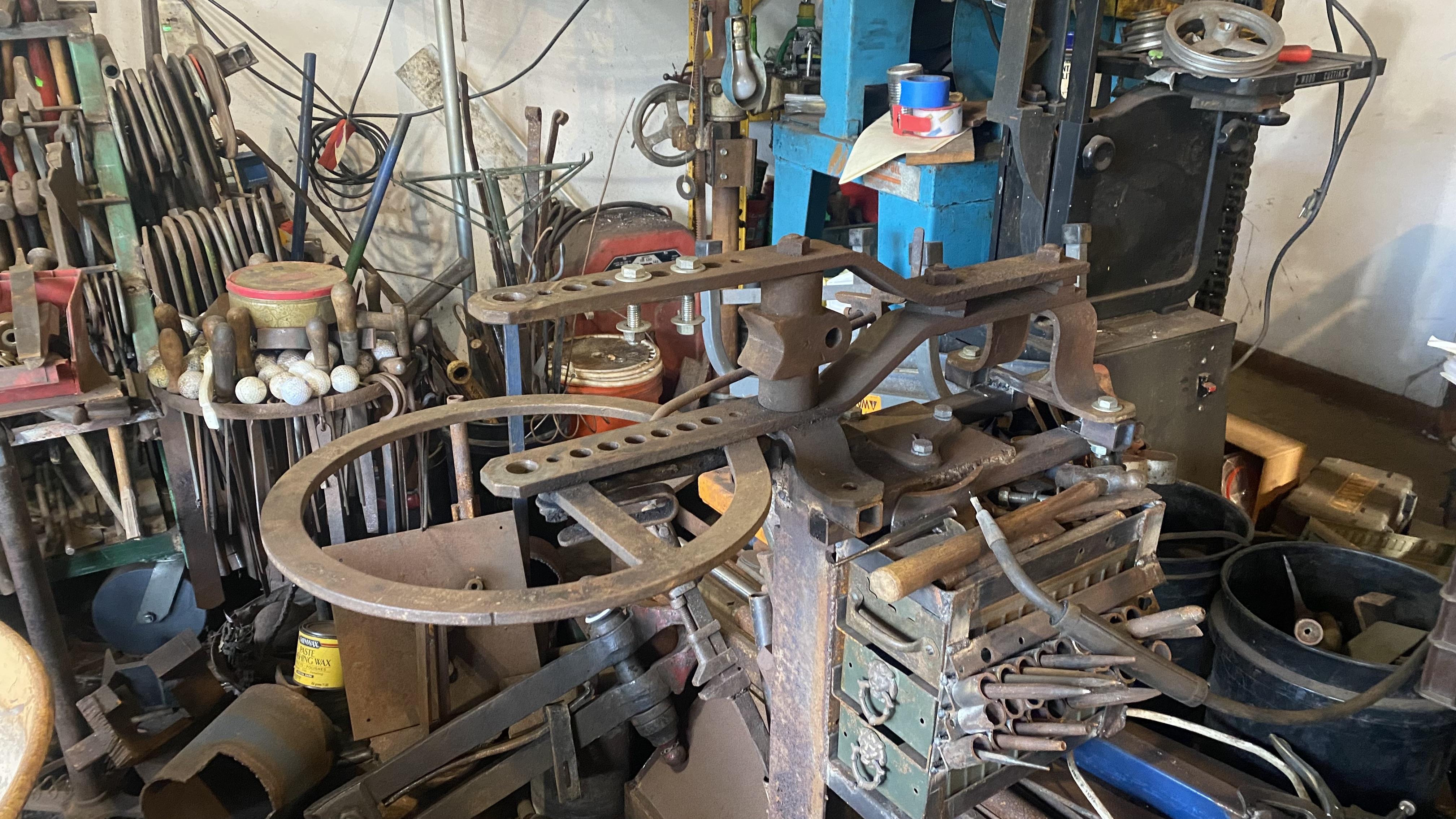

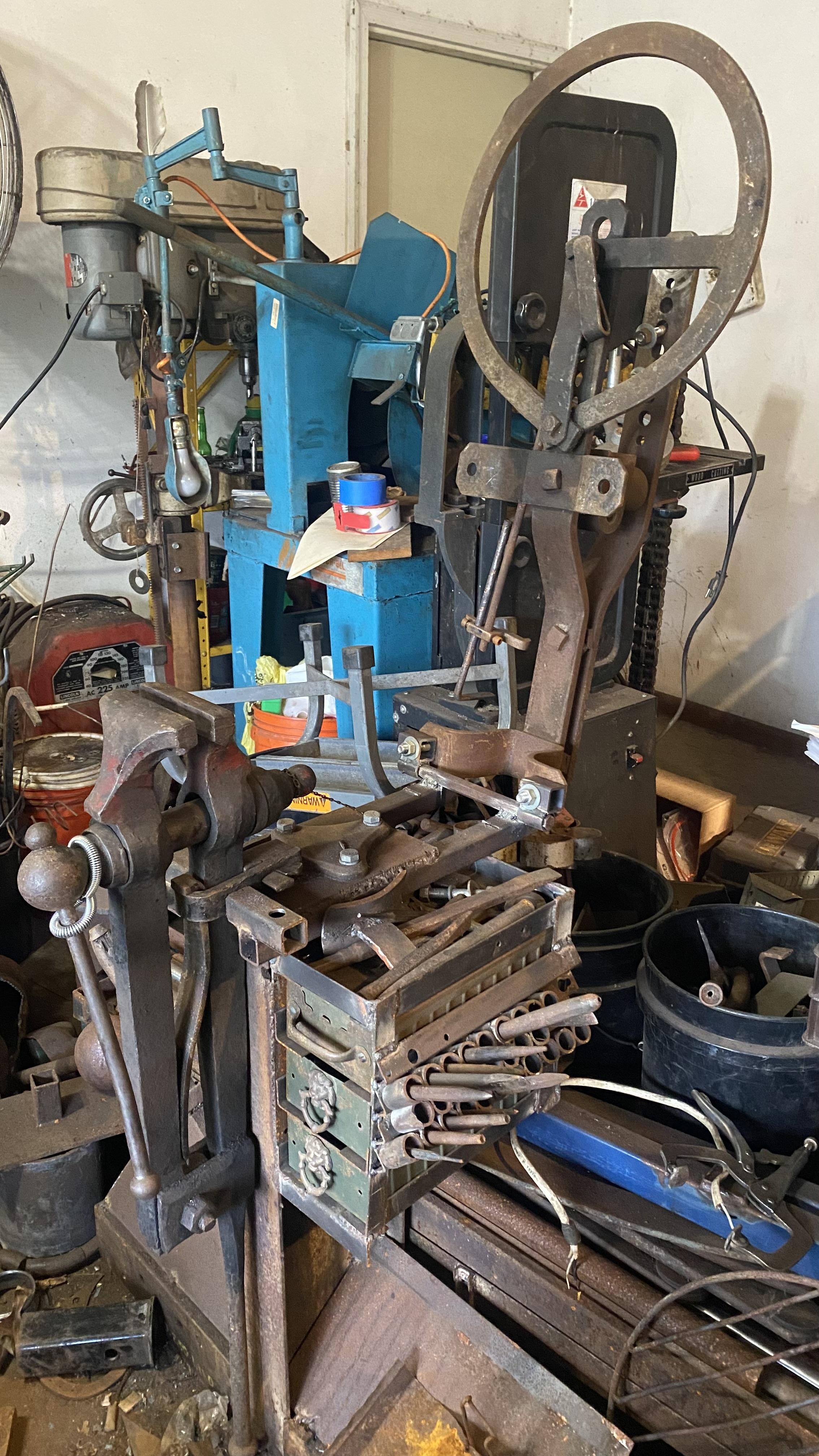

Made a simple-yet-significant change to how the Hossfeld is mounted. Because it shares a stand with my bigger post vise, switching back and forth from one to the other can be a bit of a pain, and I’ve tended to leave one or the other set up longer than I should.
I realized that by hinging the bender’s mounting bracket at the back, all I need to do is undo the front mounting bolts, and the whole thing tips up and out the way. A minimum of cutting and welding, and here we are.
Closeup of the hinge:

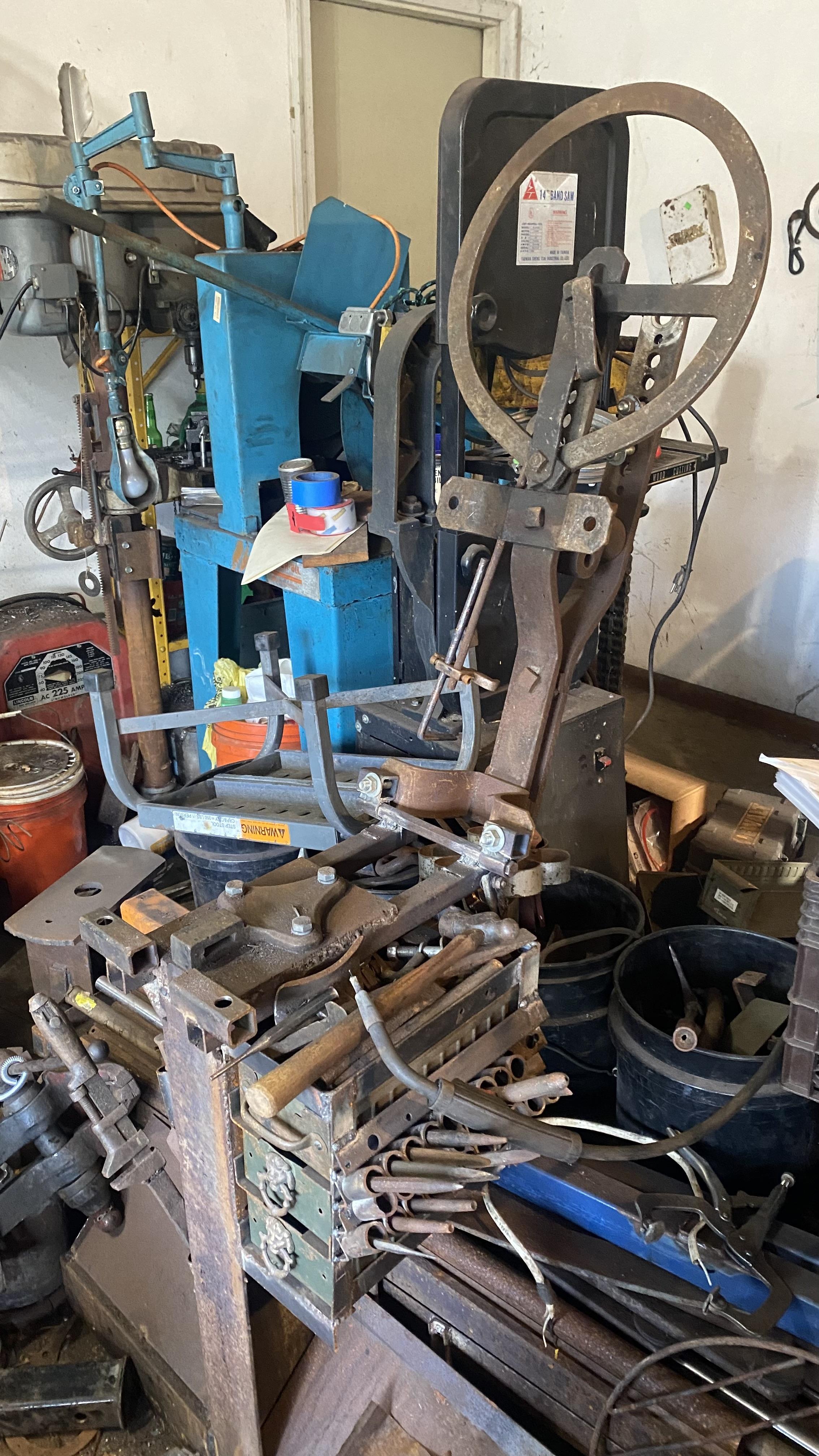

And here’s the stand with the vise in place.
I’m probably going to make or buy some big wingnuts to facilitate bolting and unbolting the bender in its lowered position, but that’s for another day.
Addendum: here it is with the swing arm in place.
Reverse angle:
Pretty slick John, I wish it were easier to see but it blends in with the shop.
How steady is it, can you really pull on it?
This is the combination vise stand/scrap steel storage that probably weighs somewhere between a quarter and half a ton. So, yeah.
Works for me too, lots of my stuff is VERY stable.

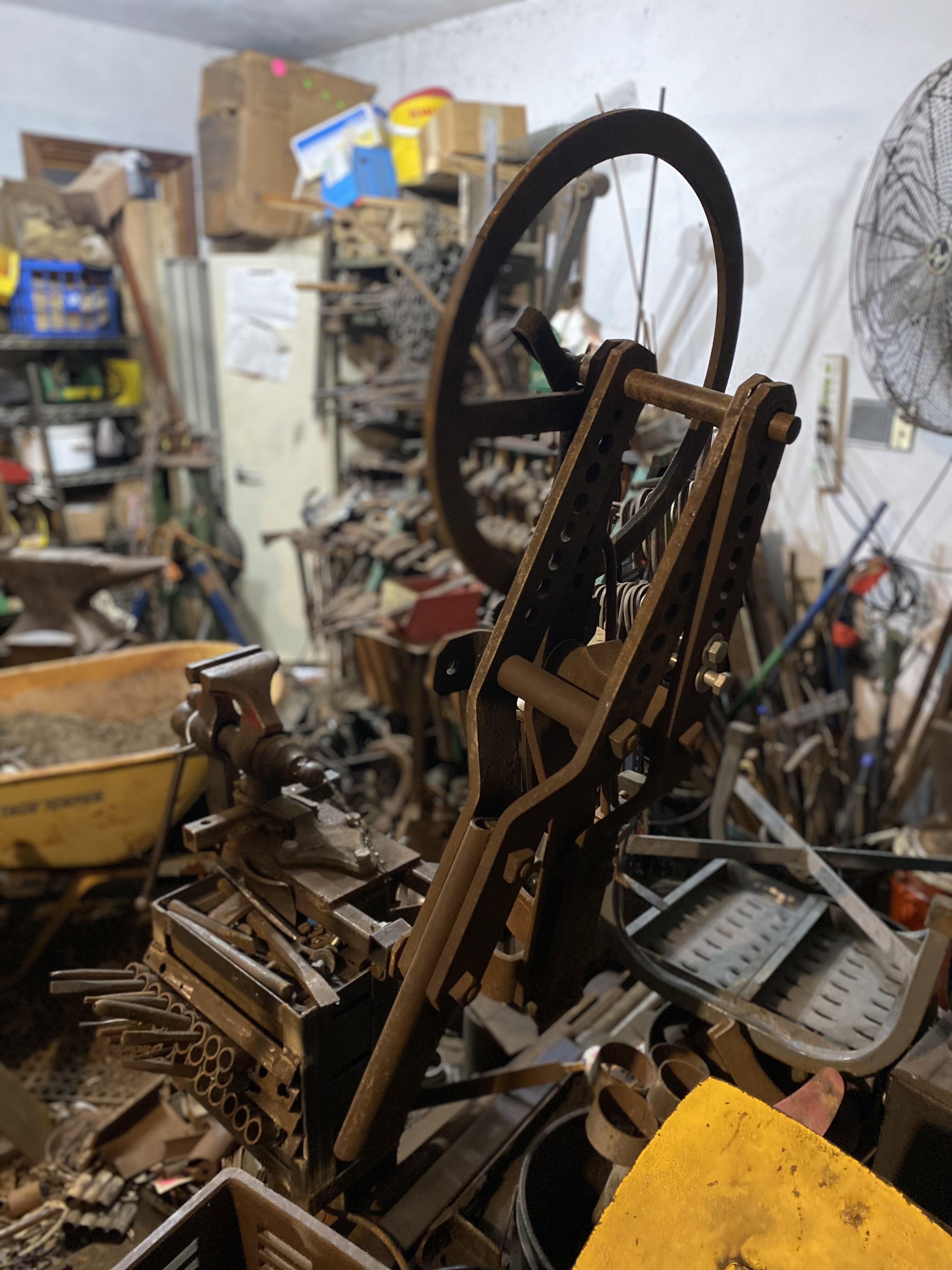

Looking back, I realize that I forgot to mention here that in early January, I modified the handle extension with a bend to match Hossfeld's original:
At least I wasn't the one who brought up black holes, I just filled in the blanks.:ph34r: Sooooo many blanks in a black hole. . . . Nope, NOT AGAIN!
I liked this handle before you angled it like the Hossfeld original.
I did too, but then I realized why the angle exists in the first place: it gives you a LOT more flexibility in the range of motion and where you stand relative to the bender.

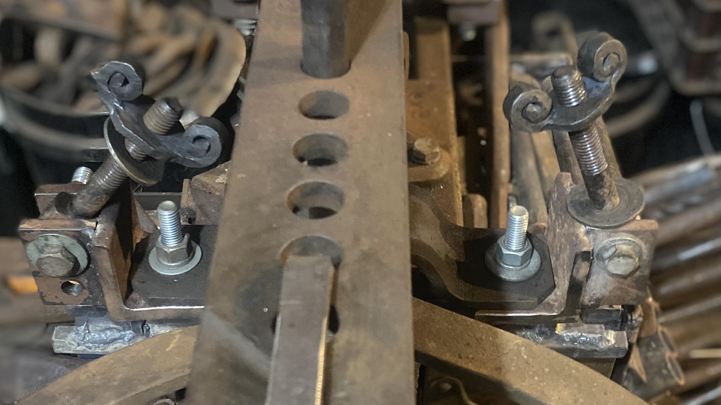

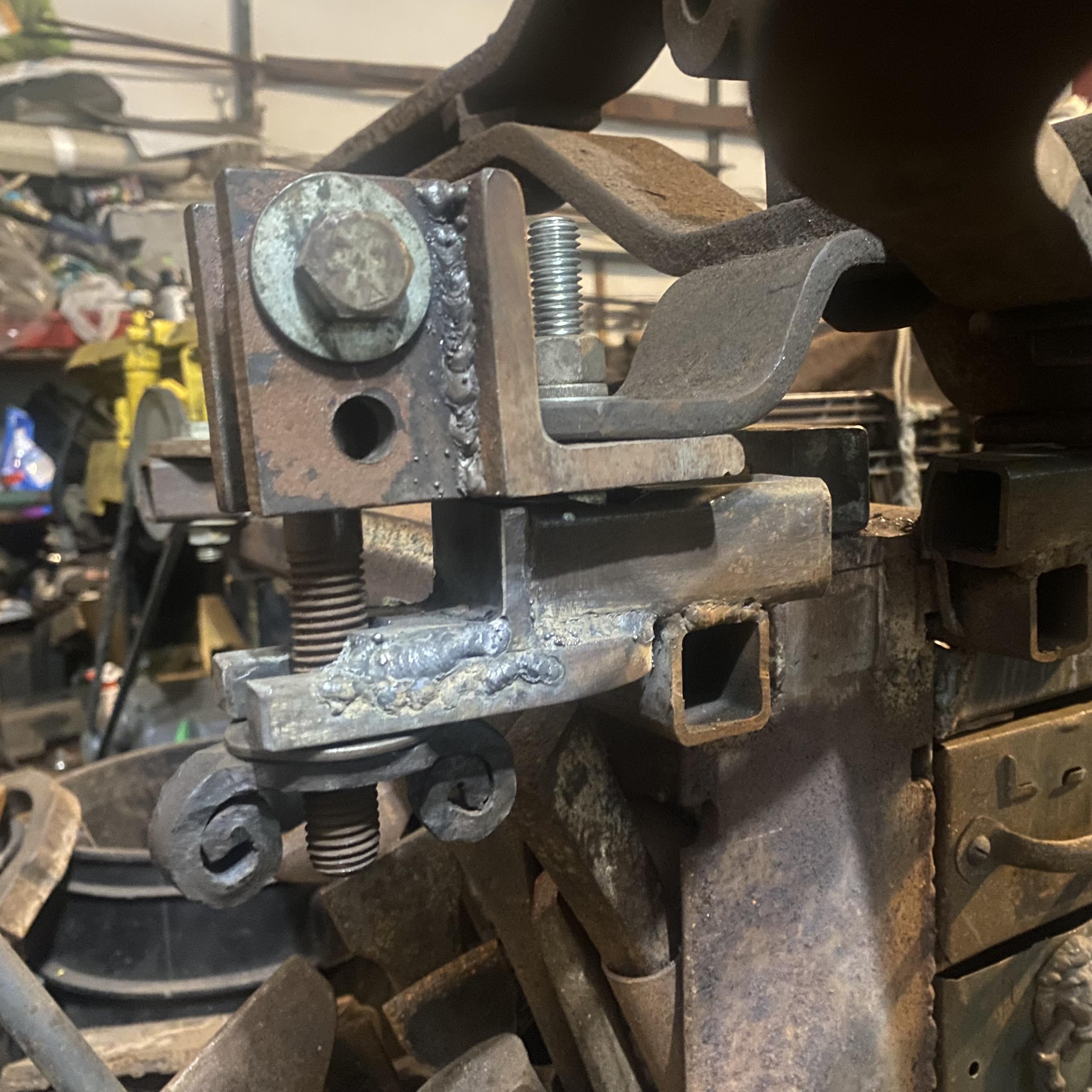

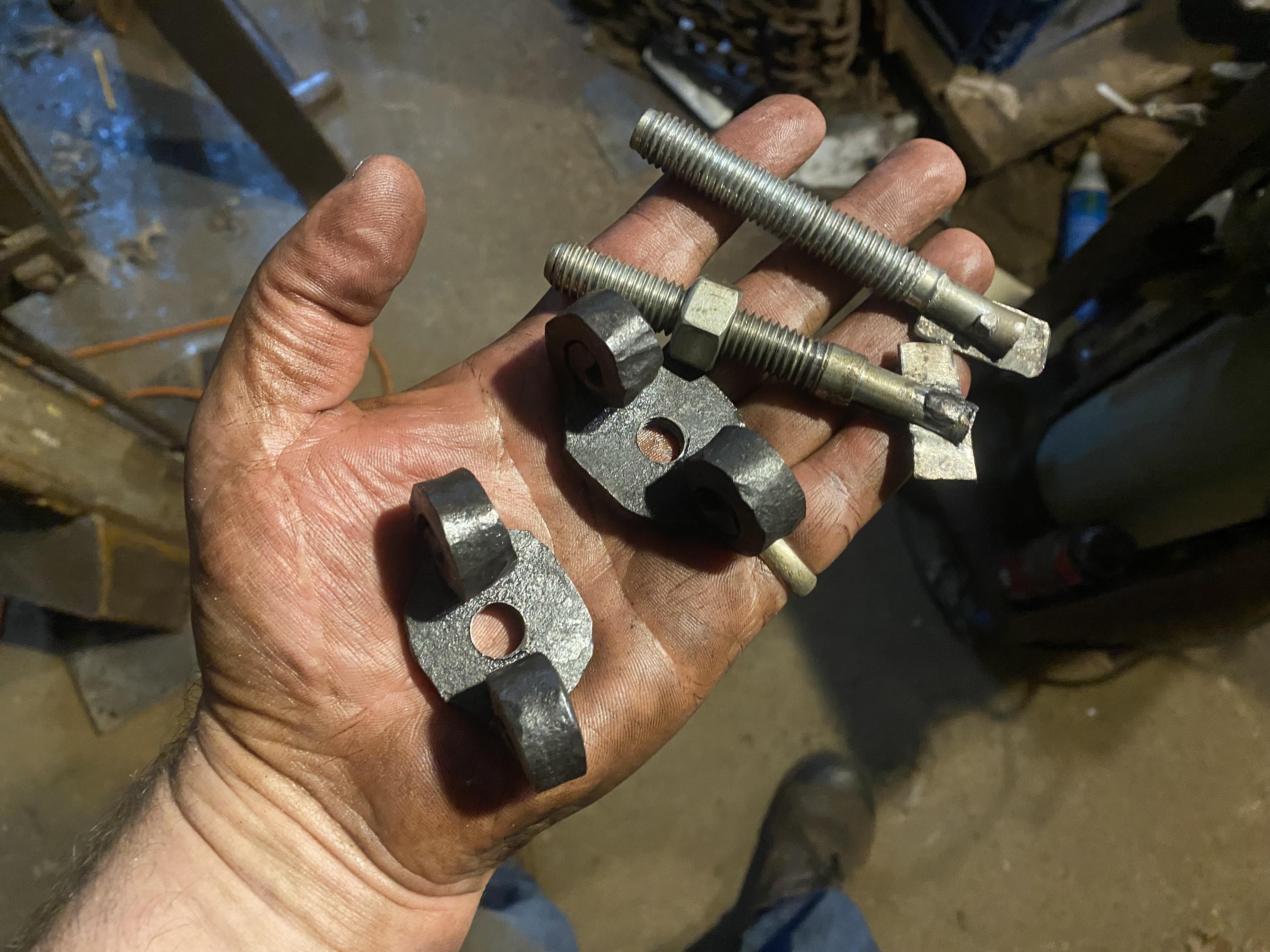

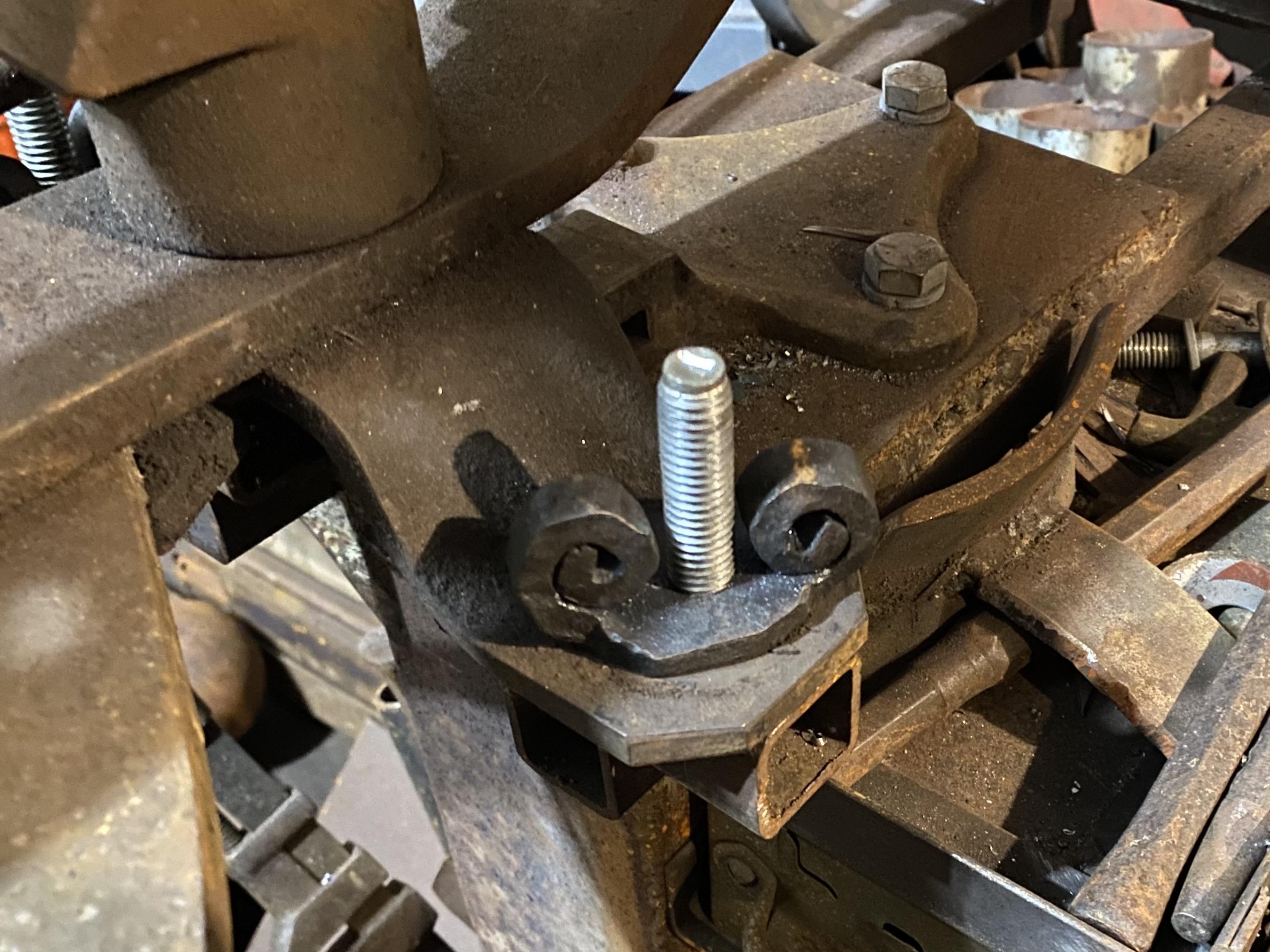

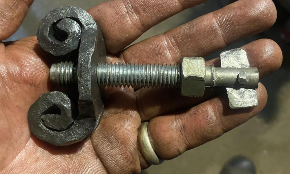

Returning to the mounting system, I added a final detail: a pair of shopmade 1/2” x 5” T-anchors with forged wingnuts. These are permanently mounted on the front feet of the bender (with the help of capture nuts at the bottoms of the threaded sections) and drop down into the bolt holes in the mounting bracket when the bender is lowered into place. The toggles are moved into perpendicular, and the wingnuts screw down to hold the bender in place. No hunting for missing parts or the right size wrench.
I love it when a plan comes together.
Very nicely done John, I like it.

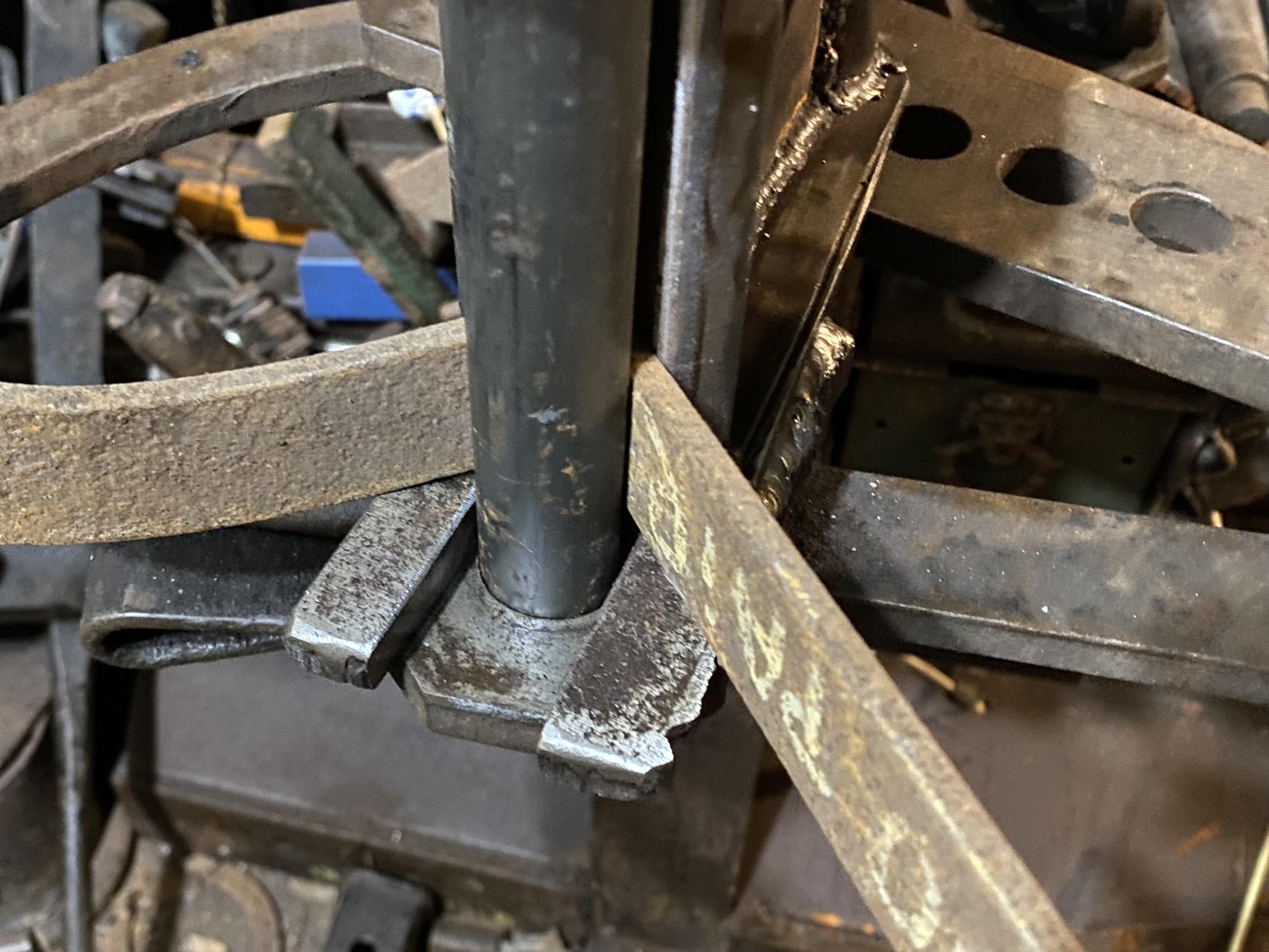

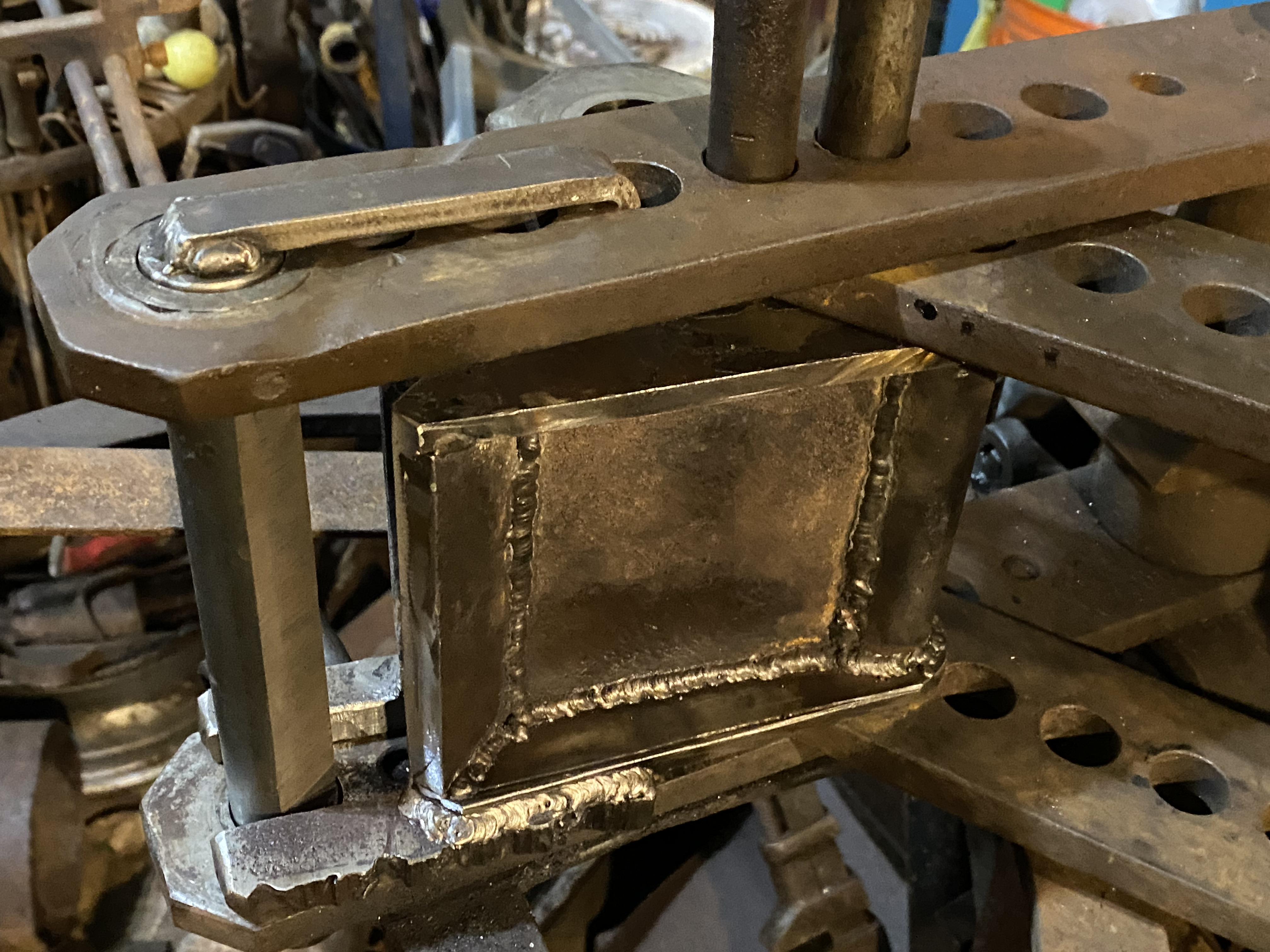

As noted in the "What did you do in the shop today?" thread, I made a bulldozer die and its pins:
The 60B1 Center Pin (the one with the right-angled facets and the arm that keeps it from rotating) and the 60B2 Bulldozer Die are both made from mild steel from my scrap bin. The 53B Wrist Pin (not visible in the above photo; it's a straight pin that allows the die to pivot within the swing arm and is trapped in place by the arms of the outer frame) is made from a piece of mystery metal that I suspect is 4140*. None of these are heat-treated, although I'm toying with the idea of case-hardening the 60B1 to give it a little extra toughness. If I do, I'll probably do the same with the work faces of the 60B2 as well, to give them a little abrasion resistance.
The Hossfeld manual says that the bulldozer die's maximum capacity is 3/16" flat. Here's a photo of a piece of 3/16" x 1" flat bar that I bent just with muscle power and without the handle extension.
I haven't yet tried anything wider, but I'll keep you posted.
I'm probably going to leave this semi-permanently set up in the bender, as I can imagine needing it fairly regularly for making mounting brackets or the like for various bits of shop furniture and equipment. I think this will be a good combination with the recently completed hinged mounting described above.

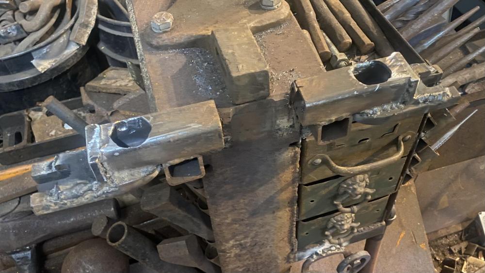

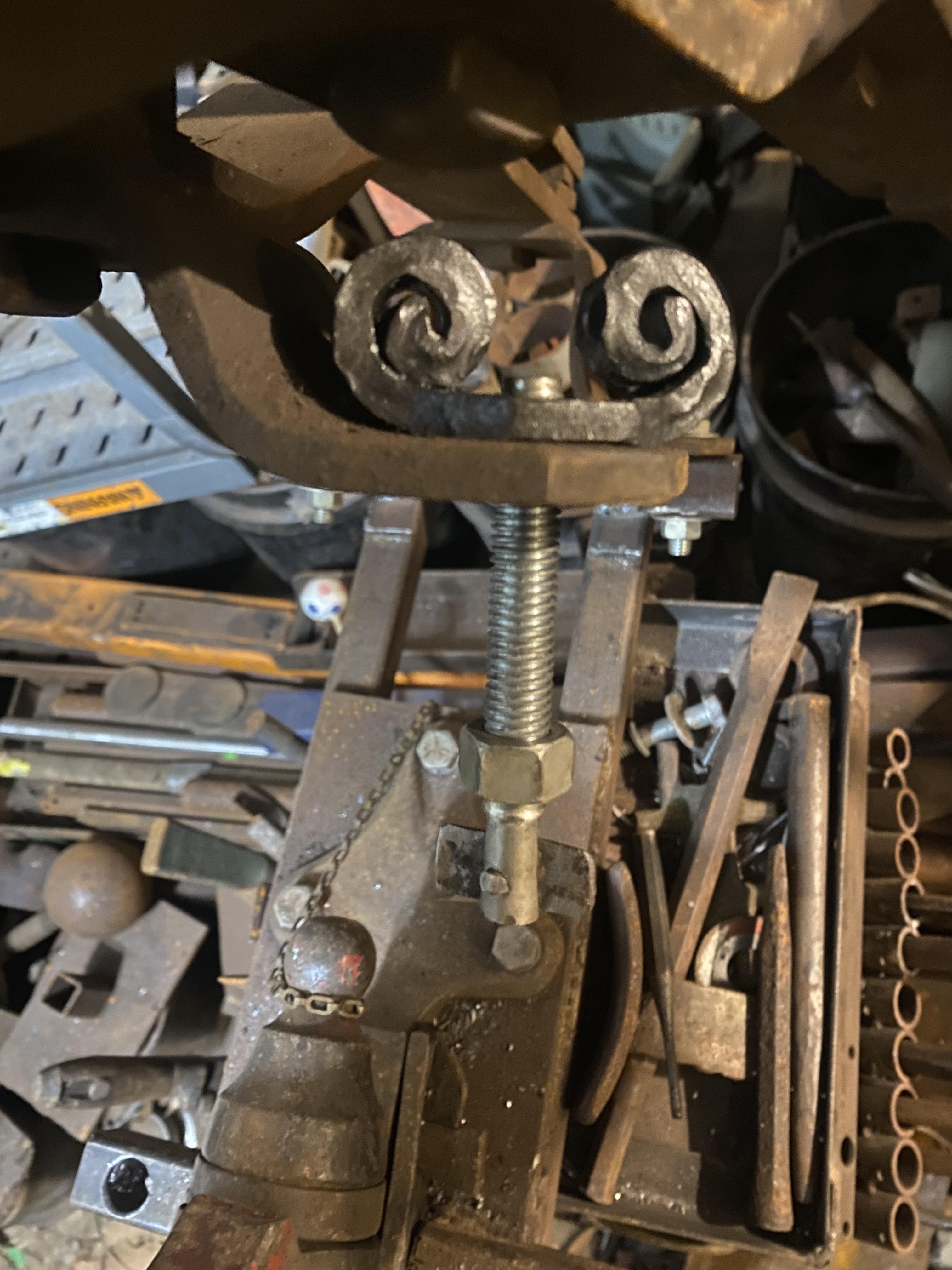

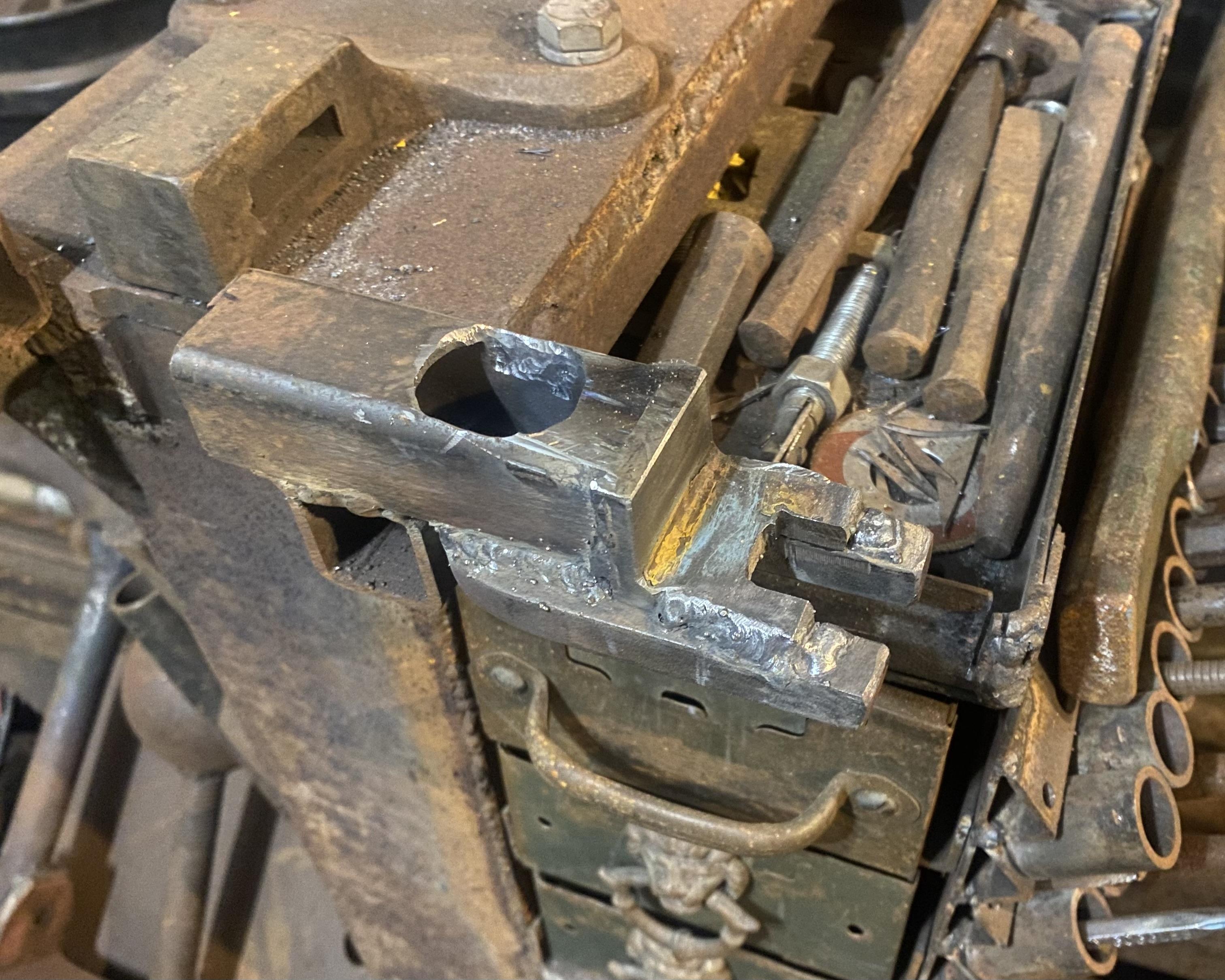

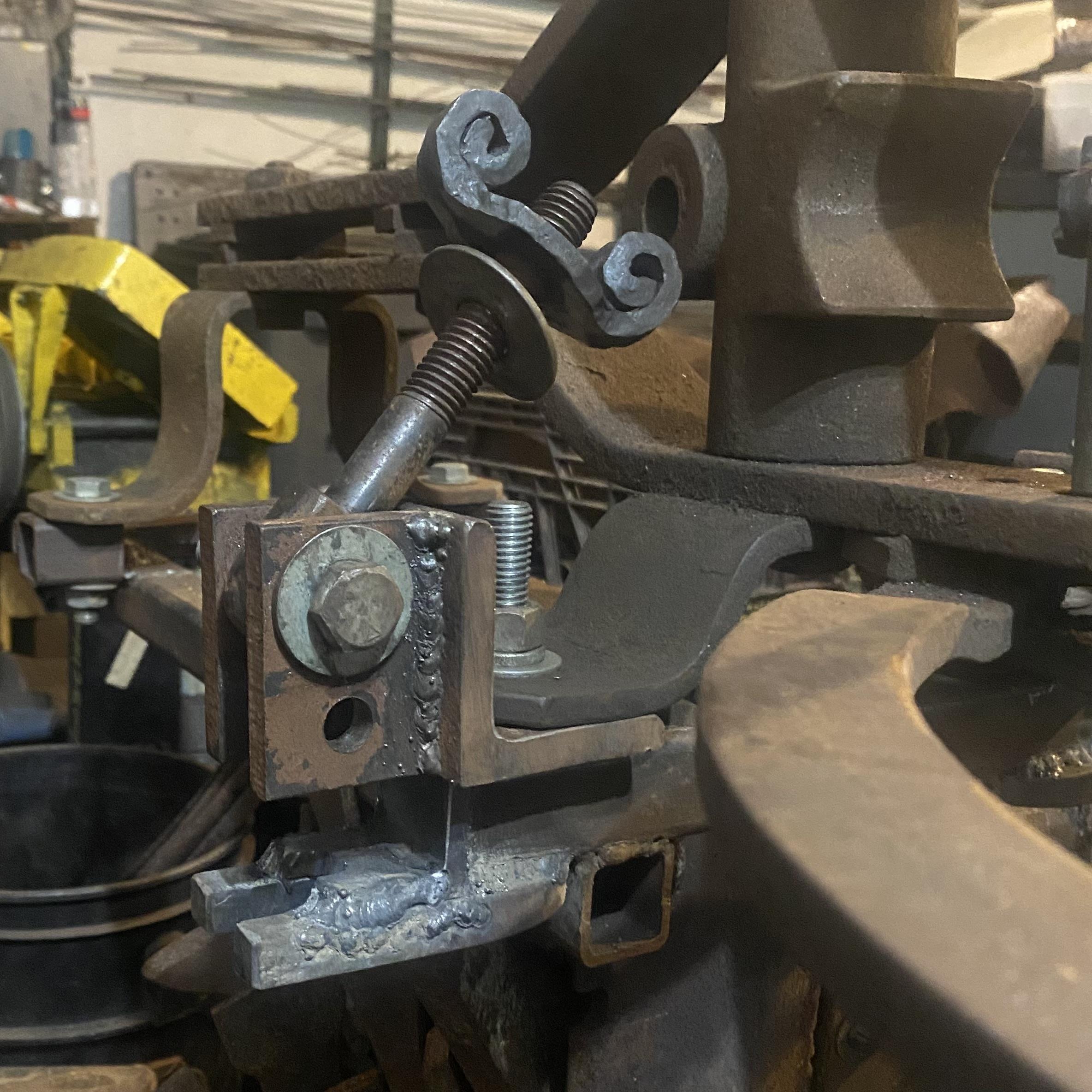

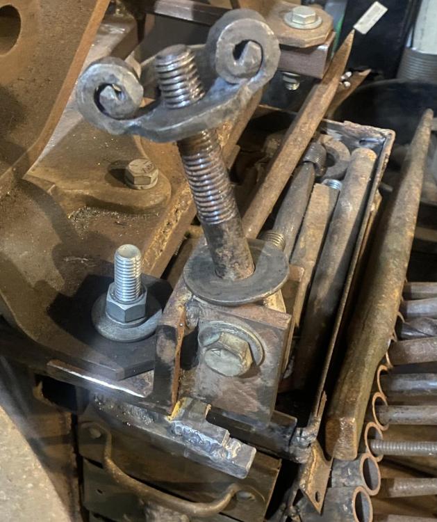

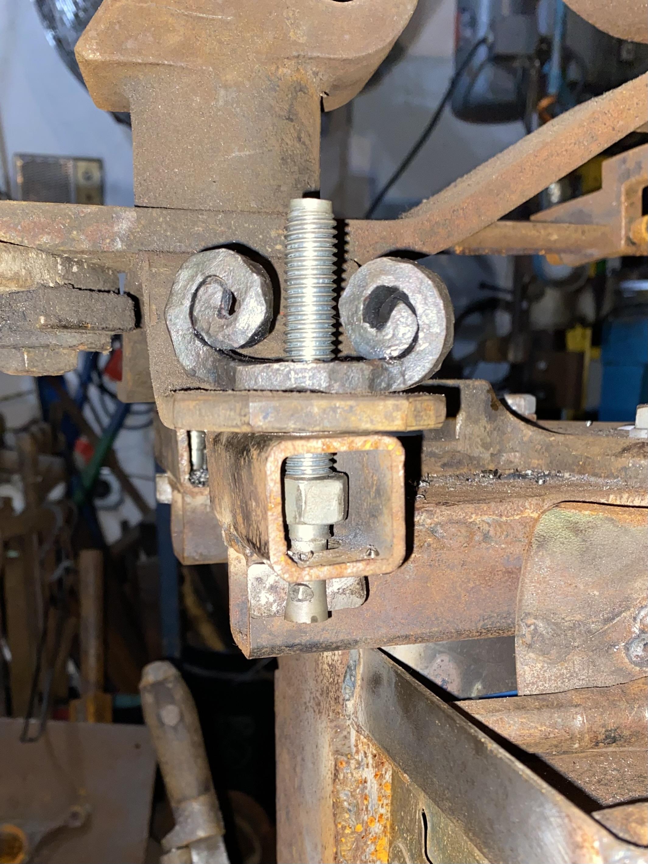

So, a further modification of the mounting system, replacing the toggle bolts that drop into holes in the front brackets. Instead, I’ve extended those brackets sideways with rather beefy short forks and replaced the toggle bolts with rod-end bolts that swing down to engage them. These are mounted in heavy brackets that bolt onto the front feet of the Hossfeld.

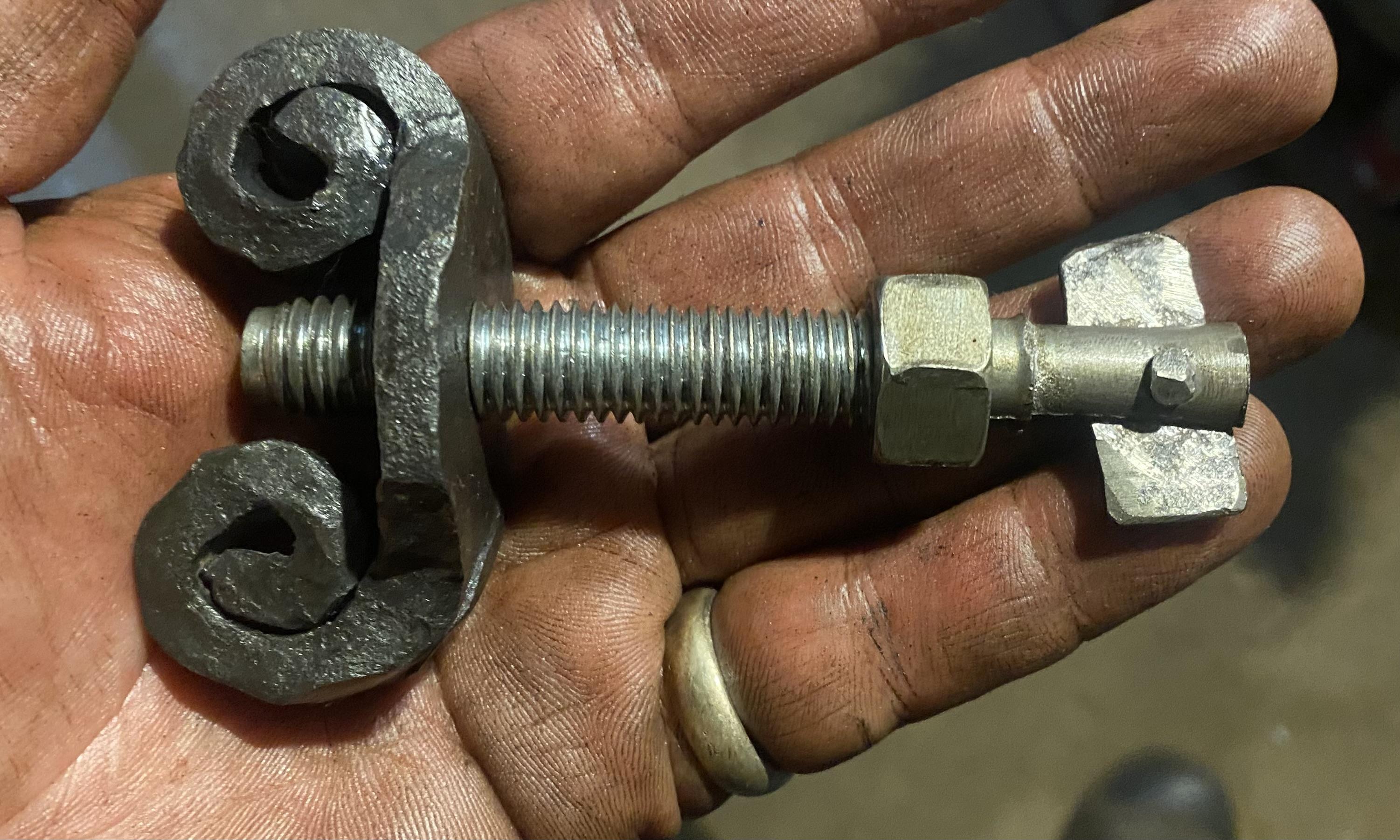

I used the same wing nuts as before, bored out and re-tapped to 5/8-11 to match a pair of rod-end bolts I had kicking around already.
You can see in the last photo how the heads of the bolts holding the top brackets to the feet drop down into holes on the top of the bottom brackets. These actually provide a good bit of the strength of this mounting system, as they keep the front feet from shifting sideways as force is applied to the swing arm.
