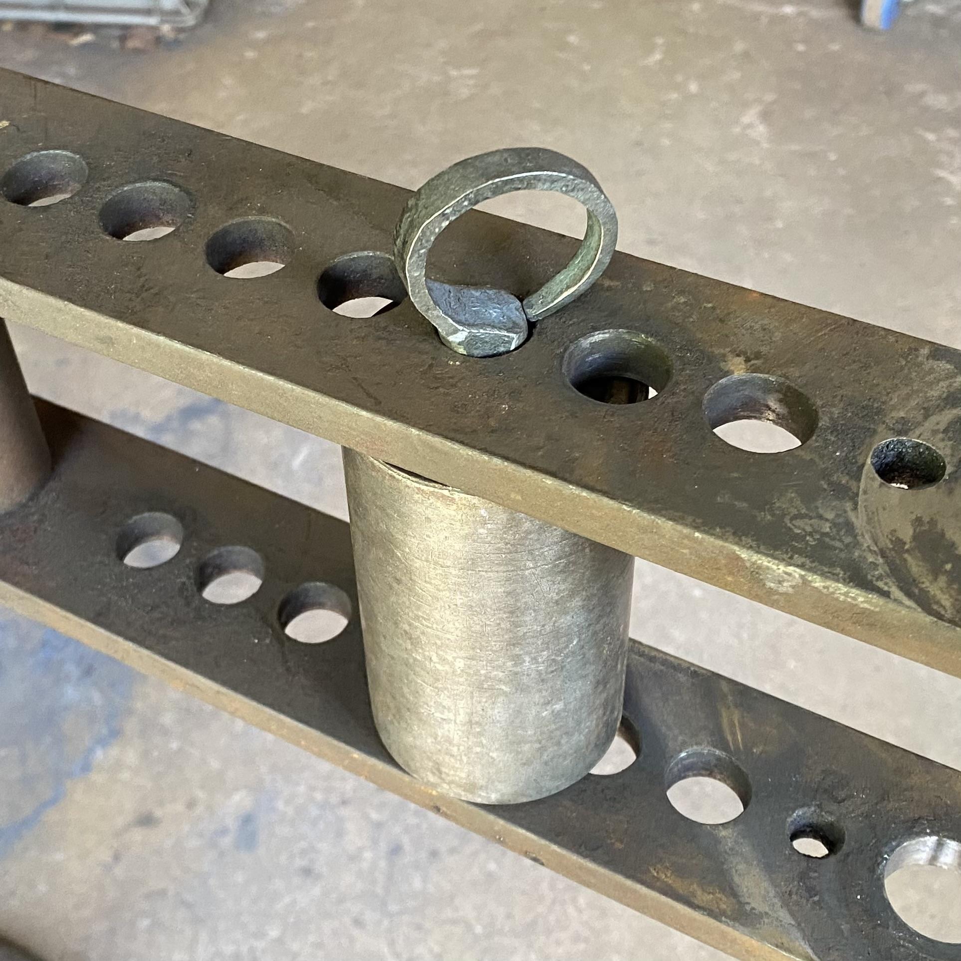

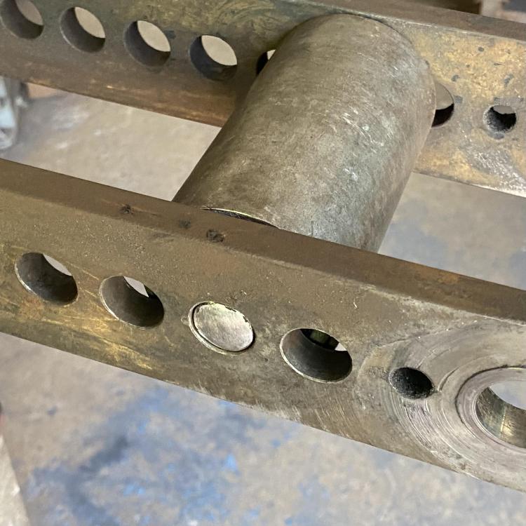

JHCC Posted May 15, 2023 Author Share Posted May 15, 2023 A further thought about the moveable roller as suggested by Scott NC above. As you can see in this photo, the pin holding it sticks out from the bottom of the swing arm: In practice, this means that the end of the pin bumps against one of the supports of the circle guide, limiting the swing arm's movement. You can raise the pin a bit to get the proper clearance, but it's awkward and annoying. I think I may make another pin that stops right at the bottom of the swing arm, so that it can swing freely though its full range without bumping into anything. I could theoretically use one of the other standard pins (such as the 17B Flat Head Pin), but the inner bore of the bearings is just a hair tight on those, and I don't want to grind them down to improve the fit if I don't have to. Quote Link to comment Share on other sites More sharing options...
Frosty Posted May 16, 2023 Share Posted May 16, 2023 Trimming the pin is a reasonable solution, a washer under the arm pivot will raise it enough you don't have to make the pin flush. If you grind the pin end in a shallow dish it's more likely to ride over the plate. I wouldn't hate having to tweak a Hossfeld and figure out how to use it. <sigh> Frosty The lucky. Quote Link to comment Share on other sites More sharing options...

JHCC Posted June 1, 2023 Author Share Posted June 1, 2023 As discussed above, I made a dedicated pin for the roller block. It has a finger ring on top and is flush with the underside of the swing arm, to clear the spot for the circle guide. Quote Link to comment Share on other sites More sharing options...
LarryFahnoe Posted June 2, 2023 Share Posted June 2, 2023 John, Your roller block is interesting, I'm assuming you're only replacing the trailing 11B block, not both. Will be interested to hear how it works for you. One comment I'd offer is that the 11B blocks were made to provide 4 different clearances given where the hole is in the block. I find being able to rotate the blocks (particularly the leading block) to change clearance is often helpful--just more of the subtleties of the Hossfeld & its tooling. Glad you got the manual, lots of good info in there--in particular notes on limits and capacities. My manual is at the shop so this is just from memory. With respect to bending eyes with the dog, do note the use of the two different pins to control the position of the dog's nose (normally to the leading side of the center pin) and the caution about safe limits. My take on it is that you can damage the dog's nose with too much force. --Larry Quote Link to comment Share on other sites More sharing options...

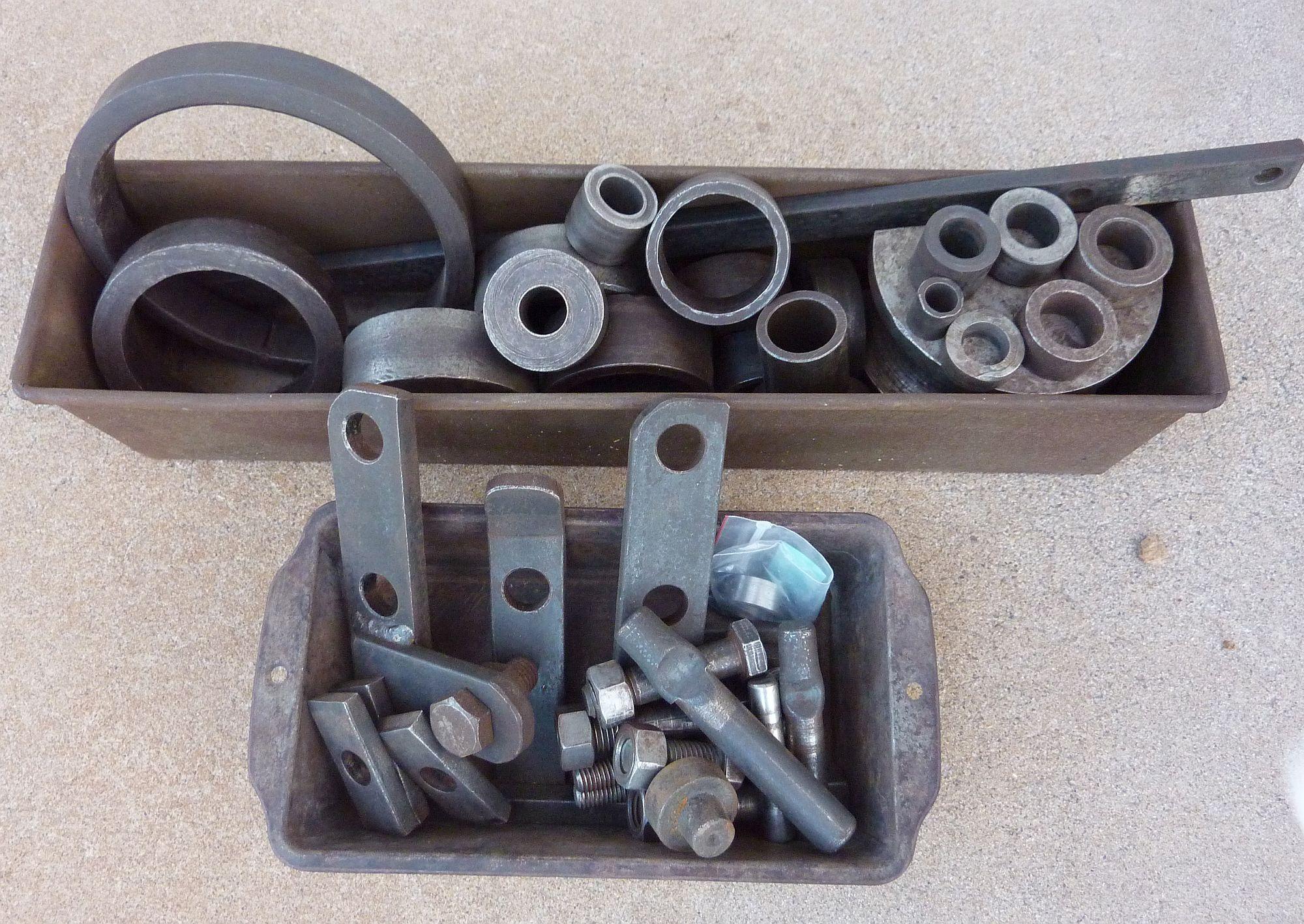

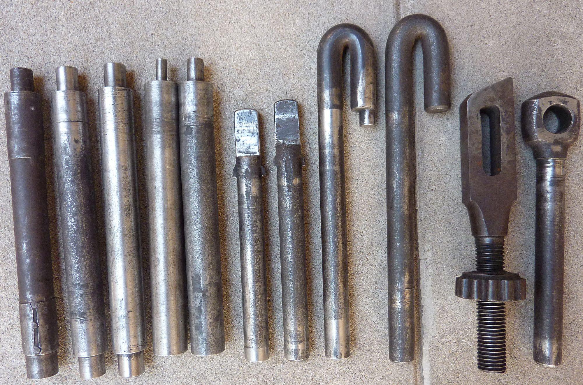

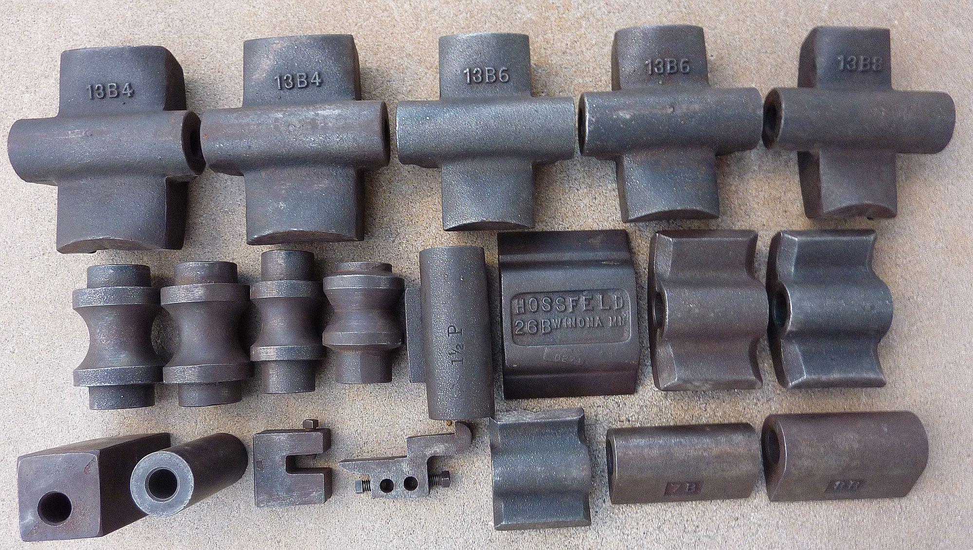

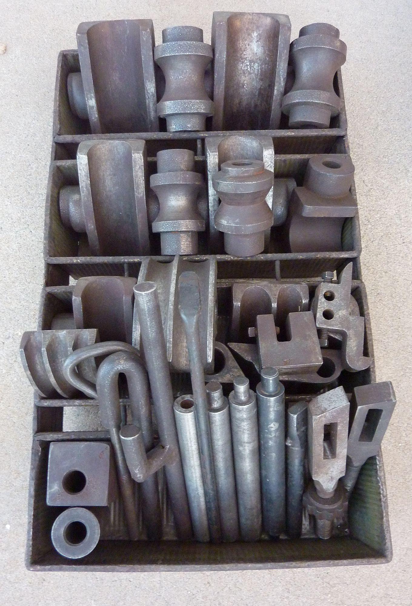

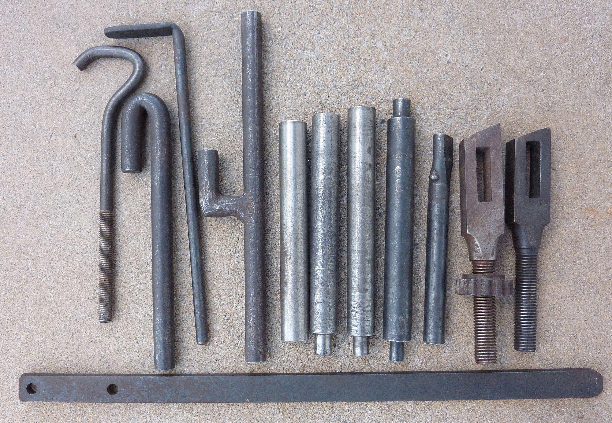

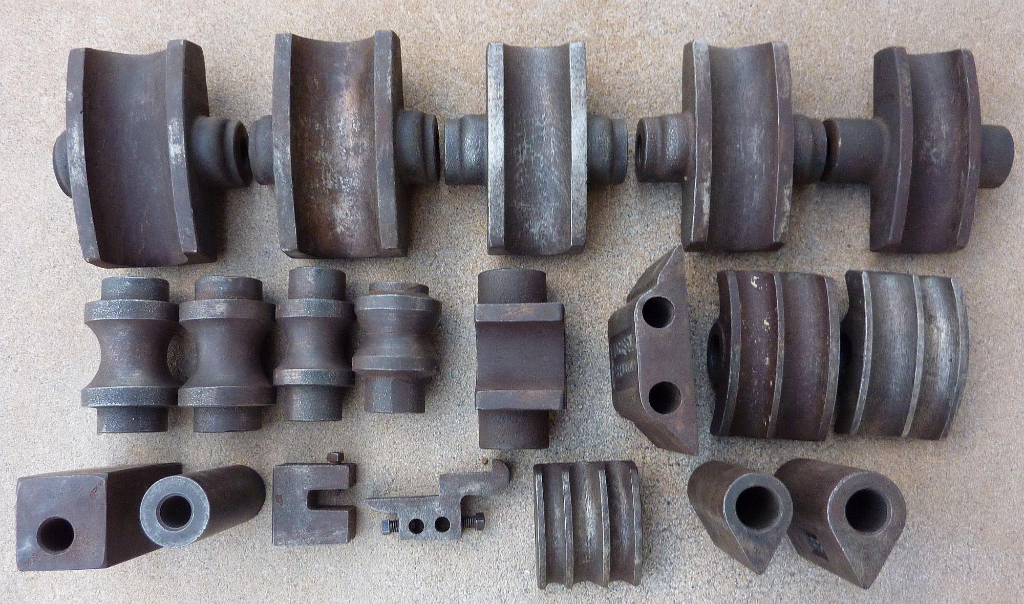

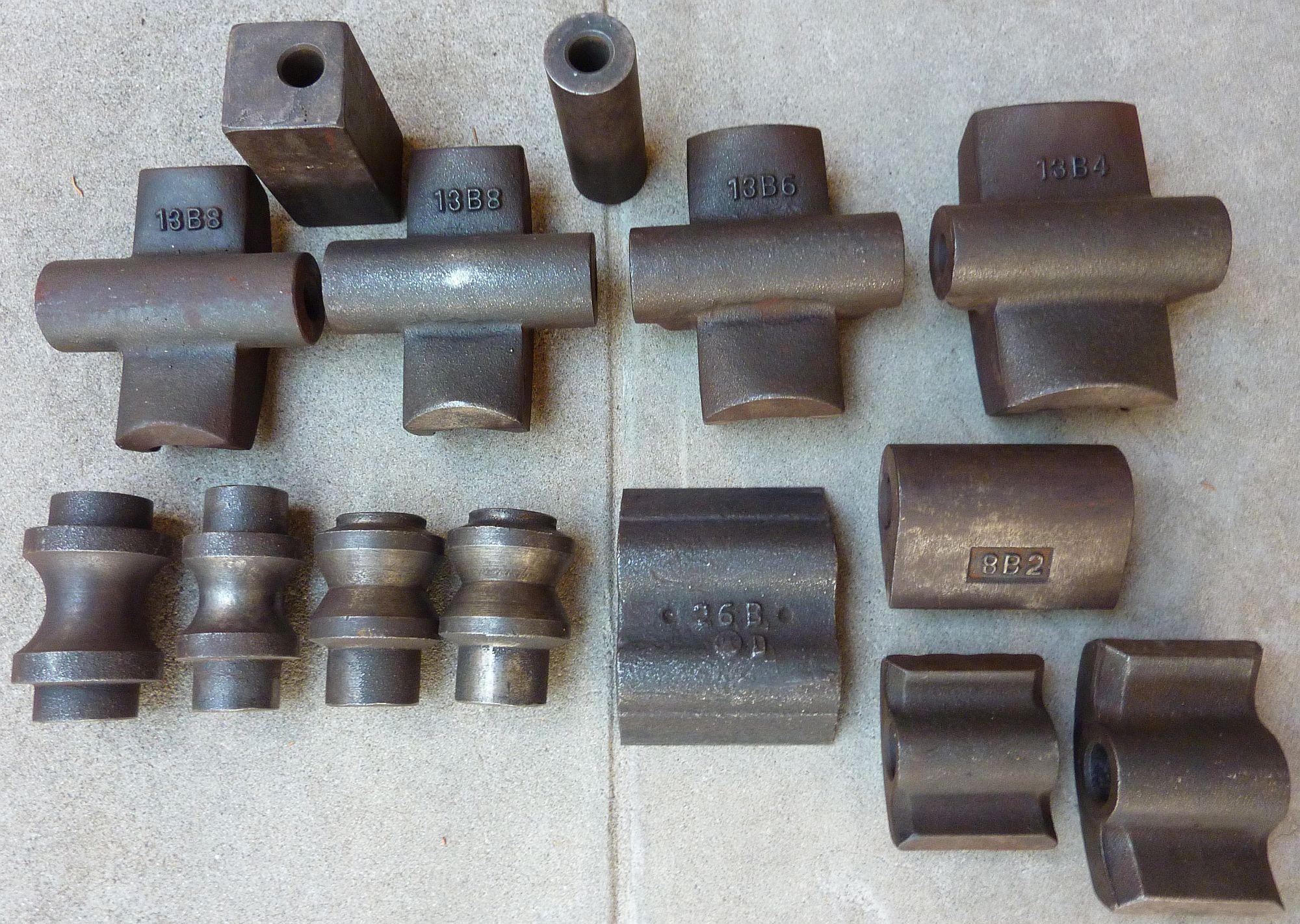

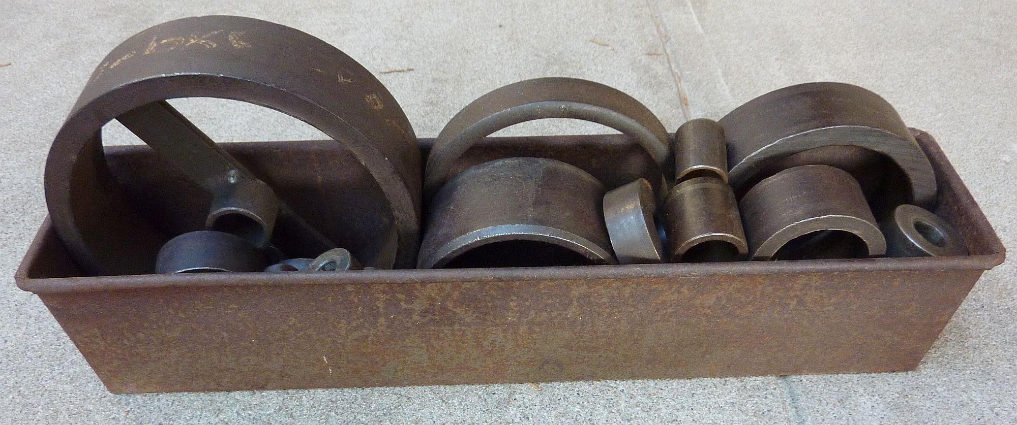

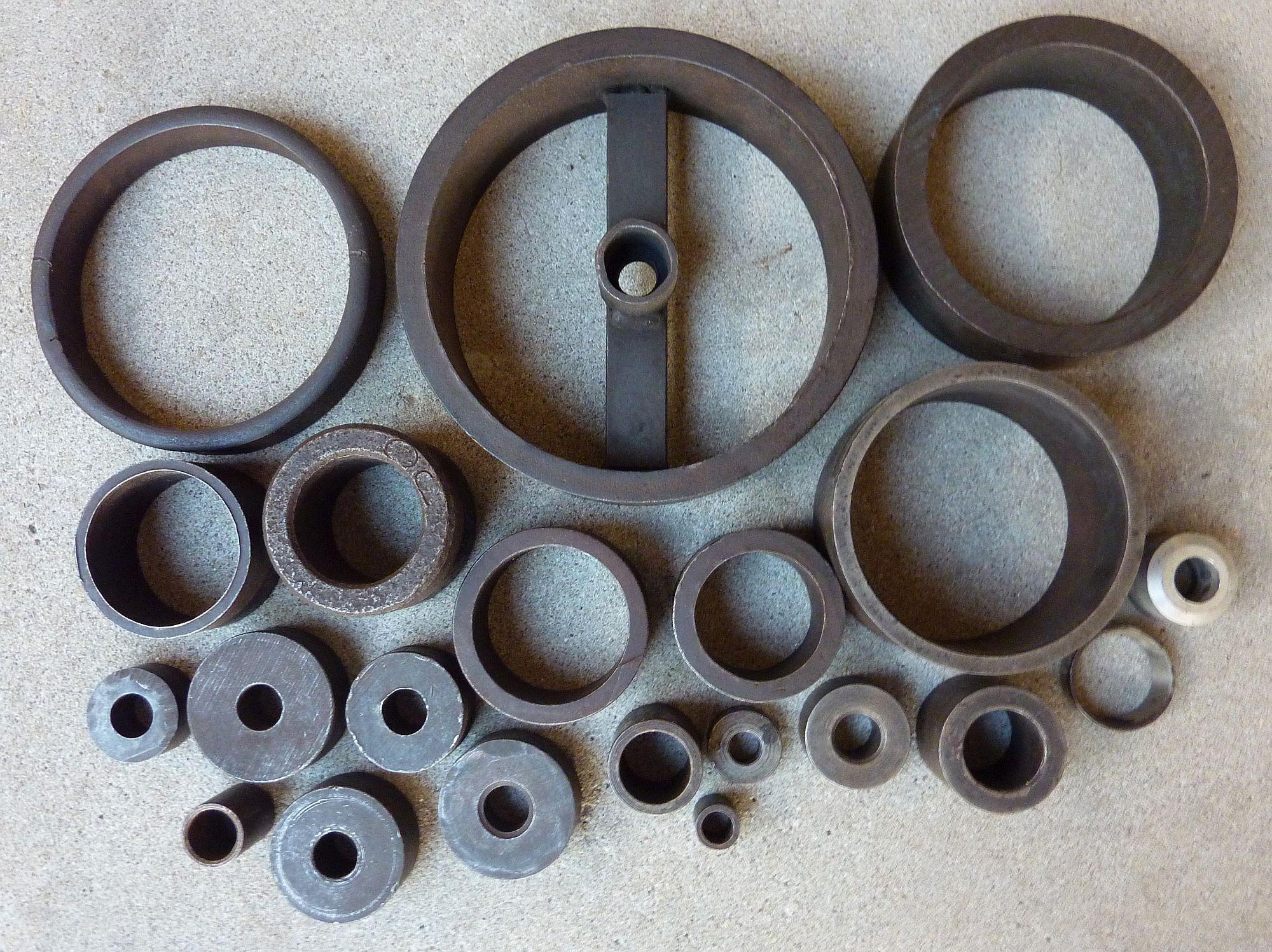

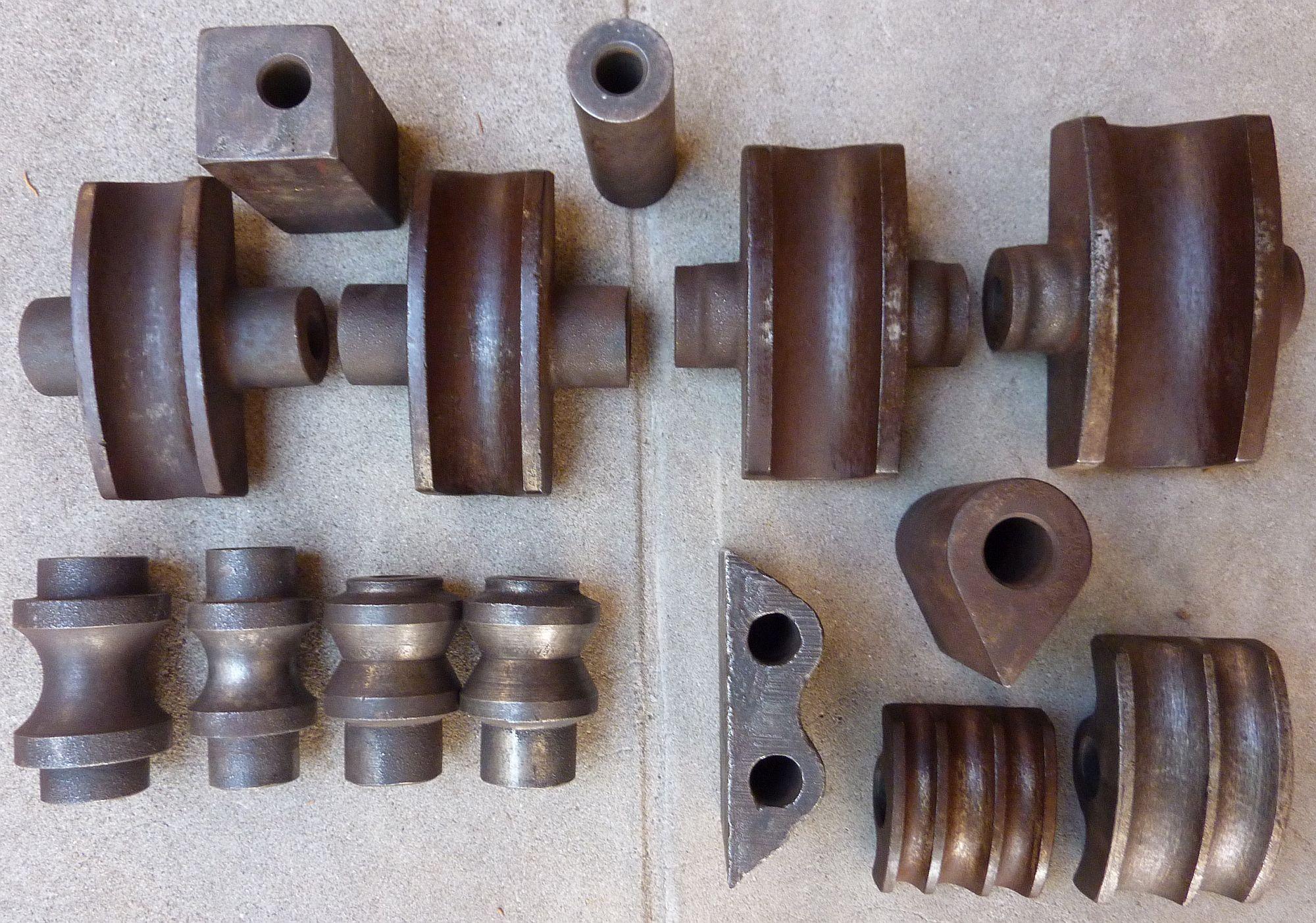

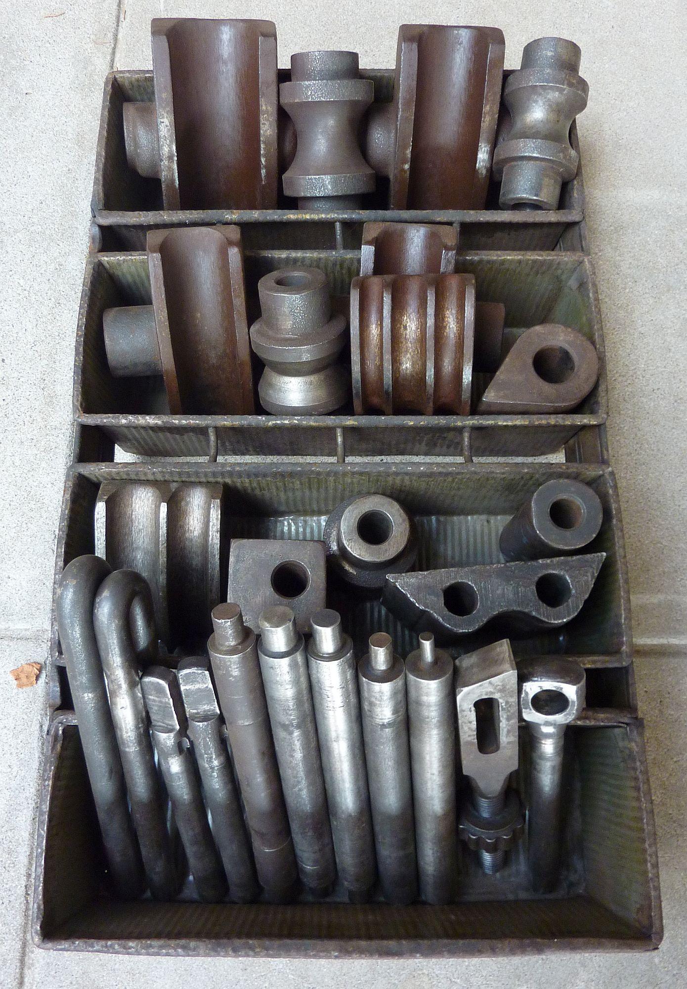

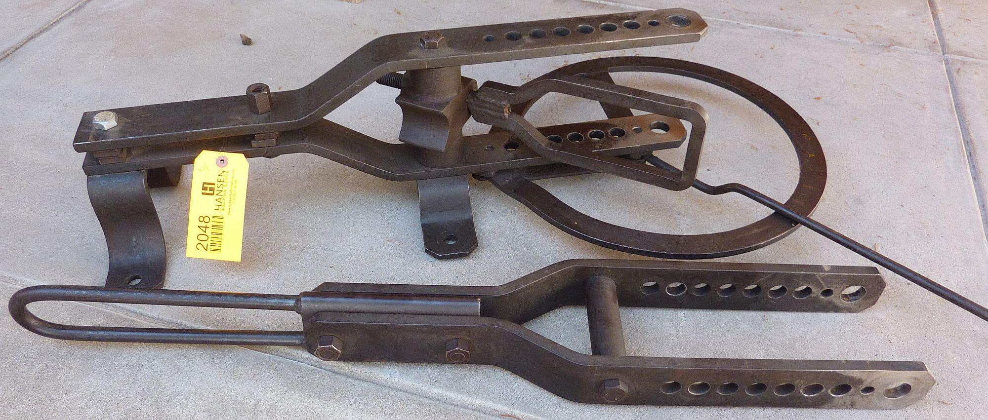

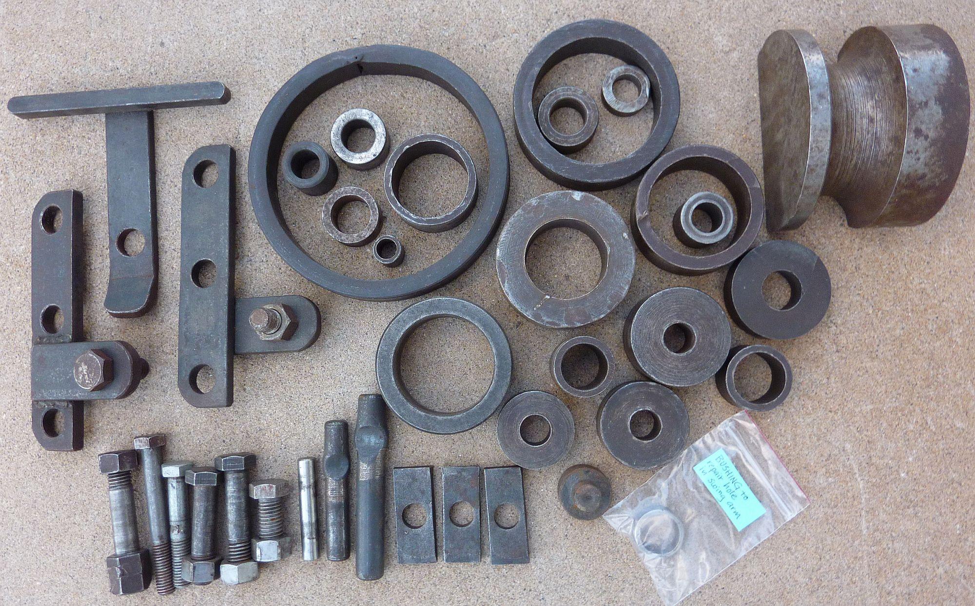

JHCC Posted June 5, 2023 Author Share Posted June 5, 2023 (edited) With permission, I am photo-dumping here a bunch of images of Hossfeld tooling. These are from a couple of posts on the "Hossfeld bender junkies" Facebook forum by a couple of folks in New Mexico who are auctioning off the two benders from their shop. [dead link removed] (Note the unusual handle, which I think may be a shop-built replacement.) [dead links removed] The previous photos are all from their post about a manual bender; the following, from their post about a hydraulic. [dead links removed] (I've asked what the fourth pin from the left is for; here is their reply: "For one of our products, we made tight eyebolt-like bends in the end of 1/2" round stock, working cold. The dog leg allowed us to complete and center the eyebolt shape at the end of the round stock. As I remember, when we got to finishing that eye bolt shape, it was just a quick adjustment to adjust that dog leg piece to complete the bend...instead of using another pin.") [dead links removed] Edited April 2 by Mod34 Dead links to photos removed; see later comment for images. Quote Link to comment Share on other sites More sharing options...

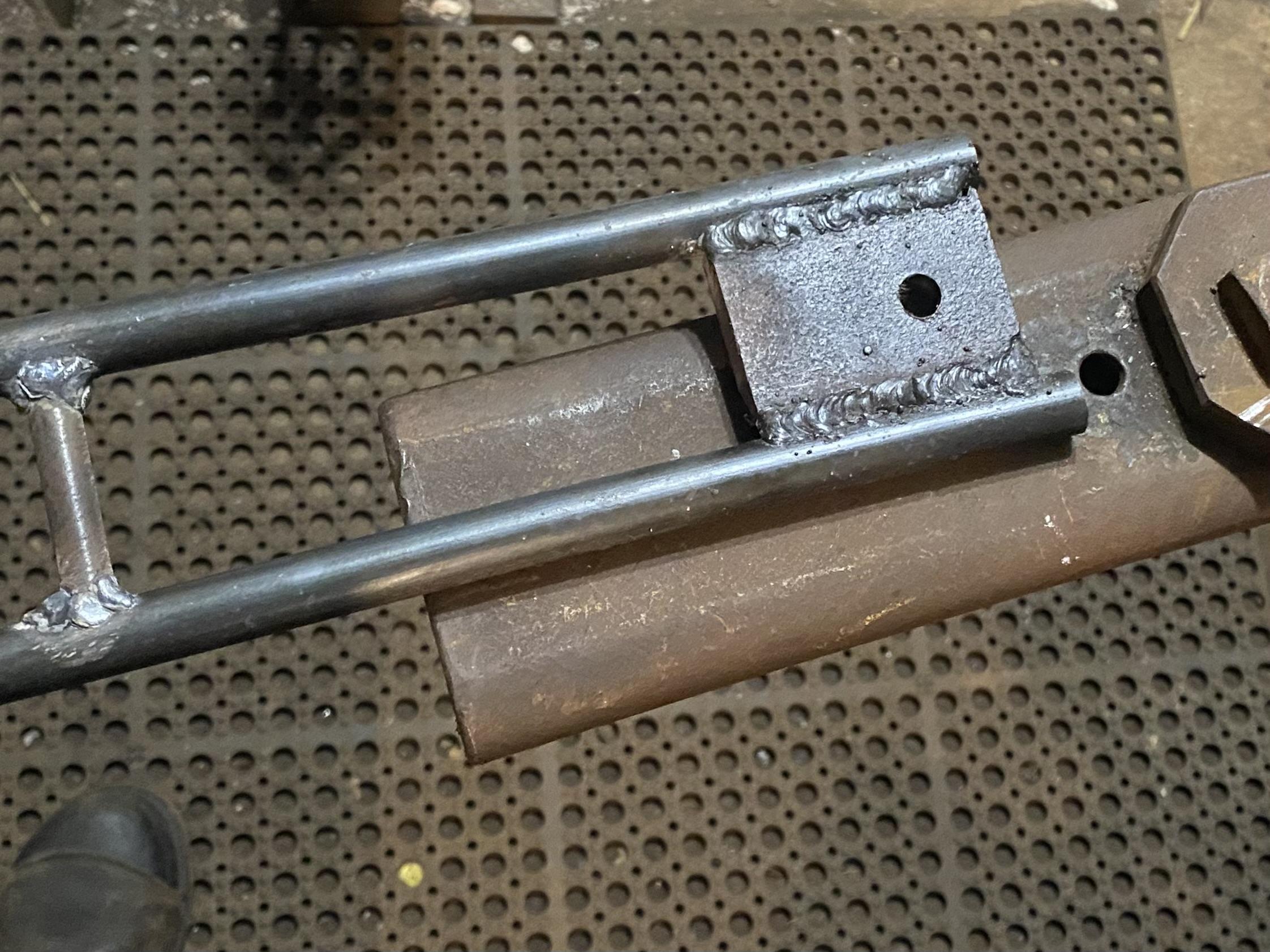

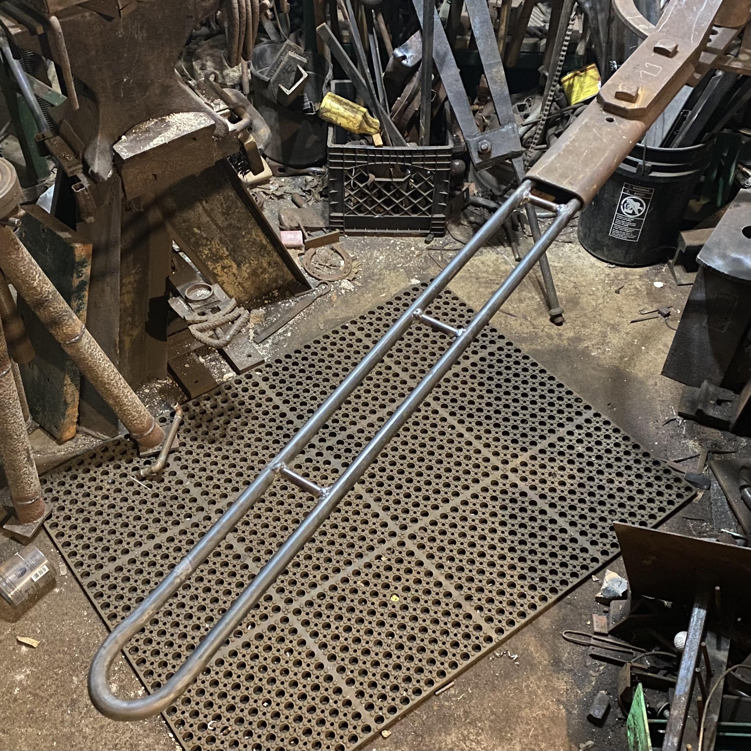

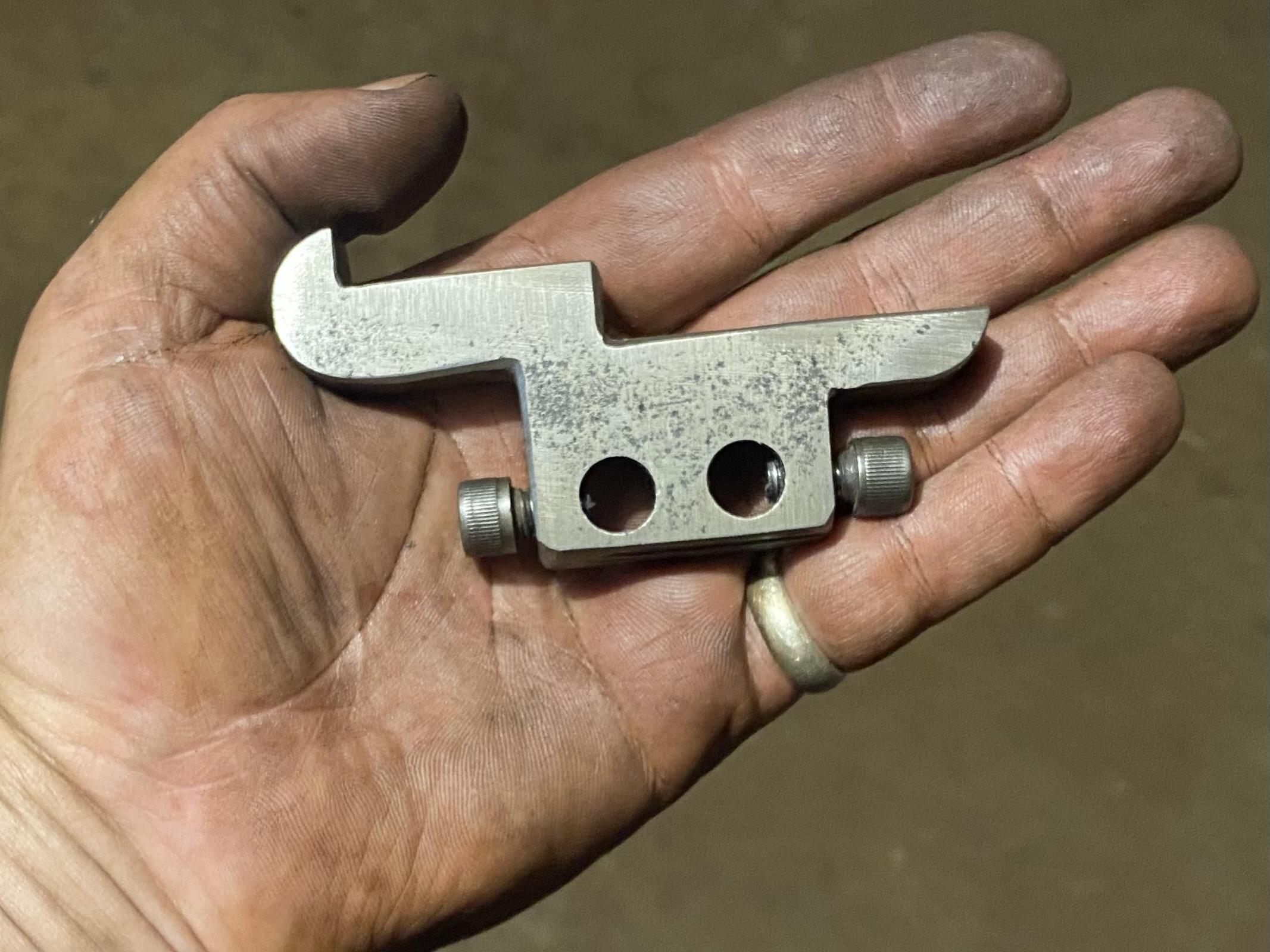

JHCC Posted September 3, 2023 Author Share Posted September 3, 2023 Made some more Hossfeld parts. First, inspired by one of the photos from June 5, I made an unconventional extension handle. I might add some diagonal bracing if I find it flexing too much. Also, a 25B Sliding Gauge from some 1/2” plate and a couple of 5/16” x 18 socket screws: Quote Link to comment Share on other sites More sharing options...
