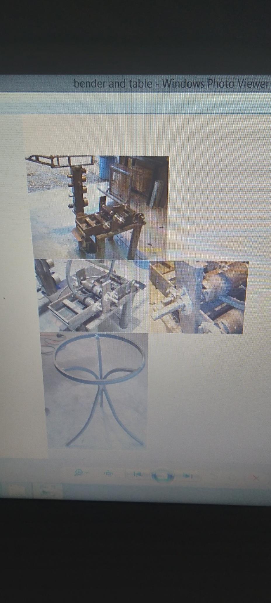

  Too bad I live in a black house, the charred stick idea sounds like a lot of fun.  ;).   I just took a picture of it on my puter screen instead.  Actually you can barely see it in the top photo.  I was still working on it.  I guess what made me happy was, it included the old ring roller which went in the scrap hopper when we moved.  I built a beefier one that went in also as they were both worn beyond salvation.  And too heavey....  Thought I had no photo of those.   I don't know why I did a collage of pictures like that, I might have been sending it to someone.  The photo looks sort of ok on my small phone screen but if it's all pixelated blur on a regular size monitor IDK what to say, theres always a fly in the ointment, eh?  The photo is from 2008.  Time sure flies.

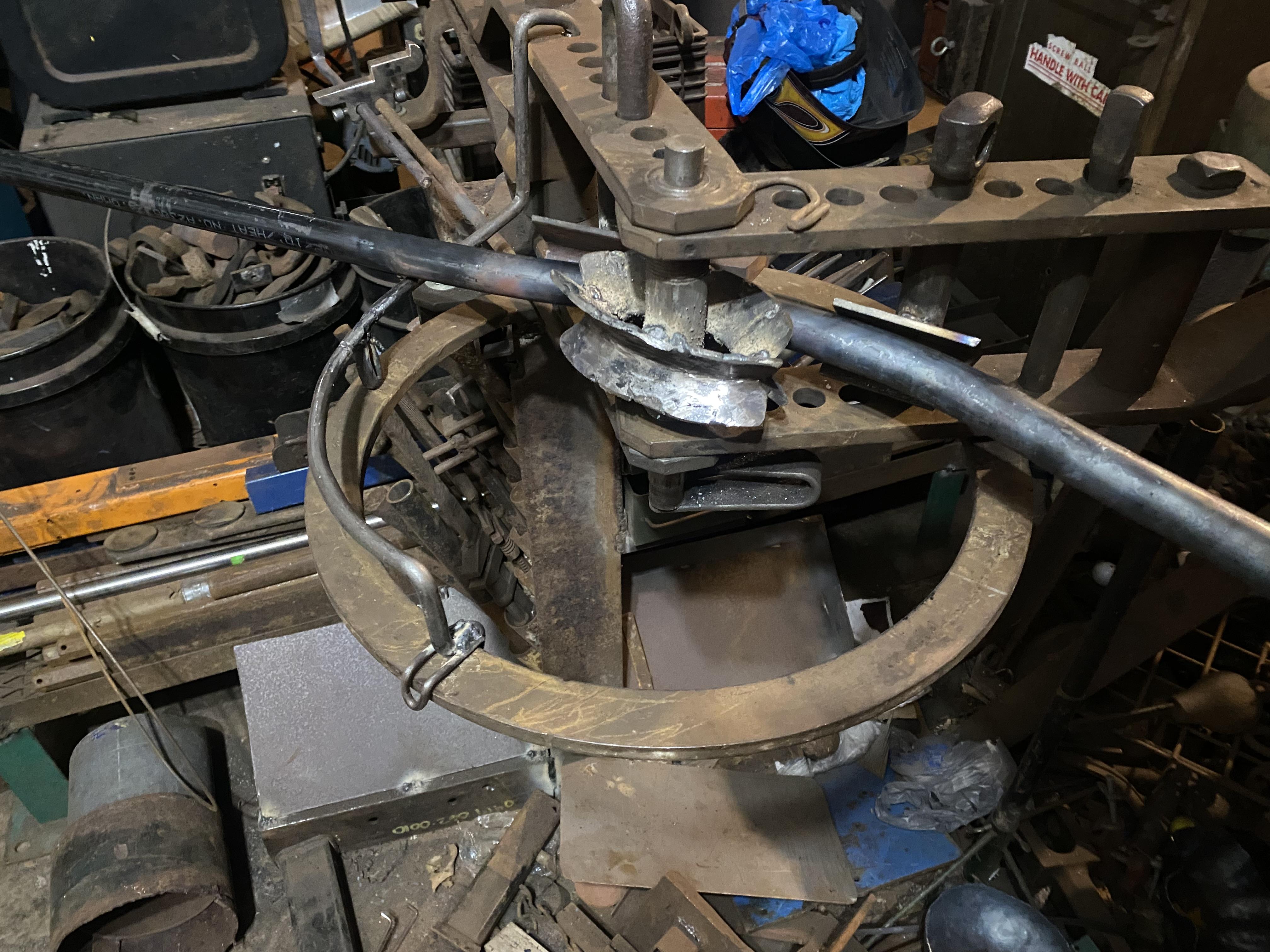

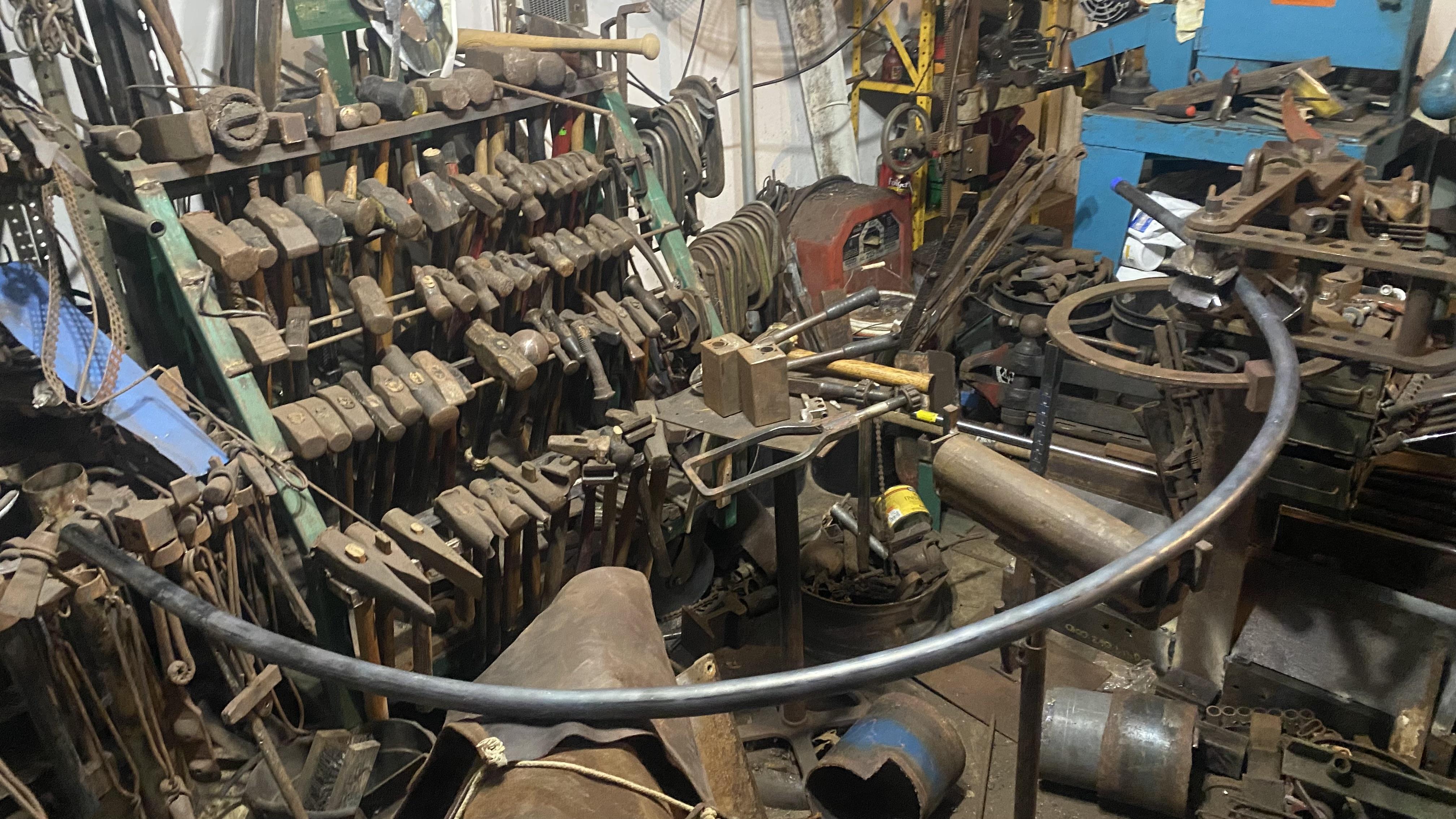

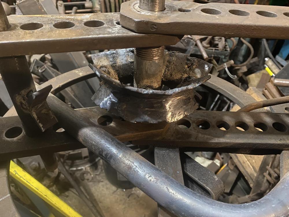

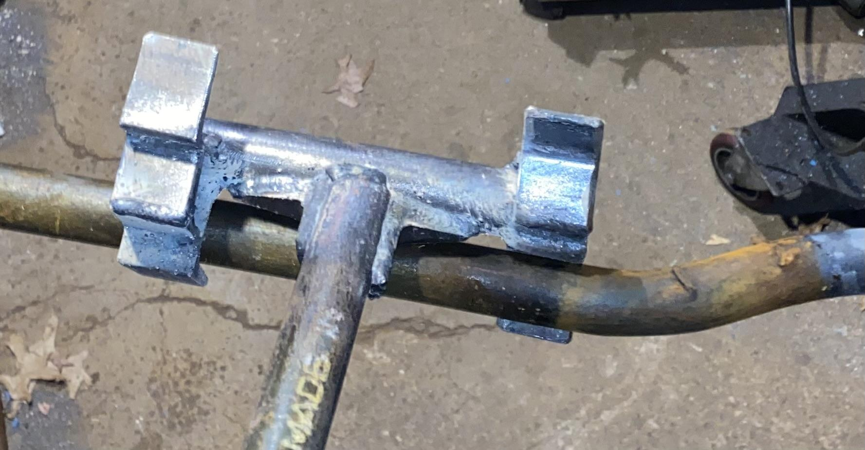

In preparation for another railing project -- this one involving a lot of sinuous bends in 3/4" Schedule 40 pipe (1" OD) -- I've been making a V-grooved radius tool for hot-bending round stock. Here it is set up for its first test bend:
This still needs some cleanup, but works well. The pivoting block on the left turned out to be much too narrow, with an unfortunate tendency to flop over sideways. I will make a pair of new ones before moving forward.

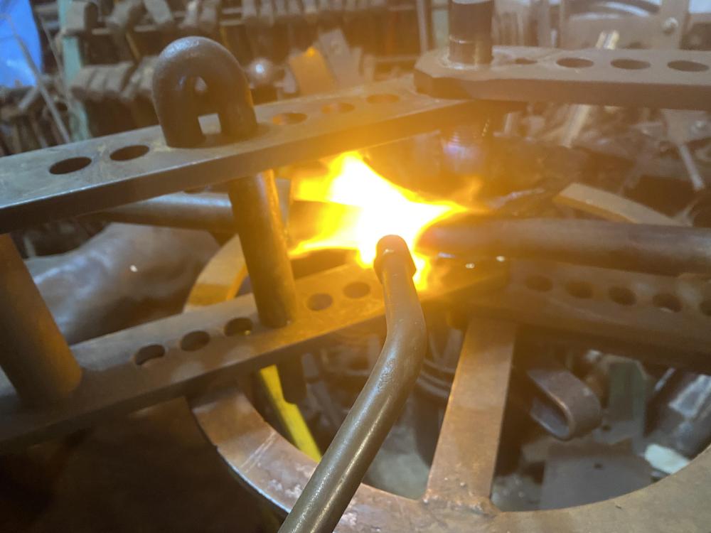

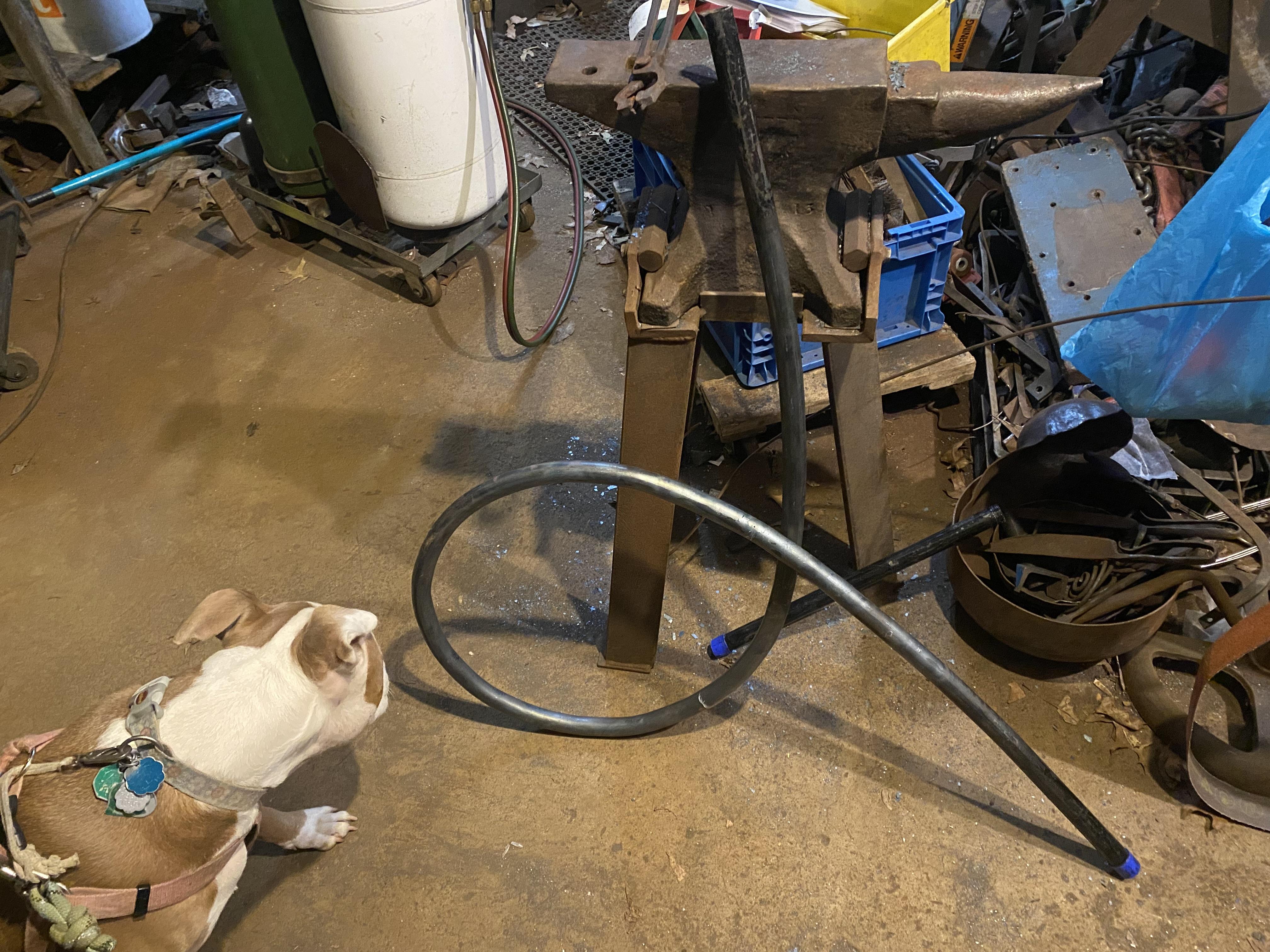

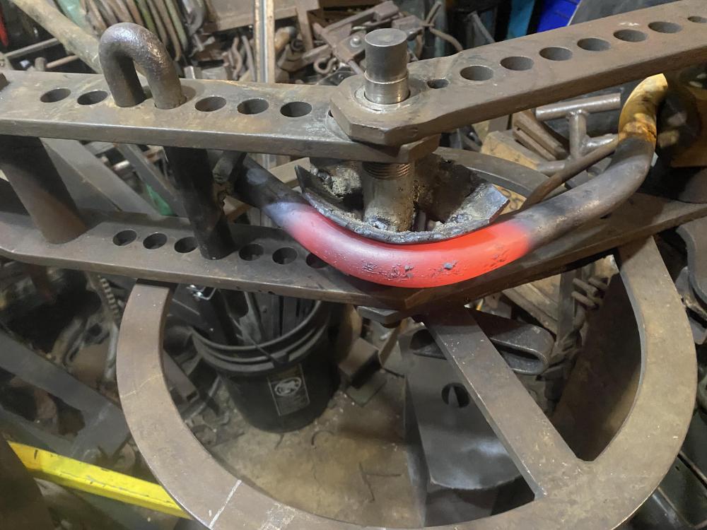

Here is the pipe being heated and bent:
The pipe had a tendency to collapse slightly, but not too badly. I think I have an idea about how to work around that: if I only heat an inch or so at a time, the unheated pipe on either side of the heated section should provide enough support to minimize the collapse. On the other hand, I might decide that I like the slightly oval cross section, so I'll have to play around with some more test pieces to see what looks good.

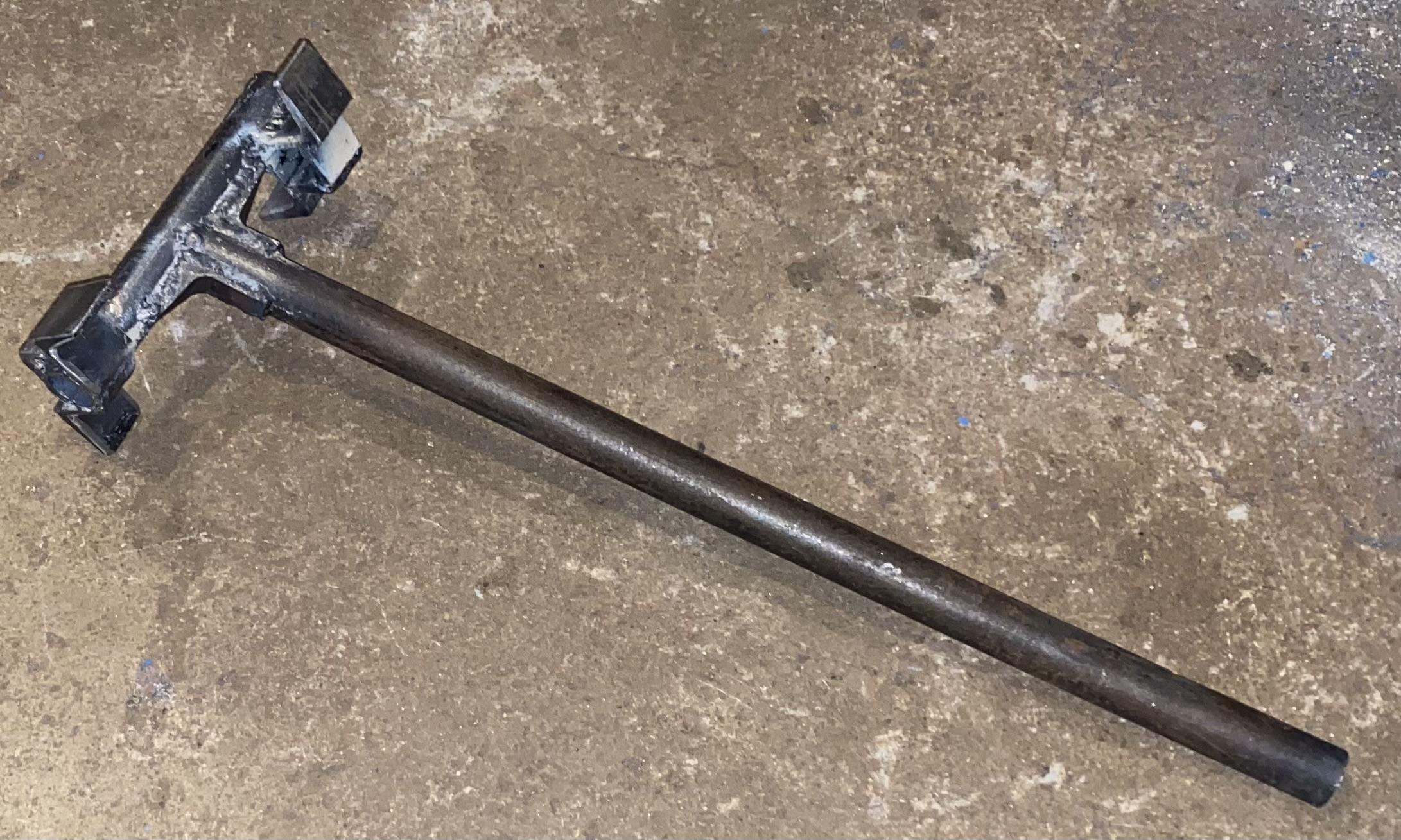

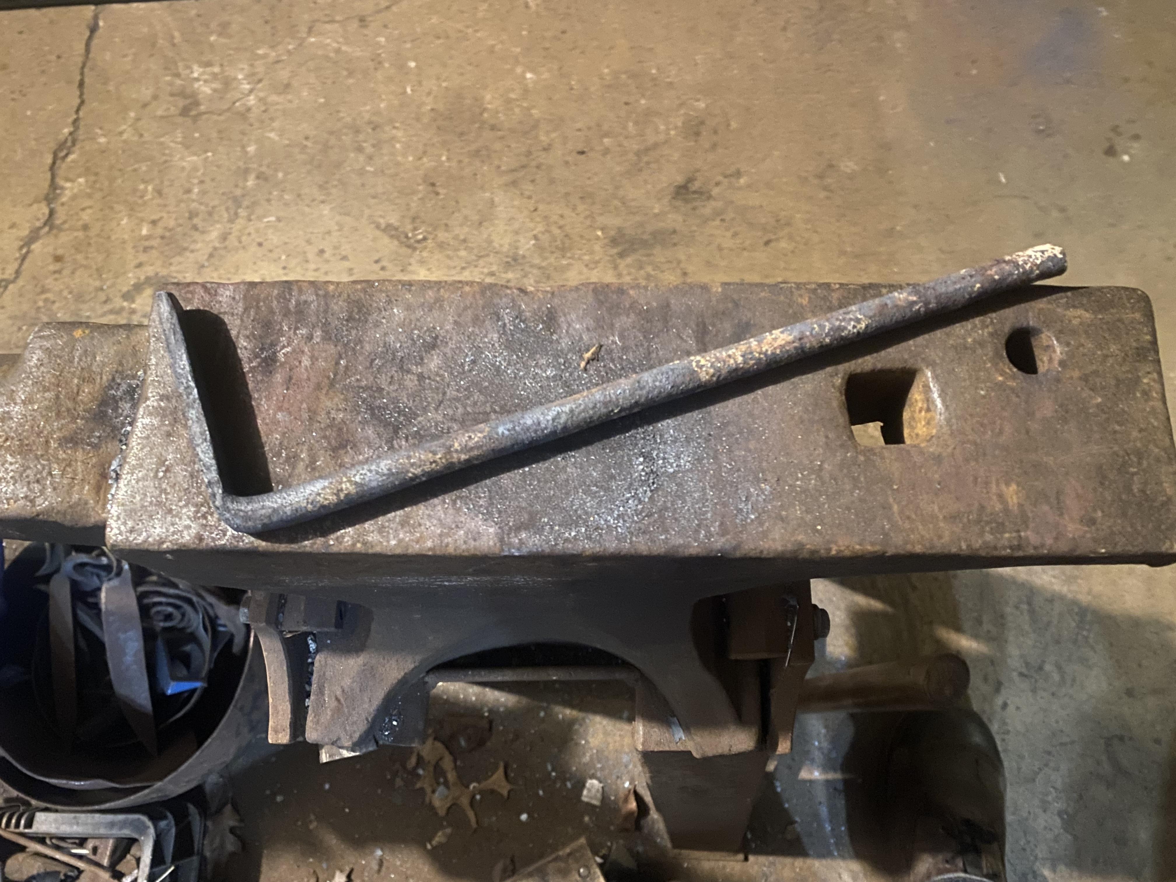

NB: It's not as easy to tweak hot bends in the #2 as it is cold, so I plan to make any necessary adjustments to the finished pieces with this beauty:

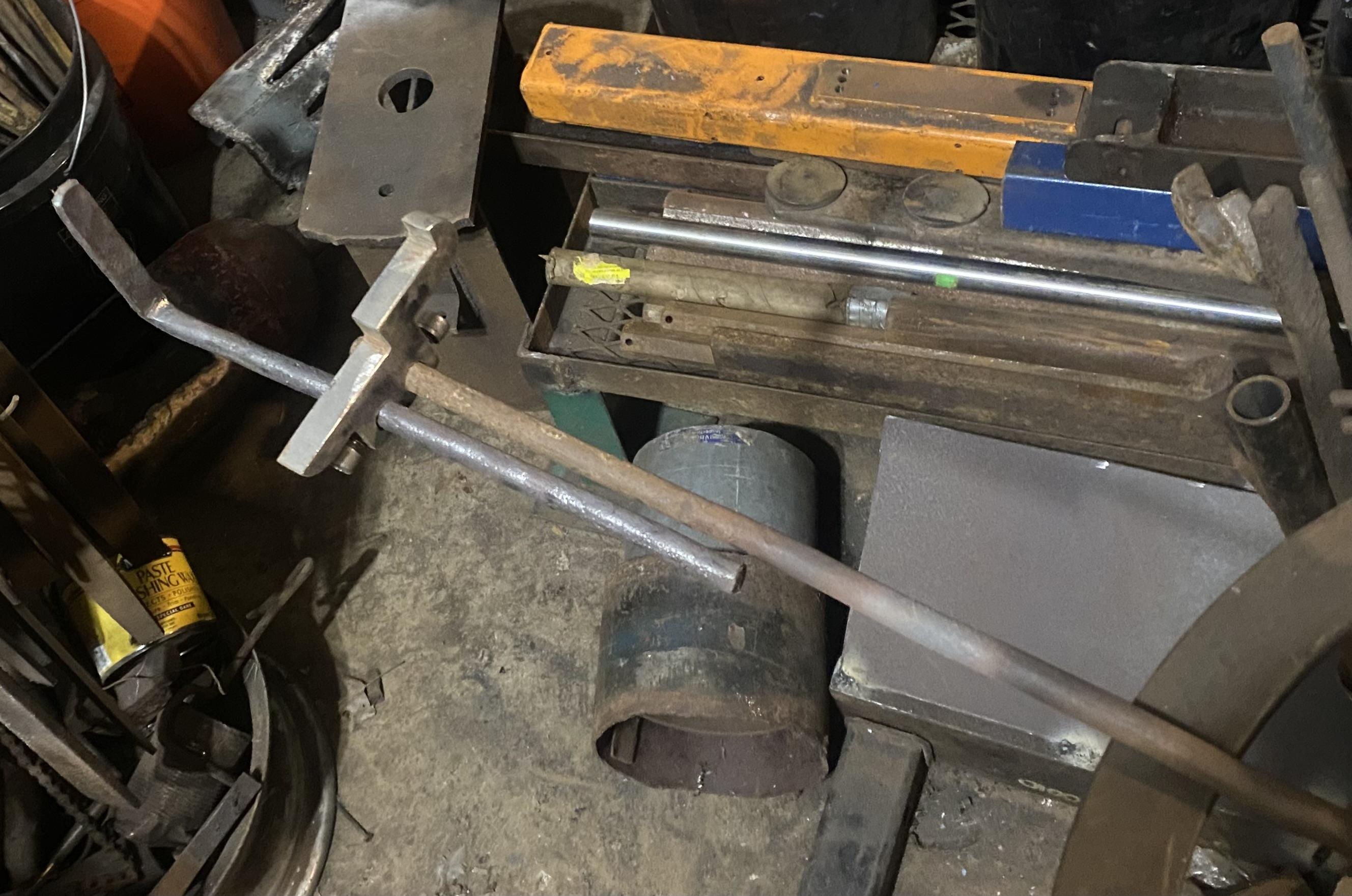

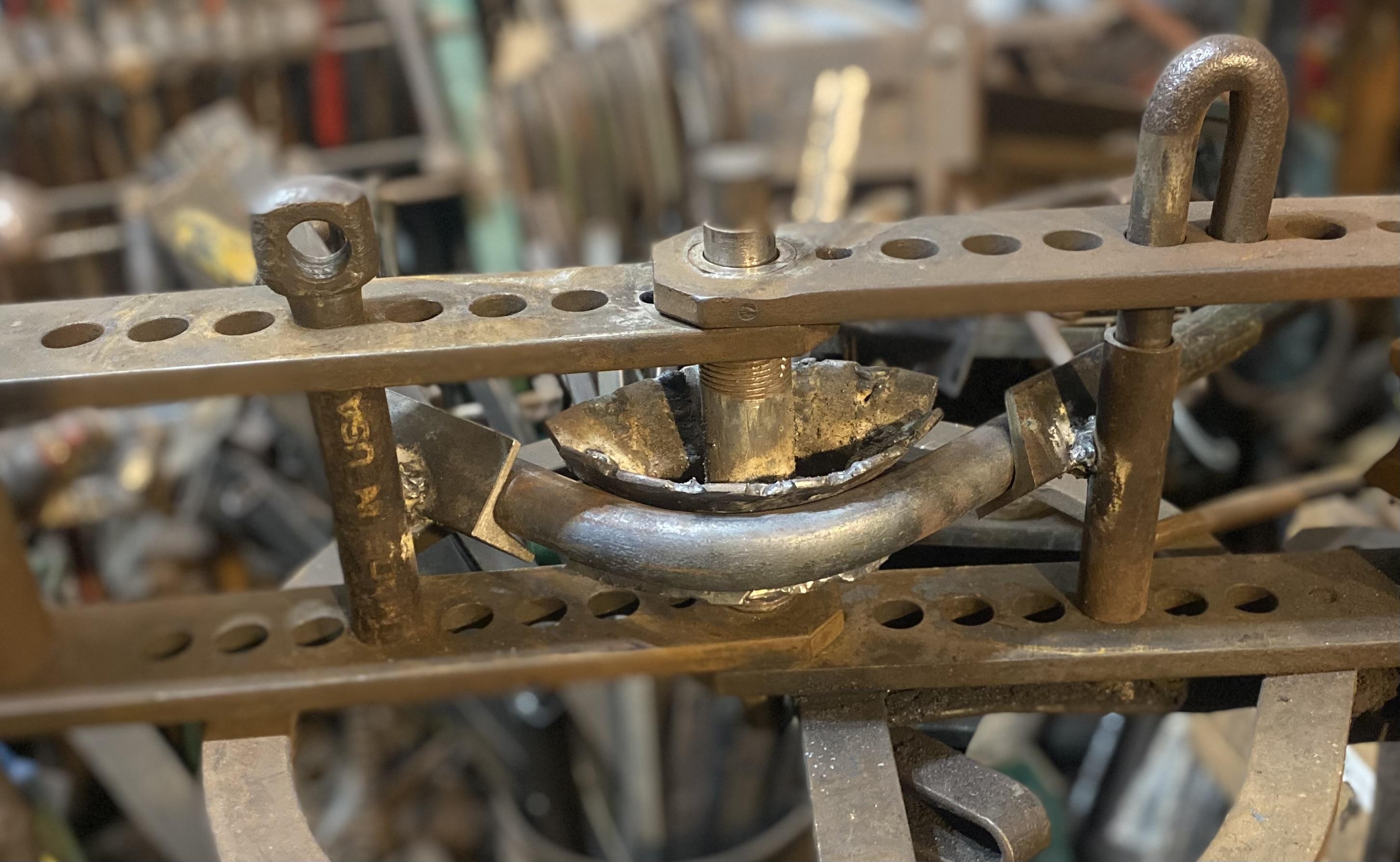

Made a pair of V-blocks to improve the working of the radius tool for round pipe.
Also added some diagonal bracing to my handle extension.
(Formerly part of a now-replaced anvil mounting system.)

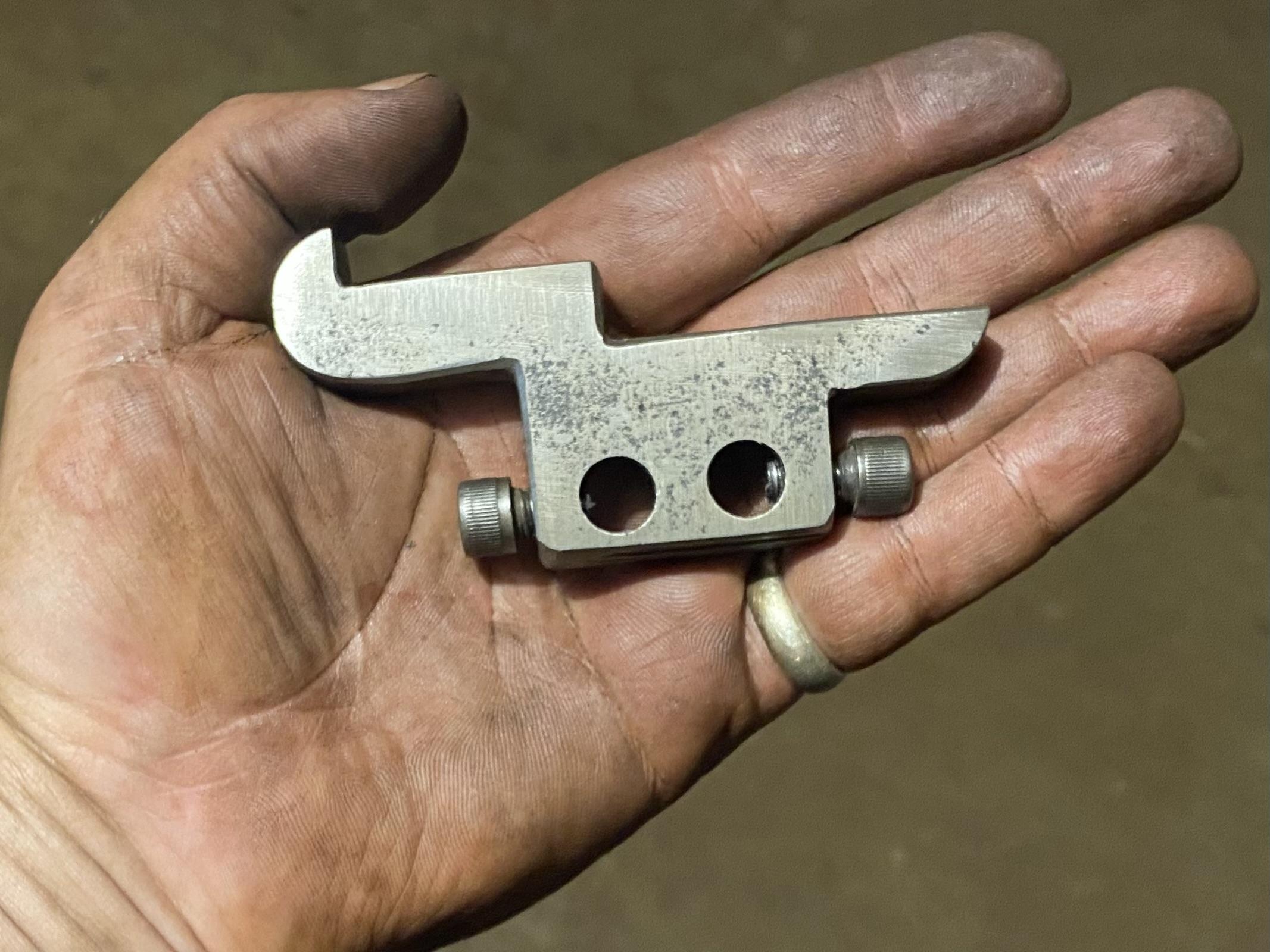

So, a few developments. The first is that I forged a Gauge Extension (part 25B1) to go with the Sliding Gauge (part 25B) I made a couple of months ago.

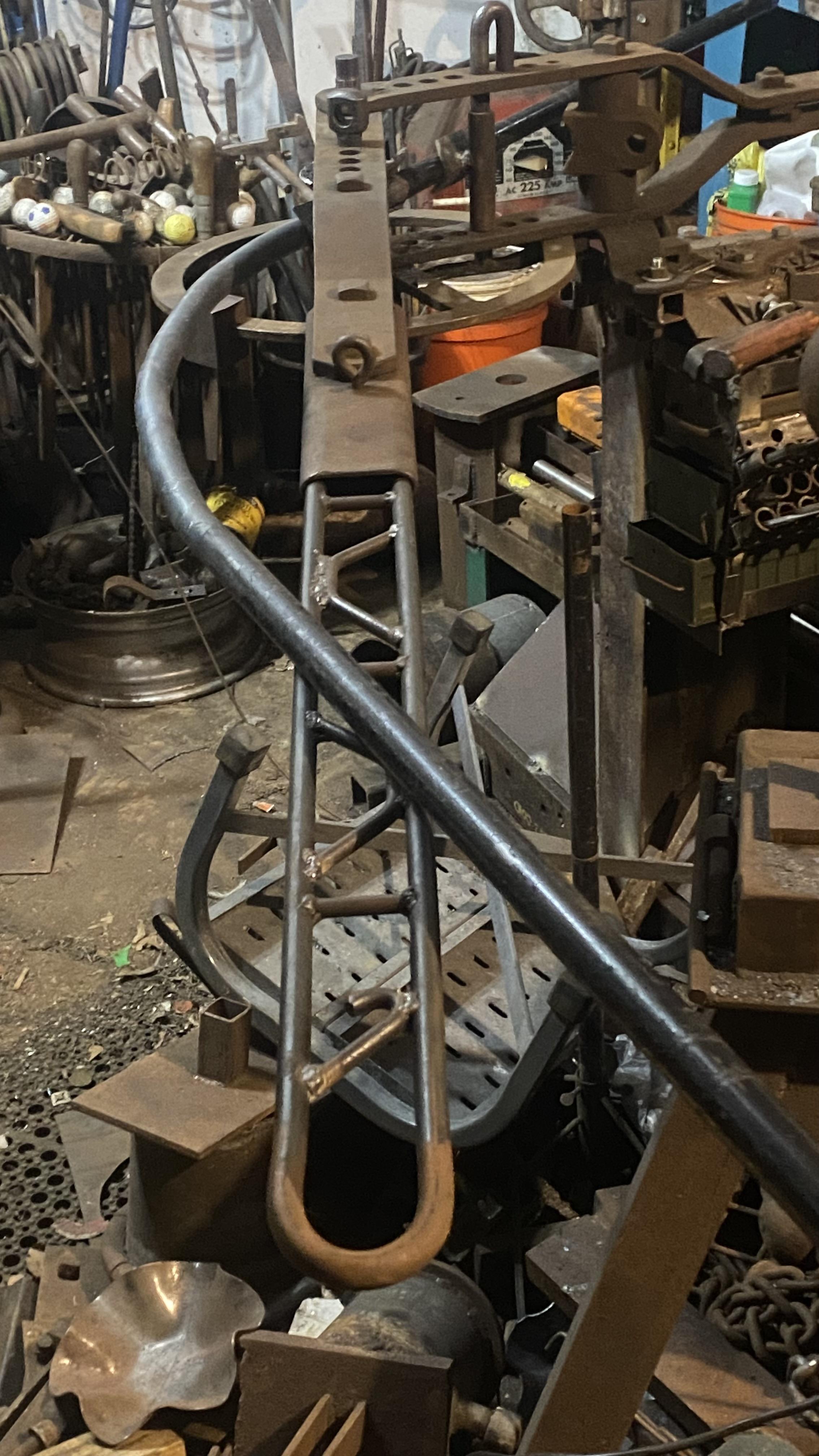

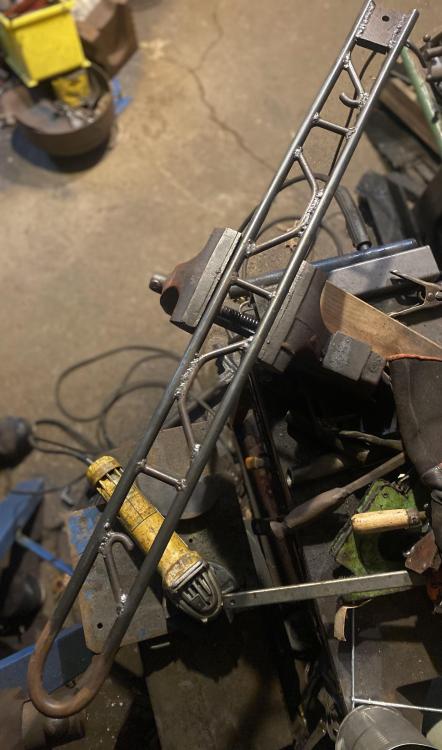

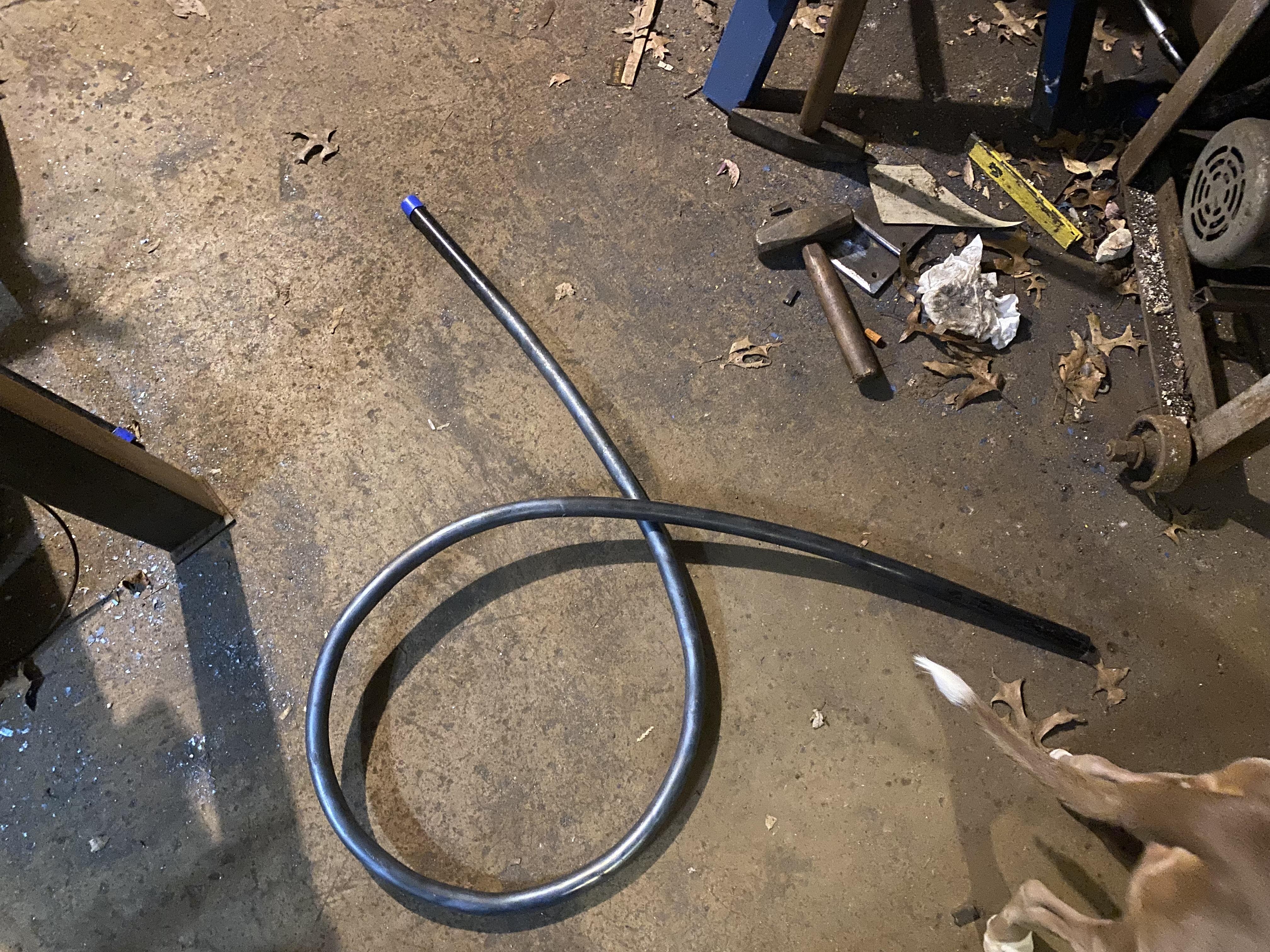

The second is that I’ve been working on the project mentioned above, making sinuous bends in 3/4” Schedule 40 pipe. This has been going well, and the wider V-blocks are a big improvement. However, I have been encountering two small problems: some difficulty in keeping the pipe supported, and having to reach somewhat awkwardly for the handle extension. For the latter, I plan to cut, bend, and re-weld it to match the bend in the standard Hand Lever (part 28B5); for the former, an idea is starting to percolate.

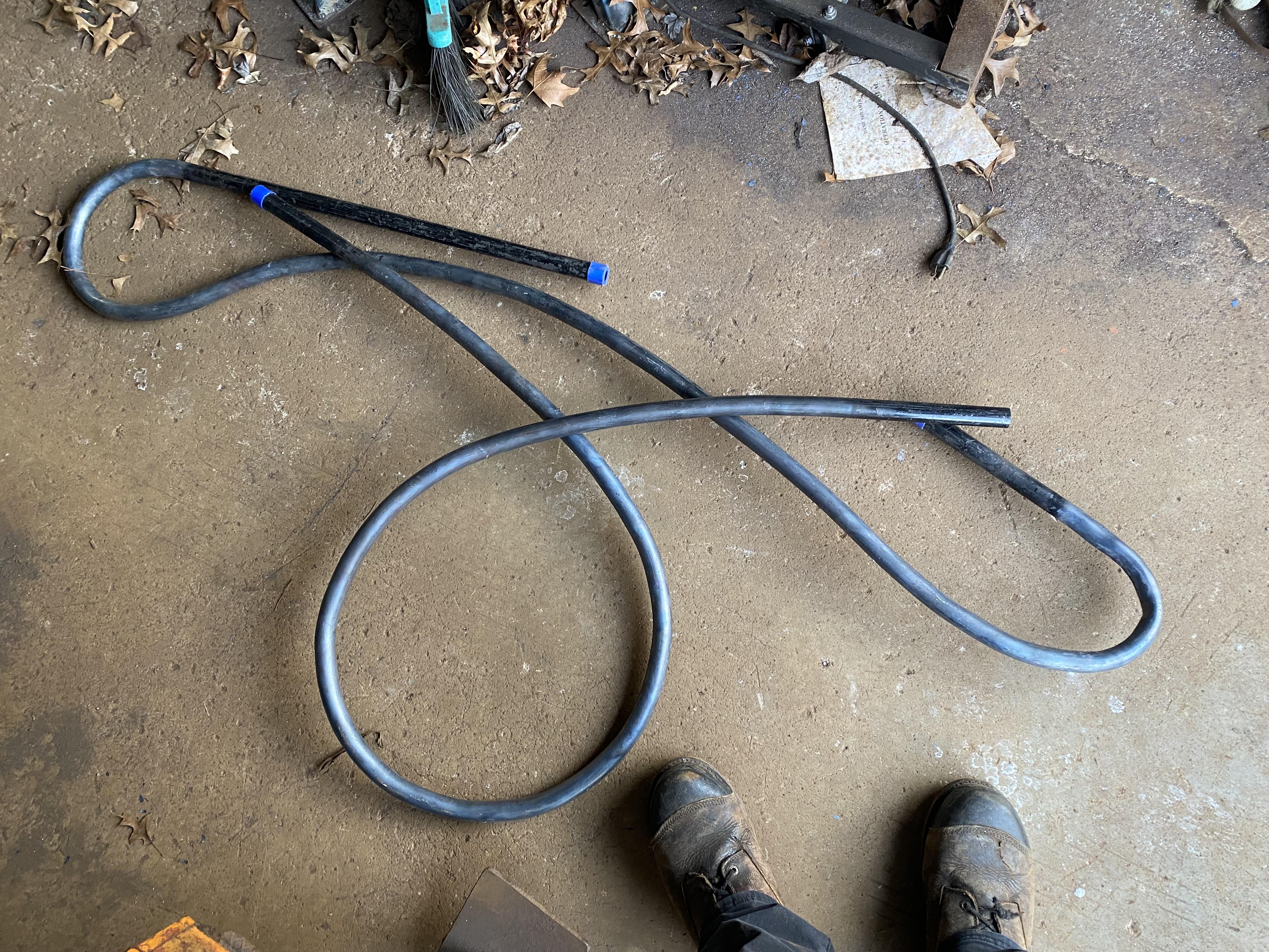

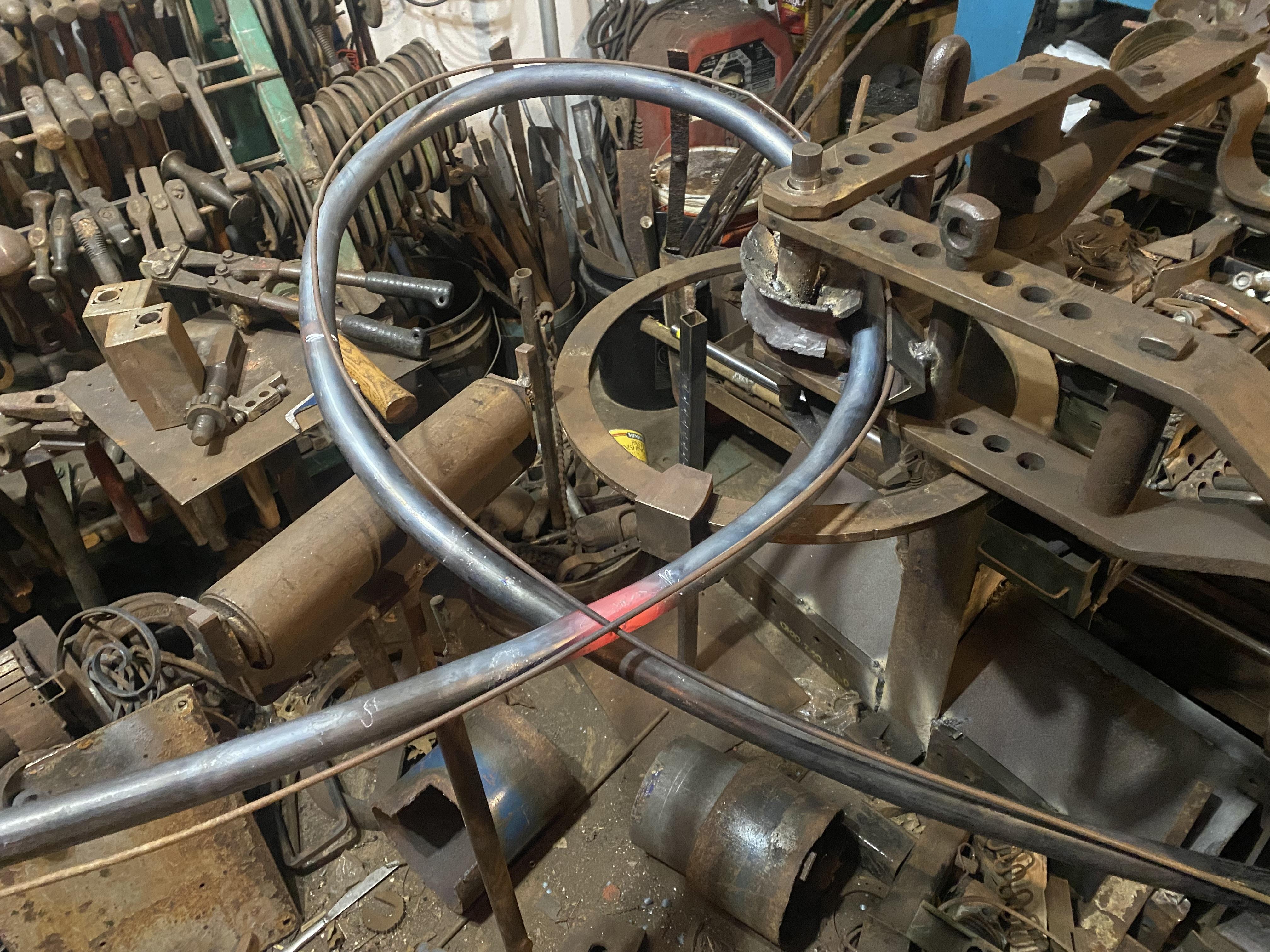

Oh, forgot to mention: here are the elements of the current stair railing project after their initial Hossfelding. More to be done, but the radiused V-blocks worked great for basic bending.
On 1/7/2024 at 10:38 AM, JHCC said:
I have been encountering two small problems: [...] and having to reach somewhat awkwardly for the handle extension. For [...] the former, an idea is starting to percolate.

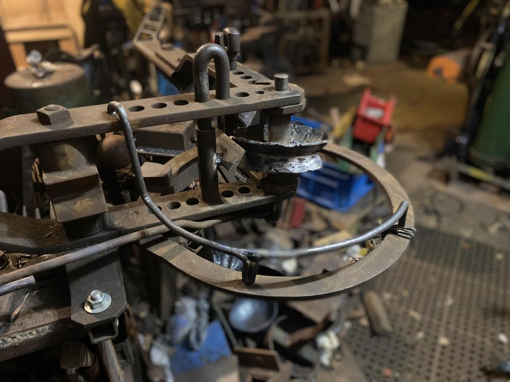

And here it is: a removable outboard stock support that hooks into the last hole in the main frame and rests on the circle guide.
It's not perfect, but it keeps the pipe from slipping out of the tooling while you're setting up the bend. I'll call that a win.
