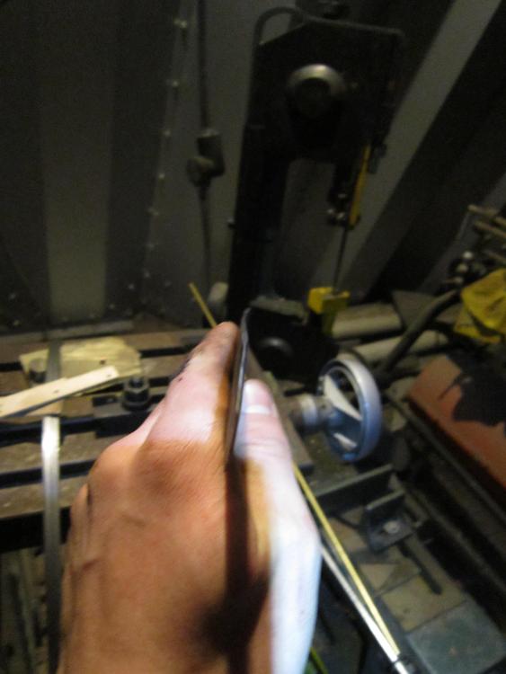

finishing up a blade I made and running into some trouble with keeping the blade straight
steel: 1095
spine thickness: .07-.08 in
oil: parks 50
Quench temp: non-mag +4-8 seconds
oil temp: 6*C
doing best to move blade in up-down motion only
on second try immediately after oil stops boiling placed between anvil and a large flat piece of steel, still bent. 3rd try same plus pushing on plate with my weight, not as bad but still some.
Now figuring I need reanneal and normalize again before trying any more
on the plus side the blade did come out hard:D (take half a win over a full loss)
results:  #3
TIA for any help

If you havent tried it, that warp might be fixed by clamping it to a thick bar with shims( like a 3 point straightening jig) and running it through a tempering cycle or two.

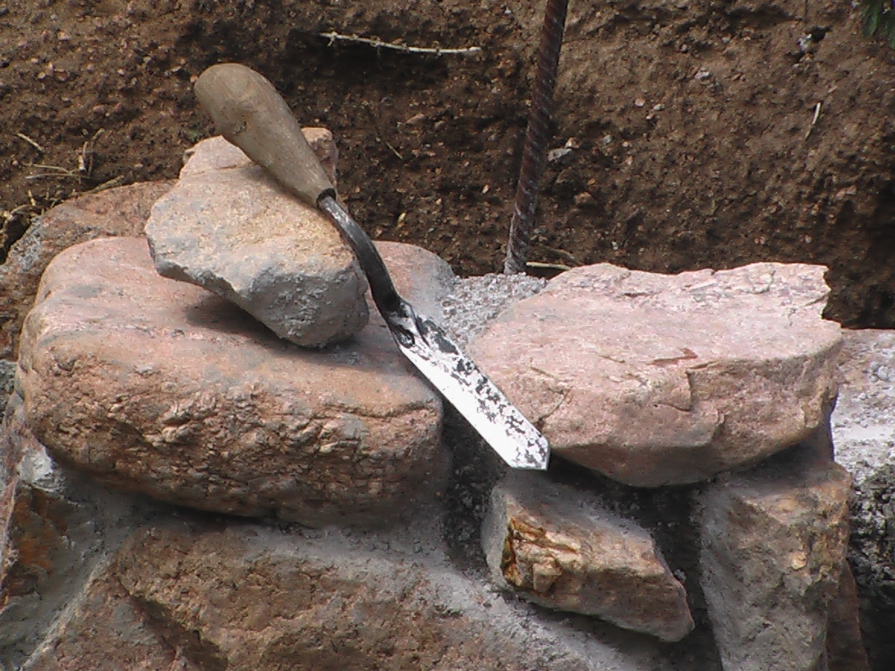

I consider the 10 series steels to be a great all around steel. Make a hammer quench in oil to enhance toughness. Make a chisel, quench in water to enhance hardness.

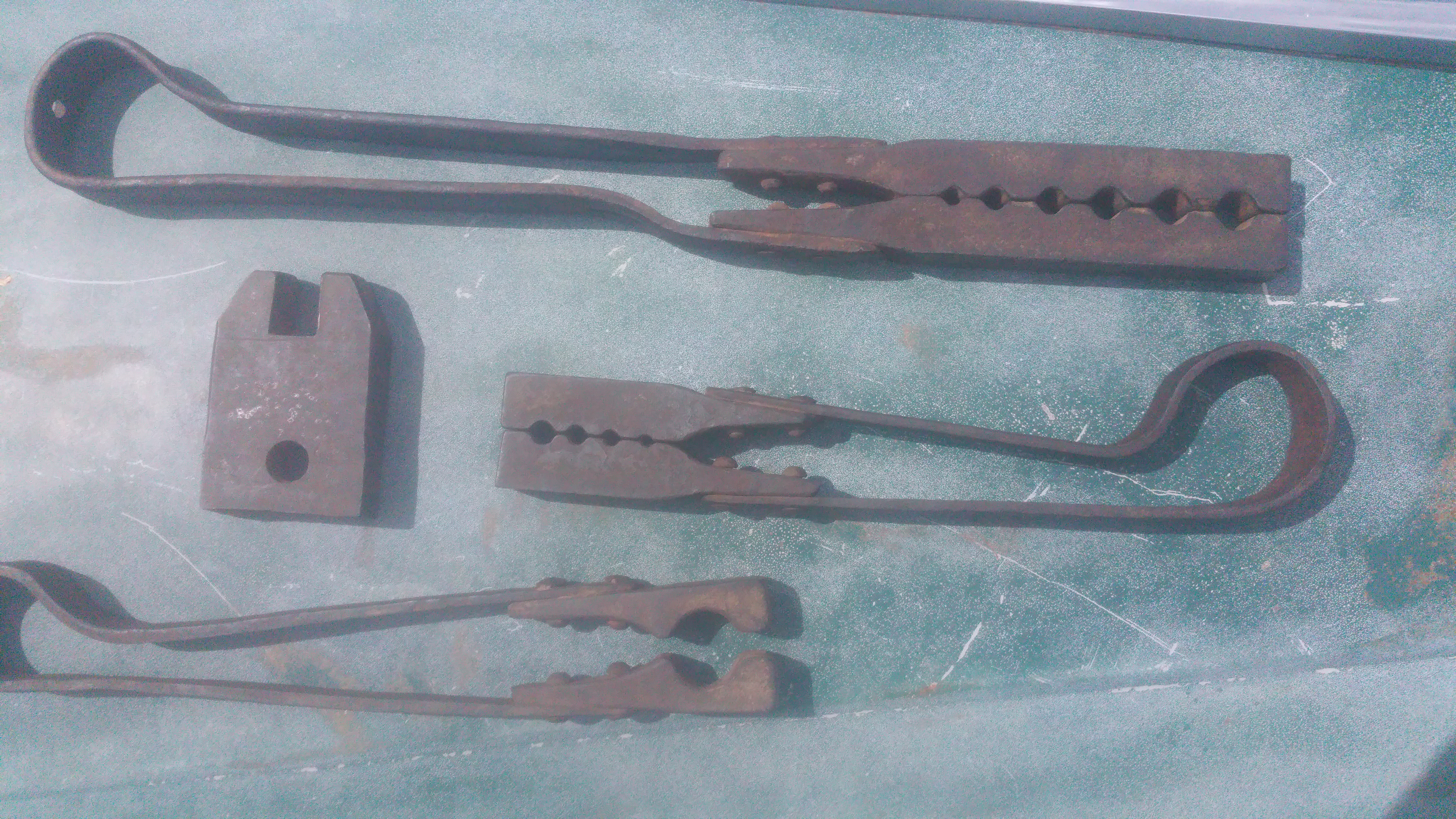

3 of my tenoning tools. All made from 1095, water quenched, drawn to a blue temper. The big one was made around 1984 or so.

If all else fails, take the warp out during tempering cycles with a 3 point bend.

Note the thick cross sections of your tooling above... I agree... The specs are generally given for a 1" cross section.

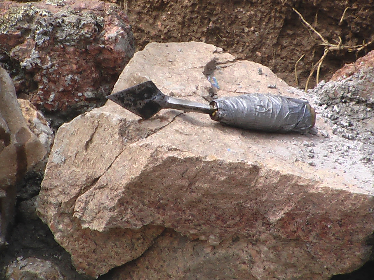

Two tools made from 1095, water quenched, drawn to a purple for springiness.
I present this not for the sake of argument, but to show just what you can do with this steel. It is very versatile and a great steel for any tool or blade. Know the characteristics and choose your process.
