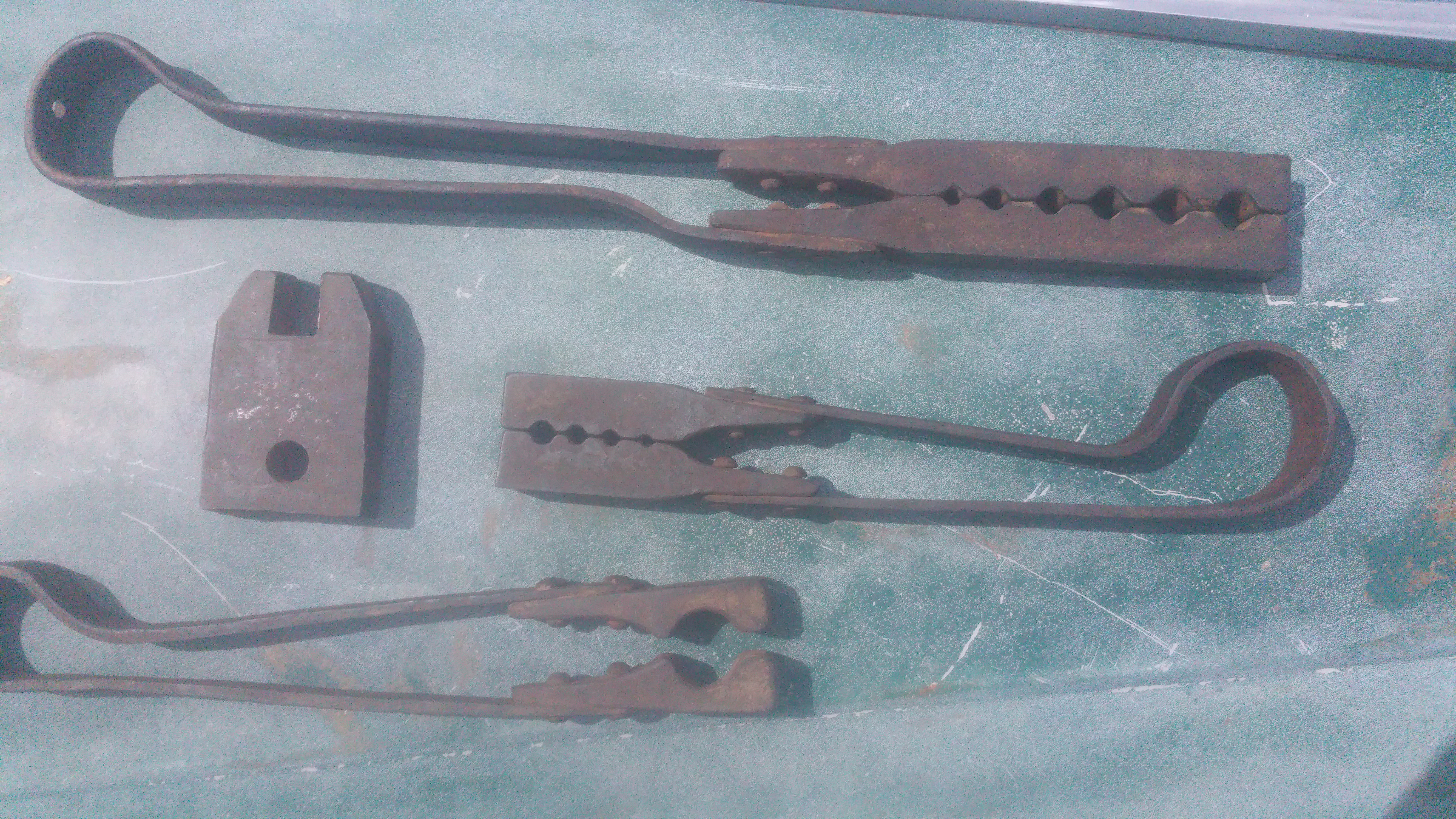

You said you were making tenons and came up with the vice problem. Heres a pic of mt tenoning tool. I use it under my 25# lil giant, but you can hand hold it and use a stand and a weight to hold your pickets level and secure on your anvil face to free up your hammer hand. Theres multiple holes, not only for different size tenons, but when you make them, start at the largest and use each to step down your tenon. On the longest tool, the holes are 5/8" to 5/16" in 1/16" increments. So a 3/8" tenon out of 5/8" starts at the top and is forged down a 1/16" at a time. If you need pics of the setup with a stand and a weight, let me know.
  Anvil, I can imagine it mayby, but I for one would like to see that set up, if you would be so kind.
I just saw your post. Ill do a setup and pics tomorrow.
  Shoot, I wouldn't bother Anvil, I can see it in my minds eye, now.
