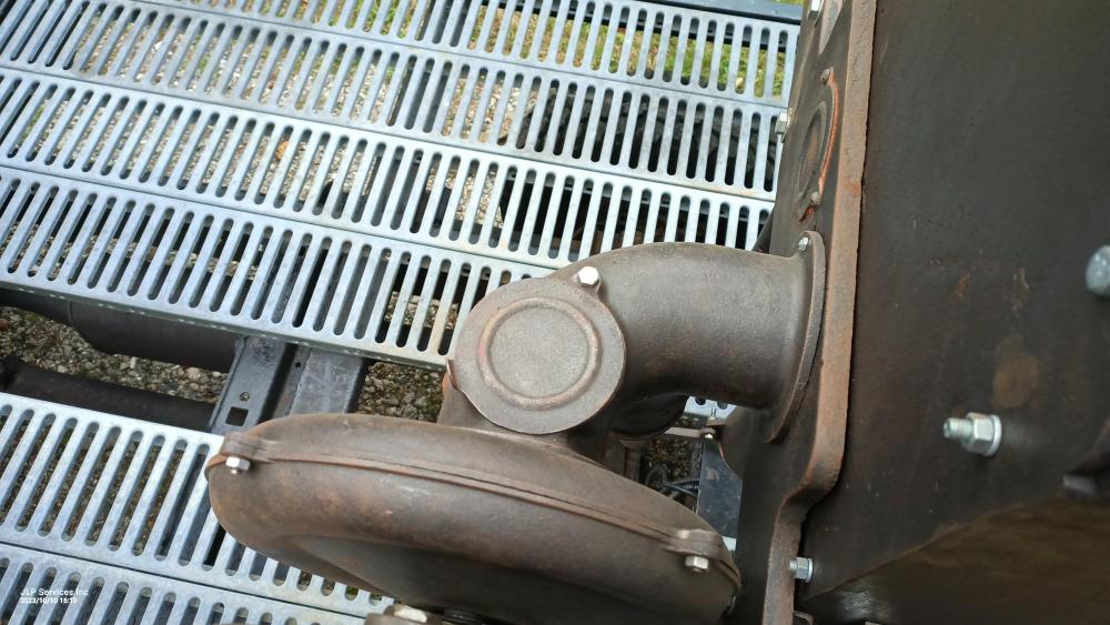

HTINVA Posted March 21, 2023 Share Posted March 21, 2023 Here are some additional pictures - just not sure if it is what you are looking for? one for picture of hood back Quote Link to comment Share on other sites More sharing options...

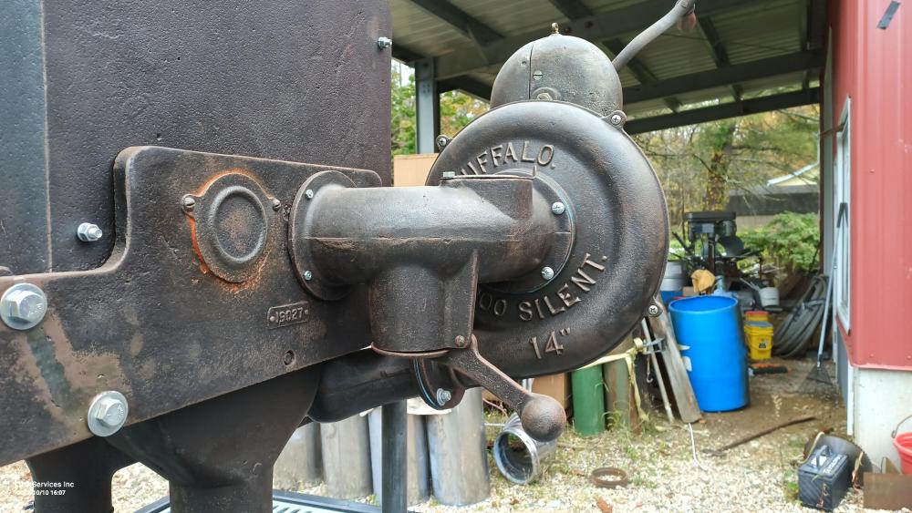

JHCC Posted March 21, 2023 Share Posted March 21, 2023 Can you get a shot showing all of the pipe connecting the back of the forge to the intake of the blower? Quote Link to comment Share on other sites More sharing options...
jlpservicesinc Posted March 21, 2023 Share Posted March 21, 2023 Htinva, yours is pretty complete. Other than the clinker breaker and arm missing. I'd give an offer if you are going to sell it. To use it, there are more control issues vs non down draft types so there is added complexity. Not really sure if the down draft is as effective as they advertised. I do plan on making my own designed unit if I can't get one in the next few years. The school will use coal as long as I can get it. So really want to find a solution for startup smoke. Your unit looks like it might have had an electric option and someone switched it to hand. Quote Link to comment Share on other sites More sharing options...

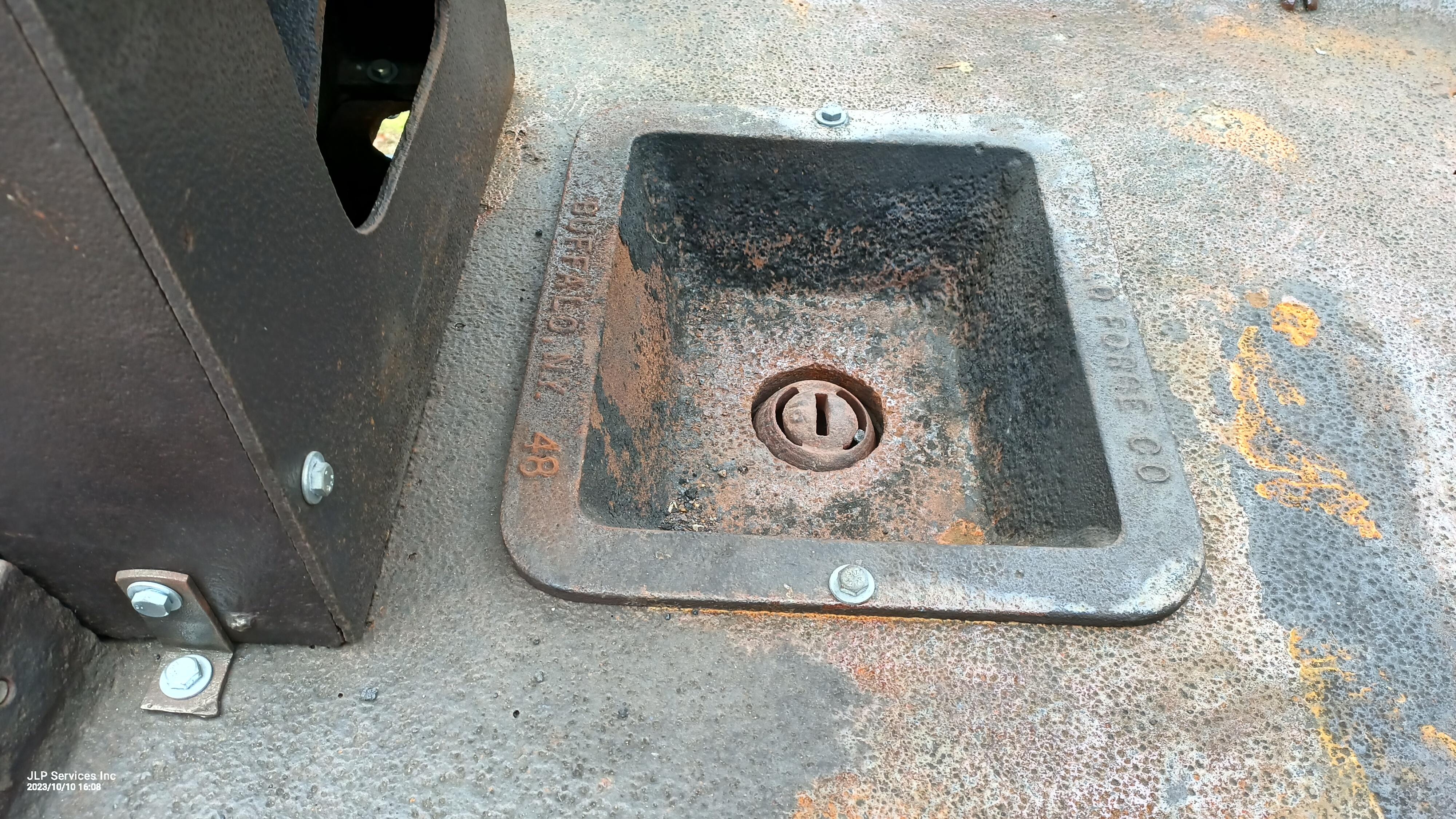

jlpservicesinc Posted March 21, 2023 Share Posted March 21, 2023 Don't worry about the concrete.. Back in the day that was normal. When I say day.. I mean 50's and such. Adding Salt to the mix helped prevent steam explosions on newly lined forges.. Your forge is well aged and all ready cracked so no worries.. The only real problem is when wetting the fire or green coal and having the water seep down between the cracks and collecting under the cement and rusting out the pan. Quote Link to comment Share on other sites More sharing options...

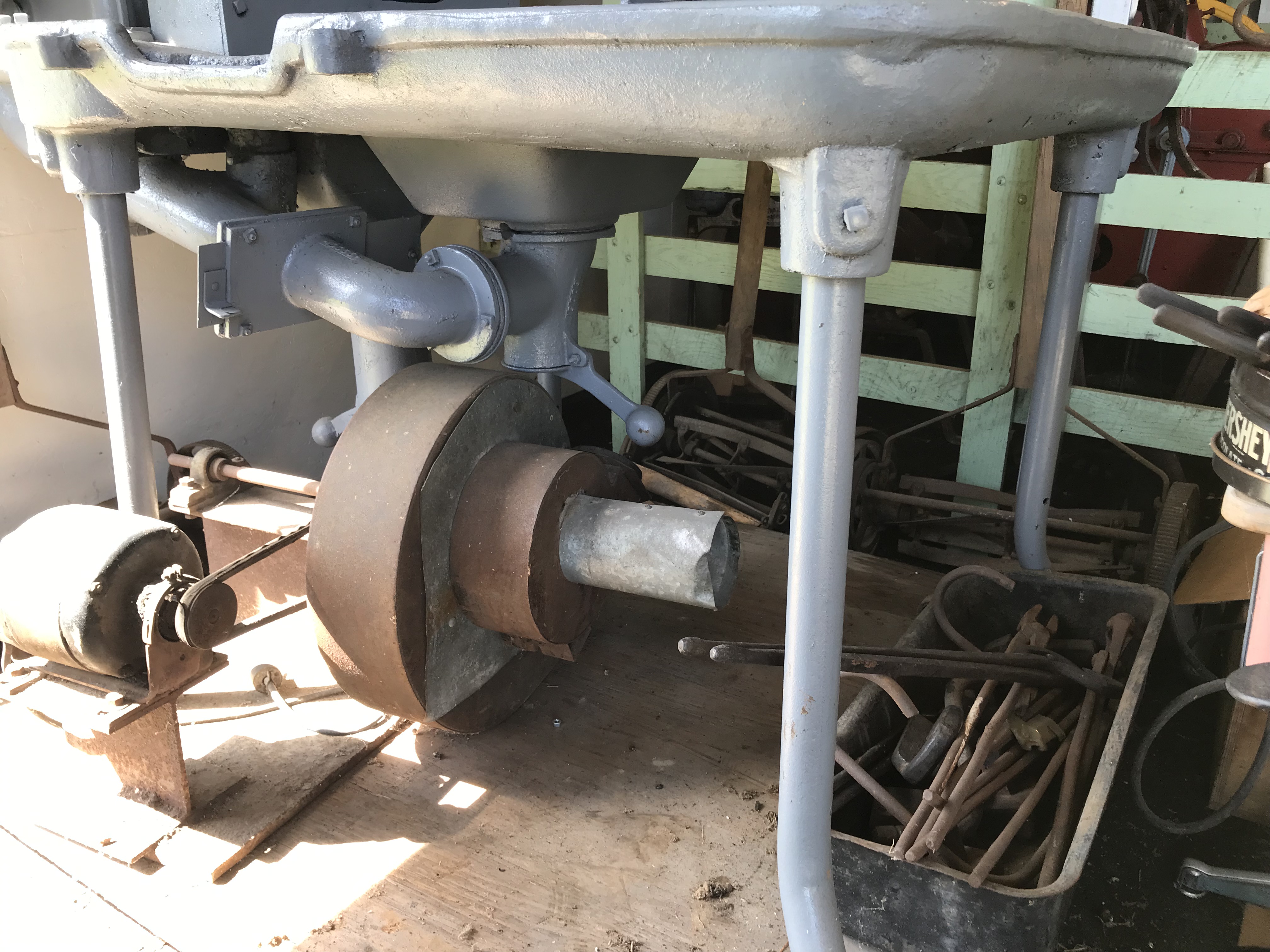

giantdude33 Posted March 21, 2023 Author Share Posted March 21, 2023 Great pictures. The hand crank blower is original to the forge. The blower below the forge looks to be a sheet metal job , probably a squirrel cage blower put together for some unknown purpose. but not original. The picture below is your blower out of a catalog. Quote Link to comment Share on other sites More sharing options...
Frosty Posted March 22, 2023 Share Posted March 22, 2023 Nice forge, good score! Back in the day portland cement was often mixed 2:1 with fire clay for fire places, pits and forge tables like yours. Cracks like the ones in yours would just fill with ash and clinker and be ignored in use. Frosty The Lucky. Quote Link to comment Share on other sites More sharing options...

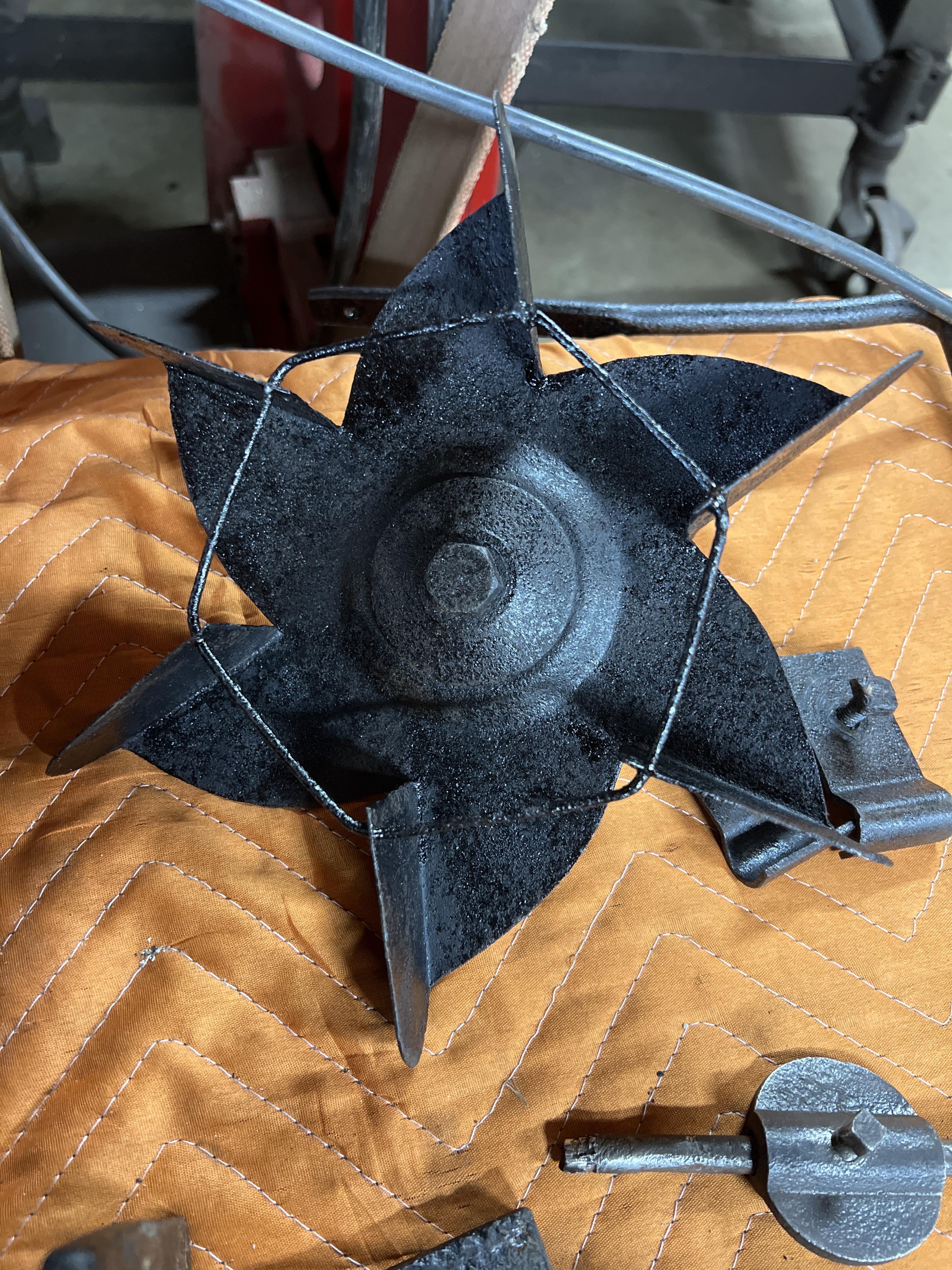

Shainarue Posted July 14, 2023 Share Posted July 14, 2023 Nice! So did you get lucky with the blower blades all being intact or did you fabricate those? Quote Link to comment Share on other sites More sharing options...
giantdude33 Posted July 14, 2023 Author Share Posted July 14, 2023 Blower blades are all intact. In fact, the wires that are braised to those blades to support them is still in place. Quote Link to comment Share on other sites More sharing options...

jlpservicesinc Posted August 26, 2023 Share Posted August 26, 2023 /That is so cool.. Do you shutters work too? Nice job.. Looks great.. Remember to be careful with watered Coal in the forge bed.. Also remember to add some clay before firing around the firepot.. You don't have to fill it up but going tot he height of the flange on the firepot will help out a bunch.. Many of these forges were cracked from watered coal and no heat absorber/dispenser.. The clay acts as a buffer. Quote Link to comment Share on other sites More sharing options...

jlpservicesinc Posted August 27, 2023 Share Posted August 27, 2023 The blower blades are markedly different than the standard 200 blower blades.. It's neat that they reinforced the blades to deal with the extra heat of the incoming hot air, smoke, etc. Quote Link to comment Share on other sites More sharing options...

jlpservicesinc Posted August 27, 2023 Share Posted August 27, 2023 keep in mind, it's the unburnt gases you want to send back.. Not the heated gases that are lighter.. There are butterfly valves to change the way the air is both taken in from the lower port or lower tuyere and pushed thru into the firepot.. There is also a butterfly valve for the upper discharge valve that pushes air out the top.. This creates a venturi effect and blows the smoke up the chimney as an assist. you have what I like to call the "throttle Valve" this controls 2 aspects at once from what I can tell.. These units are more troublesome to to use if you don't have experience as they need to be adjusted in use to be used to maximum efficiency.. The heavy smoke when first starting the fire is the smoke that will be drawn into the lower smoke reclamation intake.. The flame once established is supposed to go up the chimney and not recycled thru the blower. I'm excited for you.. But it will give you fits until you figure it out.. An 8" flue is very small considering the amount of volume and velocity it will need.. That is why it has the air or venturi assist. There is are some minor differences between the 6660 models and the 660 models.. from the photos it's hard to tell if you have the secondary butterfly valves but from your clean-up photos I believe I had seen one of the valves in the photo.. Quote Link to comment Share on other sites More sharing options...
JHCC Posted August 27, 2023 Share Posted August 27, 2023 This is also why there’s the gated opening on the pipe into the back of the blower. Once the fire is burning cleanly, you open that up so that you’re pulling fresh air into the blower rather than heated gases out of the flue. In principle, this is very similar to the “smoke-catcher” that Alexander Weygers describes in The Modern Blacksmith: Quote Link to comment Share on other sites More sharing options...
