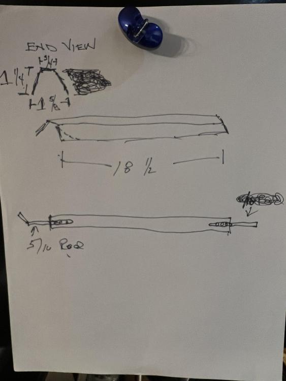

giantdude33 Posted October 11, 2023 Author Share Posted October 11, 2023 Attached are some additional pictures and a drawing of the dimensions of the shutters.. let me know if you need anything else.. Quote Link to comment Share on other sites More sharing options...
George N. M. Posted October 11, 2023 Share Posted October 11, 2023 OK, I think I understand the general principle, it eleiminates and burns the heavy smoke which occurs when starting a simple coal forge and when the air in the chimney is too cold to draw. However, I don't think I could pass and exam or build one but I think I understand the basics. Thank you. George Quote Link to comment Share on other sites More sharing options...

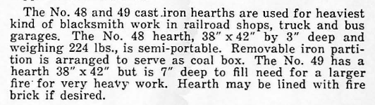

jlpservicesinc Posted October 11, 2023 Share Posted October 11, 2023 Yes, the down draft hood is for burning the heavy smoke and for assisting with the cold chimney drawing problem. Catalog 801 1903 Buffalo forge and blower. So in my research on the subject, It's been made clearer and clearer that the down draft hood assembly was indeed a separate item and could be added to both the cast iron forge bodies of the 48 series of forges as well as other models of both cast iron and pressed steel. So the forge body is a 48 Series.. This model is a 248 with downdraft hood which is a 6660 model. The 2XX represents the model of blower.. 2XX is the 200 Silent blower, The 5XX is the 500 series blower and the 7XX is the 700 series blower and 8XX is the electric model.. So a 248 is this forge body with a 200 series blower with the 48 firepot and heavy cast body.. H is half hood, E is down draft.. These forges came in a 48 and 49 series Heavy body.. The 48 is only 3" deep and the 49 series is 6" deep. So, this forges is a 248E with 6660 down draft hood. The forges weighs 345lbs and the hood assembly weighs 250lbs. By the way.. At some point.. They made 660 forges that were either/or with sidedraft.. so I own a 660 forge that is not side draft.. 660 was the forge model. I think they fitted the 660 side draft to these 660 forge bodies and just to simplify their internal system.. I can't confirm this as it's very hard to establish lines simply by catalogs. Within a very short time Buffalo forge was moving away from cast iron in their forge products stating that steel was superior in every way.. The Silent 200 blower was their main stay premium blower but even this was moved to pressed steel stampings. Quote Link to comment Share on other sites More sharing options...

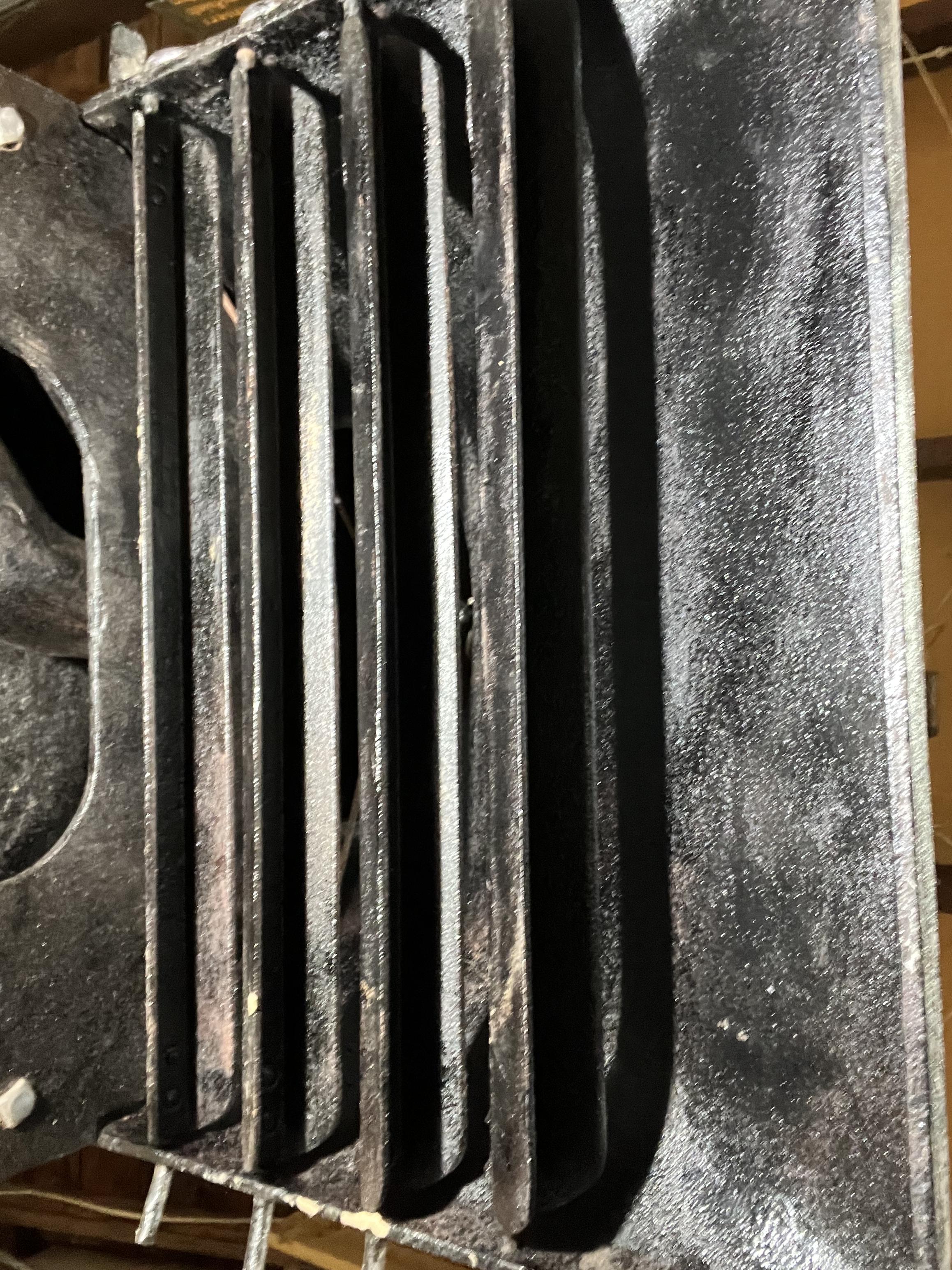

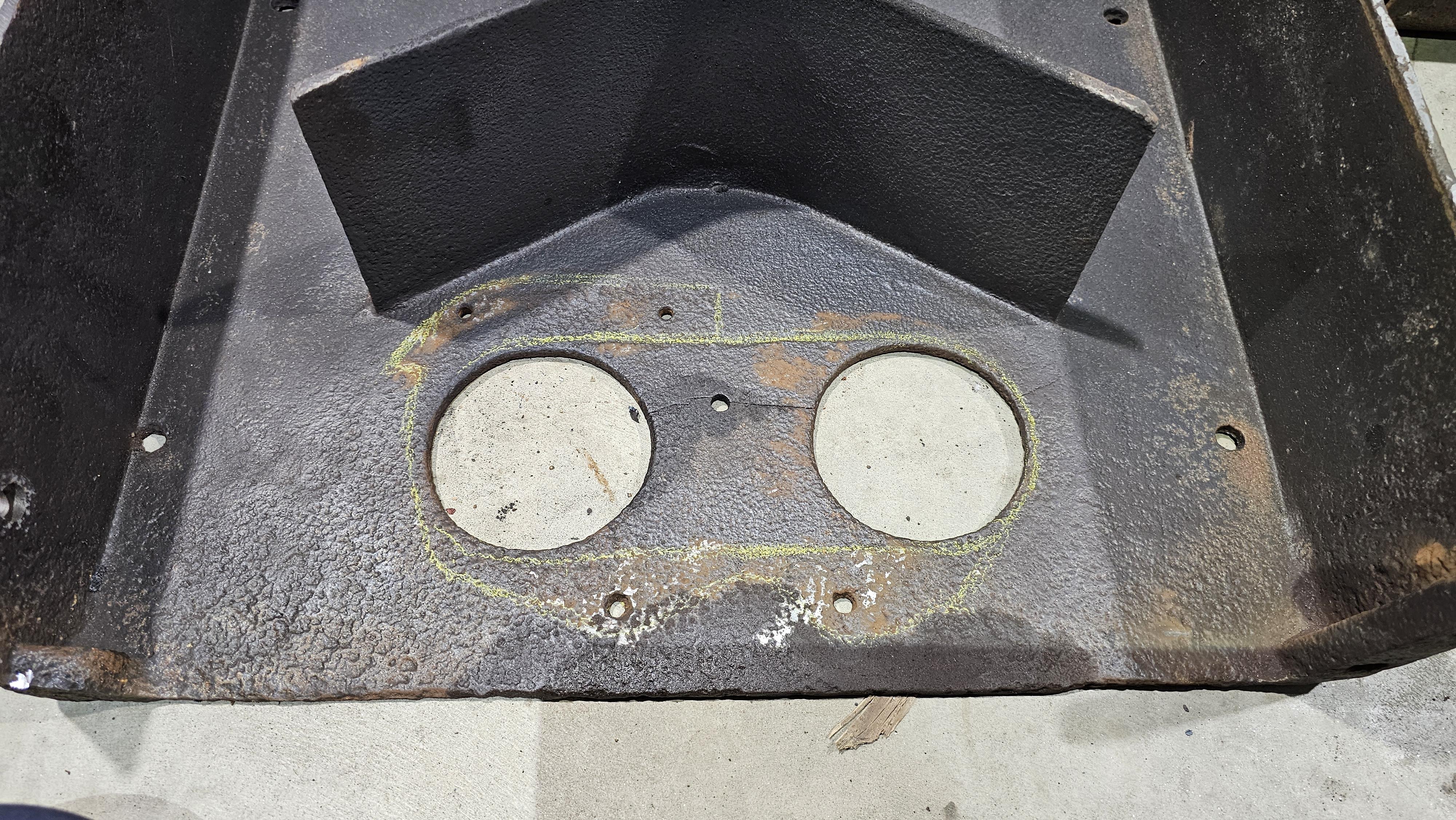

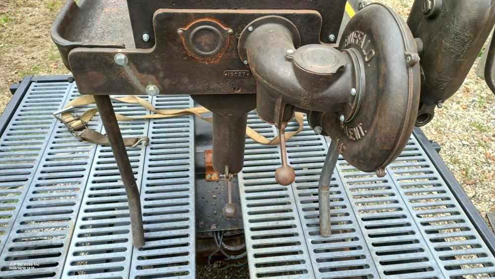

jlpservicesinc Posted October 14, 2023 Share Posted October 14, 2023 So after my test fire I noticed there was not as much suction as there should be.. When I lifted the forge up to move it I noticed there was a few things going on. Now I am perplexed because there seems to be a part missing on this forge that somehow changes the flow of air. It's a shield that goes in front of the blower intake at the back of the hood at the bottom. I can see where something was mounted but is not missing. Be great to see an original before I just guess at it. I also tore it all apart and found some missing bolts holding up the ash dump for the hood as well. Quote Link to comment Share on other sites More sharing options...
JDW84 Posted March 4 Share Posted March 4 I’ve got this same forge, I’ve just taken it all apart and cleaned everything up. I know this is an older thread but I see people are still commenting lol! Quote Link to comment Share on other sites More sharing options...
jlpservicesinc Posted March 4 Share Posted March 4 No worries on age of this thread.. What hood series do you have a 660 or a 6660? I'm still looking for some photos of the upper shutters and the air diverter that is supposed to sit just under the upsidedown V Quote Link to comment Share on other sites More sharing options...

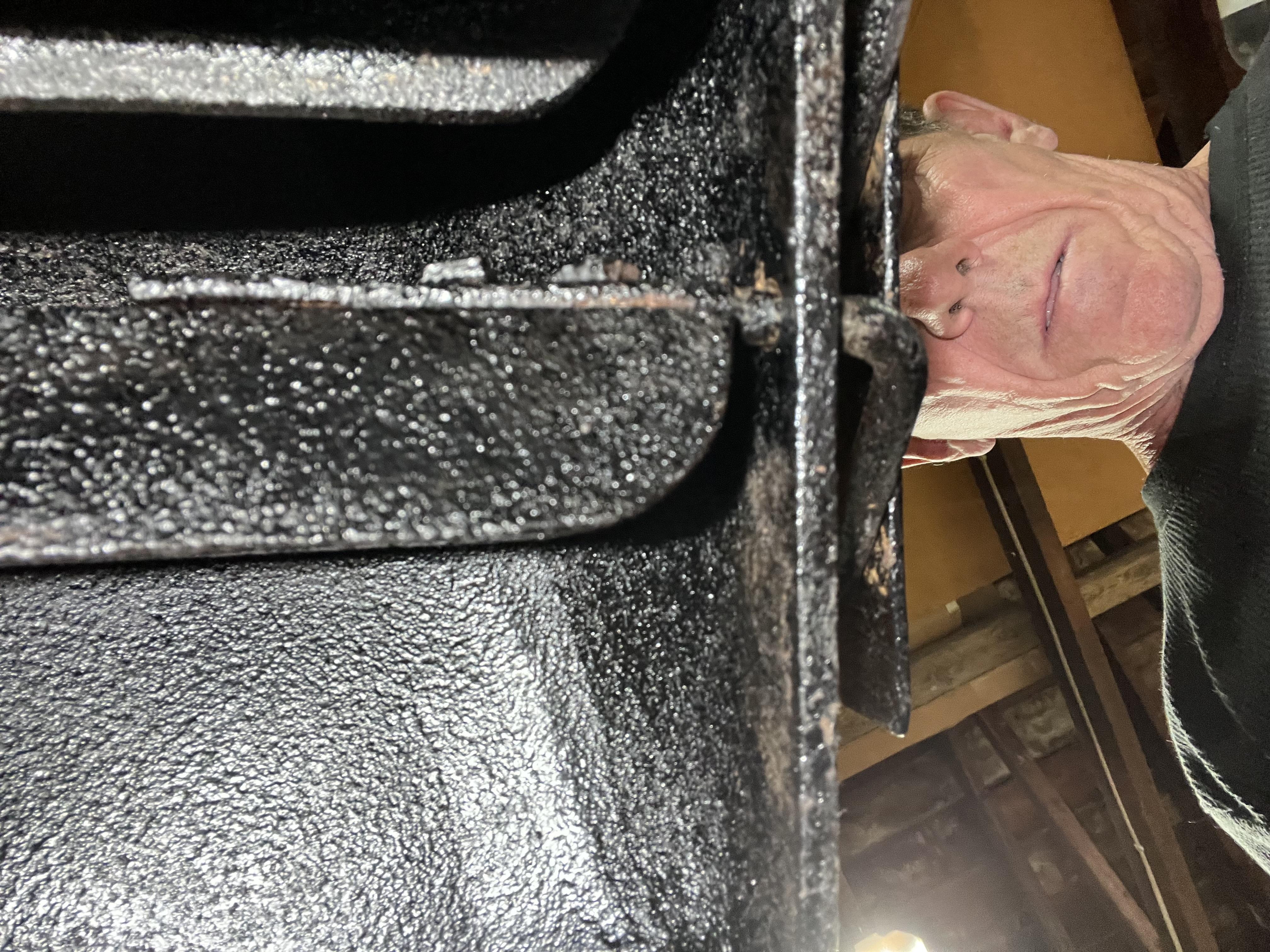

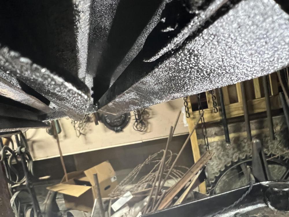

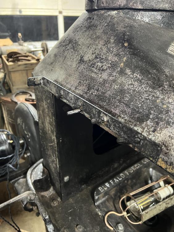

JDW84 Posted March 4 Share Posted March 4 I realize there may be some that frown on me painting it, but I like my things ti look somewhat nice. And I had to cover up the orange paint that was on part of it. The guy I got it from said he got it from a vocational school. I’ve had it awhile but it’s just been setting. I’ve got all new bolts to put it back and should start assembling it soon. Luckily I work in a large factory that has its own gasket shop and I can get new gaskets there. It’s the 6660 I’m out right now but as soon as I get back I’ll take a picture of the piece you are asking about. It’s basically a flat piece that stands out about an 1 from the hole. Could have someone break you one from a piece of 1/4 steel. Quote Link to comment Share on other sites More sharing options...
jlpservicesinc Posted March 4 Share Posted March 4 Nah, the paint looks great.. Paint is excellent for keeping rust at bay.. In the old days, the paint was great stuff and they slathered it on.. Often times it looked like creosote dip.. There would be puddles of dried paint and large runs. I was told by a guy who painted tractors and heavy equipment that runs don't rust.. Your photos did not come thru originally.. I can see them now.. Nice looking forge. If you are making gaskets commercially I'd buy a set.. A lot of the seams need to be plugged with calking. do you have some idea of what you will use? When you put it back together be sure and install all the bolts and pieces together loosly.. Then start tightening the bolts in a "round loosy" kinda deal. Some photos of those pieces would be fantastic.. When you have time.. Quote Link to comment Share on other sites More sharing options...
JDW84 Posted March 4 Share Posted March 4 I wish I’d used flat black instead of the gloss but when I originally started working on this over a year ago I didn’t pay attention that it was gloss I had got. POR-15, a little pricey but good stuff. The gasket material will probably be grafoil material which is a graphite based material that we use quite a bit. I can buy the material or they will probably have scraps they will let me have. They have a machine that cuts them out, I’ll just have to bring them a pattern. Hope these pictures help! Quote Link to comment Share on other sites More sharing options...

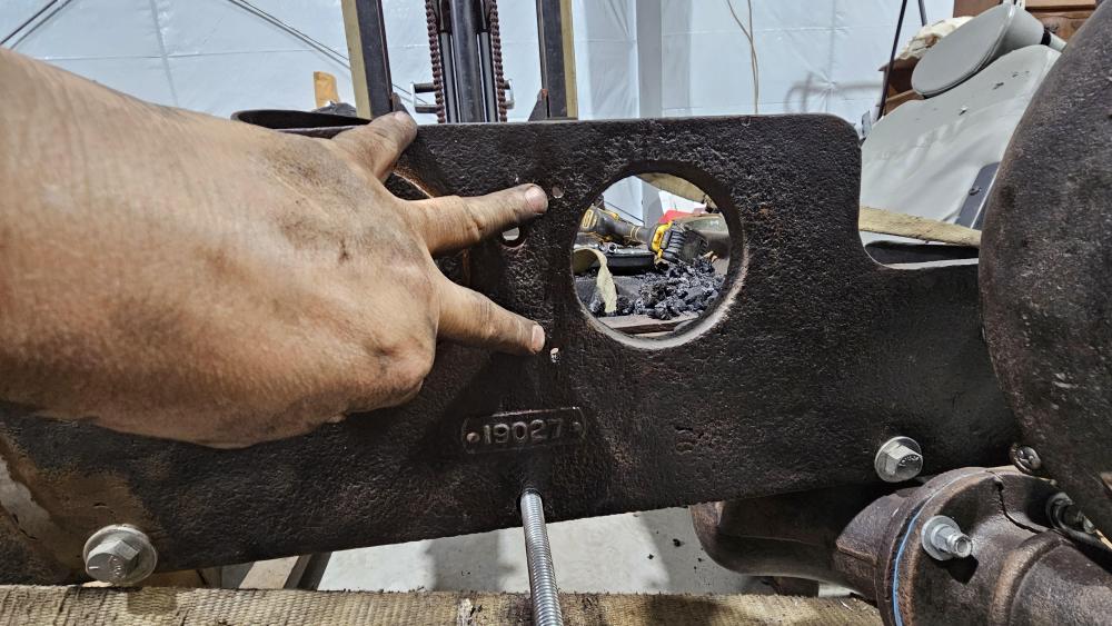

jlpservicesinc Posted March 4 Share Posted March 4 Wow, thank you very much.. That is great.. Now I can make up the parts I need.. On my unit there are bolt holes on the bottom as well.. Does your back wall have the extra bolt holes? The gloss black will turn matt over time.. Looking really sharp though.. I like the gloss. Quote Link to comment Share on other sites More sharing options...
JDW84 Posted March 4 Share Posted March 4 These? Is there any way to date this thing that you know of? Quote Link to comment Share on other sites More sharing options...
jlpservicesinc Posted March 4 Share Posted March 4 Here. Quote Link to comment Share on other sites More sharing options...
JDW84 Posted March 4 Share Posted March 4 Yep, they are there but as far as I know there wasn’t anything in them. There is a bolt that goes through where my finger is, well a counter sunk screw that comes through the back plate and had a nut on the inside under the air diverter plate. Those two holes at the bottom I’m pretty sure didn’t have anything in them. Quote Link to comment Share on other sites More sharing options...
jlpservicesinc Posted March 4 Share Posted March 4 It makes me wonder what those extra holes were for? Your forge looks like it lived a good life.. These forges often times end up living outside or in a barn with the roof falling in. Here is the post of the forge I have. Posting all the photos here might have been more useful.. Quote Link to comment Share on other sites More sharing options...
