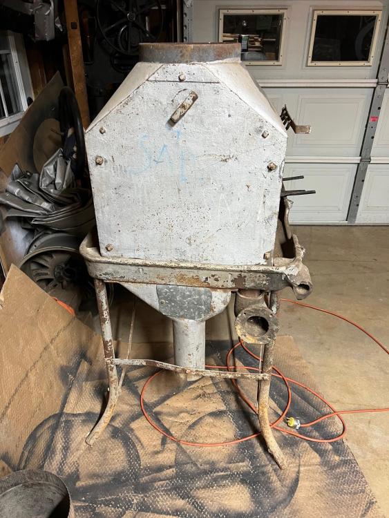

  10. I am preserving /restoring a buffalo 660 Forge. Please see my video for progress. IMG_6091.MOV
  11. Thanks for all of the great suggestions. After I posted I was able to break out a small chunk. Then, with the patience everyone suggested, I was able to chip out larger chunks separating them from the cast pan. It took a couple of hours but it is completed without any casualty ( to the forge of course). Thanks again for everyone's assistance!!
  12. I need to remove the refractory from a cast forge pan in order to free up and remove the firebox. I don't want to use Muriatic acid to "eat" the concrete if I can avoid it. I have tried a chisel to break it but it is strong stuff and I am concerned about breaking the cast pan. Any knowledge/wisdom/advise from everyone with more experience and smarter than myself would be greatly appreciated.
  13. Great pictures. The hand crank blower is original to the forge. The blower below the forge looks to be a sheet metal job , probably a squirrel cage blower put together for some unknown purpose. but not original. The picture below is your blower out of a catalog.
  14. Blackwater forge of this forum posted a 6660 with both a hand crank and electric blower attached but had no pictures. PACO312 had a picture of a 6660 posted very similar to yours. If you could post a picture of the back that would be great. It should have a gas return tube connected back to the blower.

  16. Some folks have asked for pictures so I wanted to include what I have so far. The forge is complete except for the 200 blower and the gas return tube. My father had it buried in his barn for 40 years and I recently rescued it. Please keep me in mind if you run across anyone that may have parts. Many thanks for the responses and assistance. Thanks for the suggestions. I know the quest will be hard but I am hopeful. I am one of those guys that like to restore back to original...I know, it's a sickness. Last year I had a No.3 Buffalo blower missing the 1/2 moon gear and finally found that part so I remain optimistic in my quest. I have posted some pictures. Many thank for the thread.
