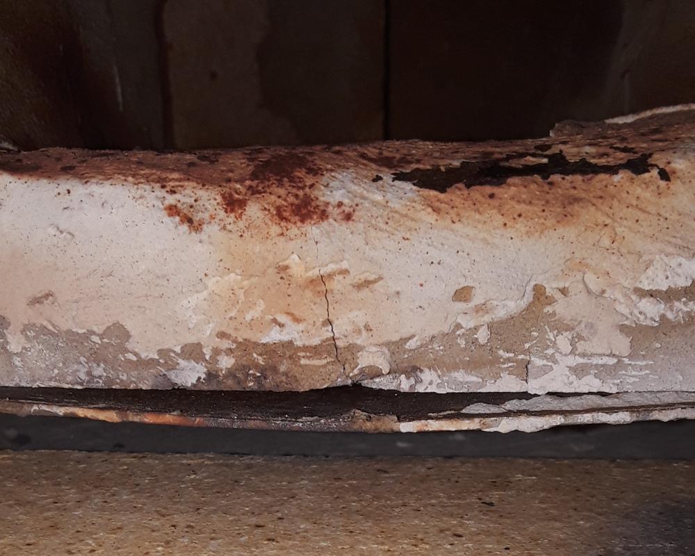

Update on the YSZ experimentation.  I fired the Satanite refractory and then I needed to order some plistix.  I added small amounts of the Zirconia powder to the plistix and applied that.  Three weeks' ago I fired it up the hottest yet.  It sustained damage to the lining.

It even caused the floor to sag.  At this point I had to choose to use the same refractory mix or just go headlong into the Zirconia coating.  Headlong I went.
Above is the YSZ mixed with a binder and applied.  It took forever to air dry!  The weather here had gone cold so I brought it inside for a week of drying.  Following that, I attempted to cure it with a propane torch.  Some of it delaminated and cracked.  I made up a fresh batch yesterday to patch up what needed patching.  Fired up the forge after quite some time of indirect heating to cure it hard.
I don't have a temperature reading, but I was once again able to practice turning good steel into bad.  We'll see how the interior looks later.  I had to wrap things up, it was getting late.
Those look like awfully thick coats. Did you try putting a light bulb in the forge to keep it warm while drying? It really speeds it up even in warm weather. Just a small bulb, 40 watt incandescent is plenty.

Yes, it was really thick.. I even filled in the hole which you see in the one photo of the damage.  Clear down to the insulating wool.  The binder that I used in the most recent test is not plistix at all.  The prior test of adding YSZ to plistix is uncertain.  There were areas of that layer which cracked and delaminated.  You can see evidence of that in the other photo as well.  I just had to employ a lot of patience, mixed with a little impatience, to give it the time it needed to seem dry enough to fire it.
Yeah, that's the problem you're having. You want LOTS of THIN coats, latex paint thin. Thin coats dry completely in under a day and don't shrink check (cracks like in yours) or delaminate. Mix it the consistency of latex paint and butter the sub-surface before applying. Buttering is wetting the surface with clean fresh water, it makes a major difference to how mortars, plasters, etc. bond.  Spritz, or wipe on with a wet sponge or cloth.
You can make it as thick as you wish but you have to do it in thin coats. Plistex and Matrikote are not water setting they dry so a light bulb or fan won't hurt a thing.

This is all uncharted territory for me.  I did butter the previous coating.  However, the binder I used is in a solution of 50% water.  I expect that there is no absorption of water or binder with Zirconia, but adsorption.  Shrinkage should be minimized, as such.  I think that my first torch firings caused it to curl because it was drying too much from the outside, causing tension from some shrinkage on the outer part first.  That was why the most recent time I used an indirect heating.  And actually, on the prior test, I was trying to heat the forge from the outside, which is pretty ineffective due to the insulation.

I was using Aluminum DiHydrogen Phosphate.  Mikey had mentioned that he thought Phosphoric acid could be used.  I wanted to stay away from playing around with acid.  But that sent me down a little rabbit hole in which I found that Phosphoric acid is used to react with aluminum salts or hydroxides, and the result is Aluminum phosphate or aluminum dihydrogen phosphate.  I chose to forgo the messing around with the initial steps and buy the end product.  It was not cheap, either.  Still trying to get something of an improvement, or new altogether.  Wish me luck.

I have also considered that putting the YSZ coating on top of the Satanite can have ill effects if the coefficient of thermal expansion between the two is too much of a mismatch.  That being said, I am considering maybe another new Mr. Volcano as the test rig.  It has been a pain to be out of commission forging while I am also experimenting with my only forge.
It is also possible that the Zirconia that I am using is too coarse for this type of binder.  The finest that I have recovered passes through a number 400 sieve.  The rest are larger, progessing from #'s 270, 230 and 140.
