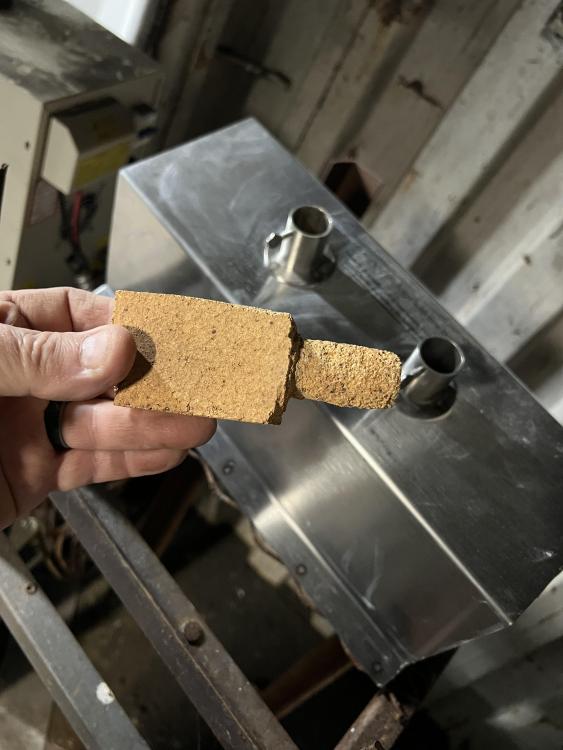

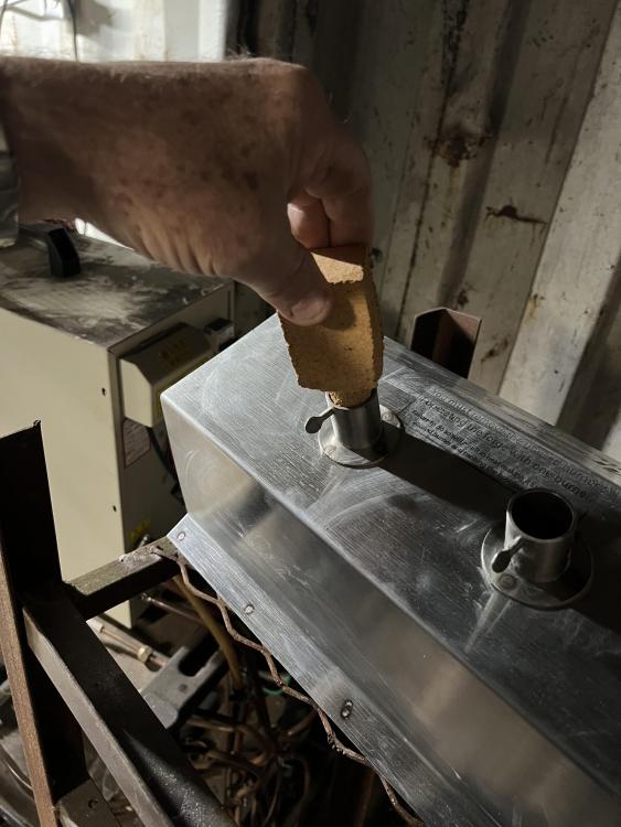

Purple Bullet Posted October 11, 2022 Share Posted October 11, 2022 After reading all the raves AND ESPECIALLY after learning about the new insulation (low bio persistent, non carcinogenic) I ordered a Hero 2. My original gas forge had cera-wool, which is why I trashed it after damaging the coating and never getting that circular thingy (the round tuit) to repairing it. I'm going to try it first as per instructions, with the only change in that I cut off the overhanging bottom firebrick and used it to make a plug for the burner hole that I will probably rarely use. I ran the idea by Mr Volcano tech support and they don't see any problems with that. Link to comment Share on other sites More sharing options...
