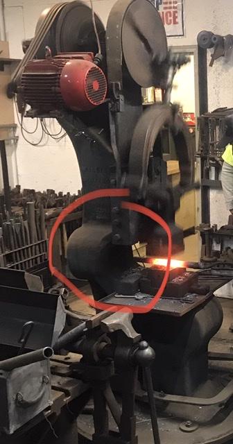

Goods Posted May 11, 2022 Share Posted May 11, 2022 If you were worried about ever needing to work longer stock, you could always come back weld some bent tube arches to the frame a cut the center of the frame out. Basically, make a “pass through,” similar to this old Williams and White: Keep it fun, David Link to comment Share on other sites More sharing options...
Frosty Posted May 11, 2022 Share Posted May 11, 2022 That's a cool idea David. A person could include a gozinta facing backwards so you could install a helper to support long stock on the far side. Working long pieces tends to make them sag on the far side of the dies. Angling the dies would only involve a second step machining them out. Cut the dovetails and shim or jig the stock to cut the die faces at a 15*(?) angle. Frosty The Lucky. Link to comment Share on other sites More sharing options...

MerlincMan Posted May 12, 2022 Author Share Posted May 12, 2022 19 hours ago, Frosty said: Angling the dies would only involve a second step machining them out. Cut the dovetails and shim or jig the stock to cut the die faces at a 15*(?) angle. Chewed on that design detail for around 2 months while I was making the head. It would have taken quite a bit of weld-to-cut (embiggening the stock) on the head-piece (upper die-shoe) to make that happen, I ultimately decided against it and just made wider dies. I can sneak past the spine (as I do in the rebar-video) and address the weirdness that this produces by hand on the little anvil. As it is, you can see in my pics that I had to weld some re-enforcement to the face of the upper-die-shoe after cutting the receiver for the upper die. After grind and paint, it made it look "cast" (in my view) and gave it a neat look, so I'm happy with that. And, why didn't I just buy a bigger blank? Steel prices have gotten indefensible here, and I had most of this scrap lying around anyways. Aside from that, 4x4x8 solid is.... not exactly common stock. 3 minutes ago, Anachronist58 said: Not that there appears to be any necessity to further inflate your ego, . Believe me my friend, there is more than sufficient deflationary pressure; thinking too highly of myself is the least of my realistic problems .... Hence the overcompensation Link to comment Share on other sites More sharing options...

Frosty Posted May 12, 2022 Share Posted May 12, 2022 I believe were envisioning different things where angling the dies is concerned. What I'm thnking wouldn't require welding or larger stock. Upon further thought last night I'd cut the dovetails and use a female dovetail on a base plate that clamped to the mill at whatever angle I wished. The only downside would be the striking surfaces of the dies would be slightly narrower but you have plenty of meat there now. Lead shot in the frame tubing is what I'd use. Concrete will stiffen it up considerably but not damp the compression waves conducted through the steel tubing frame. filling with lead shot is an industry standard for many applications, not all but many. The automatic drop hammers we ran on the soil sampling drill rig I operated were filled with lead shot and they hardly bounced if the casing or sampler fetched up on a boulder or bedrock. It turned the deafening ring from the manual safety hammers to a heavy thunk with the auto hammers, fetched up on rock it was a metallic clunk but no ring, zero. Lead shot in the frame laying on the steel base plate should damp the sound considerable. Unfortunately there WILL still be compression waves radiating from the hammer's foot into the ground. Perhaps putting a sheet of plywood under it will work. Some guys use thick rubber like conveyor belt stiff. My 50lb. Little Giant is mounted on a pair of 6" x 12" beams in large part to fit the dies and treadle more to my comfort zone but also to damp the thumping. It helped but didn't make it go away. About the clutch wear question, it's a good one thanks for asking. I don't know what a VW weighs but let's call a fully loaded one 1,000lbs. The wear on the clutch comes from starting it moving from stopped. Estimating with my mark-1 eyeball There is the clutch plate, shaft, crank plate, pinion, link arms, and hammer, toss in a few lbs for nuts bolts, etc. I'd use 100lbs. for ease of estimation. So, when you press the treadle on a stopped hammer the clutch is accelerating maybe 1/10 it's rated use capacity. Does that make sense? (I hope) Frosty The Lucky. Link to comment Share on other sites More sharing options...
