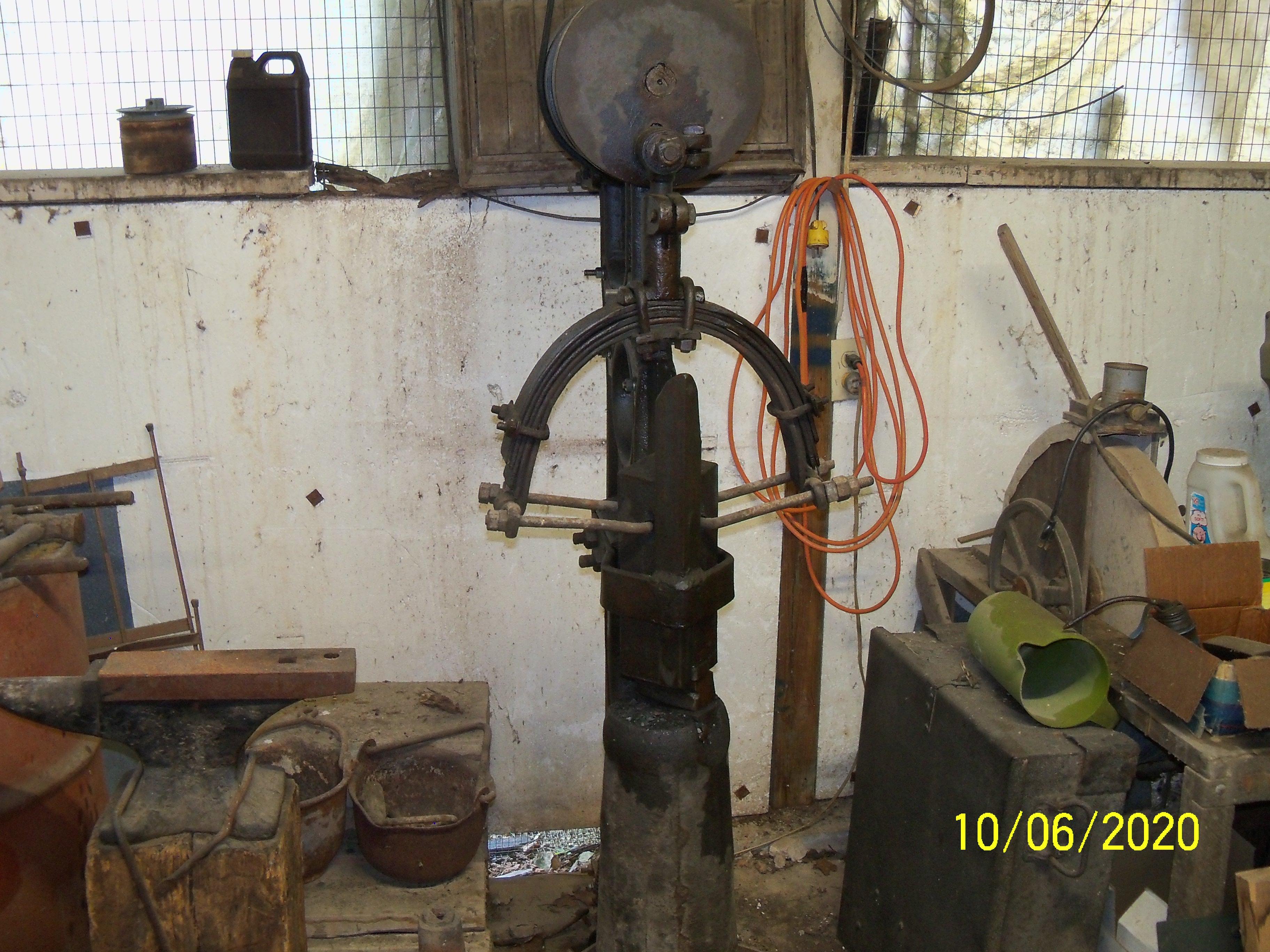

Power Hammer that I did.
30 minutes ago, Irondragon ForgeClay Works said:
no weeble-wobble.
I will consult the local CL for such a mat - thank you!
Champion power hammers use 90 degree dies and so are worked from the sides.  Mine have leaf spring linkages though not the LG coil spring.
BTW my 25# LG came from Merino Colorado and arrived there in 1915; been at least 25 years since it was sneaked into NM though...
As for 4"x4"x8" stock  some farm tractors use stock like that on their implements.  I measured one in La Union NM that was just sitting half buried along a fence row.  Unfortunately the owner died before I could ask him about it.  Might ask around an implement dealer, especially around a place where they run to large fields and big tractors.
