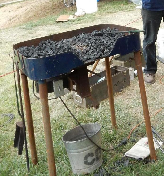

Hi, I've used these specific firepots a lot. CBA has 10 teaching forges set up like this. We transport them in a trailer to hammer ins and they set up (the forges, with the firepots) in just a few minutes. The design was for both consistancy across all the forges, CBA had a trailer of mismatched coal forges before this, and ease of build during a workshop-I think 15 were built over a weekend, with 10 slated for the trailer and the others went home with the crew members. These are also designed to drop into the forge tables and come out easily during breakdown. Here's what the whole forge looks like.
Having worked on and demonstrated with these forges, I don't think I've ever used the clinker breaker. Each forge comes with a poker, rake, shovel and watering can and we just pull the clinkers out with the poker. These are also teaching forges, I wouldn't say they are abused, but they do see a lot of students new to solid fuel. So, blowers get left on, fires get too big and clinker builds up.
That said, I started out with a brake drum forge, originally in a plant stand, then a rolling metal cart and finally found a nice case iron table forge with a round Centaur forge firepot that I use now.
I looked thru my CBA pictures folder and it doesn't look like I have one. The legs are pipe (stored in buckets)and fit into sockets in the table, the sockets are inset so the tables all stack together. Pokers, rakes and watering cans go in the tables as they are stacked. Firepots are stored in angle iron racks on the walls of the trailer (the flange keeping the firepot in the table fits in the angle iron) I'll see if I can get someone to take a picture of them broken down. There's an event this weekend and I "think" the trailer is there. Here's a picture from the volunteer workshop when these were built (Photo credit to Paul Boulay, our VP and Photographer extraordinaire!) I was mistaken, they built 20, 10 for the trailer and 10 for the workshop participants.

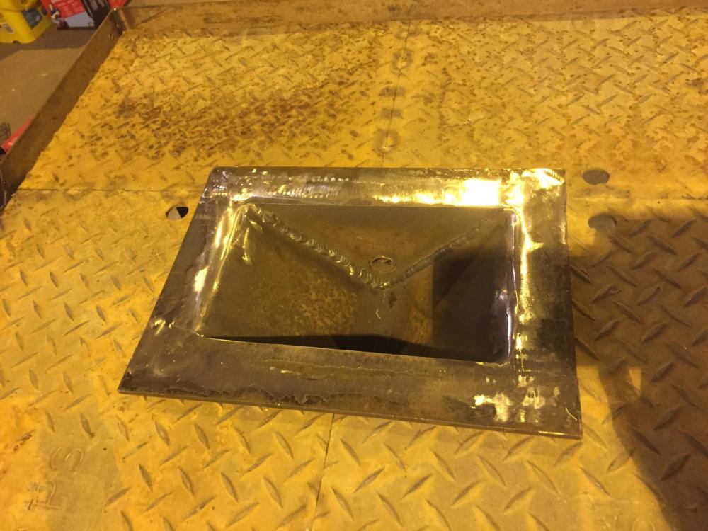

My forge. Side blast fire pot 6” deep with a 7/8”(3/4”schedule 40 pipe) ID tuyere out of 1/4” plate

so the fire pot is made from a 12” square of 1/4” plate cut on the diagonal. Measure 1-1/2” up from the corner and drill a hole to take a piece of 3/4” schedule 40 pipe. Weld it in at a 5% angle or so. That would be sloping down to the bottom of the forge. This leaves about an inch under the tuyere and 4” above it.
I made the pot 6” wide but I would have made it 4”, as I keep a fire brick in it to narrow the pot. I keep telling myself I will make a moving plate to adjust the width.
I have a “T” with a gate valve on it, it is set up so there is strait shot to the vent and the tuyere is at 90 degrees.
I power the forge with an electric blow up bed pump.
the table is 30”x60”  and made of all salvage, the top is plates from below ground transformer covers, the frame is welded up from bed frame and the wheels are salvage. I think they came from an old fire extiquiser.
I melt bricks and burn steel if I am not carful.
tho I usually burn charcoal, coal burns just fine and the forge handles 1” stock easily and I have worked 1-1/2”.
