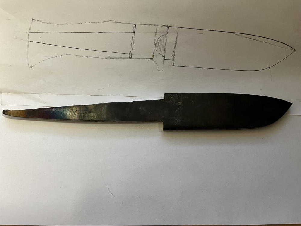

SlimW Posted October 23, 2023 Author Share Posted October 23, 2023 The tang is in fact the whole way in. what you see there is my inability to file a 90 degree angle accurately on both sides of the tang. I'll get it better next time. the gap isn't actually that bad, it's a trick of the light due to my inability to take good pictures. that's one of the things I don't like about this knife. I also think the guard is too thick; it could have used some sculpting. I couldn't figure out how best to do that with the tools I had, and after two years of sitting on it I got a little impatient. the handle shape isn't bad, but I should have moved the thicker transition portion further up towards the guard. I should also have narrowed the back end of the handle a bit, I think. I just freehanded the thing on my 1x30 sander. the blade finish wasn't bad, but there were some fine scratches that I should have spent more time on. I am happy about the blade shape. In all, it's the best job I've done so far, but there is a lot I could do to improve it. I gave the knife away to a guy that had donated a bunch of metal and walnut to me. The other I gave to a guy that gave me a bunch of antler to work with. I don't think I've made anything yet I would feel good about charging money for, so it's just practice so far. templehound: do you have a rule of thumb for tang width? Quote Link to comment Share on other sites More sharing options...
SlimW Posted October 23, 2023 Author Share Posted October 23, 2023 also: one important thing that I learned was that while 1x30 grinders can work just fine, you have to tune them a bit. I've been using my for 3 years now and didn't realize the tensioner arm was too tight and didn't pivot - apparently this is very common. because of this, the tracking knob couldn't really work correctly, and this caused uneven wear on the tracking idler wheel, which meant that even after I fixed the tensioner, the thing still wouldn't track correctly. This made accurate plunges impossible to grind, I couldn't line up the belt on the platen at all. I chucked the wheel in my lathe and reprofiled it, and it worked *much* better after that. the last thing I did was to add a steel plate to the table because those stupid grooves on the table made accurate grinds very very difficult. Quote Link to comment Share on other sites More sharing options...
Latticino Posted October 23, 2023 Share Posted October 23, 2023 If you haven't done it already, I recommend that you make or purchase a file guide (preferably with carbide inserts on the face. This will help a lot with getting both the plunge and step for the tang lined up well from side to side. I like the shape of your blade quite a bit, and the grinds look pretty good also. One thing that stands out to me is the slight tapering of the handle at the front of the wood section right behind the antler and brass spacer. It is hard to tell if this is intentional or a product of grinding the relatively softer wood next to the harder spacers. If not intentional, you need to take extra care in this transition area to avoid the "dip" in the future. If intentional, I recommend you exaggerate the change a bit more so it is obvious you wanted it to be there. Quote Link to comment Share on other sites More sharing options...
SlimW Posted October 23, 2023 Author Share Posted October 23, 2023 the taper was intentional, but I will do it differently next time. I think I'll make the same knife again, but fix the things I didn't like. Quote Link to comment Share on other sites More sharing options...
Buzzkill Posted October 23, 2023 Share Posted October 23, 2023 16 hours ago, SlimW said: I also think the guard is too thick; it could have used some sculpting. I couldn't figure out how best to do that with the tools I had, and after two years of sitting on it I got a little impatient. I agree. However, with the tools you have you could have done some sculpting. It would be easiest before attaching the guard to the knife. A simple curve on the handle side of the guard would go a long way towards making it look better. To do this use a magic marker or something similar and draw the curve on the side of the guard until you like the profile. Since you have a tool rest on your grinder you can hold the guard with vice grips and lay the narrow edge on the tool rest. Then just use the edge of the belt to take off small amounts until the curve matches what you have drawn. You can then use the "shoeshine" technique with strips of sandpaper to take the sharp edges off and make if feel comfortable in your hand. If you have a drill and small drum sanders you can also accomplish the same thing, but it's slower and side pressure on drills can wear them out faster than drilling holes. Quote Link to comment Share on other sites More sharing options...
SlimW Posted October 24, 2023 Author Share Posted October 24, 2023 I started Mk.II of this knife. Going to use the same handle setup, but improve the guard and widen the tang. I'm also adding some length to the blade. While I was filing some rough cuts out of the tang, I noticed that the file was skating pretty hard on some bits that overheated when I cut the steel. I re-annealed the steel, and am making a file guide out of the scraps as metal clearly hardens enough to serve here. I also nearly lost some fingerprints pulling the blade out of my can of vermiculite. it's amazing how well that stuff insulates, even hours after heating. Quote Link to comment Share on other sites More sharing options...
Steve Sells Posted October 24, 2023 Share Posted October 24, 2023 not a good idea to have a sharp transition between tang and blade, its a stress riser for fractures Quote Link to comment Share on other sites More sharing options...
SlimW Posted October 25, 2023 Author Share Posted October 25, 2023 well, attempt number 1 at a file guide failed; both sides made it out of the quench just fine, the parallel surfaces remained parallel. My files skated on the surface completely. I put a polish on the guide faces on my sanding disk. it was getting a little warm to hold, so I dunked it in my water can, and PING, one half cracked through. I guess I should have tempered it, but I read a few posts here and other places where people had used them full hard, so I took a chance and failed. I'm not too sad, the next one I'll do with guide rods and more substantial cross-sections. Quote Link to comment Share on other sites More sharing options...
Frosty Posted October 25, 2023 Share Posted October 25, 2023 Not file steel they didn't. You might get away with using one as hardened if you're using lower carbon steel say 5160 spring steel but not a good file. Of course you could cheat and buy and read Steve's 1st book, that way you won't make such fundamental mistakes. Any questions you do have will be good questions and you'll have enough grounding in knowledge to understand the answers. Of course it can be fun to just dive into things and learn it yourself. Frosty The Lucky. Quote Link to comment Share on other sites More sharing options...
SlimW Posted October 25, 2023 Author Share Posted October 25, 2023 I tempered the remaining file guide at 275 for an hour. Files still skate easily on it, and it held up to the stresses of clamping in a vise, even half a file guide is better than none at all. I filed those sharp corners out that Steve mentioned, and I only have some very fine scratches on the guide. Quote Link to comment Share on other sites More sharing options...

Steve Sells Posted October 25, 2023 Share Posted October 25, 2023 that is exactly how to do a tang, perfect Quote Link to comment Share on other sites More sharing options...
